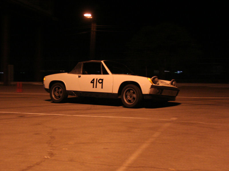

Number 419. Ha. Or rather, Ah.
Yeah... And I had NARVW on the rear trunk.

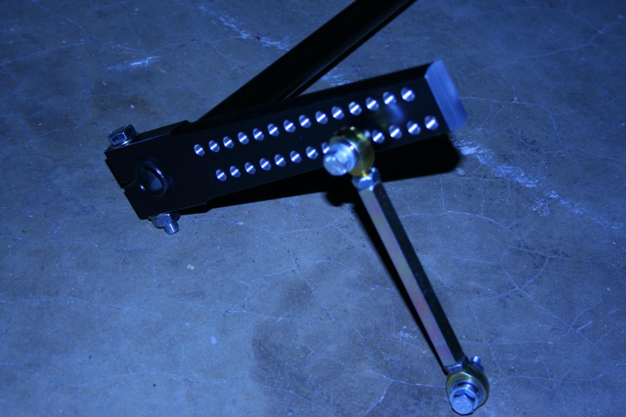

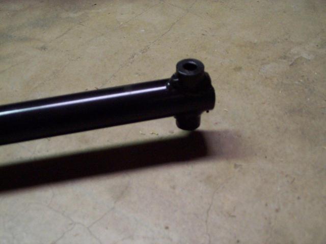

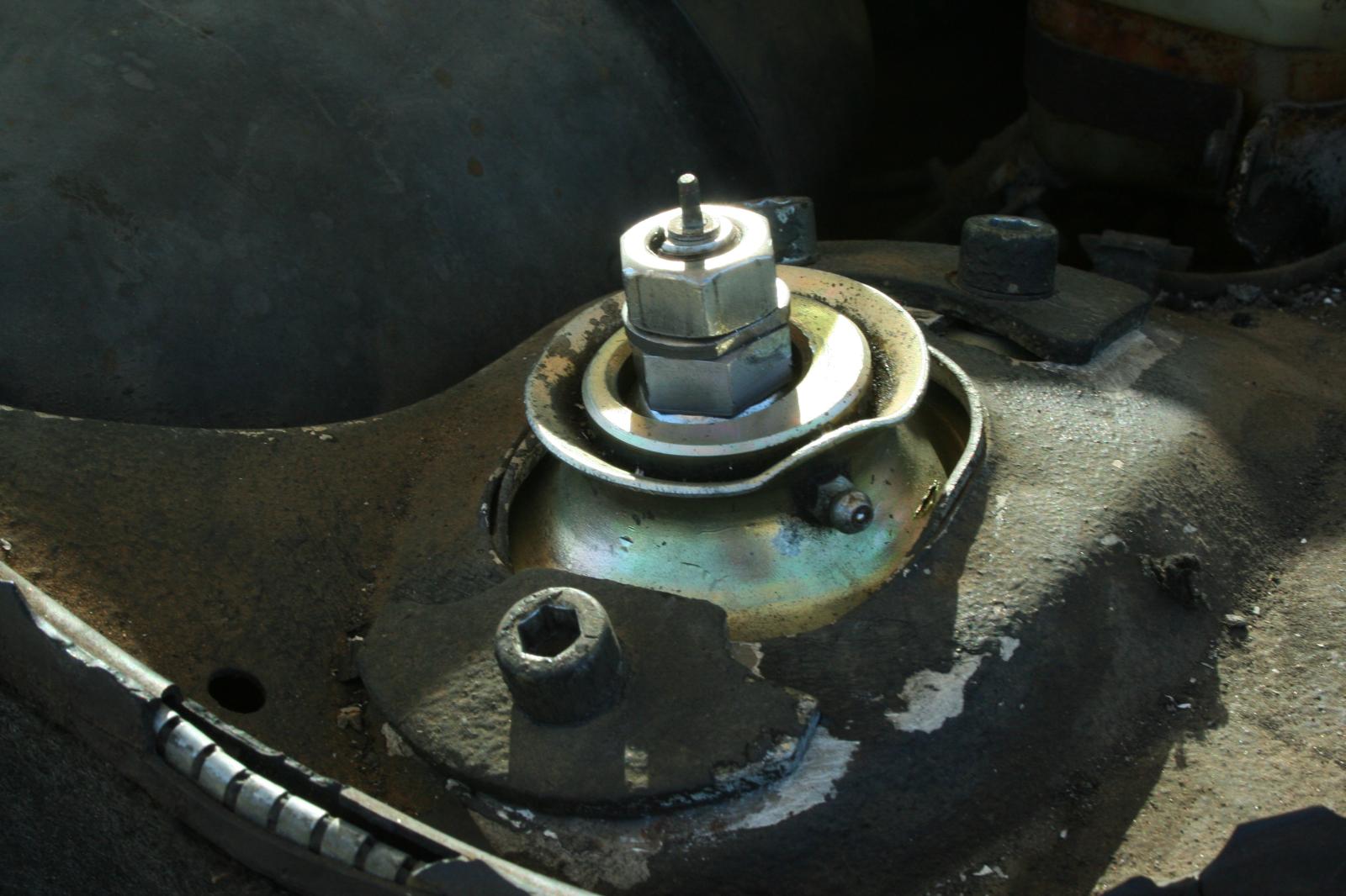

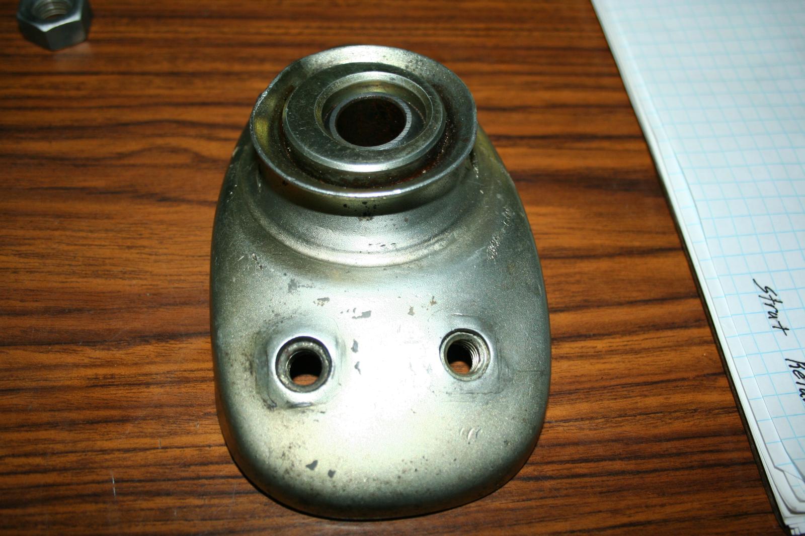

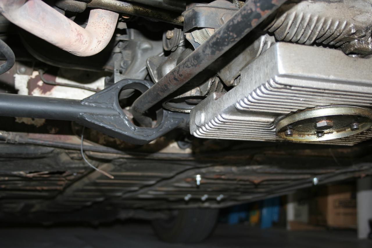

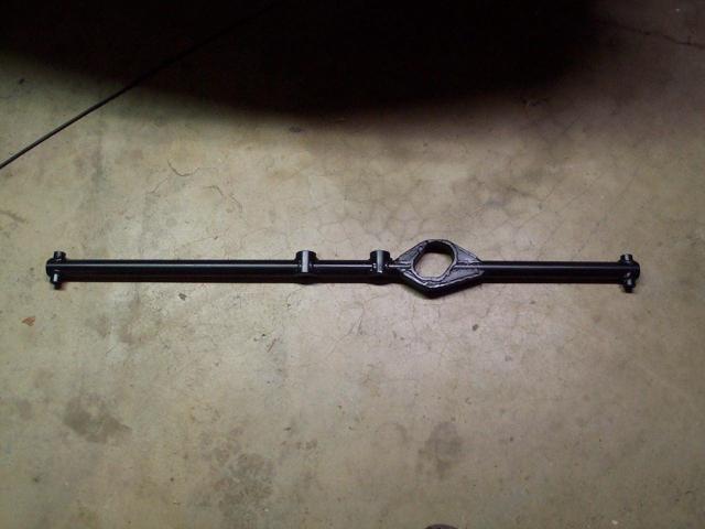

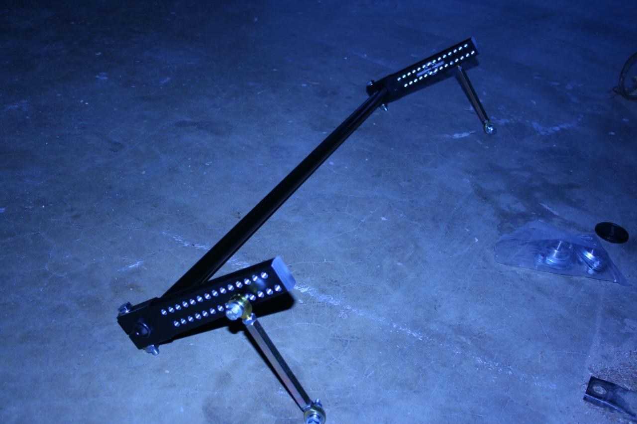

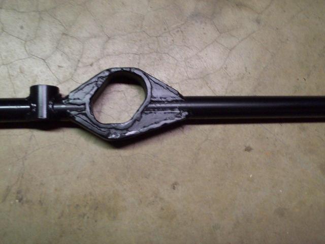

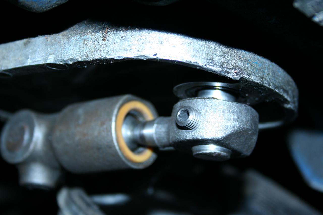

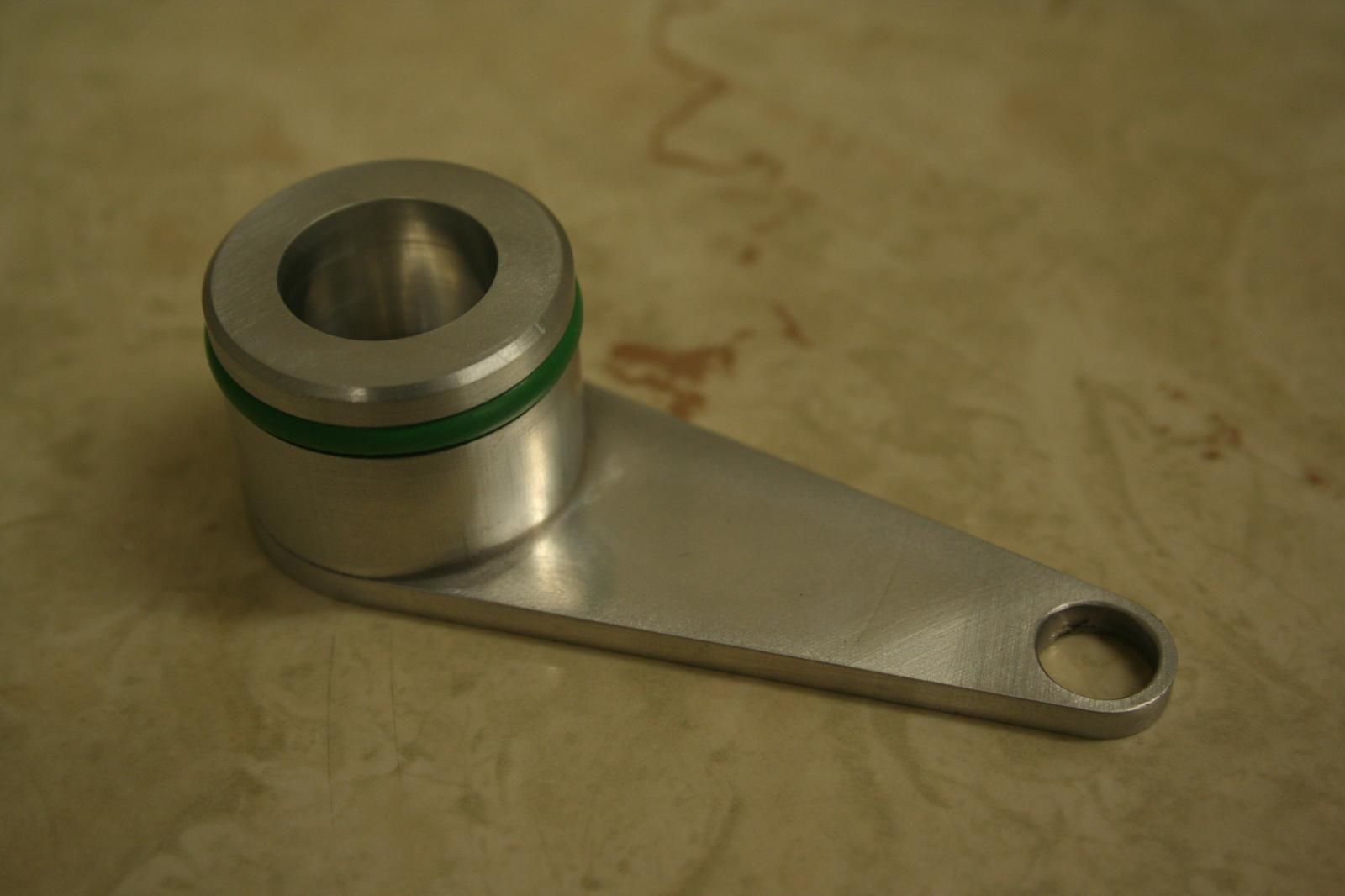

Well, let's start with the first custom fabbed piece on the car; the motor mount. When I did my side shift conversion, the mount bar that I got was bent. It looked like the car had been rear ended, because both ends were bent back, like the engine and tranny got pushed forward. So instead of finding another that may be bent, my brother talked me into letting him build a tubular one for me. I'm very happy with what resulted. It feels about 1/2-2/3 lighter, and looks way cooler than the stock one.
This part was built about a year ago and I posted pics, so some of you may remember it. I can't take any credit for the design. It was all my bro.
Mark D.
The main bar is 1 1/8" DOM steel. The ends are machined and center-drilled bar-stock that were welded in place.
The center mounts are 1 1/4" non-DOM tubing that are capped and center drilled for the rubber mounts. The hole for the shift rod is hand bent 1/8" flat bar. My brother bent the center piece in about three minutes, and then traced that shape onto the pieces for the gussets. I'm amazed how fast he did it and how well it came out... He Rules.
The welds don't look as good as they could, but he said his welder was acting up. I'm still very happy with it.

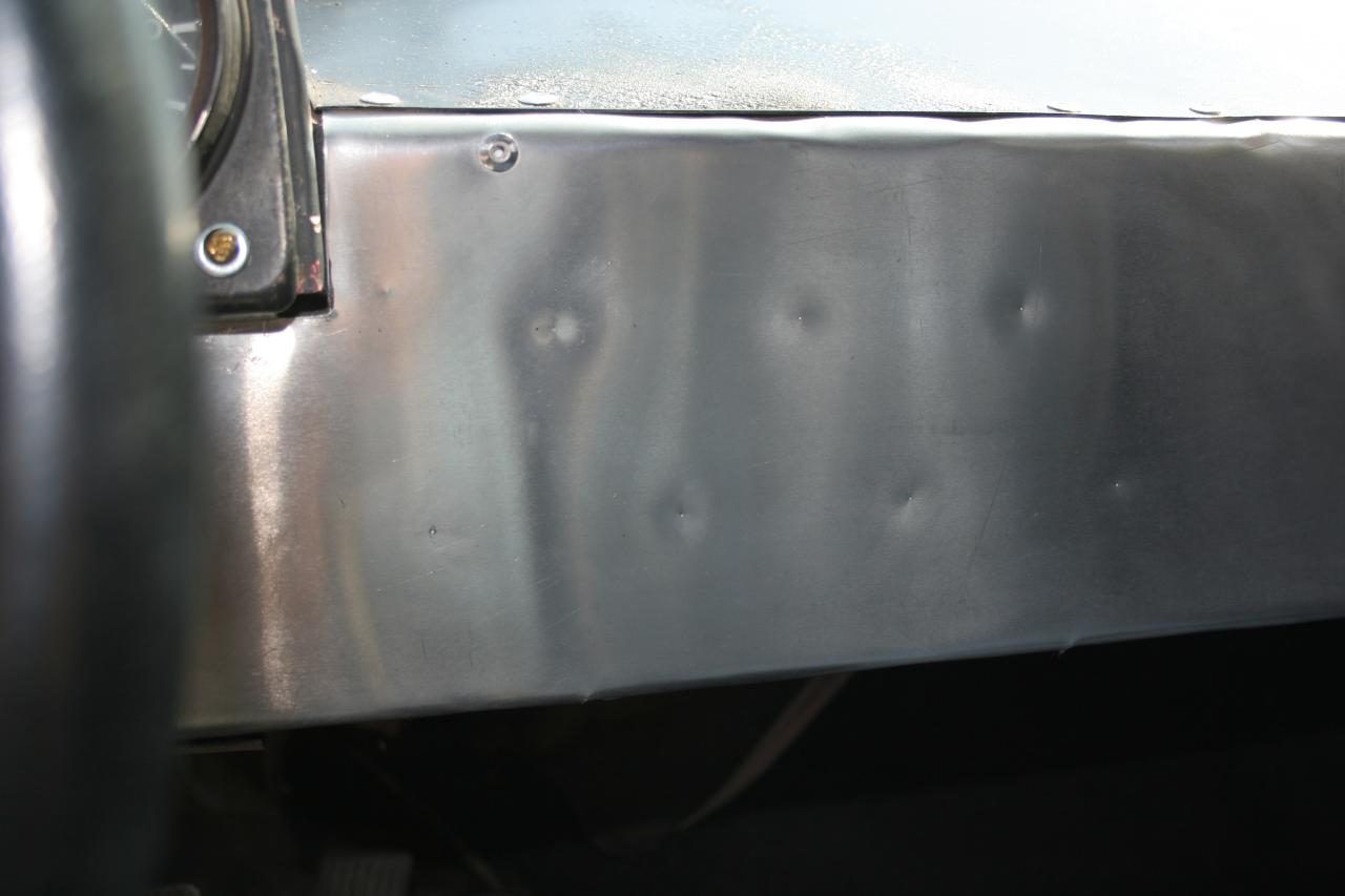

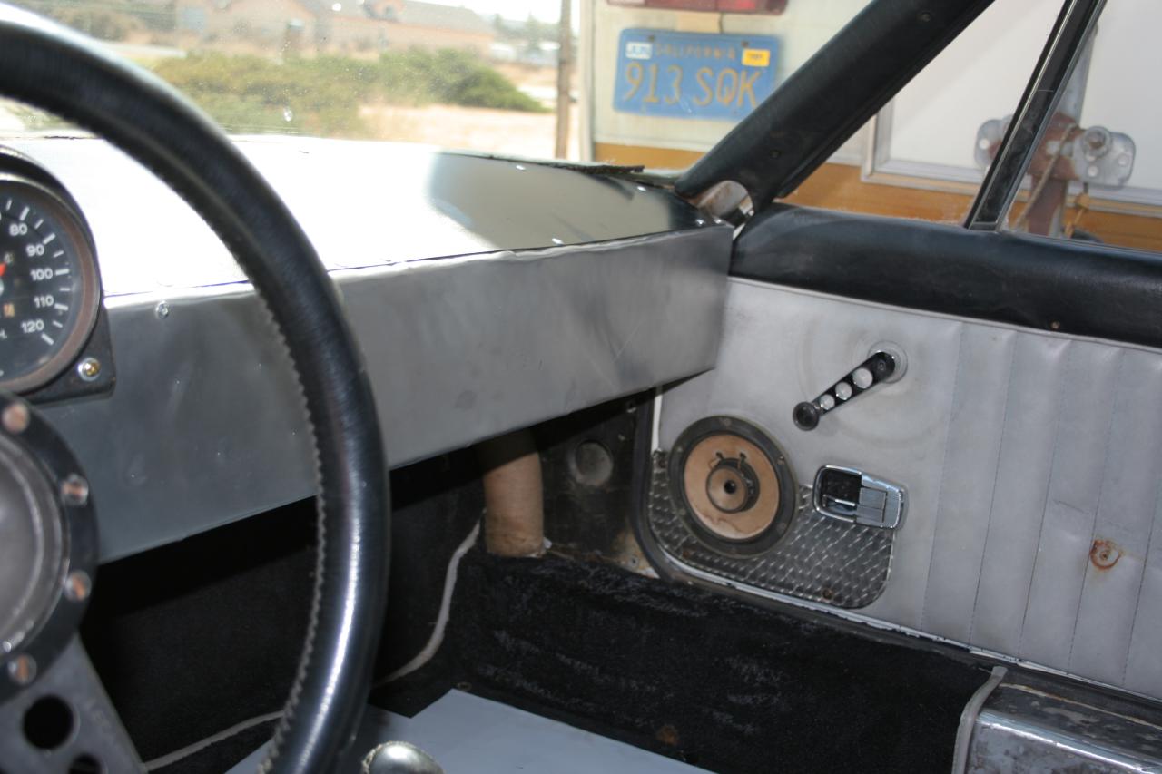

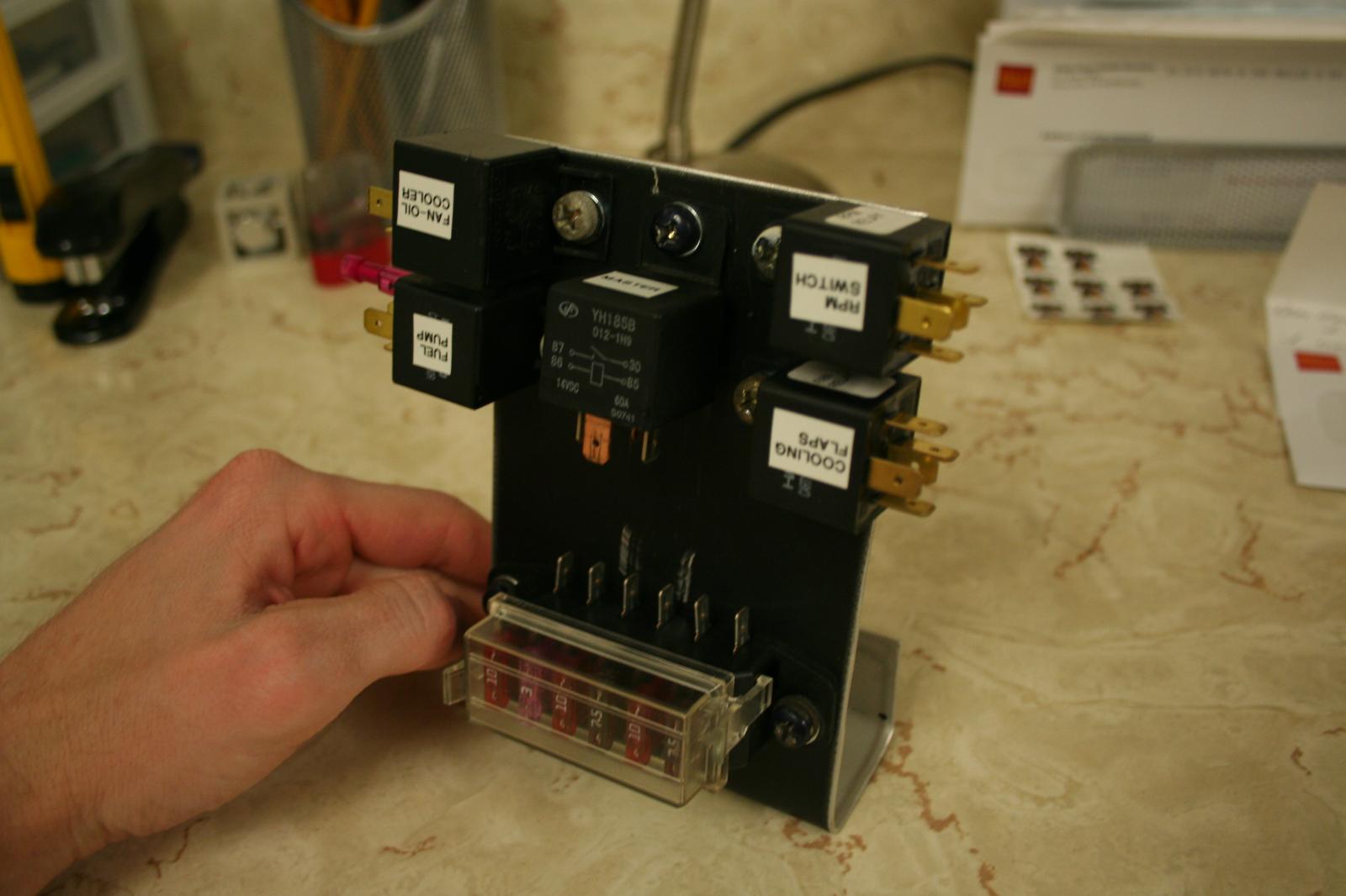

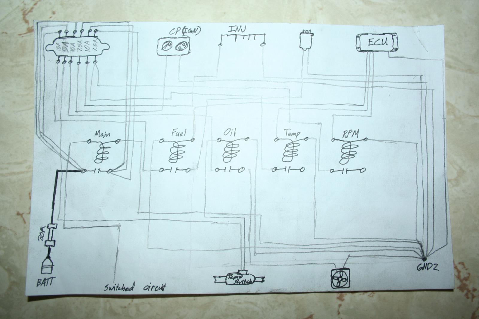

A couple months ago, I had an electrical short under the dash that took forever to find. I thought it was the ignition switch (which has had problems), but I was wrong. I ended up taking my vacation from work to fix it, as it was the only car I had at the time. I ripped the whole dash out and found my electrical problems. It turned out there was more than one. Anyways, the stock dash was thrashed when I bought the car, and it looked even worse by the time I got it out of the car. Since I got the electrical fixed way earlier than I expected to, I decided this was a good time to do my stripped out dashboard.
All I did is take the steel frame, cut it down to a flimsy framework, and then wrap some aluminum around it. Unfortunately, I don't have a 53" sheet metal break, so all the bends are hand bent around random pieces of angle-iron and 2X4. The long bends on the top and bottom had to be relief cut to facilitate this. The look isn't as good as I'd like, but it's alright.
Mark D.

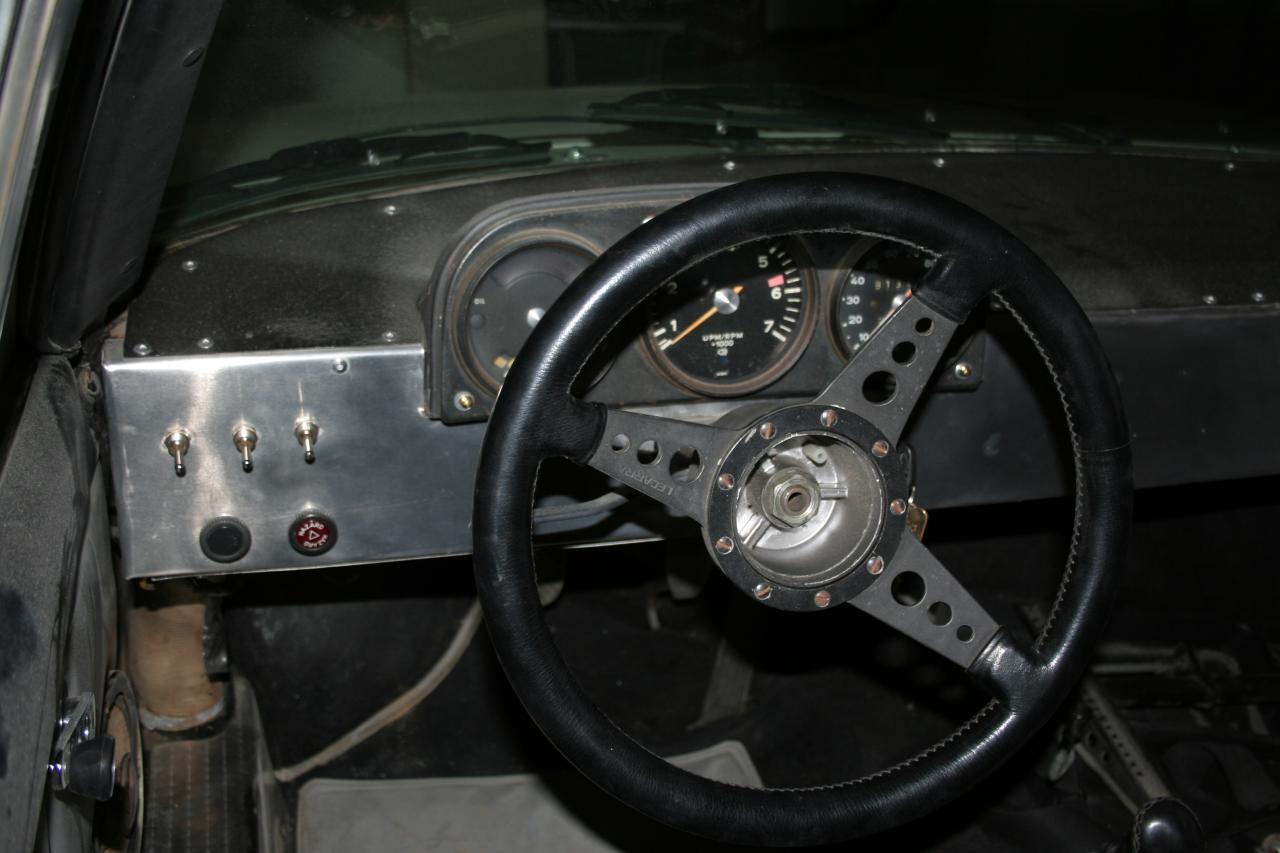

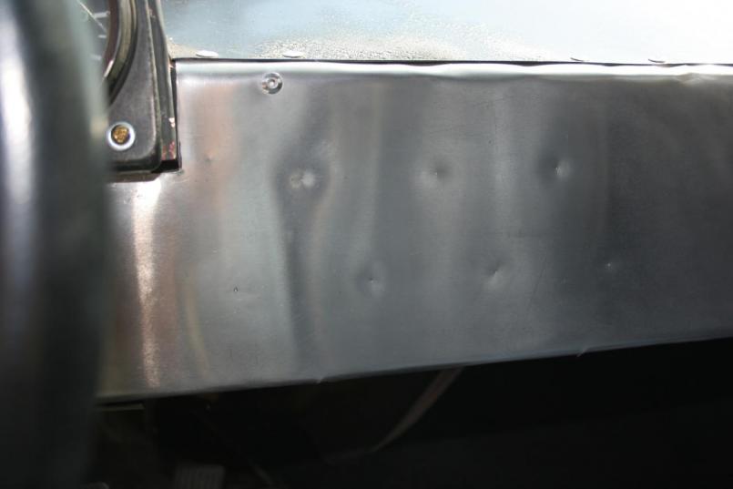

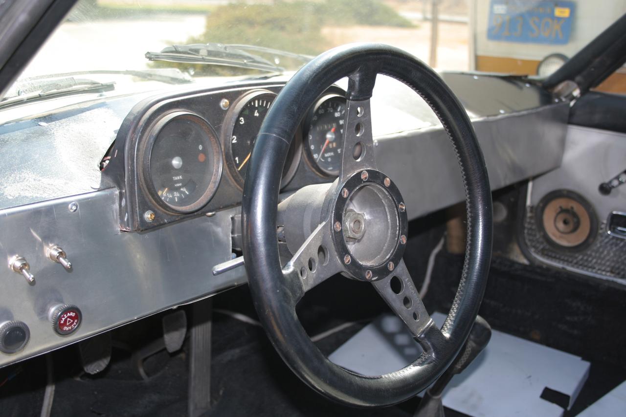

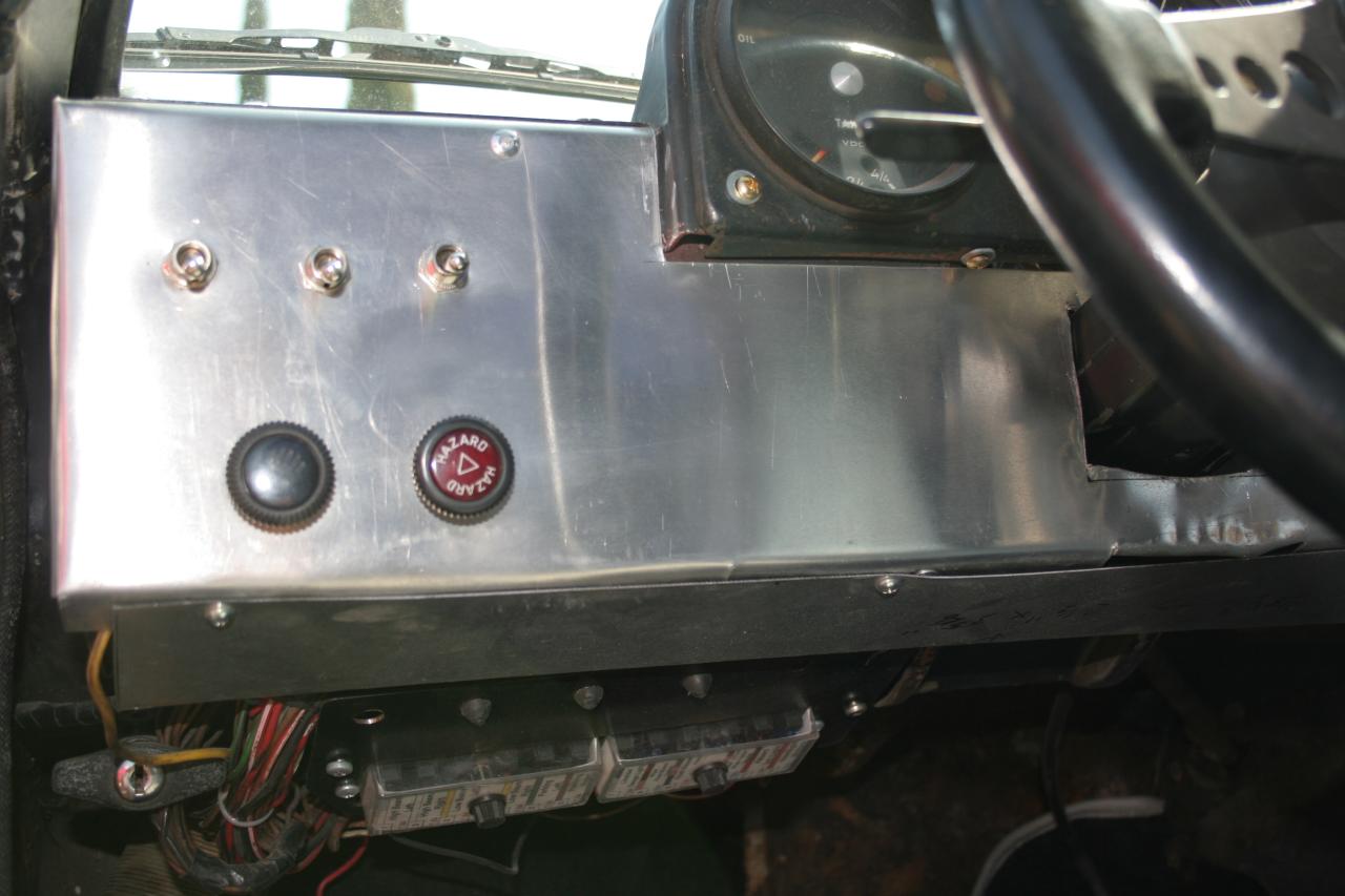

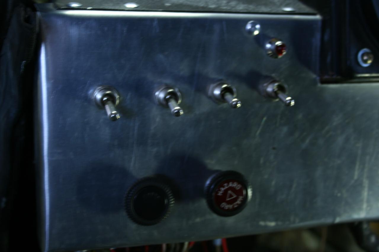

Center-punch marks for the future gauge centers. That's a project for a later date.

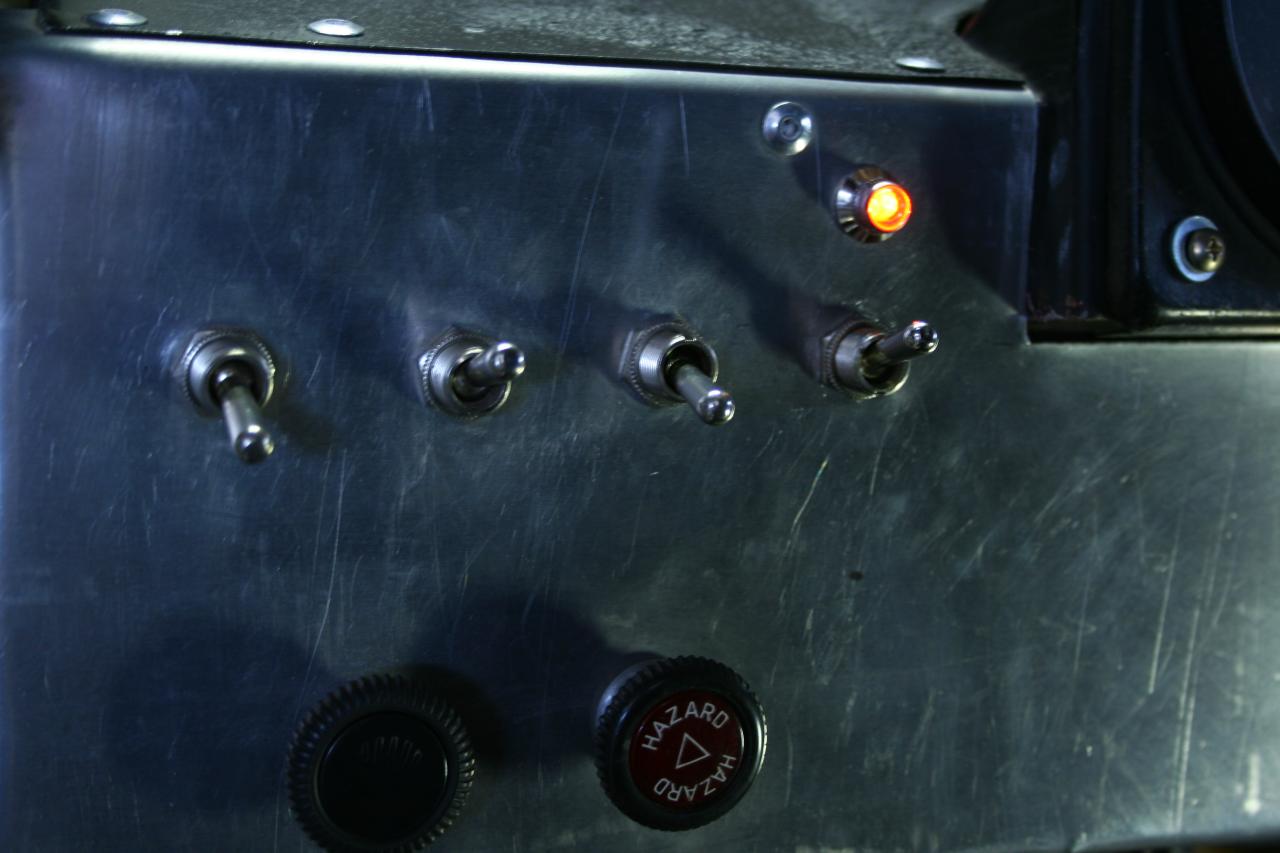

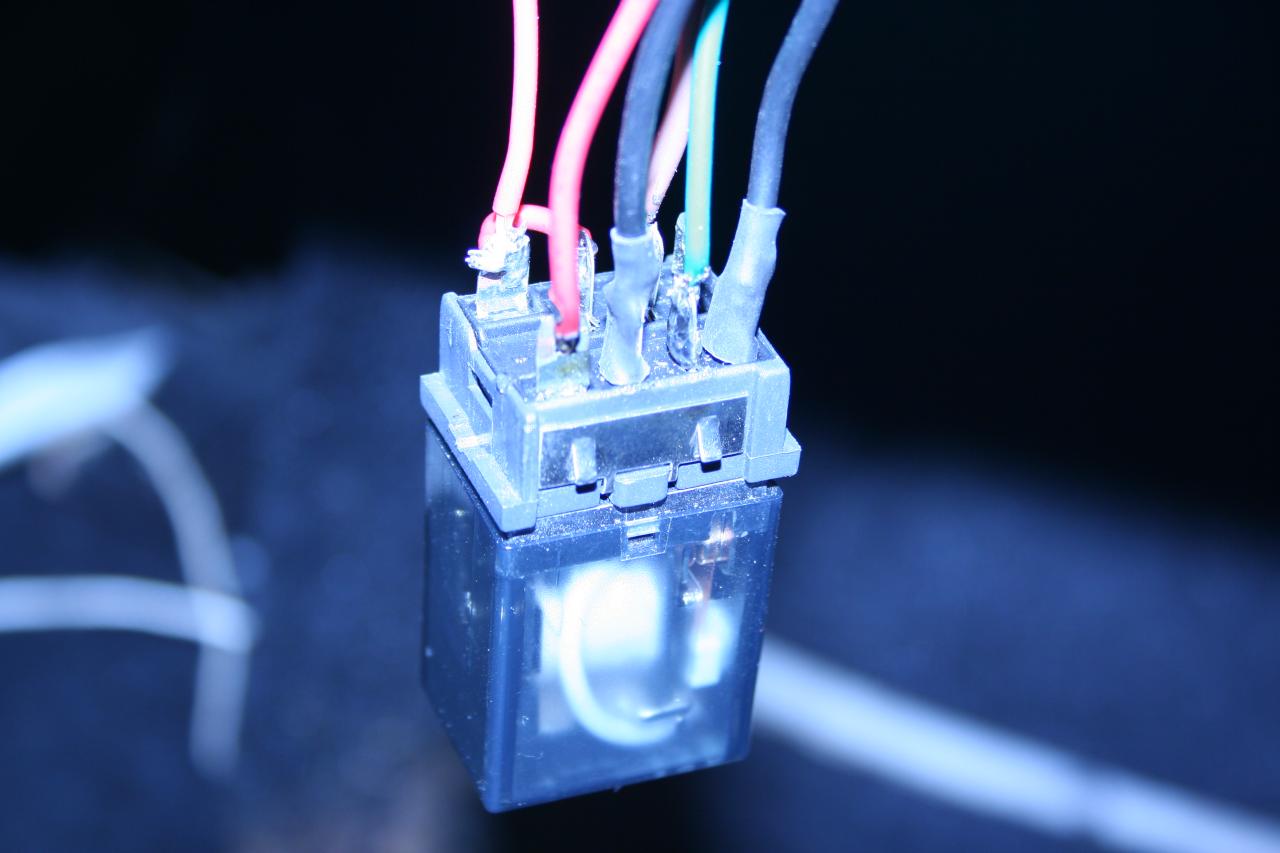

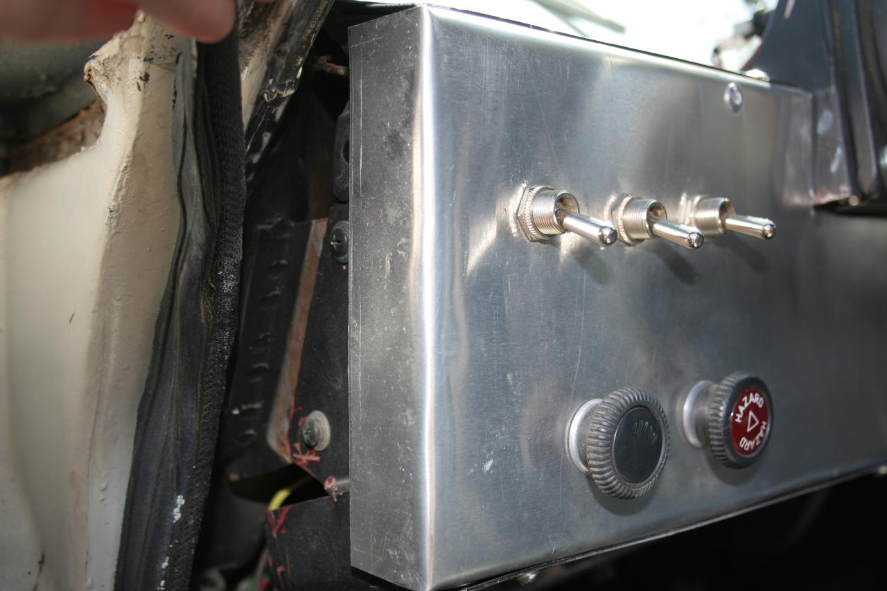

The ECU and starter are on toggle switches now, as well as the rear trunk solenoid. The headlights and flashers may be as well in the future. The top is riveted on and painted in a bad, half-assed coat of wrinkle finish black.... That's why it sucks when you need your project car for work.
There's no cover for the main gauge cluster right now. I tried to make that piece a couple times. It was a bitch and I needed my car, so I said, "I'll do that later." That was four months ago. lol
Mark D.
If you look closely, you can see some of the old framework in there.
Having the lower panel removable helps a lot when it comes to working on the mess of wires above it. As you can see, the aluminum has already had it's share of scratches. I'm thinking that later I'll move the fuse block to the far right, where the glove box used to be.

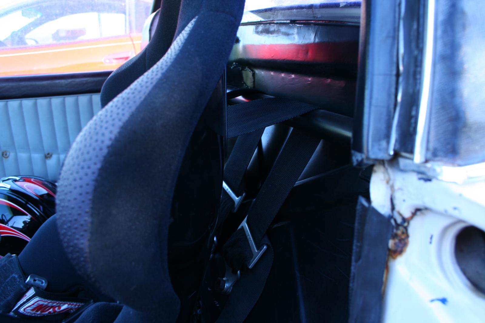

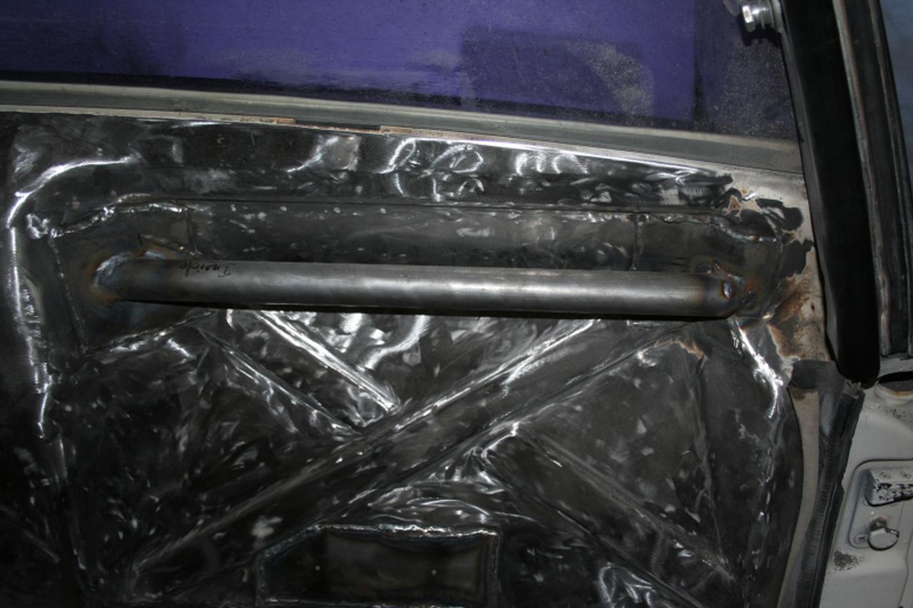

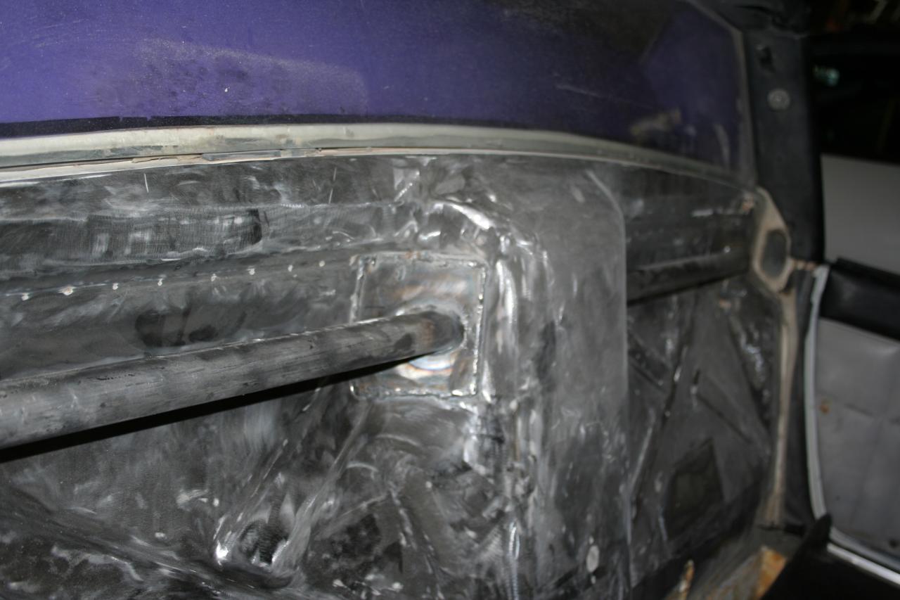

The next item is harnesses. This is the project that I'm working on right now... As you may have guessed, I'm not doing these projects in any meaningful order. I don't have the money for that. My buddy, who I build various race cars with, had a customer with some expired 5-point harnesses, and he offered them to me for free since he had no use for them anymore. They're functionally just fine, but the production dates are over 3 years. However, since I'm just doing autocrosses and weekend mountain attacks, that's fine. However, I did have to fab some harness bars and reinforce the mounting points on the firewall. I'll get all this done, and then when I'm ready to do full fledged, wheel to wheel racing, I'll just have to get new harnesses and bolt them in.
Driver's side assembly after striping the paint and glue off of the firewall.

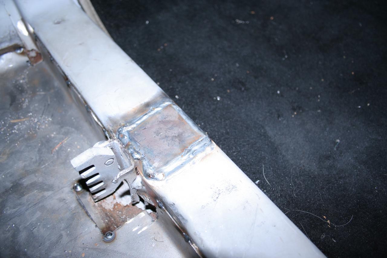

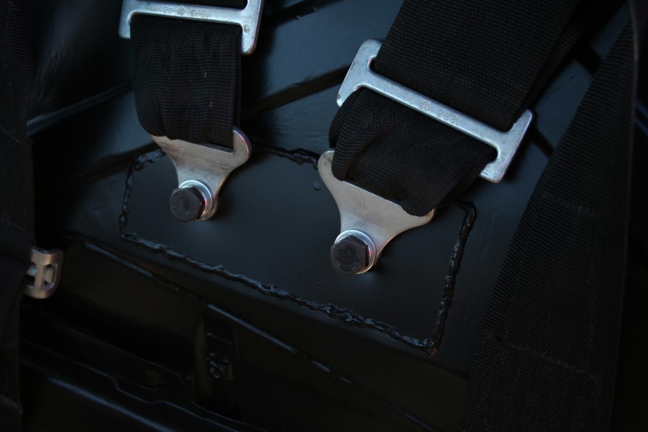

This is the reinforcement plate for the mounting point of the two shoulder belts on the passenger side. There will also be a plate on back side of the firewall when I'm done.
Mark D.

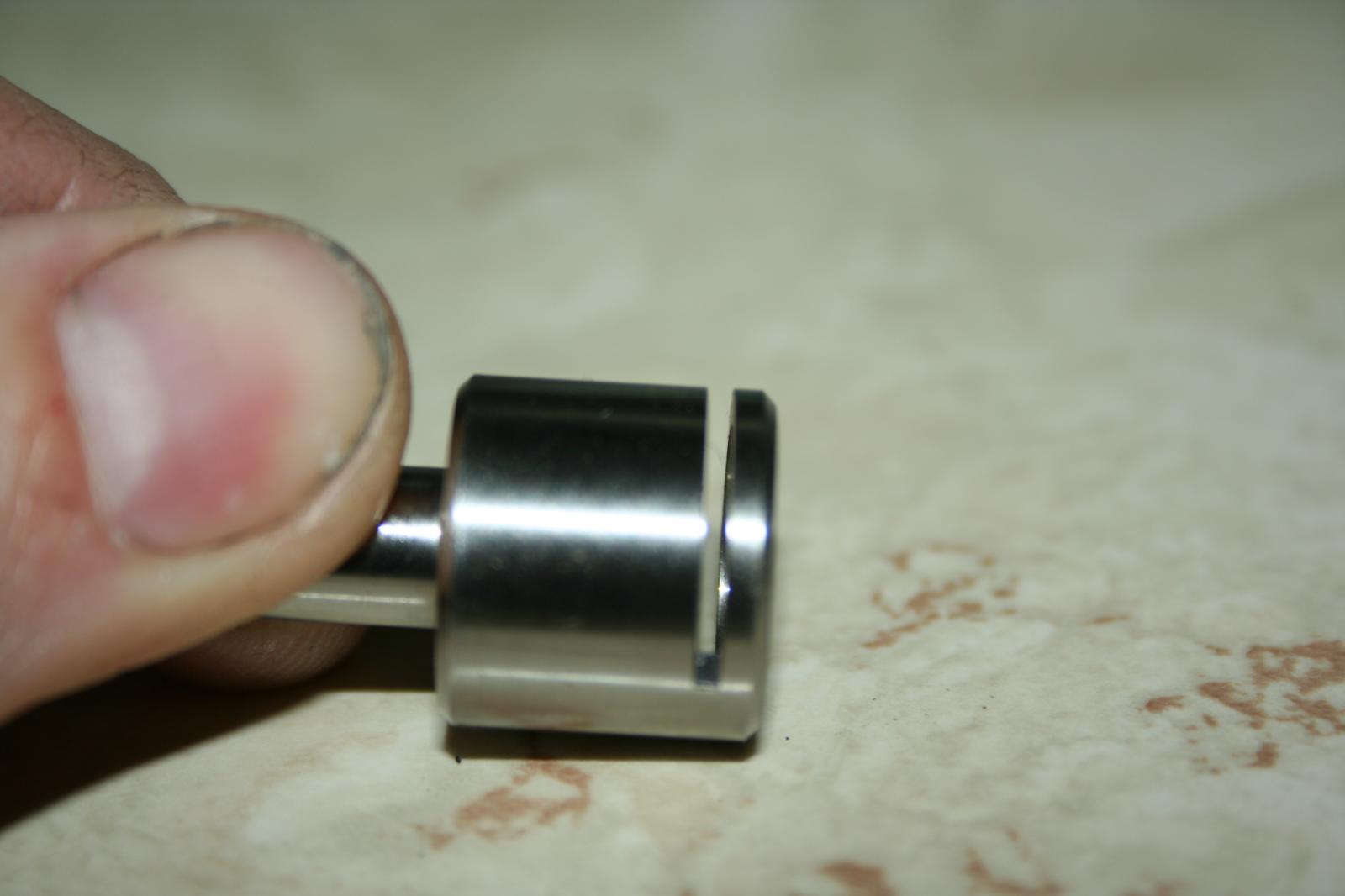

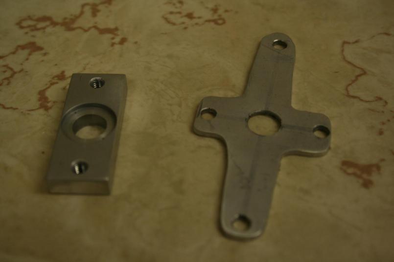

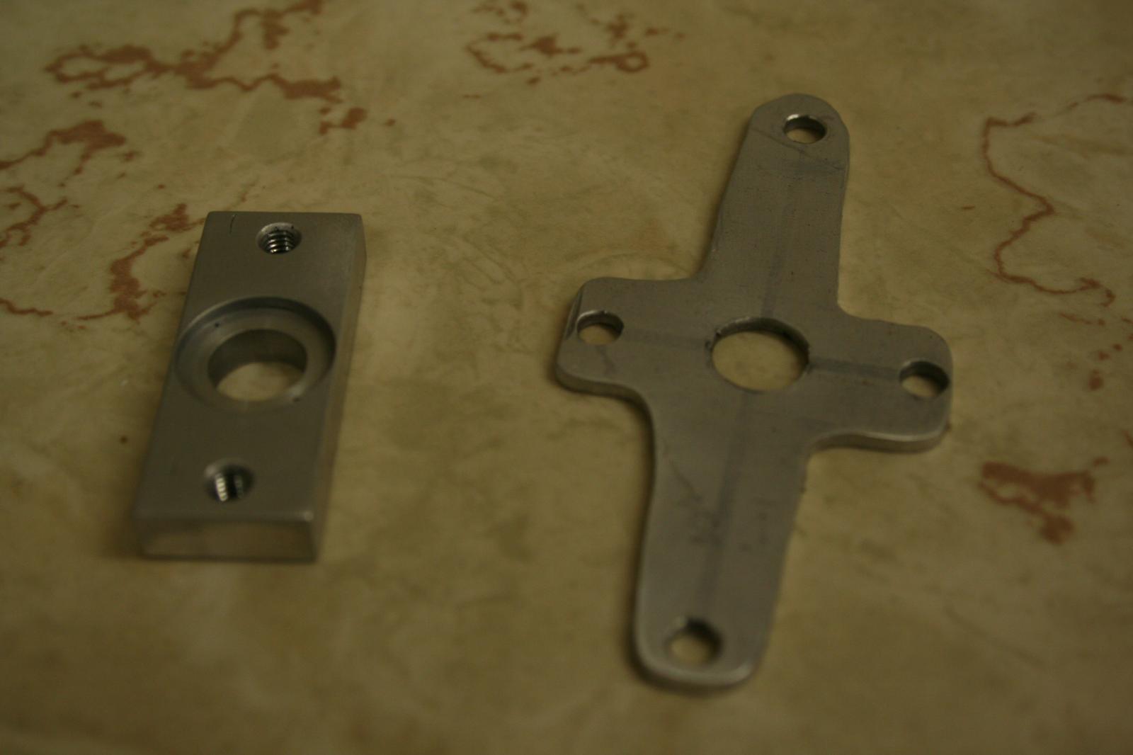

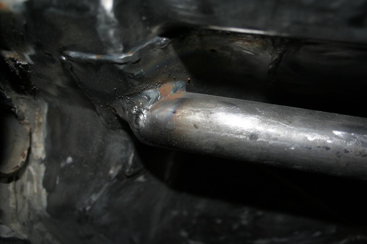

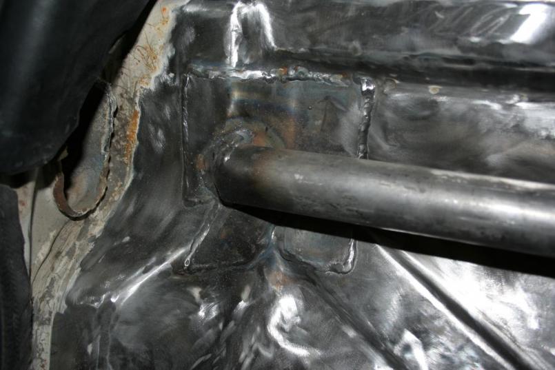

These little plates were fun to make. I made the driver's side first by taking a piece of cardboard and mapping the major folds and cuts. That way, I was able to flatten it back out to cut the flat pate before folding it. I did have to do some minor trimming to get the metal piece to fit the way I wanted. This is the passenger's side (obviously), and I just got that by mirroring it onto another piece of cardboard.
To get enough clearance for the harnesses between the bar and the firewall, the bar had to stick out in front of the angled area on the outside. To alleviate this issue, the angle for the firewall was cut through the tubing, and then the end was relief cut, bent to angle it in, and welded back together.
The inside was much more simple.
Again, all the welding was done by my bro.

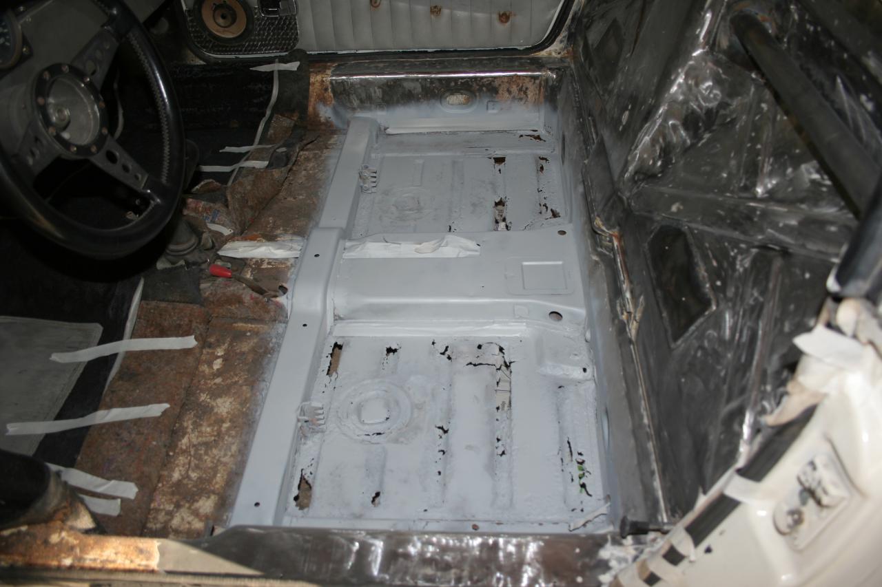

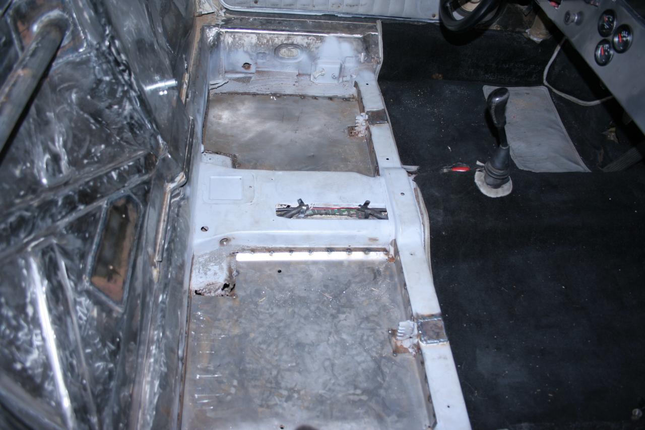

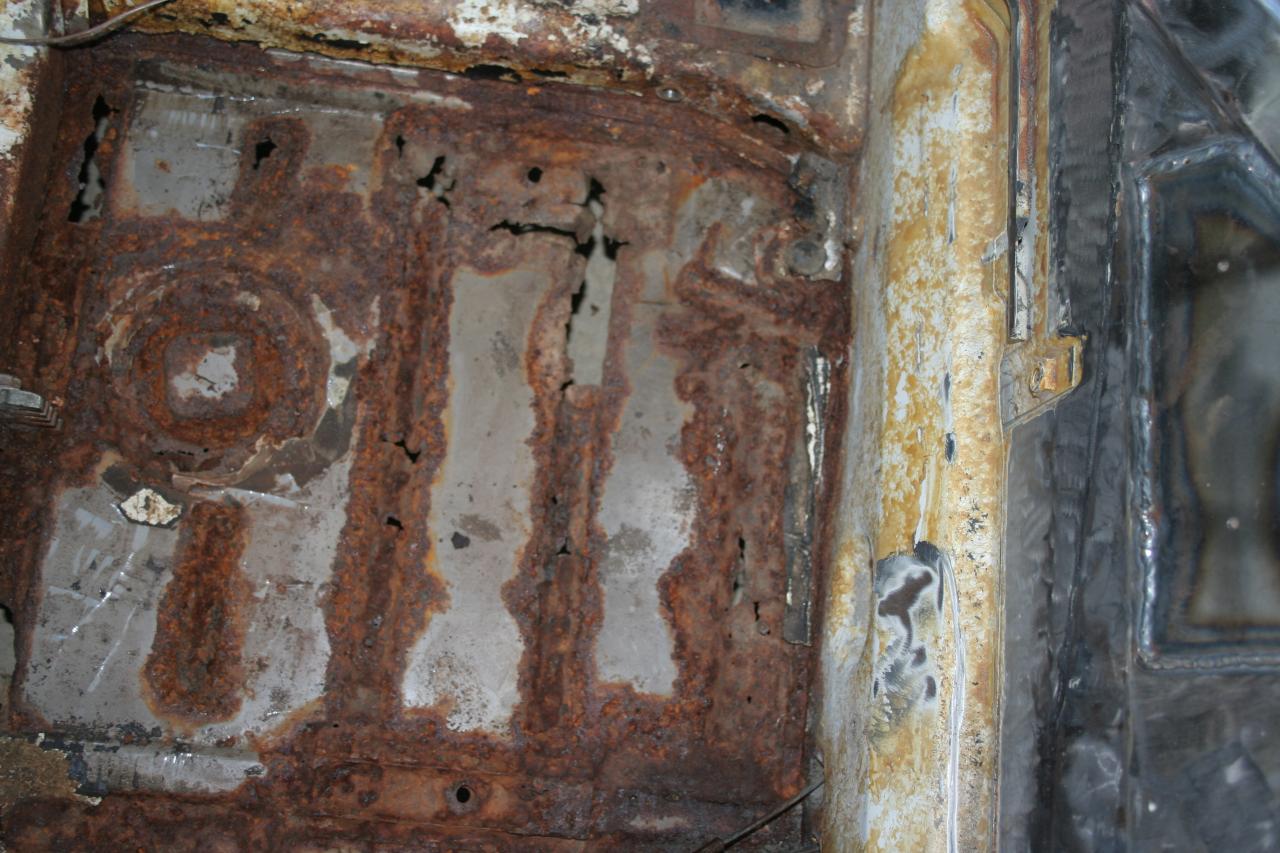

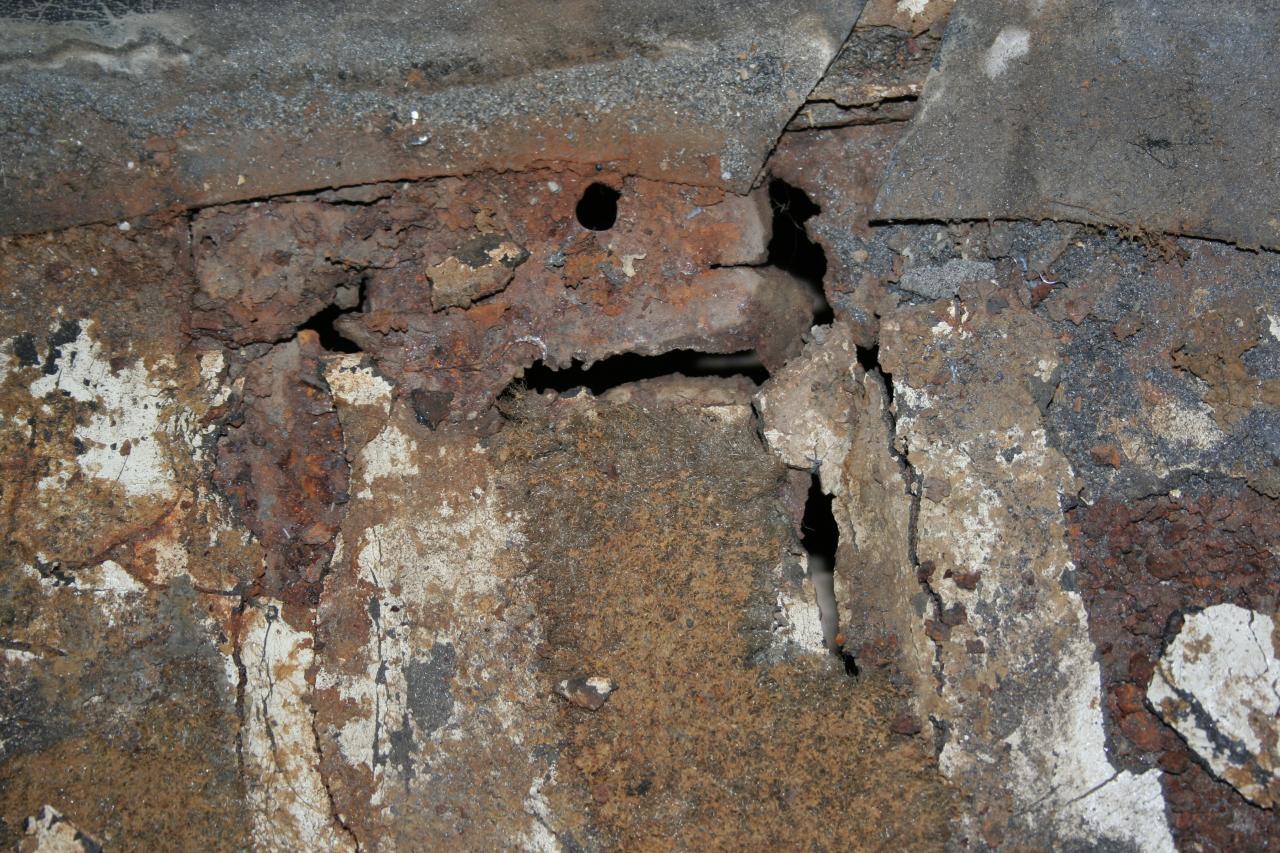

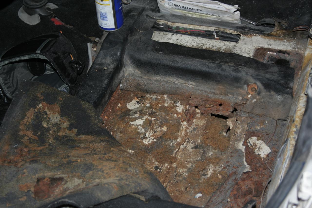

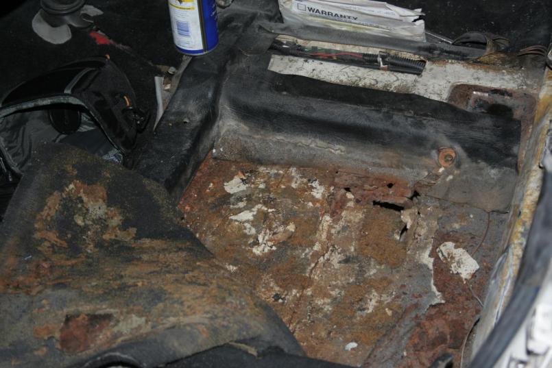

While trying to figure out how far down to paint, I decided I should look at the floor and see how bad it was. I knew there was some serious rust issues, but I wasn't sure how bad. Here's what I found.
Mark D.
After I stripped the rubber crap off.
I then cleaned it with a wire wheel and threw a coat of primer over the top to prevent any further rust.
Mark D.

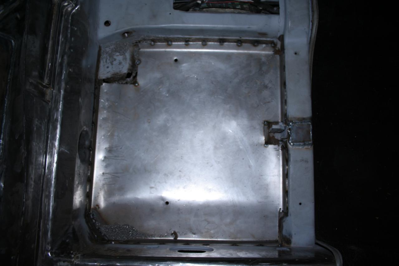

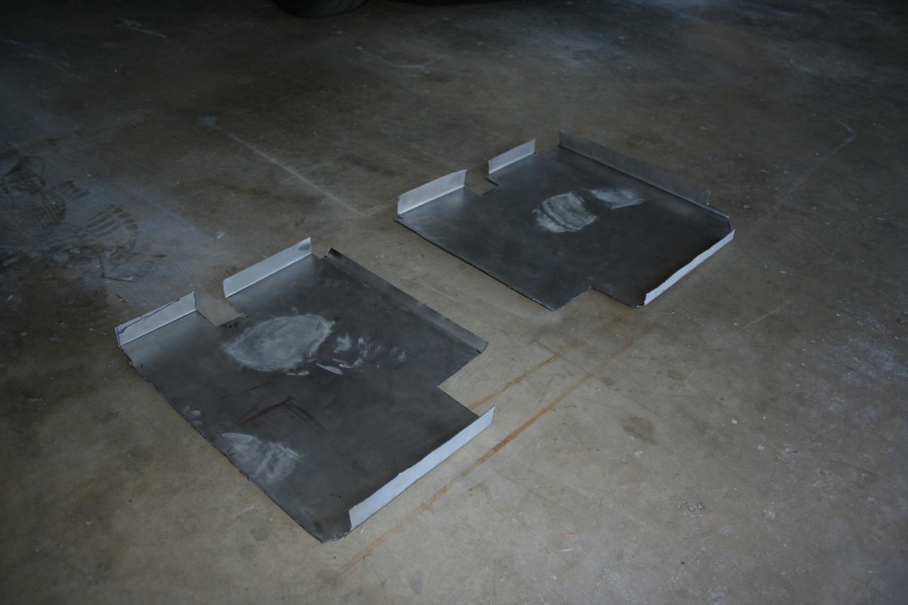

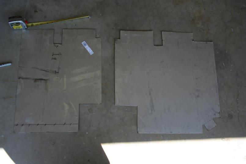

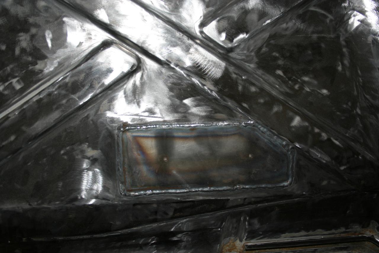

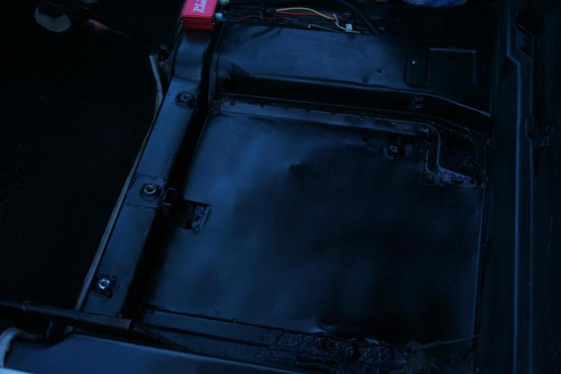

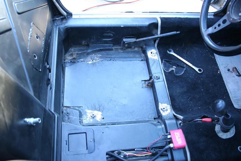

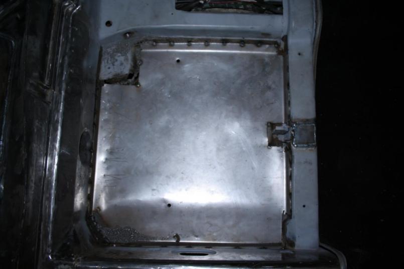

I decided to double it up by fabbing some new floorboards for now. When I do the complete tear down later, I'll probably put some of Restoration Design's floors in. However, I don't have the time or money to go into that kind of work right now, and this was a bit of an emergency. While working inside, I more than once put my foot through the passenger's side floor. These should hold for now.
Cut floor pieces waiting for the sheet metal break.
Bent and trimmed pieces with a layer of primer on the bottom. These are ready to weld in. Yes, those are my footprints on them.
Mark D.

i hope your seats have a belt hole in them.
or you are reaaaally short. Harnesses should be at your shoulder level, or a very small angle below your shoulder (10 degrees from what i recall)
if they have a steep angle upward toward your shoulders... and you crash. you will compress your spine....
The SCCA GCR calls out 20 degrees, which is approximately what I've got.

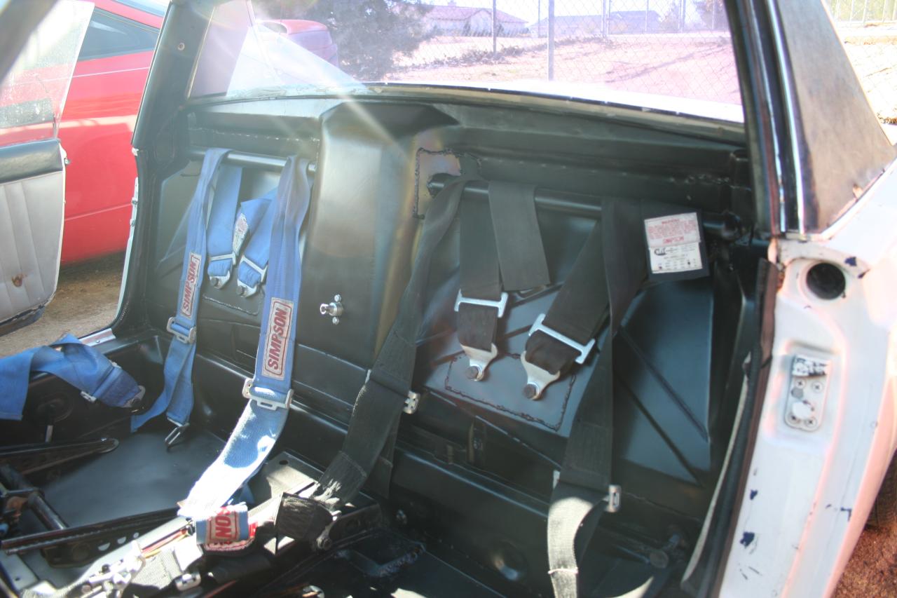

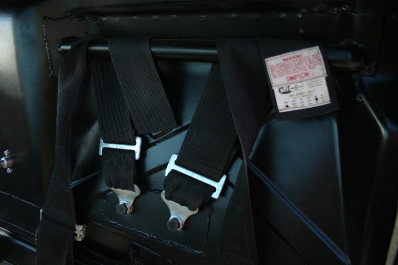

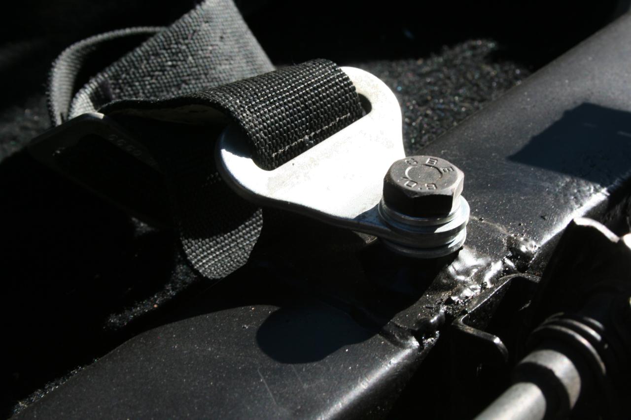

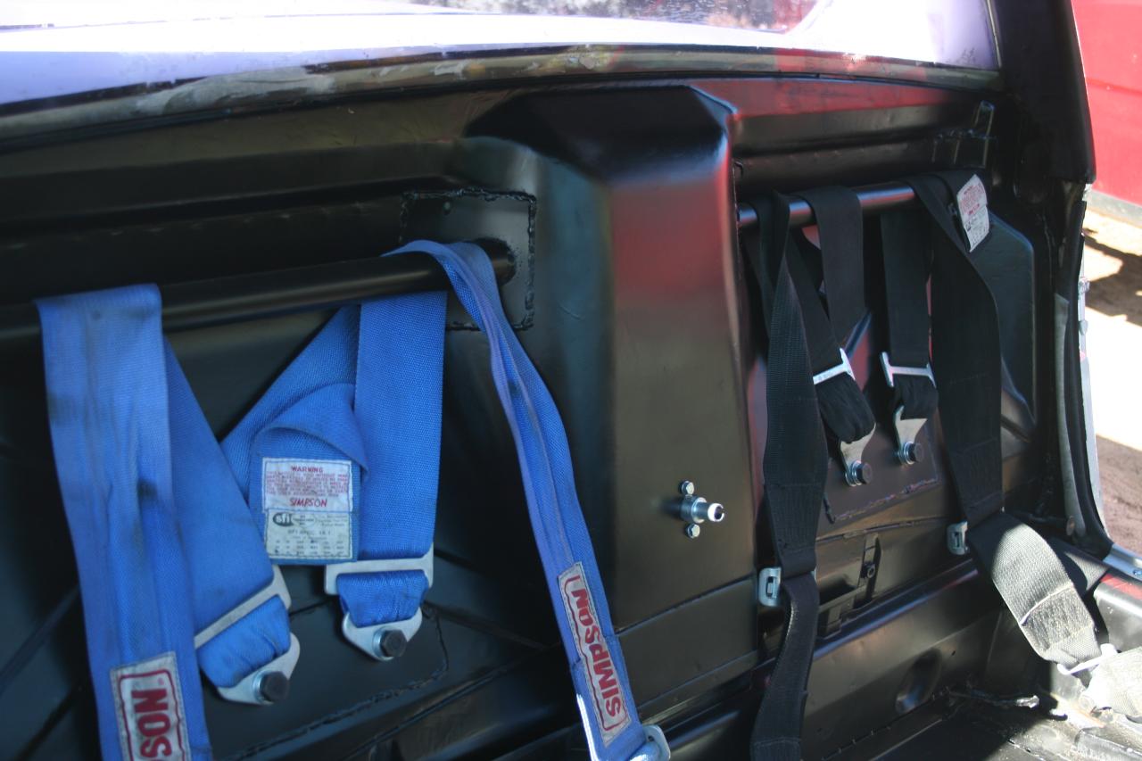

Now to actually mounting the harnesses. I made some plates for the anti-sub belt and had them welded to the frame bracing under the front edge of the seats. I was afraid it might be too far forward, but the geometry actually came out pretty good.
The reinforcement plates and metal under them were partially drilled with about a 1-1/4" drill to make a sort of chamfer. This was done in order to get weld engagement on both plates of metal.
Mark D.
The lap belts were done much the same as the anti-sub belts, but first I had to holesaw out the original bosses. At first, I wanted to just drill and tap the bosses to the size that I needed, but there wouldn't be enough metal left for thread engagement due to the existing threads. So instead, I took them out and welded in some Grade 12.9 nuts.
The holes were chamfered in the same way the anti-sub belts were.
Mark D.

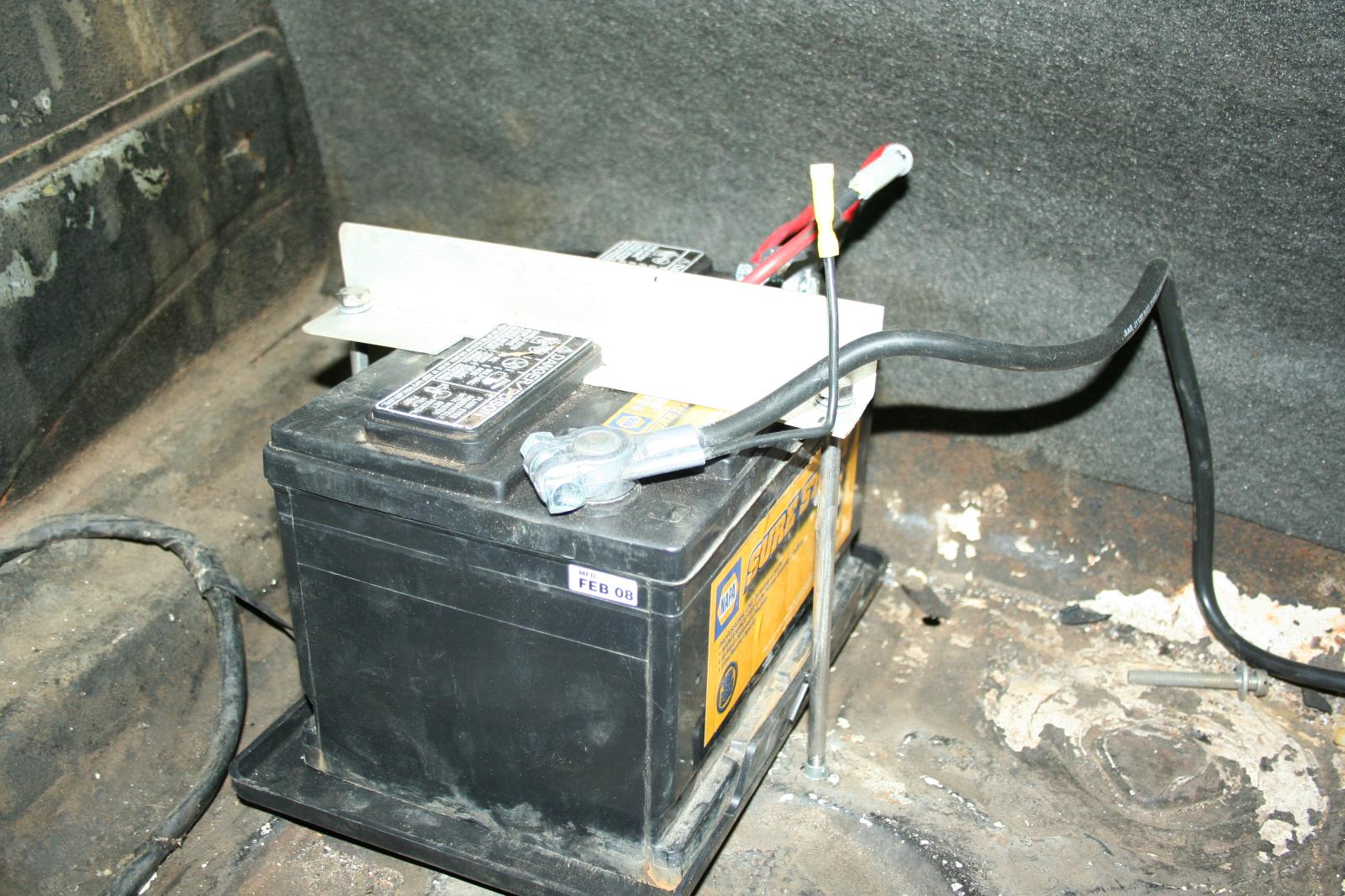

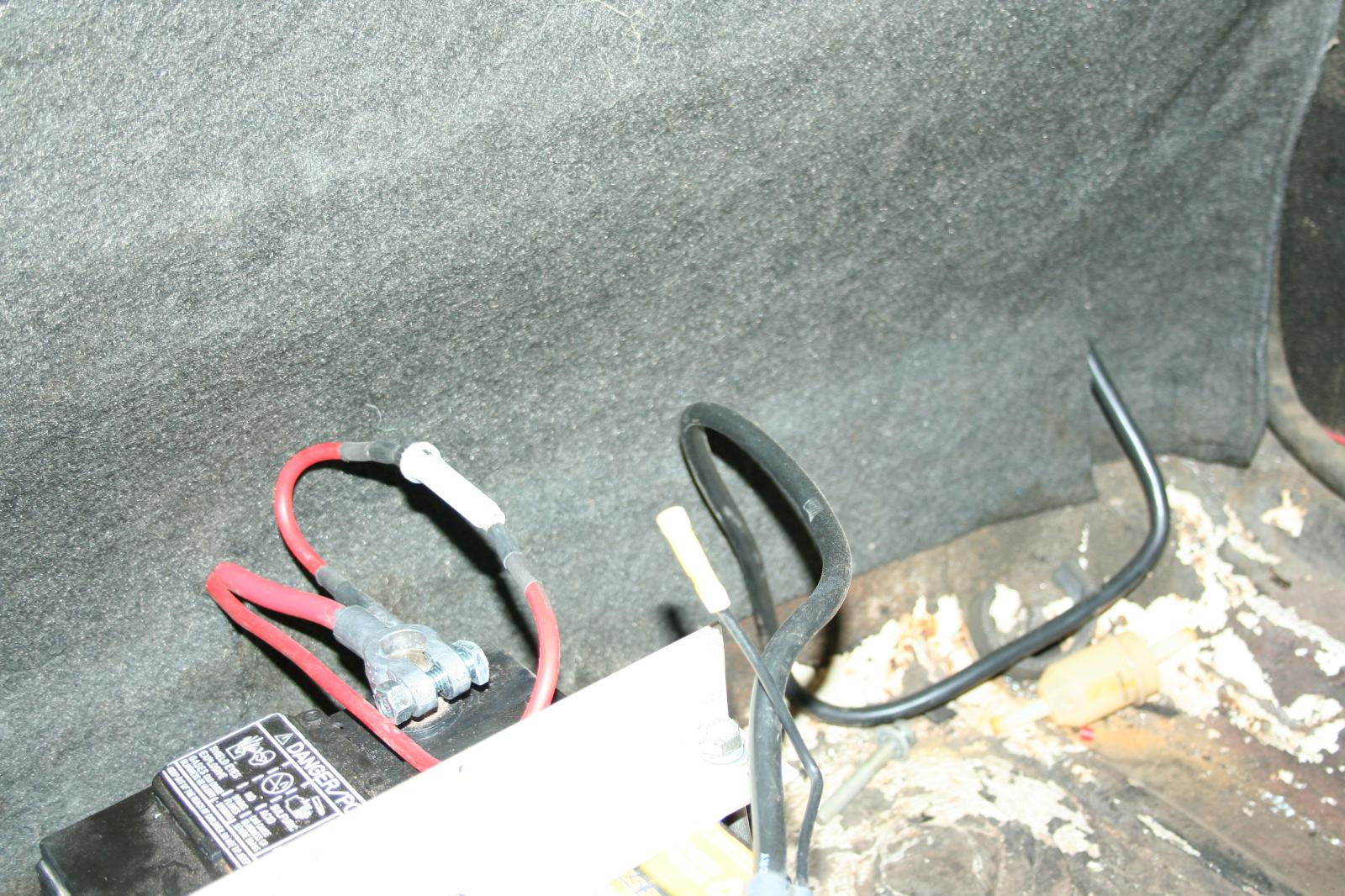

After that, I was ready to paint. These next few pictures were just taken today, and I didn't feel like removing the harnesses, but you get the idea. Rustolium Satin Black.
Notice the battery shut-off in the middle.

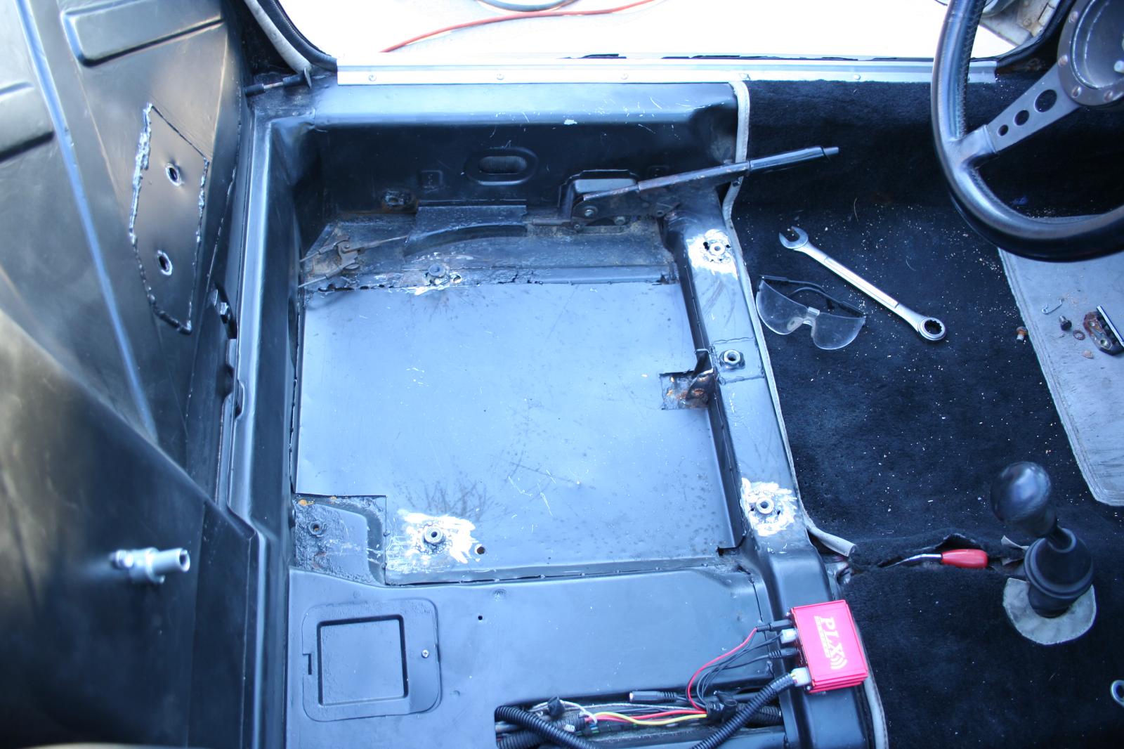

I know you just love how the stock seats are just bolted through the floor in the back. It's ghetto, I know, but the hinges were completely gone (probably rusted out), With no real metal left to weld in new ones. This'll work until I get some real race seats which will just be bolted in too.
Mark D.

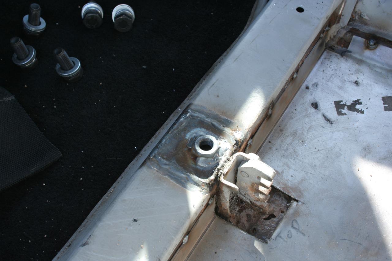

Grade 10.9 M12 X 1.5 bolts threaded into Grade 12.9 nuts, torqued to 85 ft/lbs with lock washers. Those aren't going anywhere. I don't particularly like the weight of all this hardware, but harnesses are one area you don't want to skimp on.
Ten minutes with a wire wheel and some new sheet metal screws does wonders on these little trim pieces.

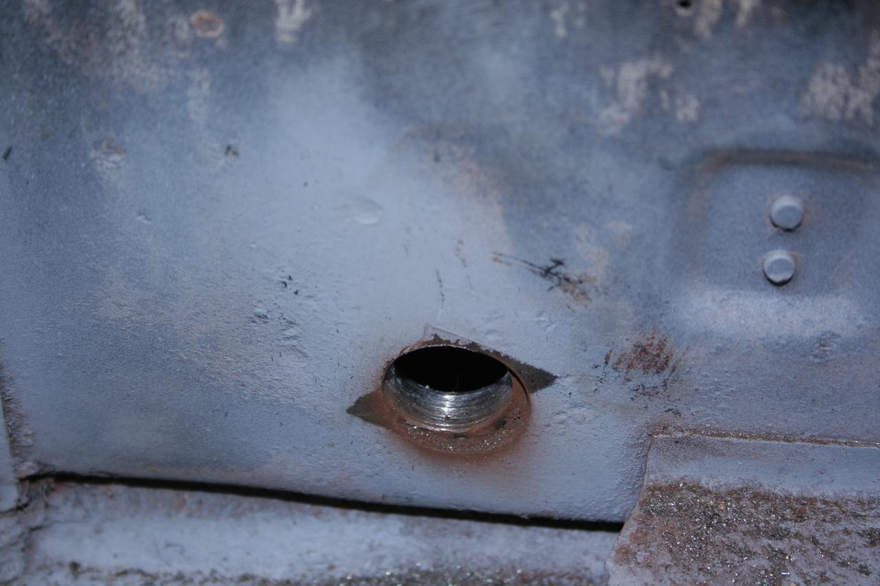

One little problem that I don't have a picture of: I got the bolts just a little long, and on the right side of the driver's lap belt, the bolt went through and interfered with the shift linkage. This prevented me from getting into 4th and 5th..... oops. Simple fix though. I cut the bolt down about 10 mm and it's fine, and it's still threaded completely through the nut.

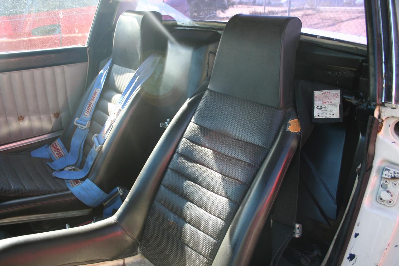

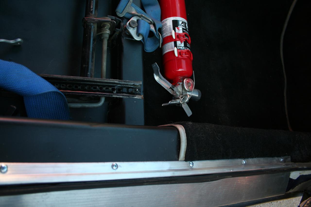

With the seats in:
I actually run without a seat cushion for more 'support' in the corners. My skinny ass allows me to get away with this. However, I would like to make some pads with a hole for the sub belt sometime.

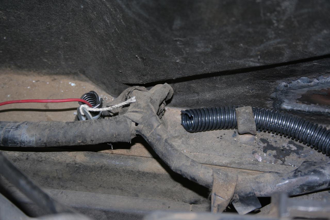

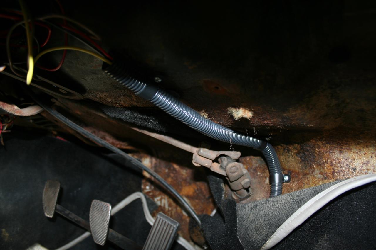

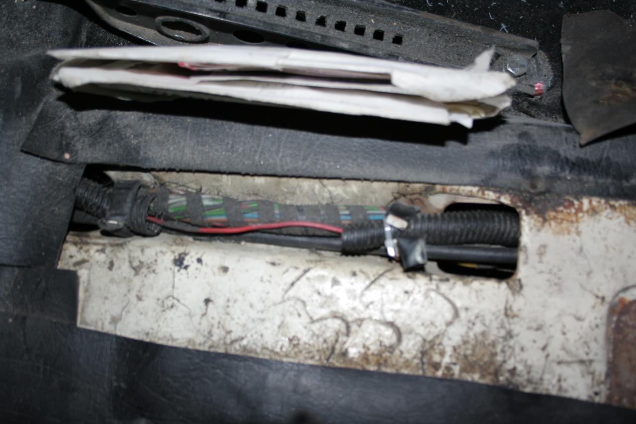

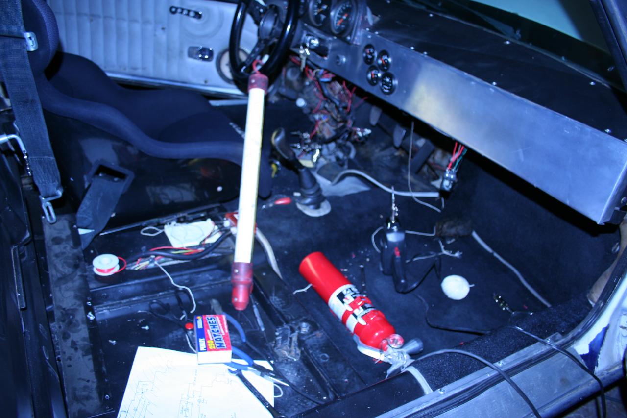

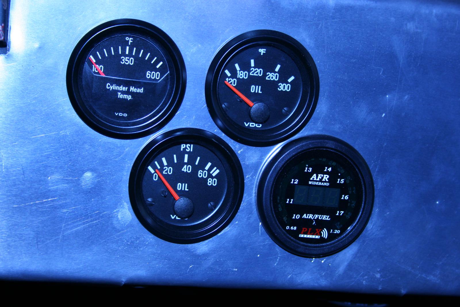

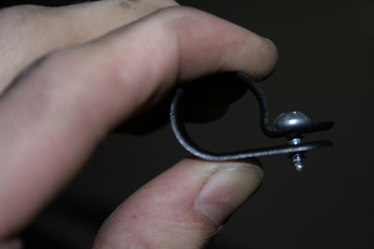

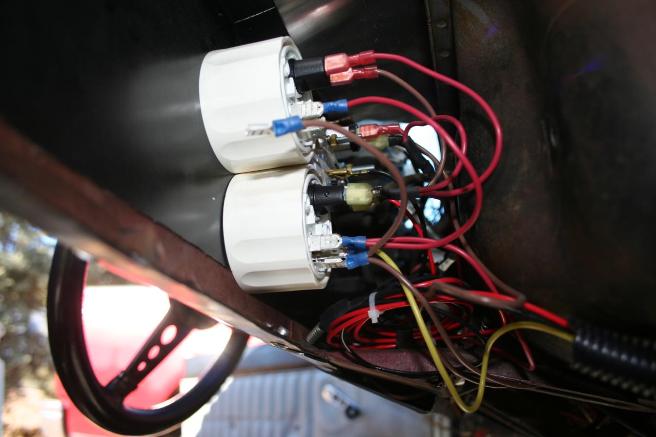

I've also been working on getting some gauges installed. The car originally had nothing but a tach, speedometer and fuel gauge.... well, and an oil pressure light. I bought a CHT, oil pressure, and oil temperature gauge from E-gauges.com, and have been gradually getting them wired up. It's not like I'm risking anything by taking my time as the car isn't even running right now. Anyways, the first thing I had to do was run some loom material under the front section of the tunnel. I actually did this a while ago when the PO's shitty wiring (under the trim piece on the longs) decided to short itself on a screw and melt the carpet.

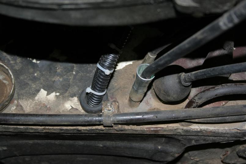

I ran a fisher through the path that I wanted the loom material to go, while pulling a string along behind it (from back to front). I then poked a couple holes through the material, tied the string through those holes, and greased up the piece I was pulling through. It actually came through pretty easily. I then sent the fisher down the loom material and pulled a string through. The string is double the length of the loom piece with a washer on both ends, and it just stays in there so it's easy to pull wires when I need to.
Simple pic. Note that this is before I got the interior repainted.
As you can see, I split the loom material where it comes up for air between the seats for accessibility. The back section was done with a hole saw and some rubber grommets from NAPA. I strung it up the same way to help me fish wire.
Through the firewall:...
Mark D.

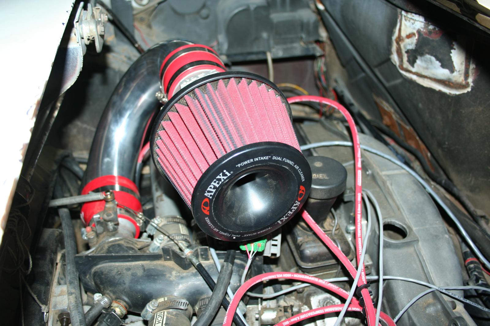

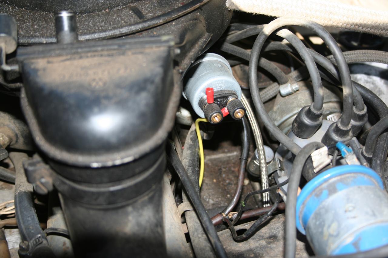

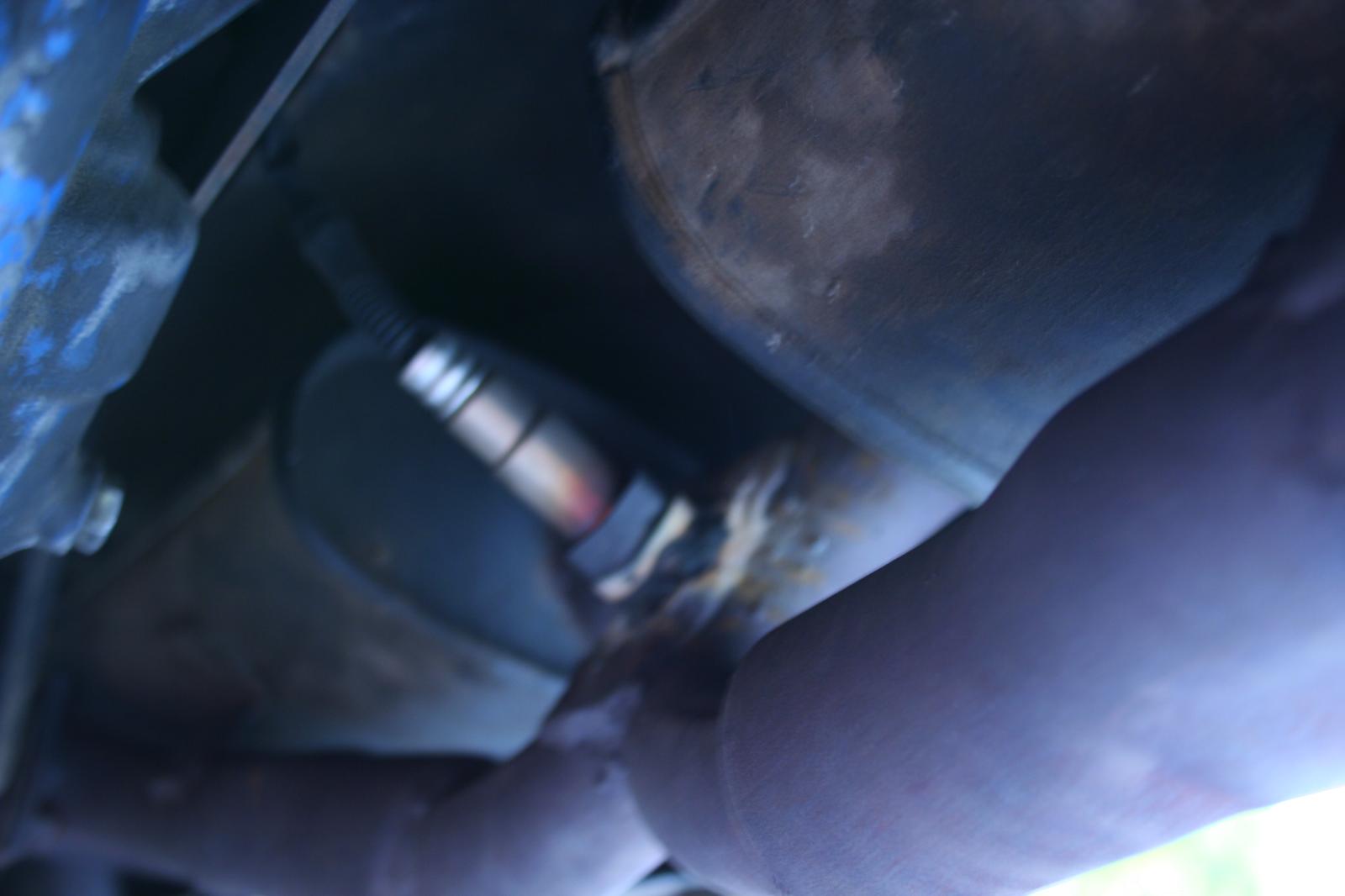

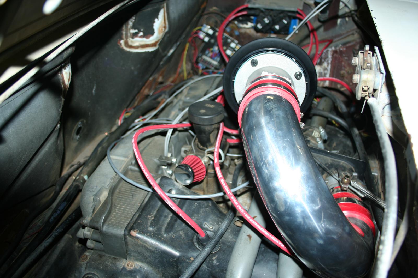

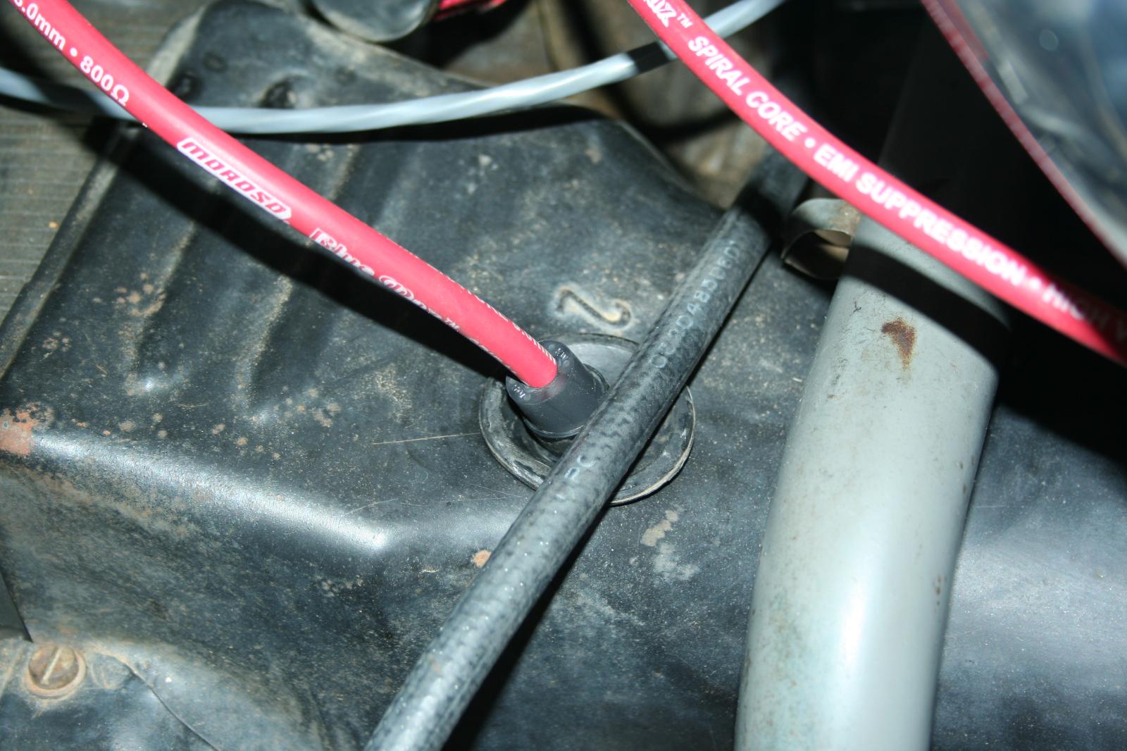

The last little section back to the CHT sensor (on cylinder #3) and the oil pressure sensor was attached using nylon Adelish Clamps.
I'm ashamed of my dirty engine compartment.
Mark D.

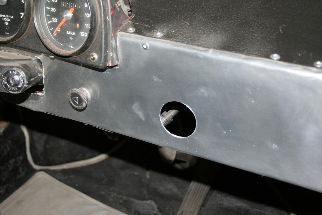

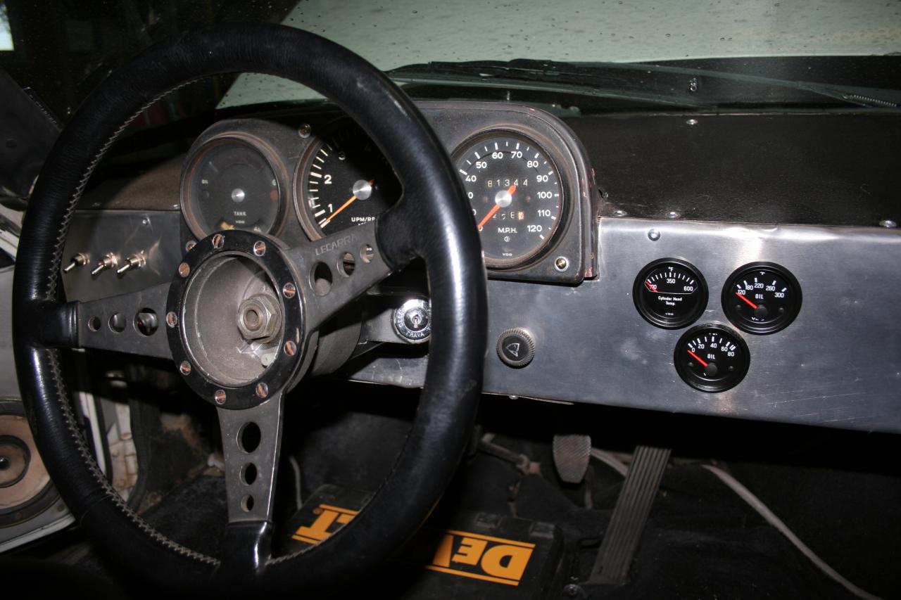

Now for the scary part; cutting giant holes in my hand-fabbed dash. In actuality it went very smoothly. Nobody that I found makes a 2-1/16" holesaw, but a 2" and some massaging with a rotary file worked just fine.
How do you like my Dewalt floor mat?
Mark D.
I don't yet have the Oil Temp sensor in, but the others work just fine. The power is daisy-chained from the 8th terminal on the fuse box, and the lights from the 7th terminal. I don't know if this is technically correct, but the PO seems to have the changed the wiring all around. The ground is run to the bolt on the lower brace of the dash. Everything seems to work like it should without catching on fire or repeatedly blowing fuses, so I'm happy enough with it.
Loom up from the tunnel. There will be more wires there later.
Tight fit back there.
Mark D.

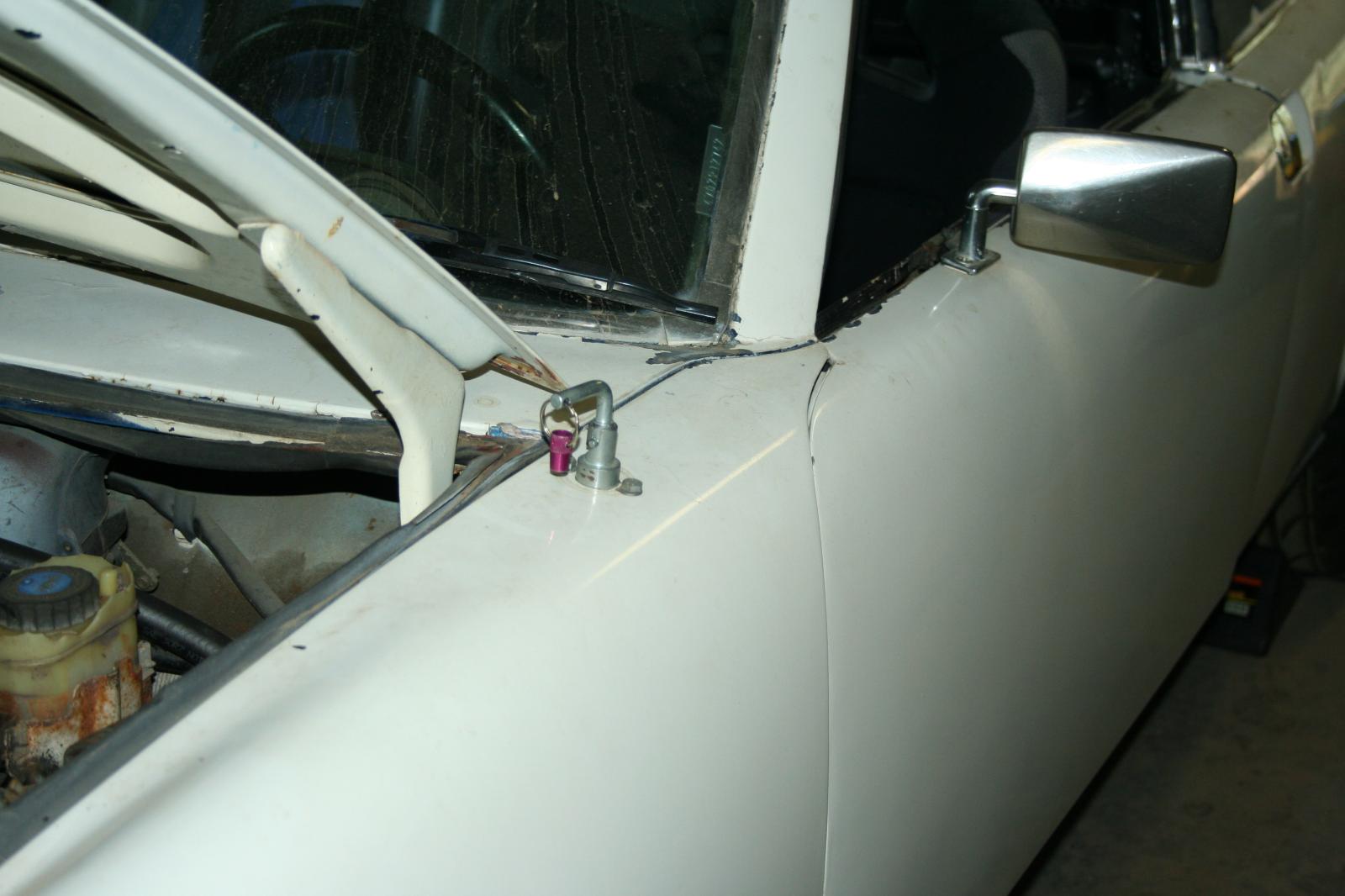

Oil pressure sensor mounted VIA adel clamp on the air filter bracket.
Random picture of the afore mentioned battery shutoff.

Depending on who/what/where group you're going to run with, you may have a problem with your seat/harness set up. For PCA DEs, it's illegal. Some regions (most, I would think) are also going to enforce the new rule for AX.
In a nutshell: Your harnesses must run thru slots in the seats (at the shoulders & sub belts).
RTRB.
The stock seat w/o cushion works great. I have a neoprene cover for the bottom of my bare-bones seat.
JP,
What if he were to weld up some "hoops" on top of the bar for the belts to go thru?
It seems that would provide the desired belt location and stability.(?)
I'm not familiar with their rules though.......
Yeah, I was supposed to get some sport seats(with harness hoops) before I got the stockers that are in there now, but they turned out to be unavailable by the time I got there. Good info, though. I'll talk to Mugs and see what he thinks, as the next event I will HOPEFULLY be able to make will be the GPX AX at Streets of Willow. In the meantime, I'm keeping my eyes peeled for cheap race seats.
Mark D.
yeah i have got a kirkey seat i love it, it'l keep u in fornt on the wheel in agresive corners, though after an hour your all will hurt. good luck on the car its looking great!
Updates: They are many actually. I'm pushing pretty hard to be ready for the 914 Shootout in August. That's three and a half months away and I need to rebuild the motor(already started), build a front swaybar, replace the rear springs, and build some headers (can't afford to buy them). After the motor is built I need to break it in and remap the D-jet. The new job is giving be a better budget to work with, but finding the time to do the work is more difficult. Even so, the budget will still be tight, since I also need to buy a helmet.
Below are some pics of what I was doing the last couple days at school. It's obvious that this was done by a machining STUDENT, but I'm happy none the less. 12 pounds is heavier than I wanted to start with, but I couldn't run the CNC milling program I wanted to, so I had to chop it the old-school way on a manual lathe. Gotta love cutting that good-ol' German steel!
Mark D.
John and I share a DE car.
We read and reread the rules and ended up buying a pair of race seats for the 914.
Our home made seats were better.
I made them buy stripping them down to the fiberglass bucket, cutting holes for the harness straps, lap belts and anti-sub belt. I then built up the bolsters with fiberglass, many layers thick. They were really strong, and the stock seat bottom sits down between the slider rails, so your but is down about even with the rails, and you have more head clearance.
We probably should have gone to the DE and argued, but all you need is one guy who cannot do anything but "his best" and interpreting what the rules say, and they say "racing seat, with openings for the harness built into the seat by the manufacturer", not one word about "home made" or "custom made".
I think these home made seats should have passed any inspection, but then it is not worth the risk of spending the money to register, to take off work, to drive to a track only to be sent home....so new "manufactured" race seats...gripe gripe etc.

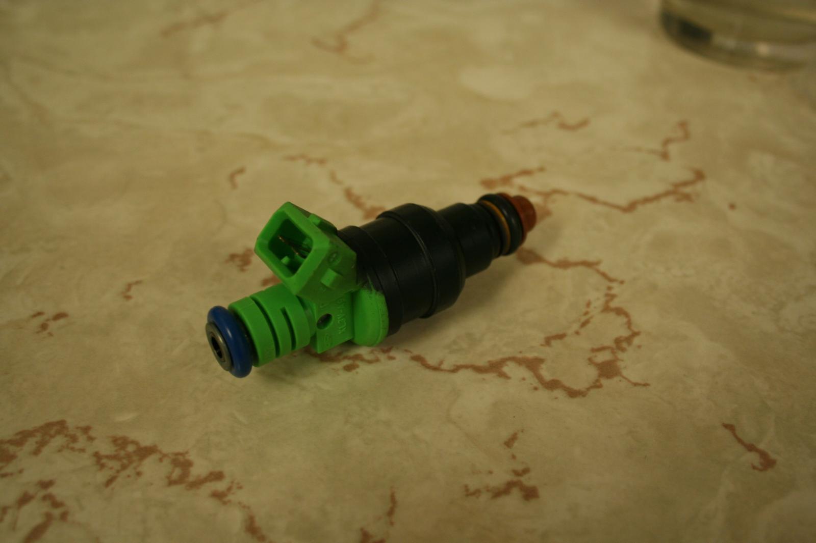

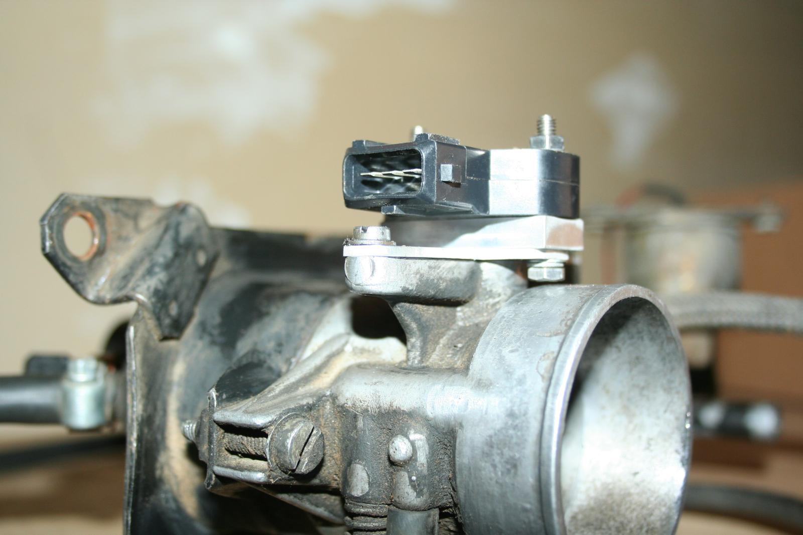

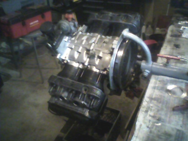

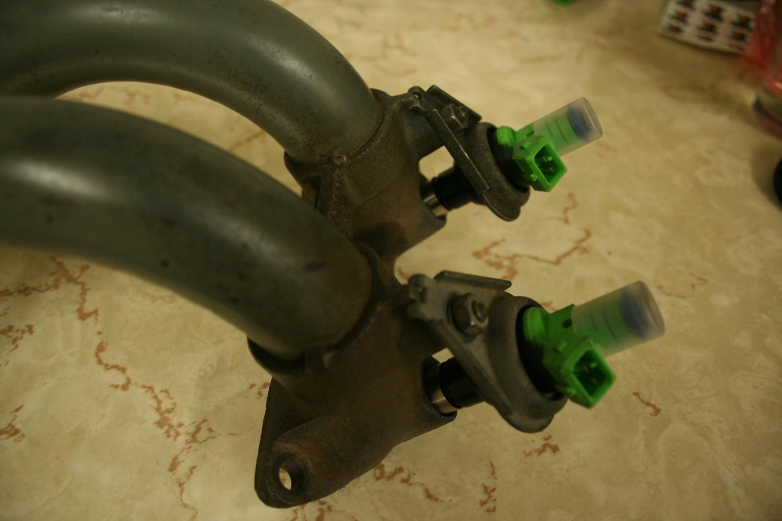

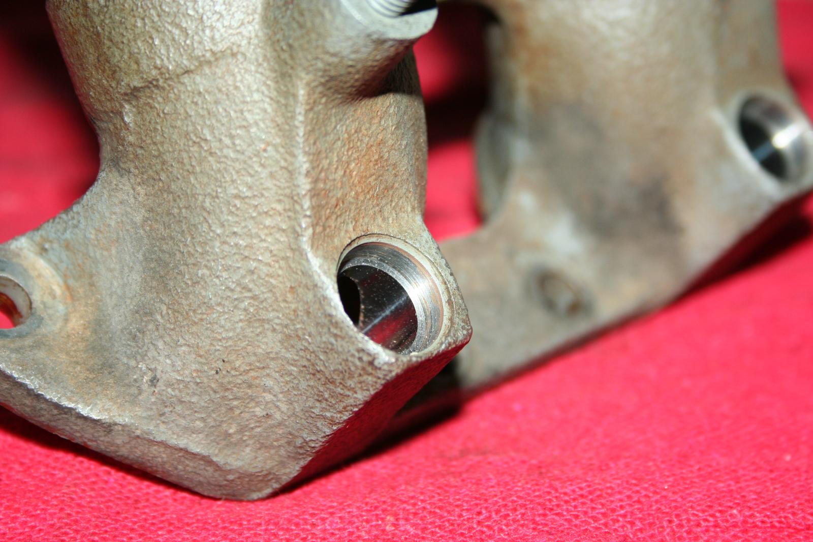

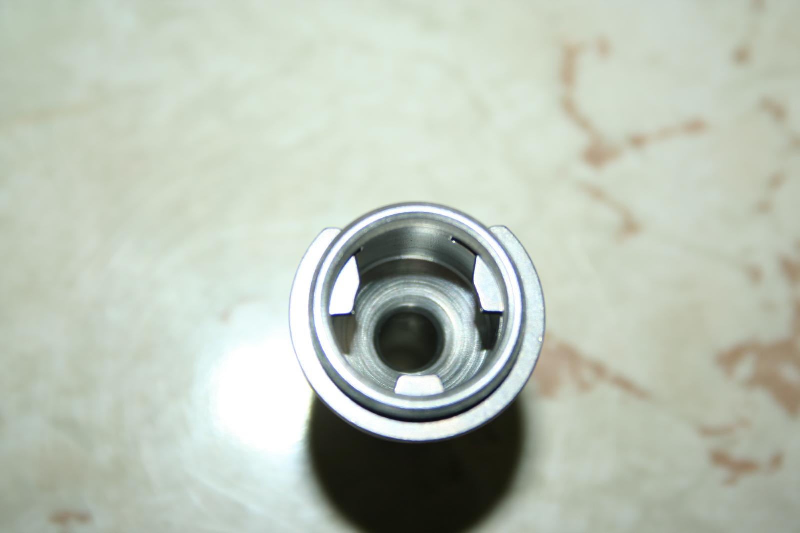

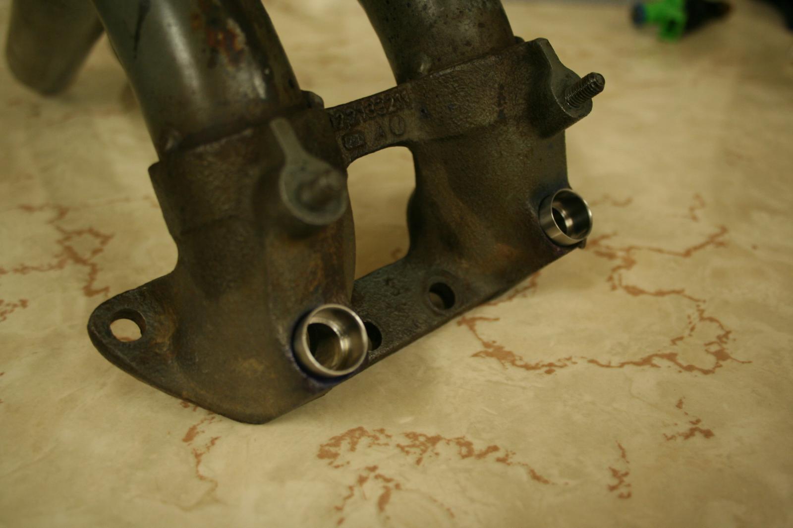

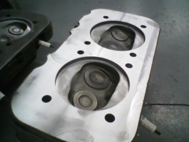

Well, I haven't posted anything in a while because I've been building an engine. This was my first engine and I think it turned out alright. I won't bore you with a lot of pictures of a stocker, mostly because I didn't think to take any! This was a budget rebuild due to the fact that I wasn't ready to do this yet. I just lost compression in one cylinder late last year and it needed to be done.

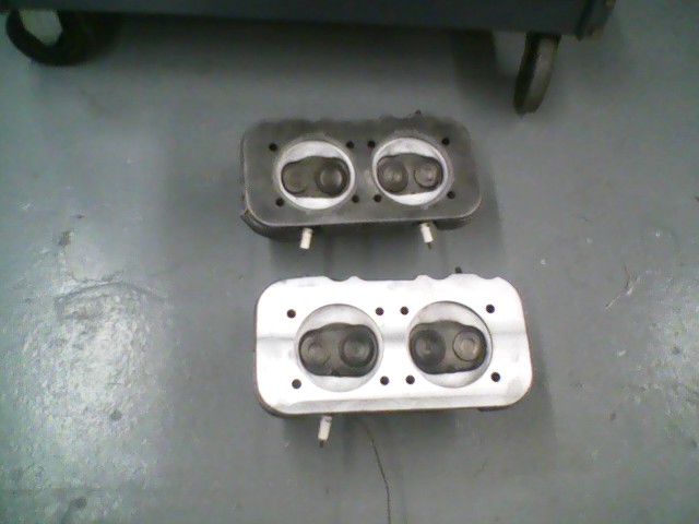

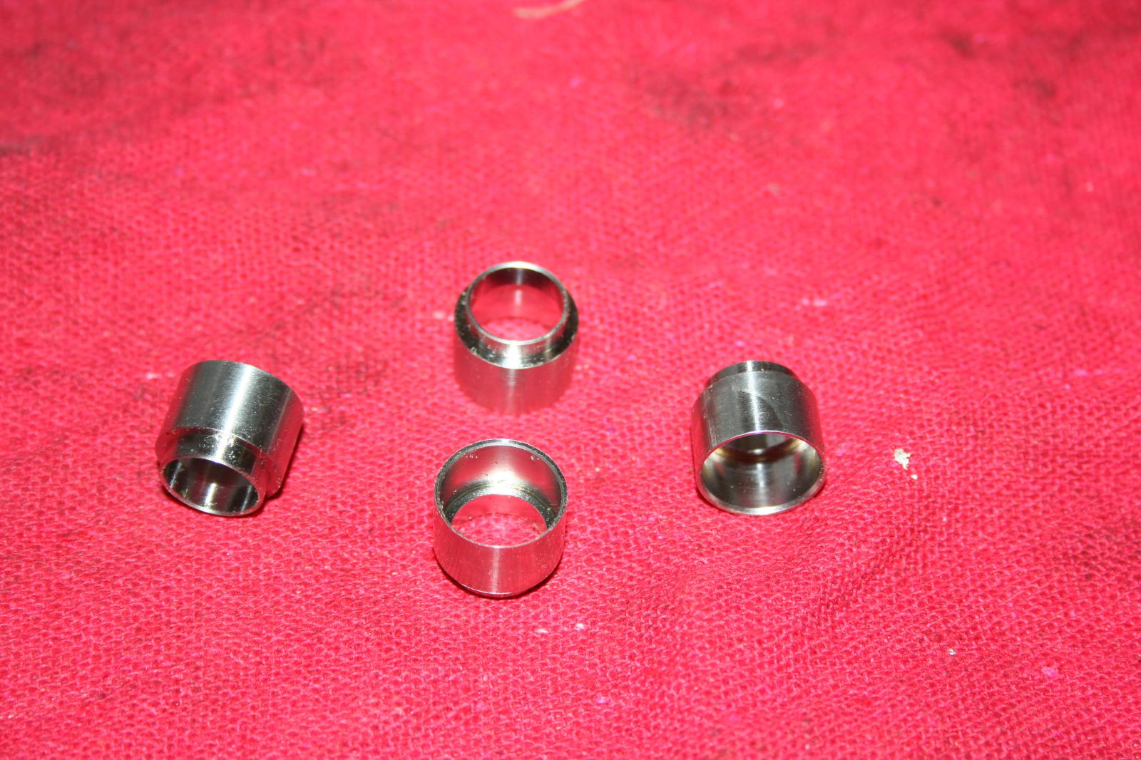

It's not totally stock. I machined the combustion chambers down to 45 ccs putting the compression at about 9.4:1. I did this because I got into the motor and found that one side had been machined and the other hadn't! So I wrote a quick CNC program at school to interpolate the pockets and just changed the offsets to get my proper depth. I just took a couple thousandths to clean up the side that had been done already, but I had to take .062" on the other side to match it. I got all the combustion chambers equal within 1cc without having my CC kit there with me, so I was pretty happy with that. I also had to face cut the underside of the heads in order to clear the shoulder on the cylinders. Fuzzy cell phone pics to follow.

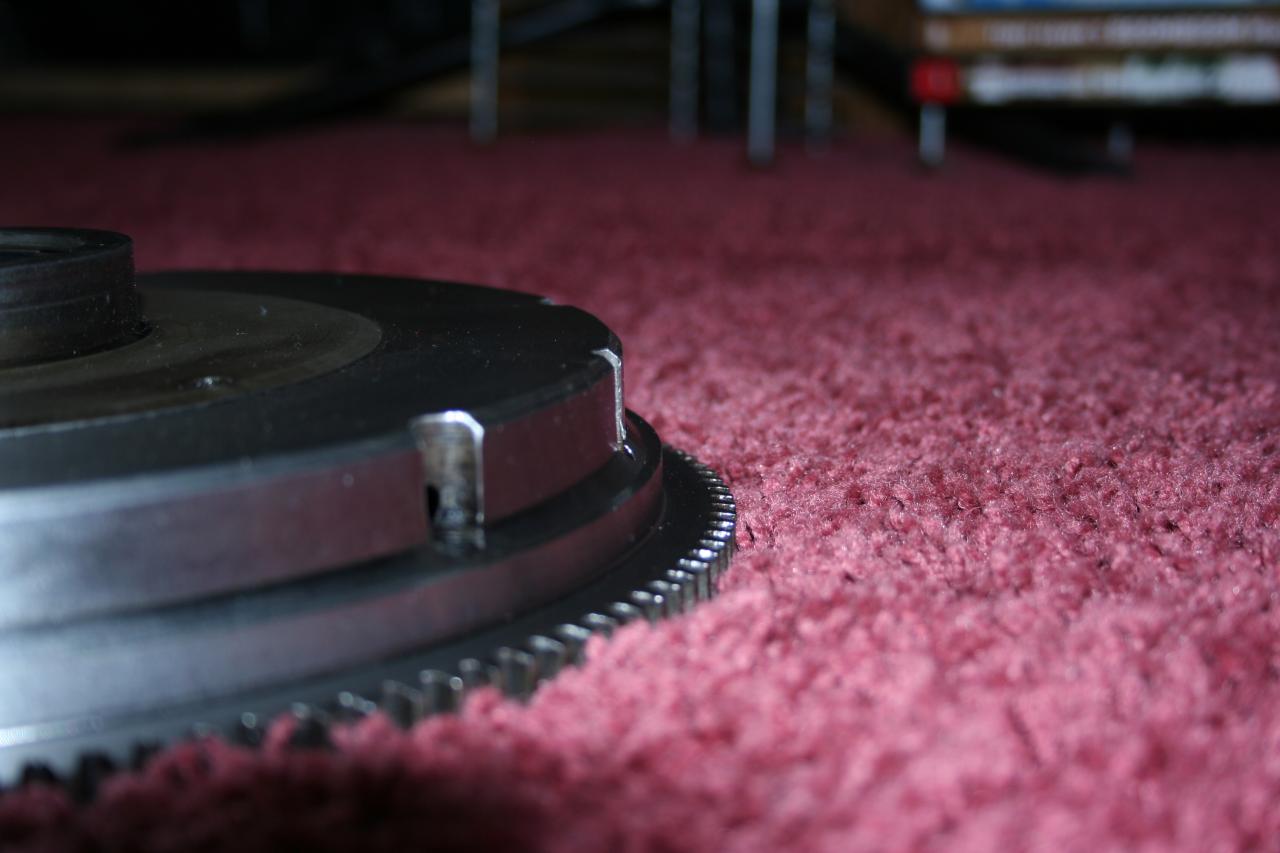

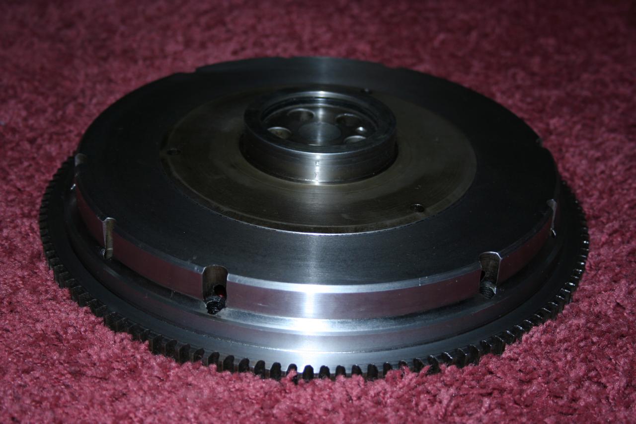

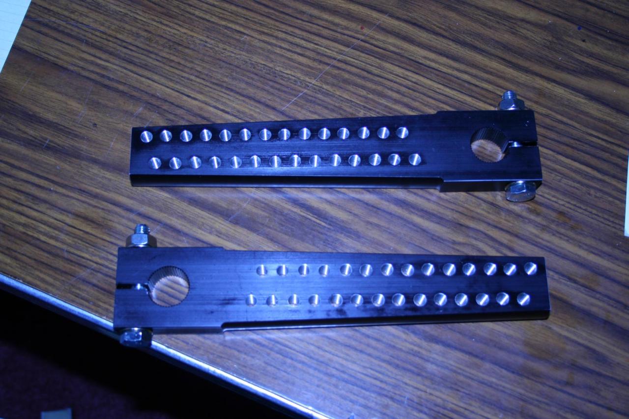

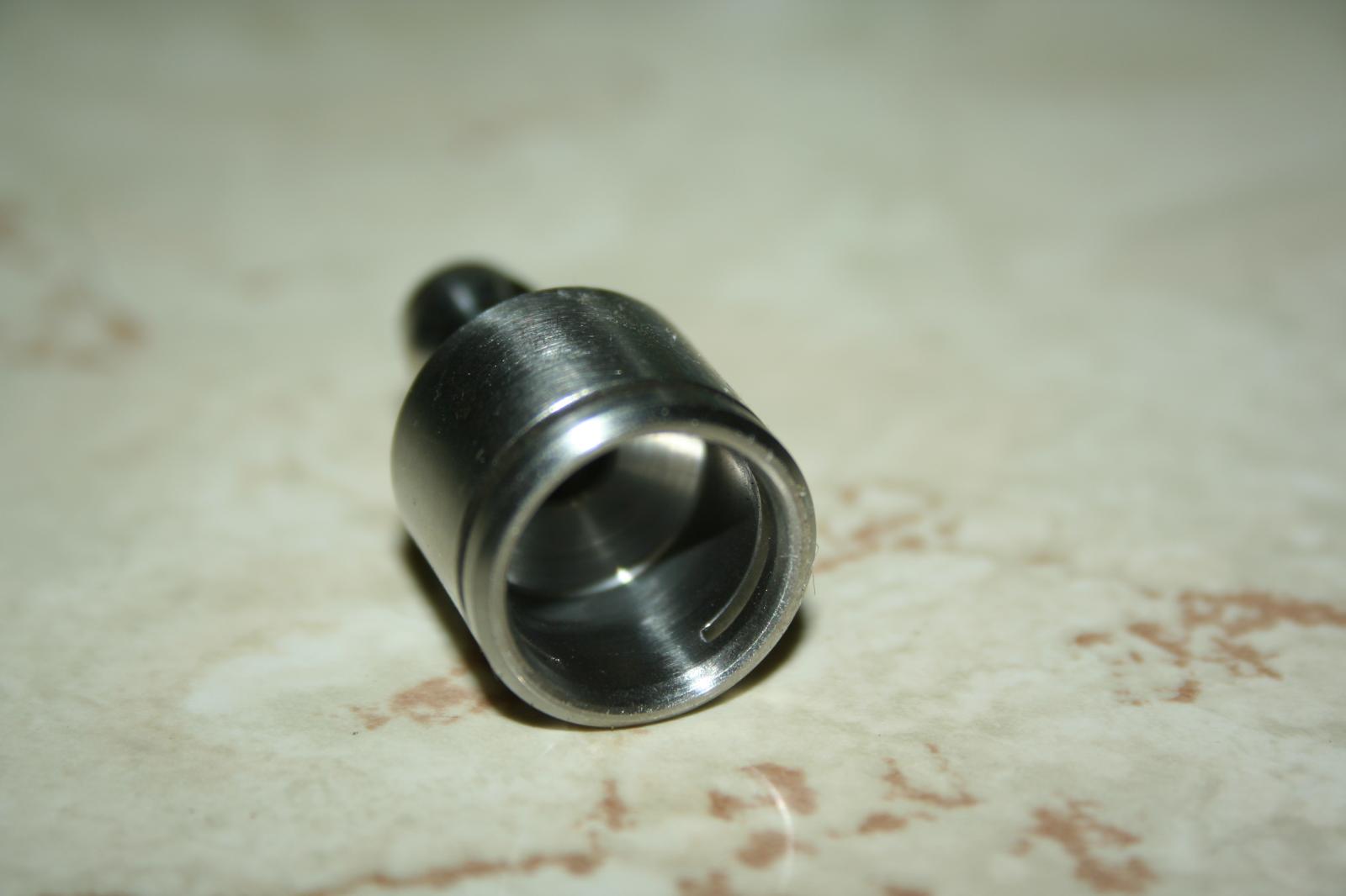

I also lightened my flywheel to 12 pounds on a manual lathe(pics already up). I wanted to use a CNC mill with a program that I made in Mastercam to cut a lot more off, but I wasn't able to use the mill for that job. So I did it the oldschool way.
I used a 440MP camshaft from Fat Performance with heavy duty T1 springs and strait cut cam gears. I also blocked off the stock oil cooler and added a thermostatically controlled external oil cooler with a fan... Oh yeah, it's still a 1.7... I didn't mention that. haha.
Anyways, it's no powerhouse, but it pulls pretty good. It actually has power up to the 5700 RPM redline, where as before it pretty much fell flat on it's face at about 5200! It also runs much smoother due to equal compression from bank to bank! lol I wanted to dyno it, but they couldn't strap the car (long story). The whole deal including the machine work, new pistons and liners, new bearings/seals, new exhaust valves, the oil cooler, and an AFR gauge setup cost me about $1900. That's not terrible, considering that some of those upgrades can be used on my next T4 engine. Pretty decent for my first ever engine build, too.

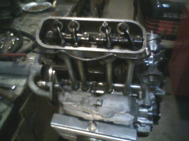

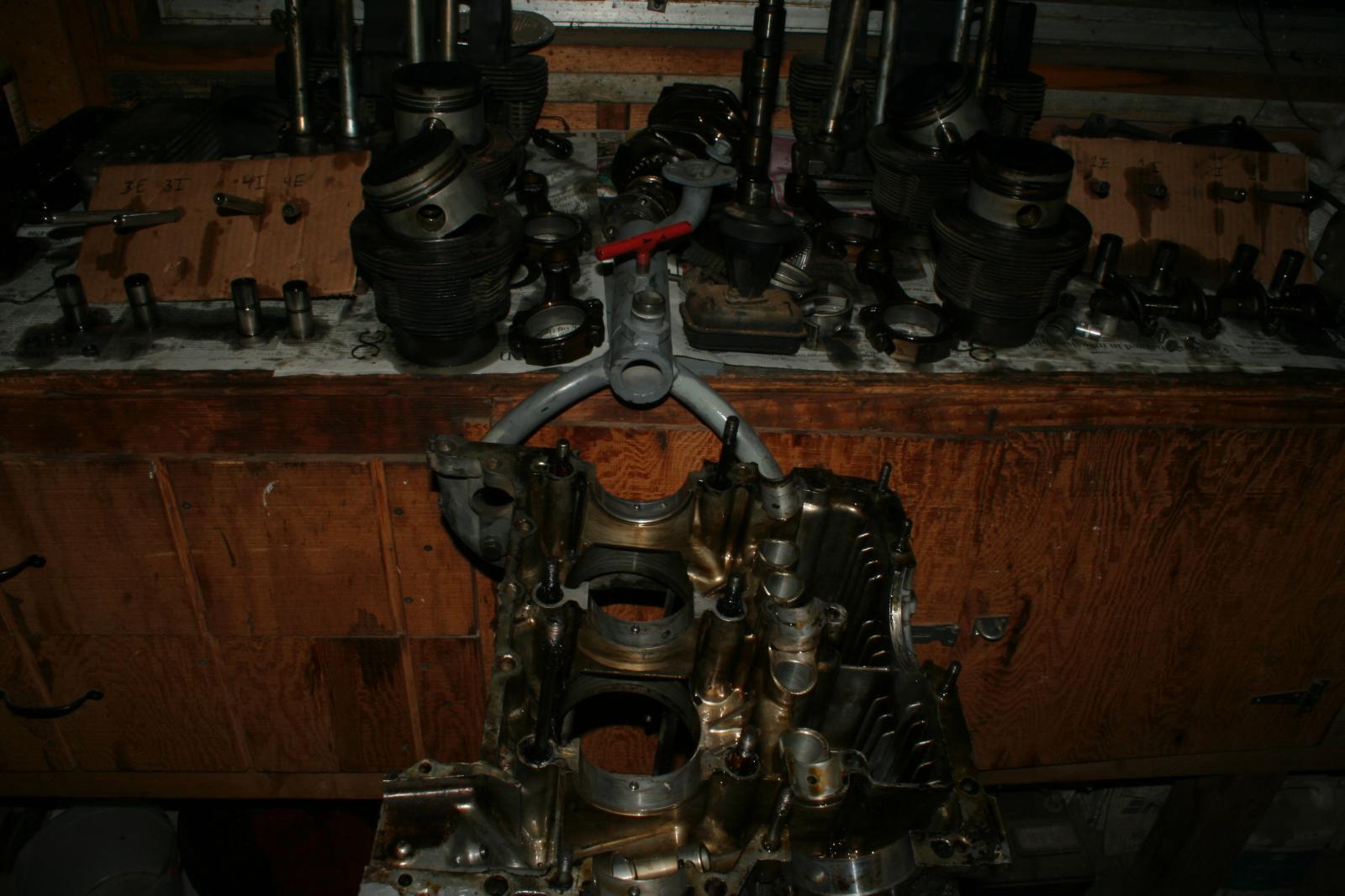

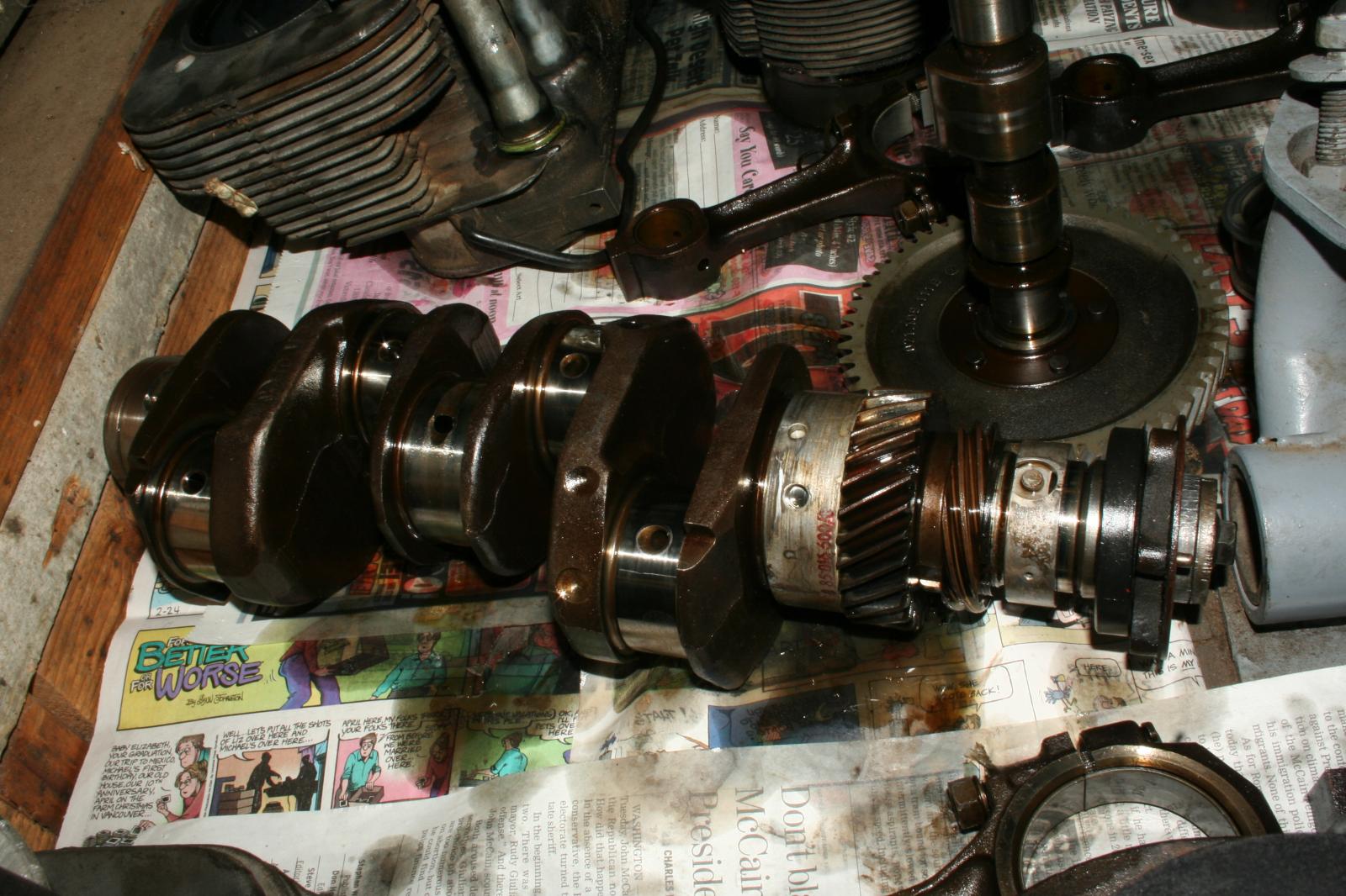

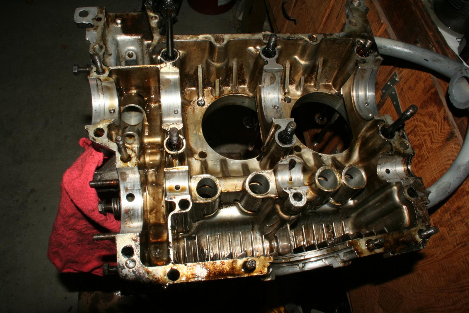

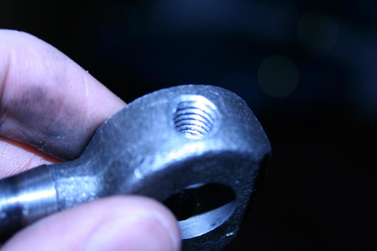

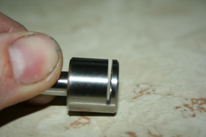

A lot of pieces in that dinky little machine.
The crank needed micropolishing for minor wear marks, but was in print, so I didn't have it machined.
I did a full inspection of the case and it actually didn't need any machine work with stock bore sizes! I was amazed!
This is the next picture that I got. I was busy building and not taking pics... That's okay. I'm sure you all know what a T4 looks like inside.
Mark D.

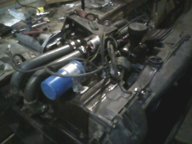

More.
With EFI and ignition on the stand.

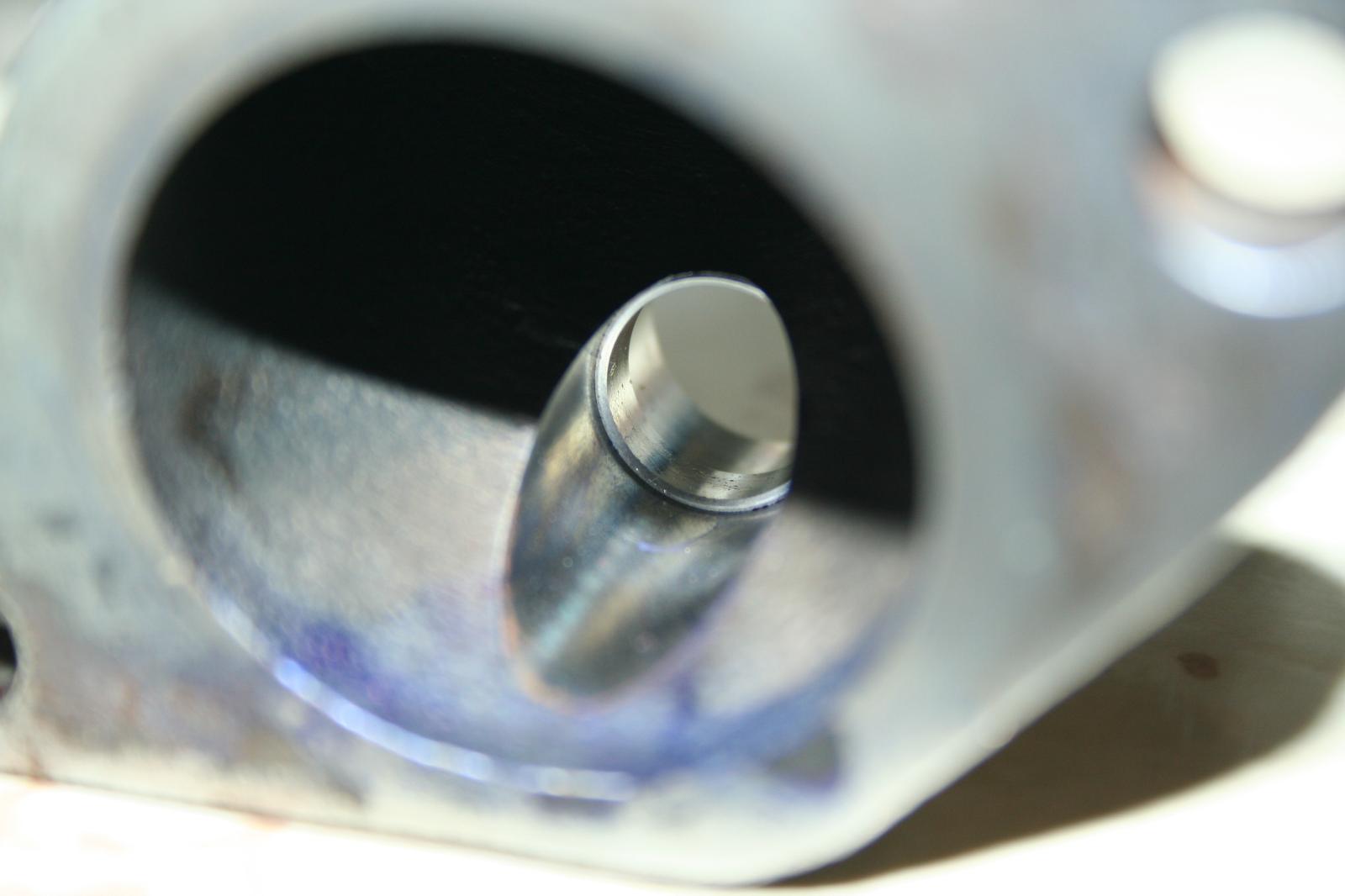

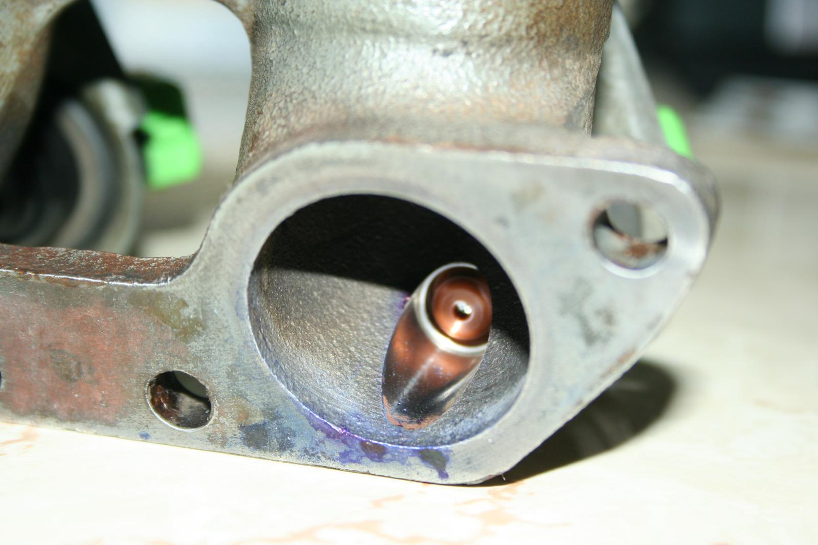

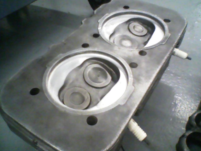

Oops... Forgot these!
After pocketing out the combustion chamber. That was quite nerve wracking for a person who was brand new to CNC, by the way! haha
After face cutting the bottom fin!
In process.

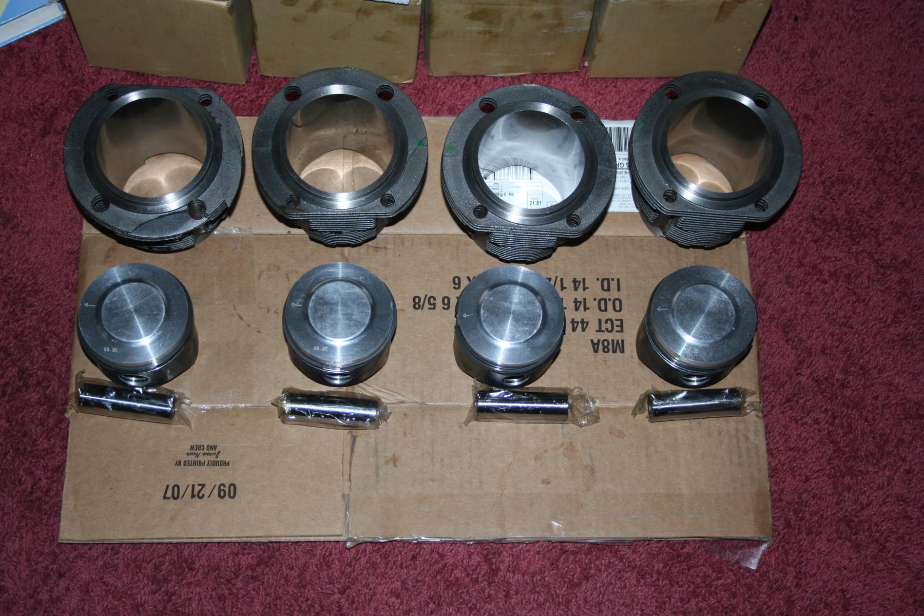

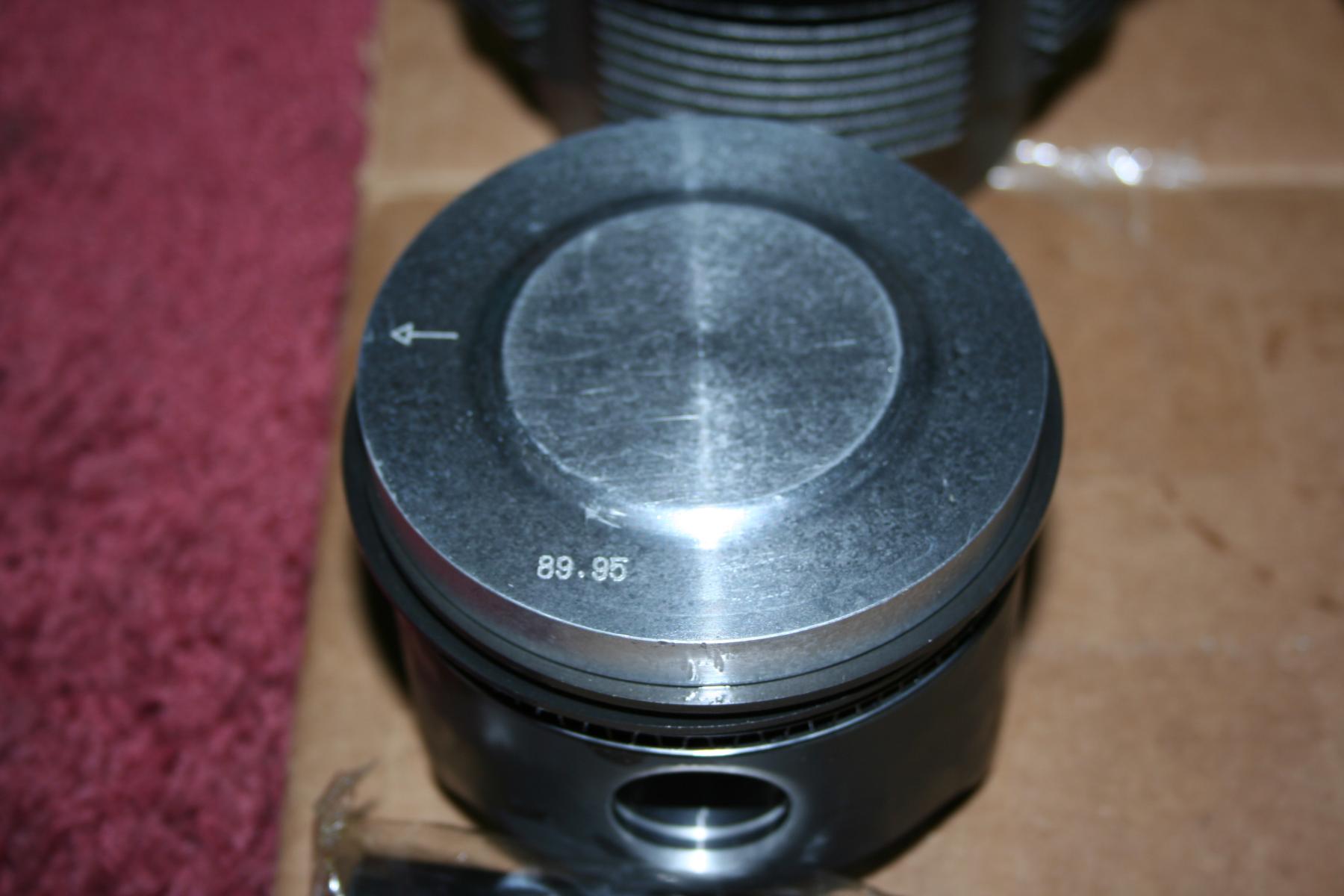

AA Products piston and cylinder kit.
Note the orientation of the arrow in relation to the wrist pin! The guy from AA never responded when I called him on that little detail! lol. What can I expect for 180 bucks? They run good... At least for now.

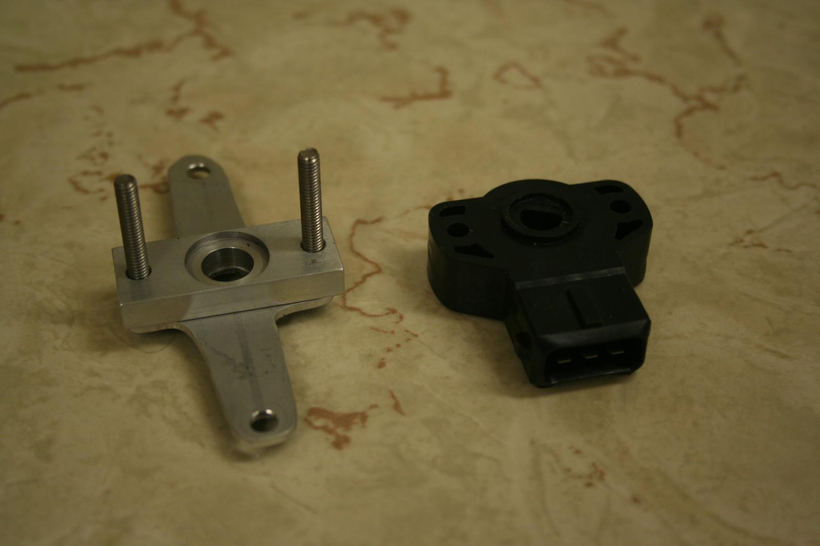

Technical difficulties!

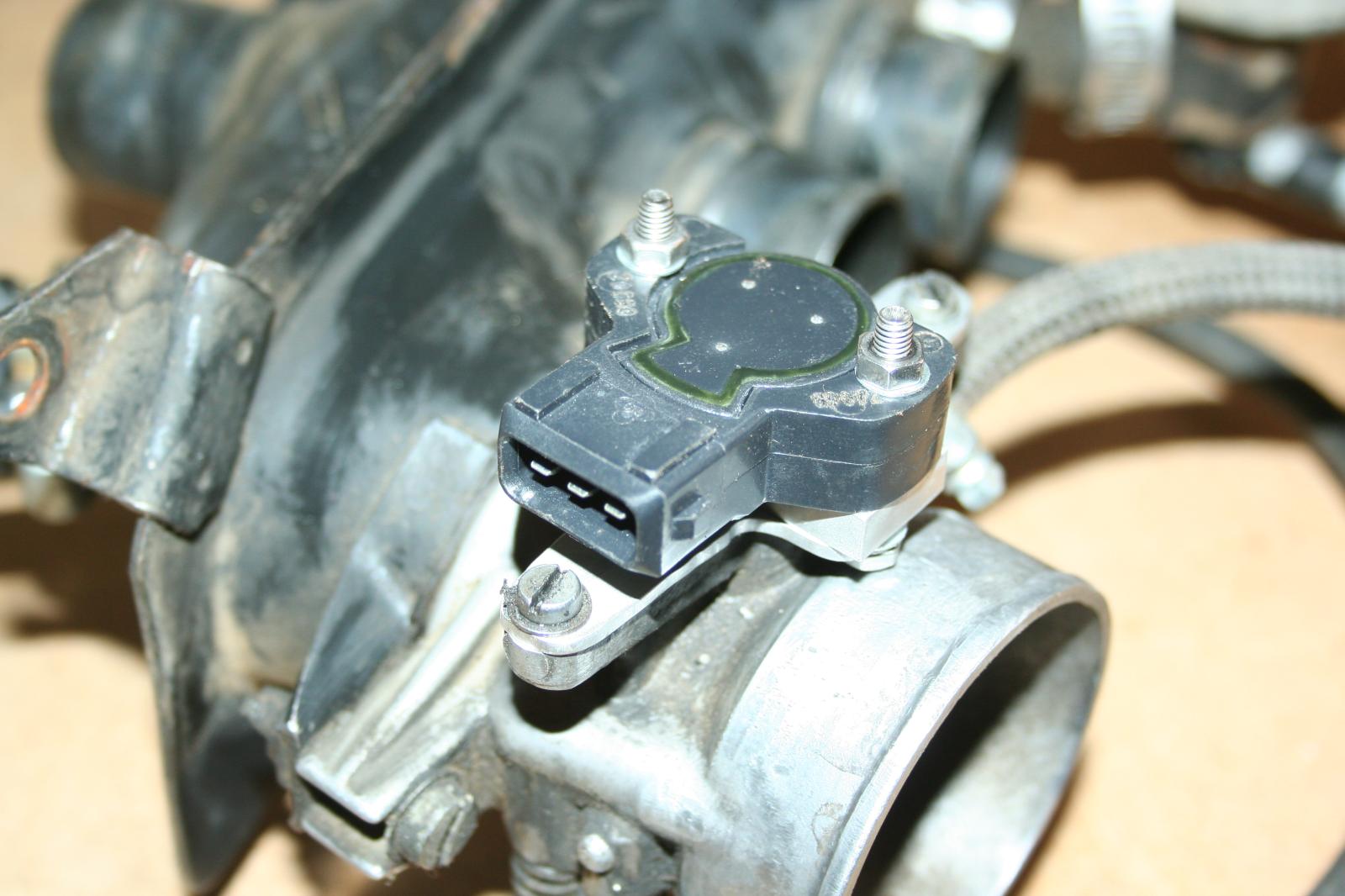

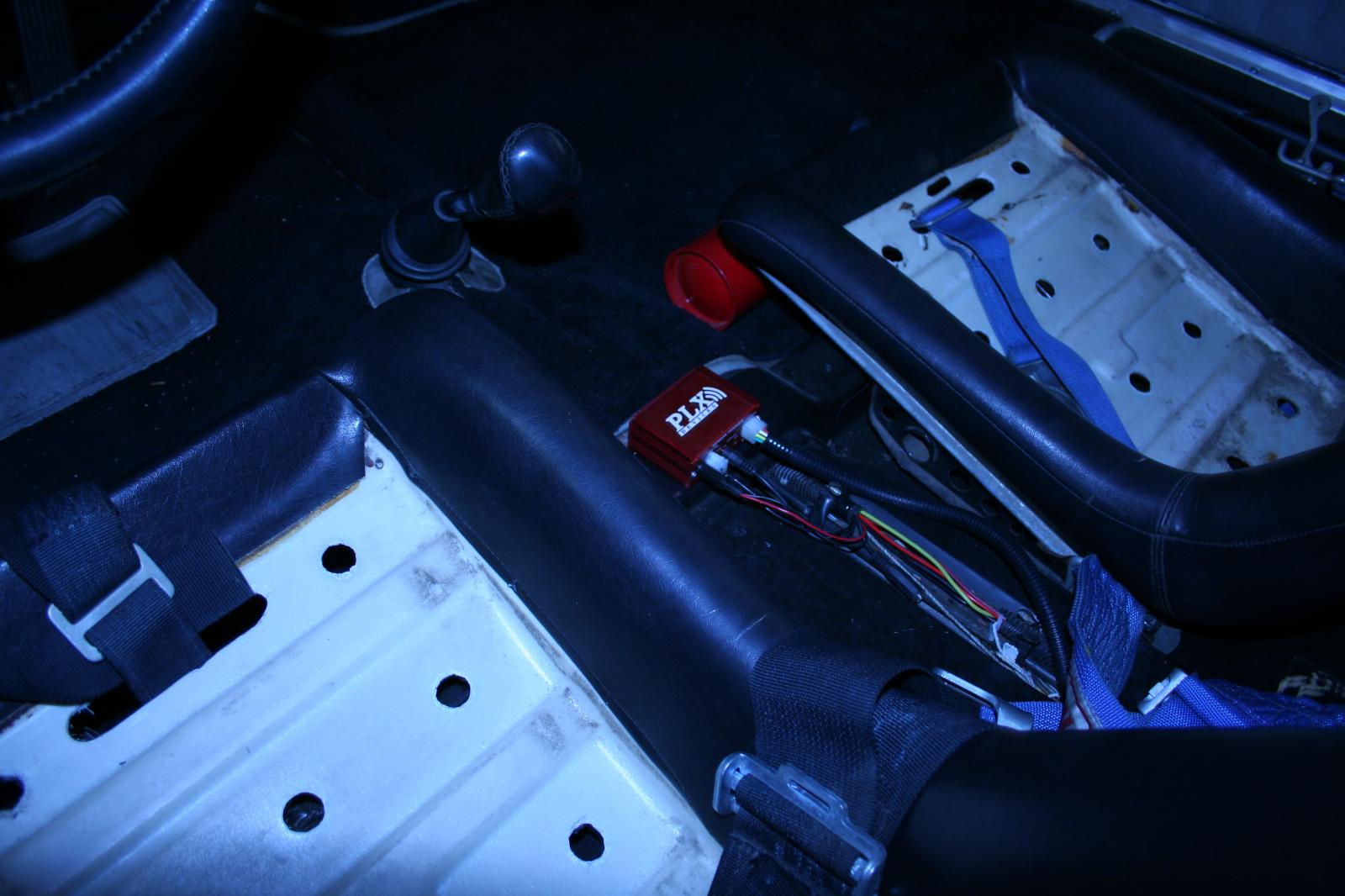

I had to install an AFR gauge to monitor the fuel mixture during break-in. With the new cam and compression, I wasn't sure how the D-jet would interpret the manifold pressure. As it turns out, it has a really flat AFR curve at wide open throttle, but it's a bit fat at partial throttle around town. I'll have to work on that. But for AX and canyon runs, right now it works great. I did have to drop the fuel pressure to about 28 PSI to lean it out a bit. I'm running between 12.8 and 13.5:1 at WOT.
Here's a couple pics of the gauge install. The first one is fuzzy as hell because I couldn't get far enough away to get the camera to focus, but anyone with a Monza exhaust ought to know where this is. It's all the way at the back, between the two mufflers. Ugly ass, flux-core welds, but it's a shitty exhaust that will be pitched soon, hopefully.
The gauge.
This is the control module for the AFR gauge. I HAD to put it in this location because the kit wasn't designed for mid engined cars. The loom from the O2 sensor and the loom from the gauge were JUST long enough to meet in the middle.
Believe it or not, installing this gauge was one of the most pain in the ass projects I've ever done on the 914. It took me a 10 and an 8 hour day (all weekend) to install this thing and get it working. I had to figure out how to route the wires without cutting them, and make it clean and all. I also had to figure out how to wire the thing with their frankly pathetic, 2 page manual. However, the results are pretty cool.... I like flashing lights and numbers. Oh yeah. I also stripped an exhaust stud in the process... A STEP STUD! So I had to helicoil that. PIA, but it came out good.

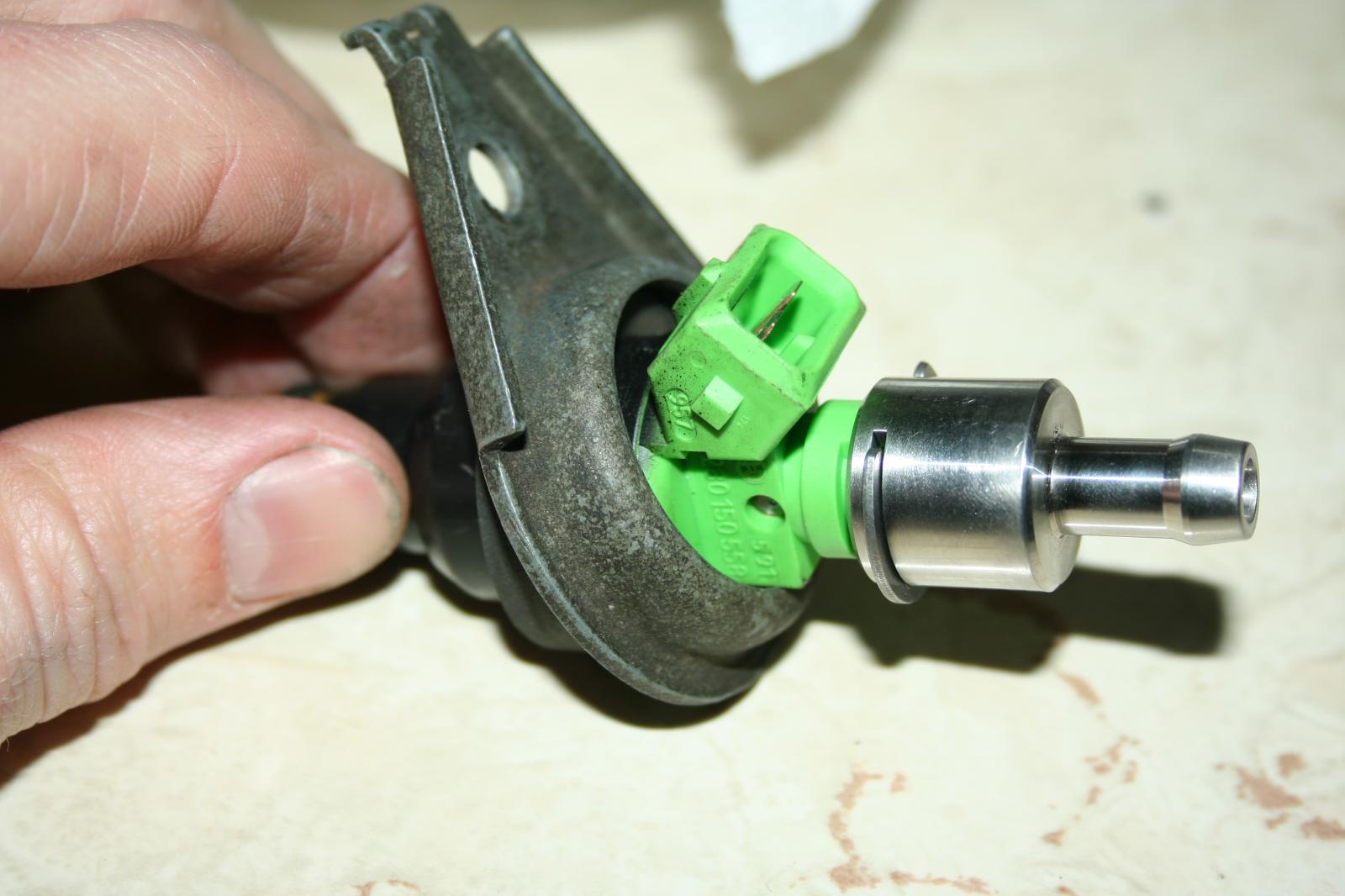

Problems??? BTW, if you are looking for a cheap racing seat (and I mean cheap) give me a call. A buddy of mine had a Sparco installed in his 914 before he had to abandon his project... But, before leaving it behind he took the racing seat and mounted it onto the base of a typical office chair (completely reversible). Well he moved and now I have it sitting in my garage. I don't have any hardware or belts but it looks like you have everything else. If not, I will post an add in the classifieds. Oh, and whats

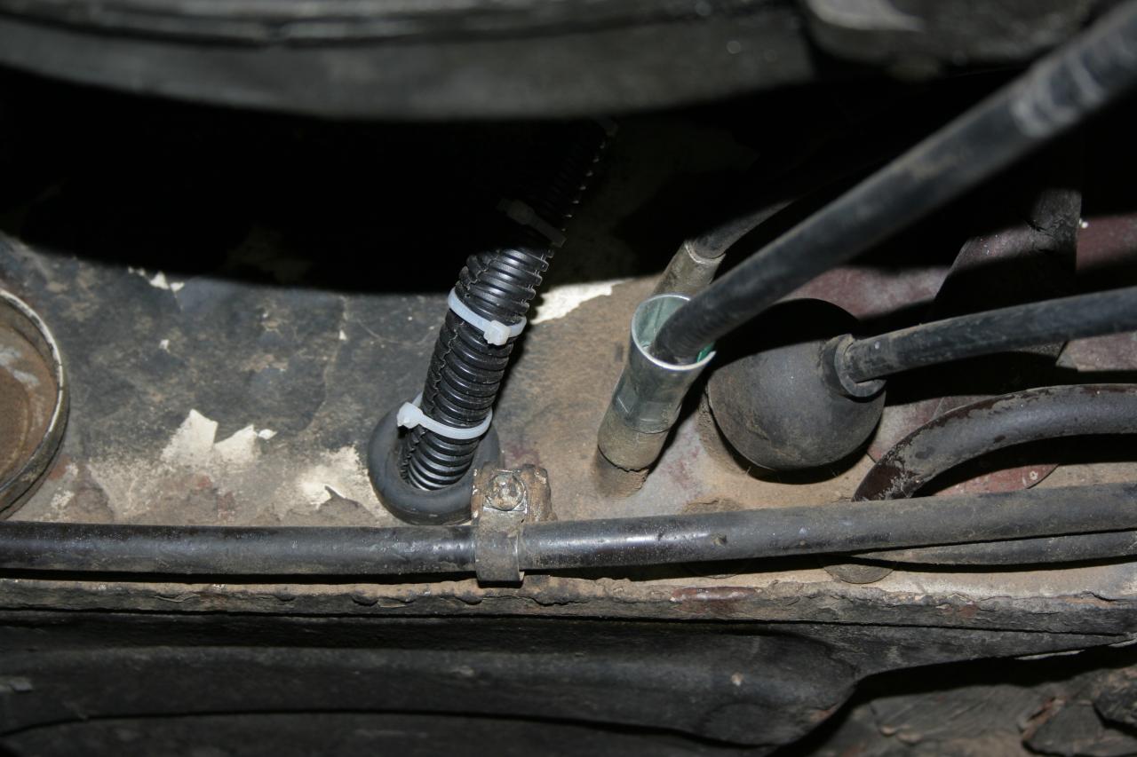

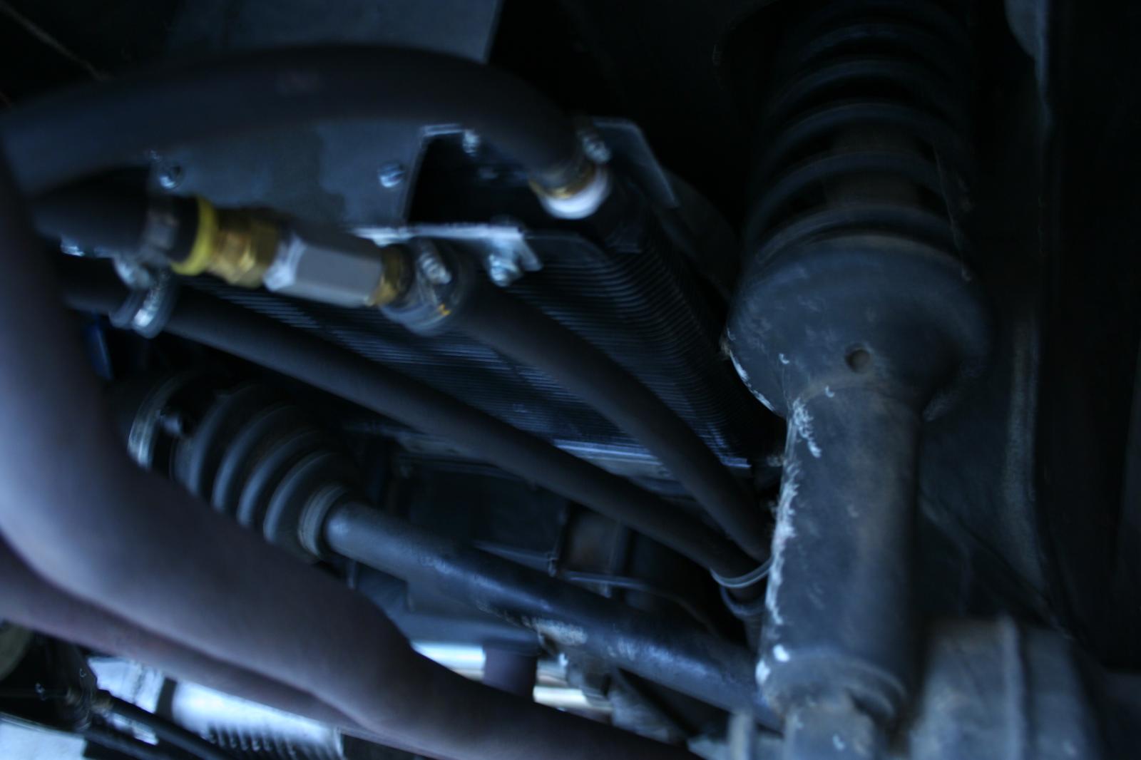

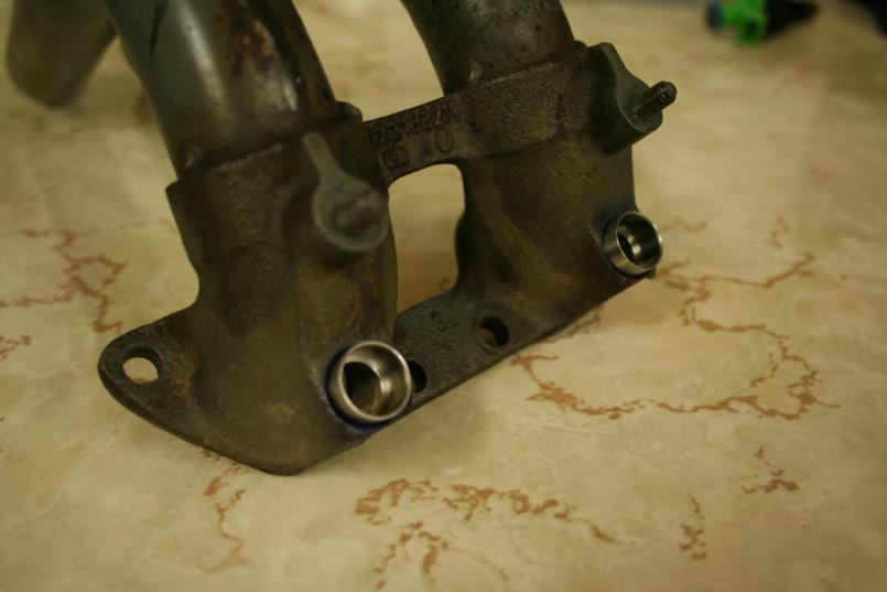

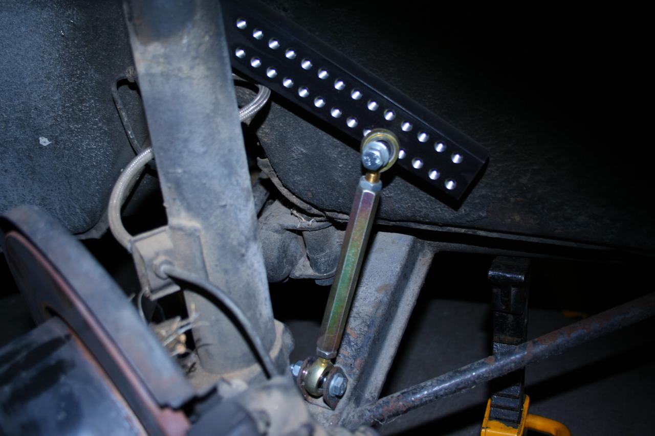

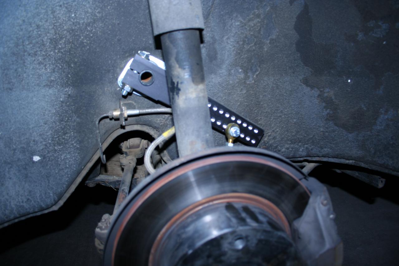

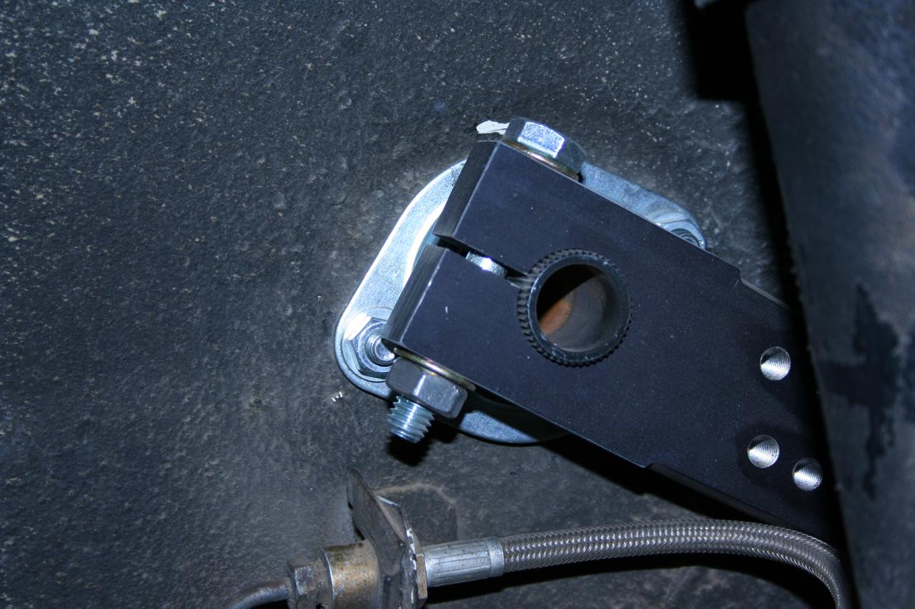

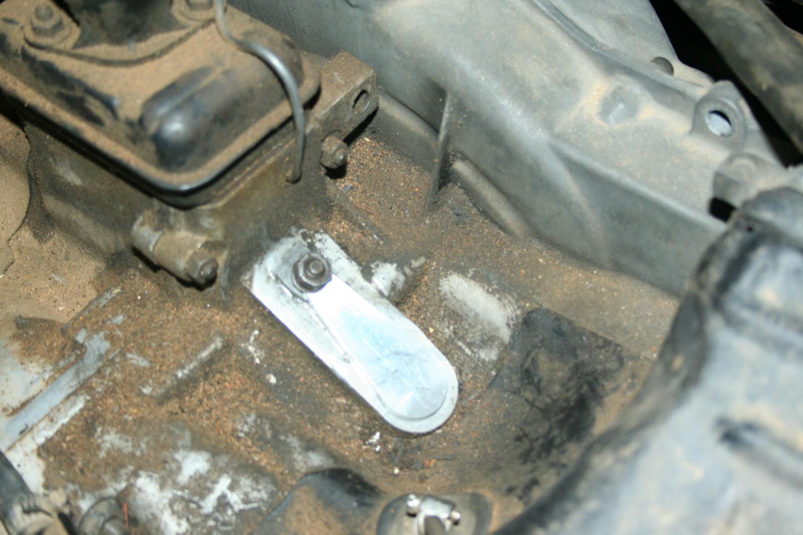

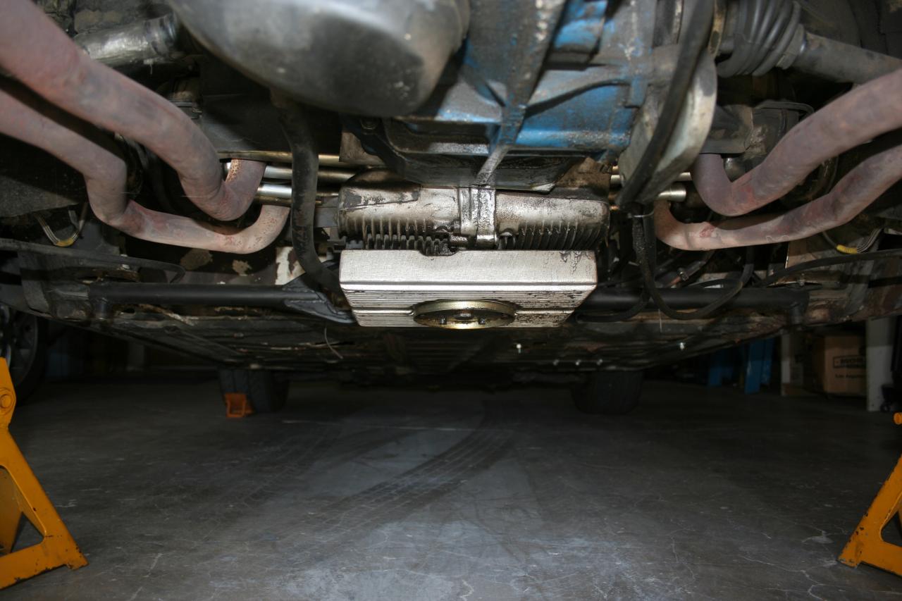

Here's a couple bad pics taken from under the car. You probably can't even tell what these are. Oh well.

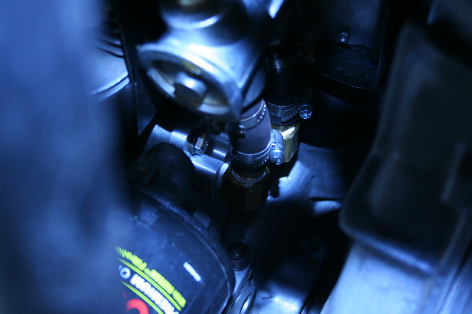

This is where the stock oil cooler goes. You can sorta see the oil cooler block off plate above the oil filter with the 90 degree brass fittings coming out. In the foreground is the thermo-bypass valve. The other side goes to the oil cooler.
This is the oil cooler itself. It's stuffed in between the shock and the tranny on the right side, just behind cylinder 3. The front bracket is actually mounted to the rear engine sheet metal there is a fan mounted above it. It's a stuff job, but there's room above the fan to get air to it (it blows down), and the clearance with the shock opens up quite a bit when you set the car down. The hose looks like it's running right next to the exhaust, but it's got a couple inches there, and it doesn't seem to be heating up my oil at all. You can see the thermo switch for the fan towards the back. All the hoses are adel clamped into place.

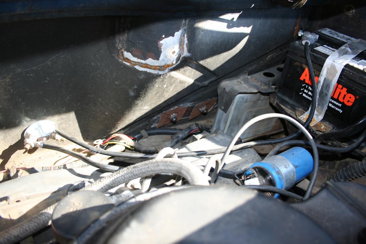

I thought you were having some kind of mechanical issues. Good to hear everything is going well. Check your messages, you should have a PM from me. Thanks

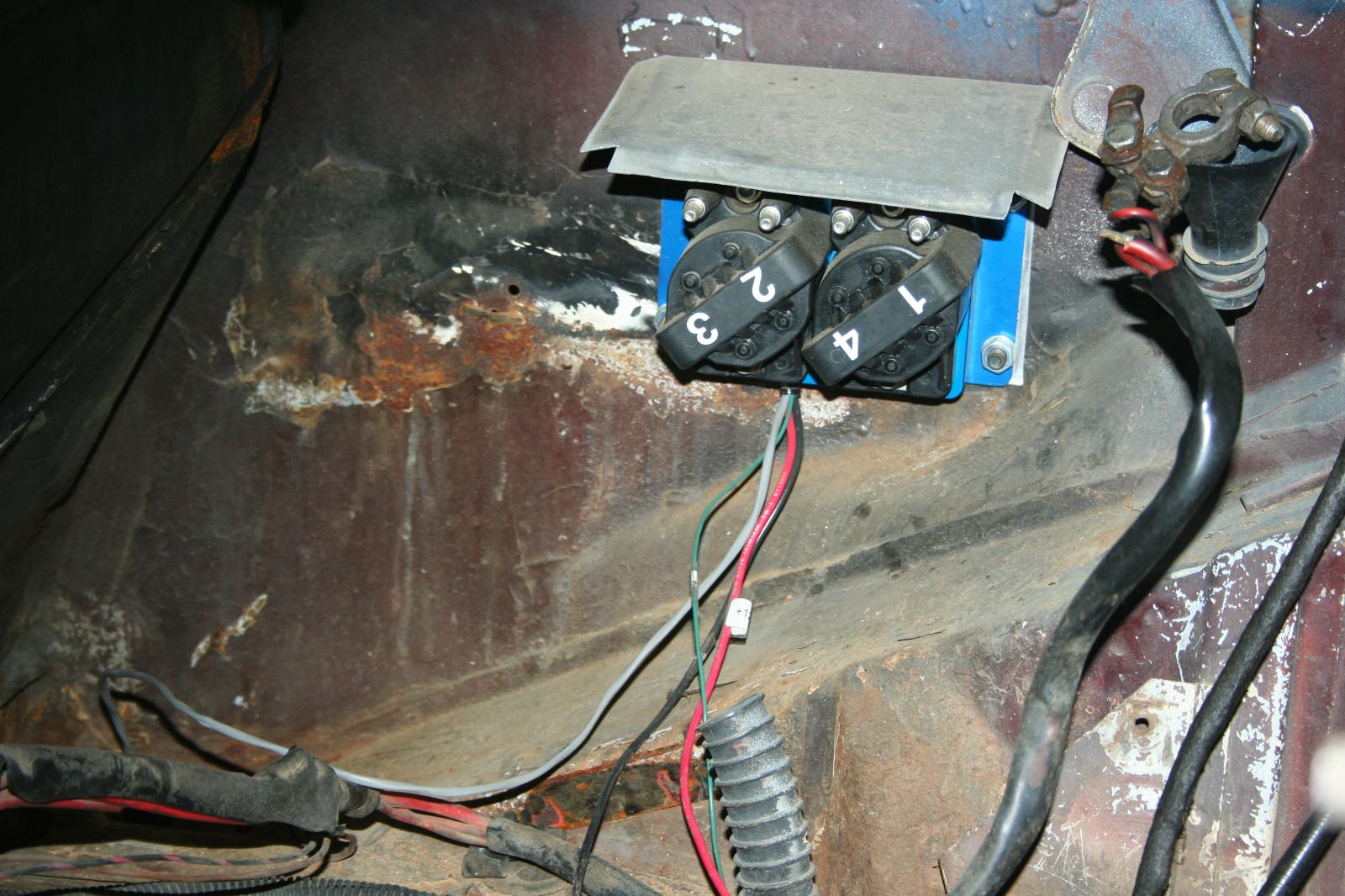

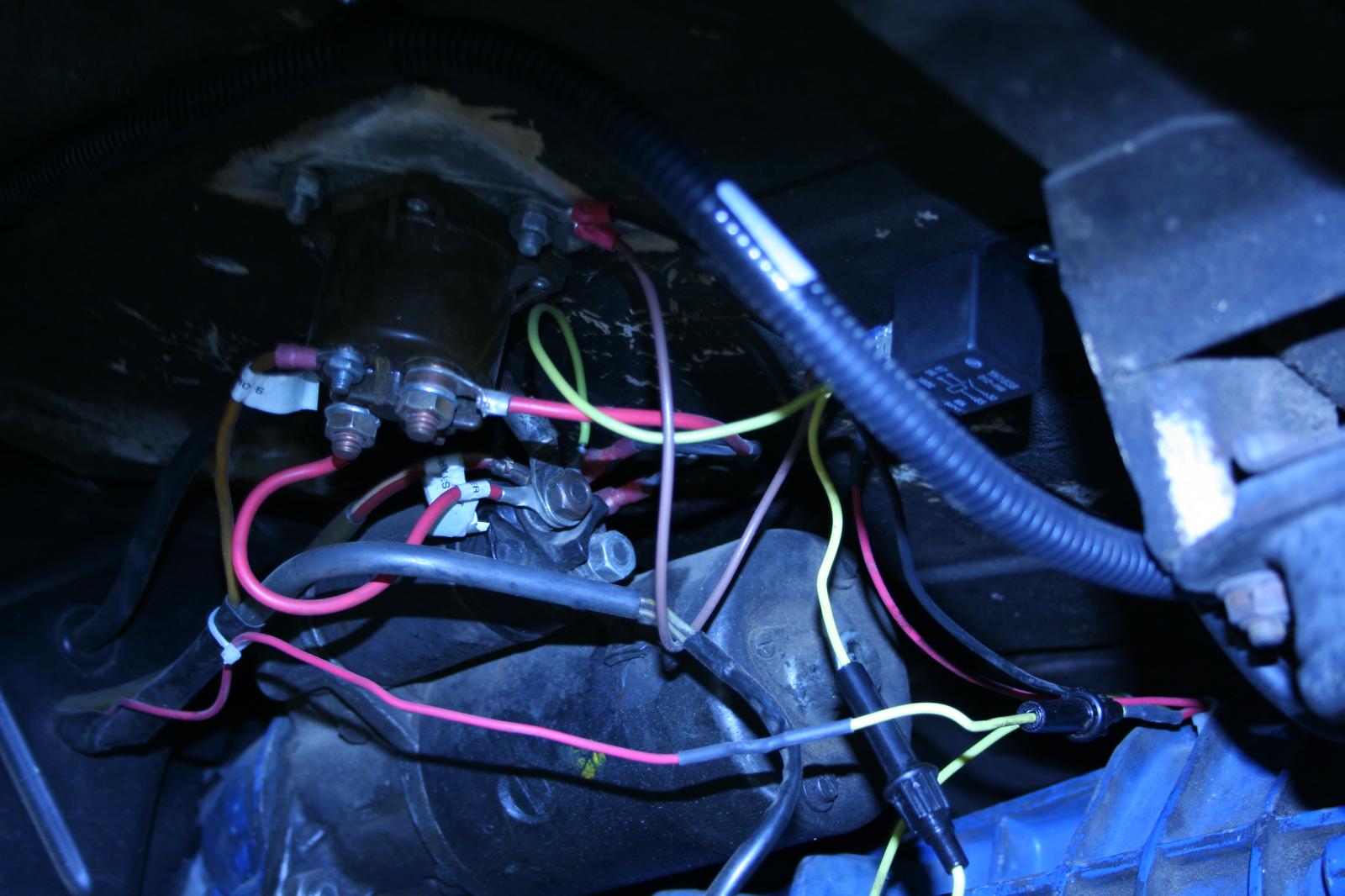

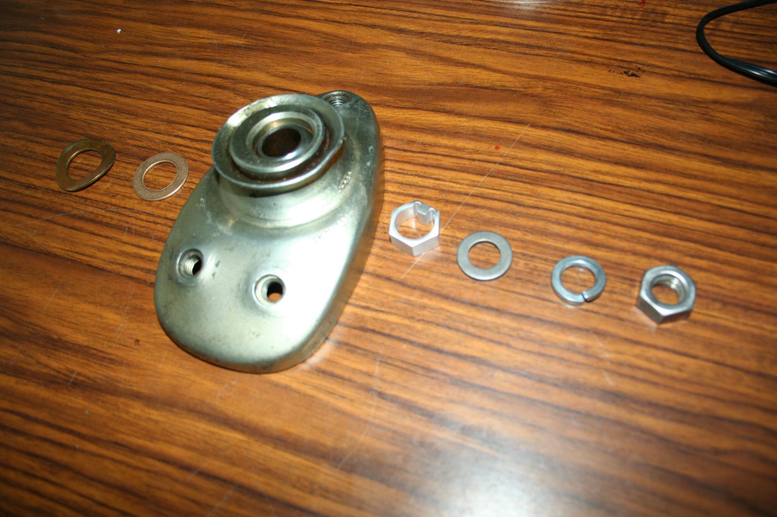

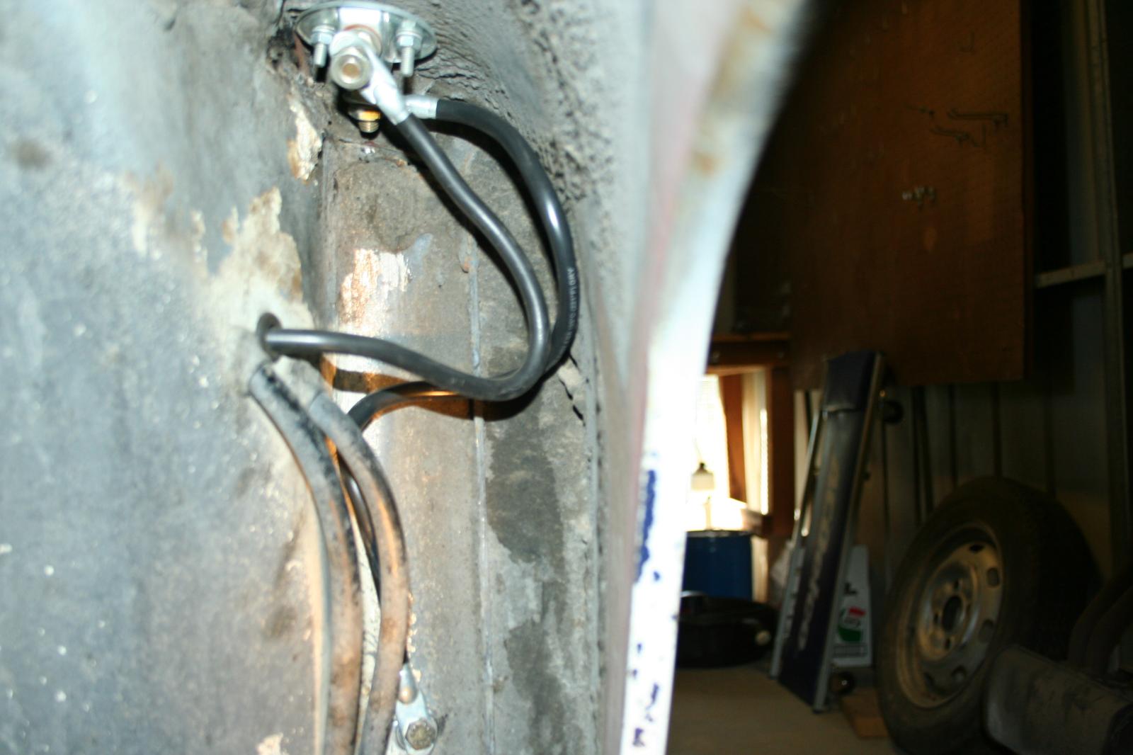

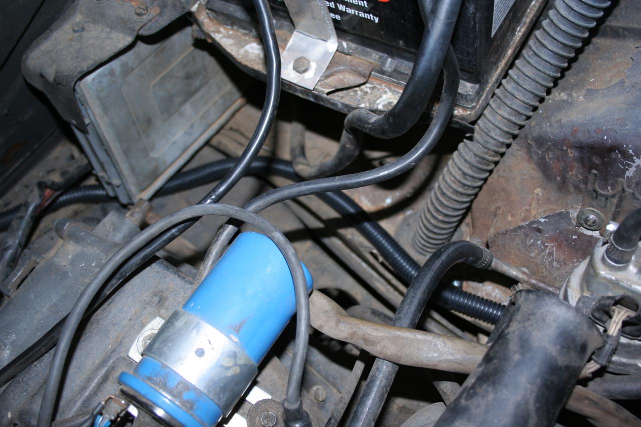

Forgot this one. This is the rats nest that's back by my starter. You can see the Ford starter relay that I added, as well as the relay for the oil cooler fan. Eventually I'd like to clean the wiring up, because right now everything seems rather tacked on. The plan at the moment is to change to an SDS Injection system at the same time that I have the car stripped bare for paint. At that point I'll redo all the wiring in the entire car. The problem is, I don't know if that'll be before or after I go to a full tubular frame with fiberglass panels... too far down the road to tell.

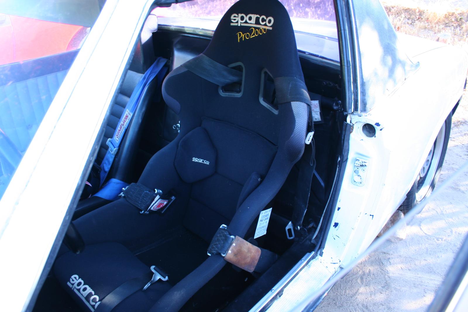

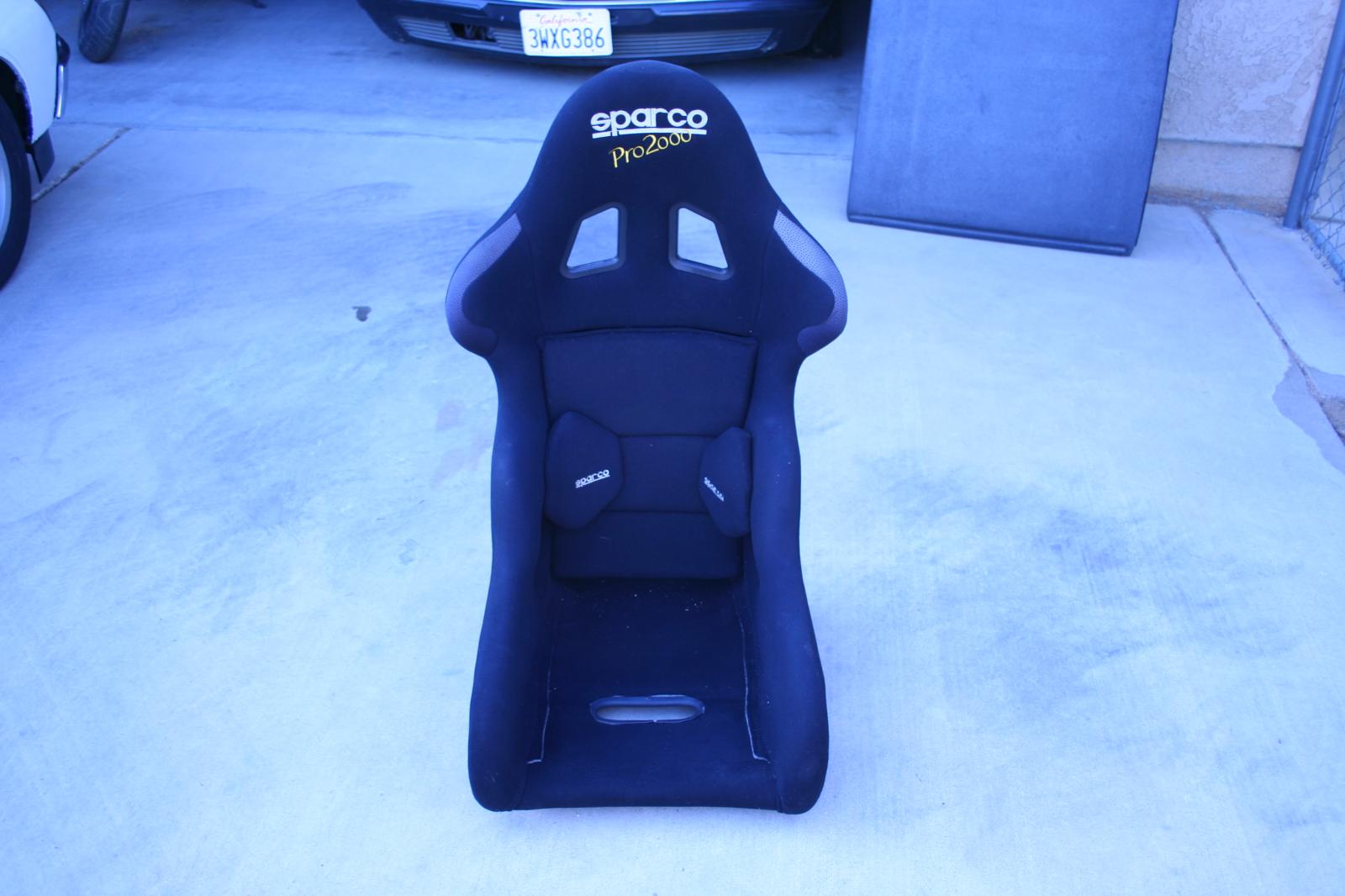

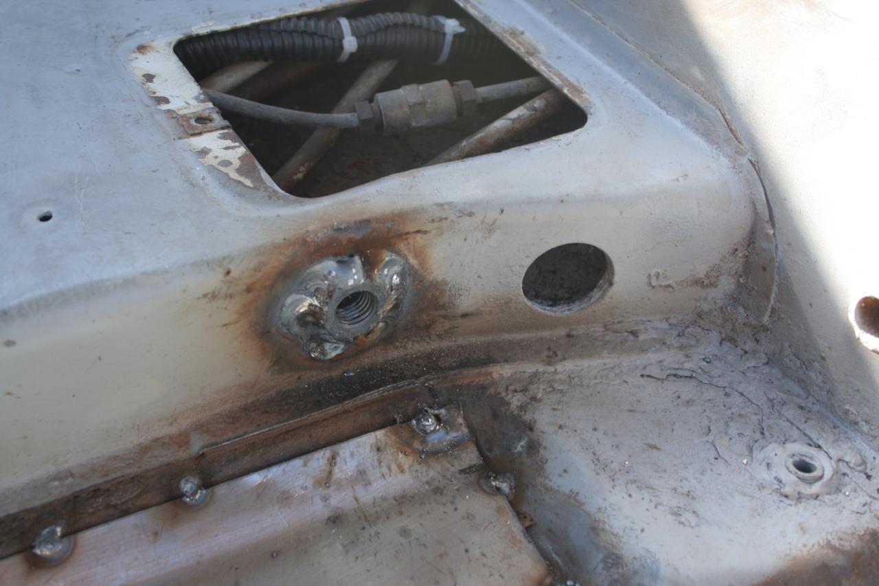

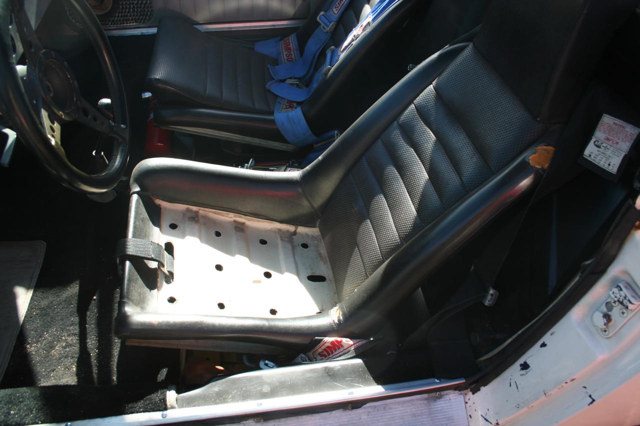

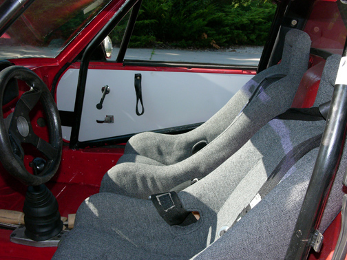

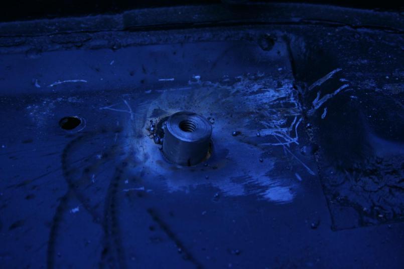

Latest addition. This is the Sparco seat that Eric sold me for a hellova good price. It's in great shape, and I thank him for steppin' up!
He did, however make the condition that I post pics on this thread once it's in, so here goes. These are the bosses that I machined. They were quick and ugly, but paint goes a long way. I just bolted these to the seat rails, set the seat in, marked a circle around the bosses and holesawed those circles. Once holesawed, I simply put the seat in and held it up about 1/4" while my brother tack-welded them on (picture). This put them at the correct angle and proper alignment with no trouble. After that, I unbolted the seat and had my bro finish welding.
This is them welded in with a little grinding to clean them up and get rid of the slag. The welds were a little (a lot) ugly due to rusty floor panels, but they're under the seat. I'm not really concerned grinding on these welds, as it's the harnesses that really hold you in, not the seat. It's still plenty sturdy!
A little paint and it'll all be purty!

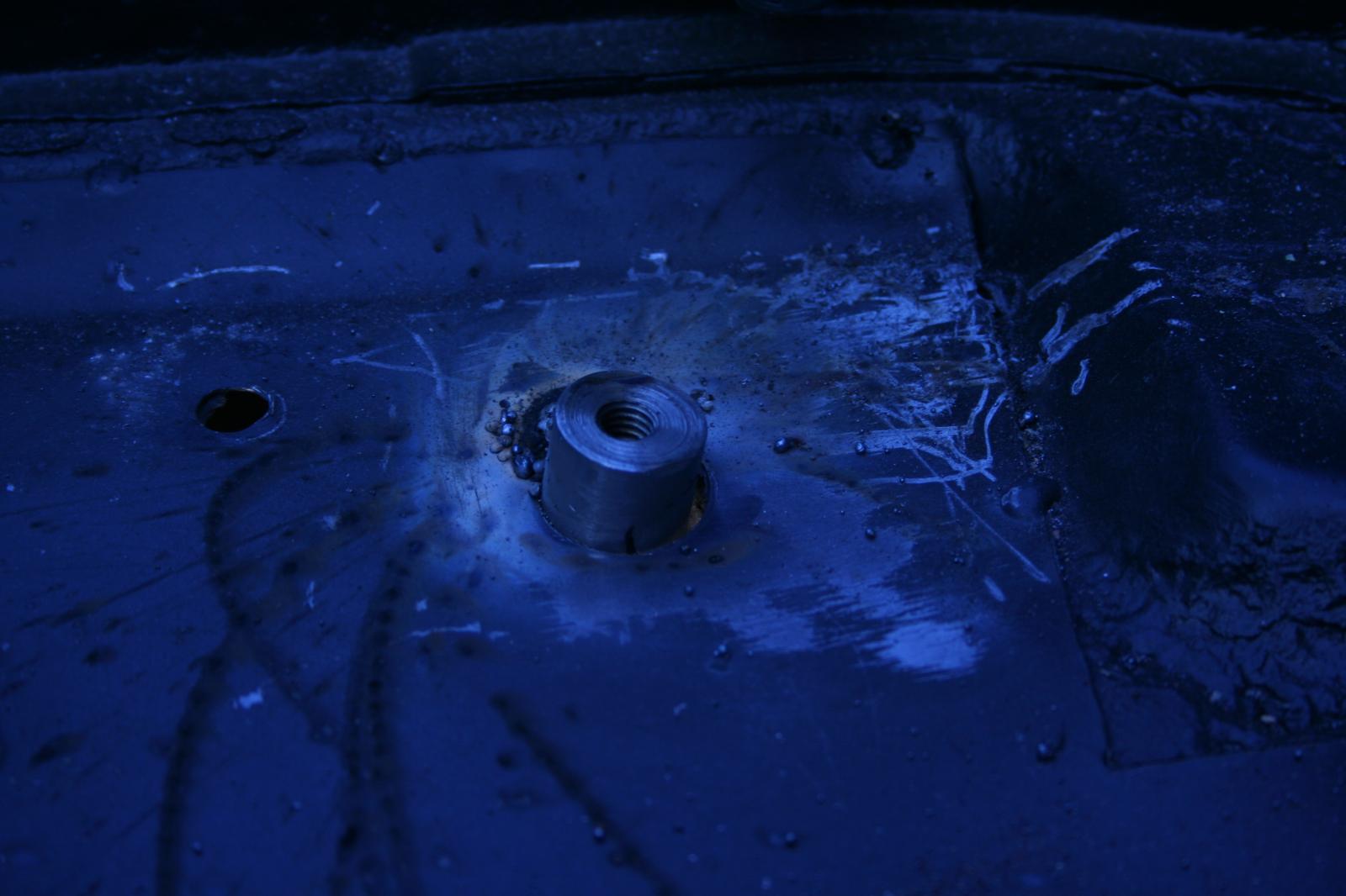

Mark D.
This is after a layer of paint. Oh, and nobody needs to point out that the bosses are crooked. This was done intentionally to put you inline with the steering wheel and pedals, as they're not exactly in front of you otherwise.
The seat installed. The holes on the rails lined up perfectly with the bosses and the bolts threaded easily. It worked really well! The seat position is quite a bit more upright than the stockers. It'll take some getting used to, but I think it's an improvement. The steering feels much more in control, and the toggle switches aren't such a reach.
This is the weird part of the rule that you guys are referring to. The hoops in the seat are actually lower than the harness bars that I welded in. The harnesses actually goes right through the middle when I'm strapped in with no binding at all, which is good, but the seat didn't change the geometry of the belts at all. lol. It's cool though. I do need a race seat for when this thing is ready for the track, and rules are rules. Plus, the side bolstering is awesome! And what a deal!
Thanks again, Eric. It was cool meeting you. You should come out to Running Springs next month if you can.
Mark D.
Nice I have the Evo2. Similar seat. I love it. Had to modify my interior too. Nice work.
Well, after the side track with the engine I got back on track to do the front anti-roll bar. The car lacked any anti-roll bars from the factory, and I feel that that's what cost me the most time at last years Nite AX... well, that and my lack of skill! So I set to work. After looking at what was available from Tarret and Weltmeister for $470, I figured I could fabricate some for cheaper. I started with the 1" hollow bar sold by HRP world (http://www.hrpworld.com/index.cfm?form_prod_id=216,212,363_1424&action=product) , and the accompanying splined aluminum arms (http://www.hrpworld.com/index.cfm?form_prod_id=216,212,363_1428&action=product)
For starters the arms were too long to even FIT in the wheel well. There would've been serious tire clearance issues, so I had to cut them down considerably. I ended up taking almost 7 inches off of the end. There also aren't any holes for drop links to attach to, so I had to make those. I knew I didn't want slots as they are rather weak, but I figured that the arms were so thick that I could get away with two staggered rows of adjustment holes. Very long story short, I ended up with 28 adjustment holes in 1/4" increments. When I say they are 1/4" increments, I mean that from center of the bar to center of the drop link hole. I actually trigged out every hole so that the center to center distance would be right. This doesn't mean anything right now, but when I learn how to calculate spring rates of these bars, I'll be able to do so accurately.
So I set the part up in a CNC mill and located off of the splined hole, wrote a quick CNC program to spot drill the holes, and then just edited the same program for the drilling and tapping operations. They are tapped M8 X 1.00. A more experienced guy at work did help me with the setup a bit, and I'm very grateful. I didn't even ask, he just offered! This here's to you, UB. Oh, forgot one thing. I threaded the arms because I wanted to make them hug the inner wheel well as much as possible, and I didn't want bolts and nuts sticking out on the back side. Also, it will make adjustment easier at the track, as you won't have to worry about blind-threading a nut.
Mark D.
For drop links I simply purchased the Weltmeister units so that I didn't have to bother building my own up from rod end components. Normally I wouldn't mind, but I was coming down to the wire on time, so I did it the quick way and probably spent a little extra cash in the process. I did, however, replace the SAE hardware with metric, because I try to keep it all metric on my car. I couldn't do that on the turn buckles, though. The M8s were actually a closer fit in the sleeves than the 5/16" bolts that came with the drop links.
Mark D.
I got the bearings from the Big Bearing Store online, and just used the pressed steel housings. The housing is flared to hold the bearing, and that flare is a little over 2-1/4" DIA. So all I did is hole saw a 2-1/4" hole in the wheel well and drill two holes for mounting bolts. It sounds cheesy, but it seems to work well. What I had in mind was that when you tighten the bolts it would compress flare of the bearing housing into that 2-1/4 hole, making that large hole the load bearing surface, and not the two small bolt holes. This theoretically eliminates the need for any further reinforcement in the area, at least with the relatively soft bar. I've run one AX with it as well as some spirited canyon driving, and there seems to be no signs of cracking or excessive stress. Sorry, I don't have any pictures of the bearings from the back side. I was in a serious rush and actually lifted the car, figured out how the bearings should go in there, laid it out, drilled the holes, drilled the bolt holes, measured for the bar length, set the car down and cleaned up in an hour and a half. I didn't really think to snap any shots.
Problems:
1. In my rush of laying the bearing holes out without the gas tank in, I didn't think to make any consideration for the height of the bar, as it relates to the bottom of the gas tank. Once the bar was in and the gas tank was reinstalled there was the tiniest little drag on one side of the bar (I was looking for it by then as I figured out later that that might be a problem). A couple minutes of "adjustment" on the gas tank with a sledge hammer and a block of wood cleared that problem right up, but it's still VERY close in there. If I go to a 1-1/4 bar later, something else will have to be done.
2. The bearings I bought were about a 1.0002" bore, and the bar miced in at about 1.0006. I figured it easier to hone the bearings than knock all the paint off of the bar and hope I wouldn't have to grind it, so I went ahead and honed the bearings. I still can't slide the bar all of the way through, but the part that needs to fit, fits, and fits tight!
Mark D.
Right now the adjustment is pretty well on the loose side. You see, before I didn't like the body roll, but I thought the balance of the car front to back was pretty good, and I figured that ONLY adding a front sway bar to the thing would upset that. As a result, I bought a rear coilover kit from Paragon Products with 200 lb springs. Unfortunately, I didn't realize that that kit wouldn't work with the KYB struts that are in there. I called E-shocks to get some Koni Yellows 3 day shipped out here, and put it on credit. This was on last Monday when I was supposed to race on Saturday! Well the shocks never showed up, and I was never charged for them. I called earlier this week and they have no record of the order! Oh well, I shouldn't have gone into debt for my hobby anyways. Back to the tech side of things, though, the anti-roll bar did make the car oversteer a BIT more, but once I got used to it, I rather liked it! It handles like a Porsche now! I still think we could get a little more out of the front tires, but right now, what I'm getting from the lack of body roll MORE than outweighs the slight lack of balance.
Mark D.
So, I got basically all that Tarret and Weltmeister sells for about $470. What was the final price tag of mine?
Arms: $95
Bar: $96.28 with 2 day shipping
Drop links: $105.98 from Paragon Products
Bearings: $28.31
Hardware: $24.25
Total: $349.82
That plus a few late hours at the machine shop and in the garage. I consider it time well spent.

Well, this is the first work I've done since Allen died. This was another typical example of how my car has come together the past couple years. I had an idea of something that could be better, I came up with a solution, ran to tell him to show him how smart I am, and then he came up with a way better way to do it! Well, not completely, but we did bounce ideas off of each other a lot.
Here's the problem. There was a lot of slop between the rear lever thing on the transmission (highly technical terminology, I know) and the input shaft for the gear selector. This was resulting in about 1/4" of play just at the end of that lever. Multiply that up the long shift lever, and it turns into a lot of forward/back slop. So what we came up with was to drill the rivet out of that rear lever and use cone screws instead. Well, when I finally got to it a couple weeks ago, I drilled out the rivet and found out that the hole in the input shaft was much larger than the rivet, which caused the slop. I don't know if there's more that's supposed to be in there or not, but I didn't like it one way or another. This also meant that cone screws alone wouldn't work. I had to machine an aluminum sleeve to press in that hole in the input shaft and reduce the diameter so the cone screws would actually have something to press up to. I swore I took a picture of the sleeve, but I can't find it!
First step was to drill out the rivet and remove the lever. After that I had to drill and tap the lever for the cone screws. M8 X 1.25
With the cone screws installed. They both compress into a common aluminum sleeve and is press fit into the input shaft. The press fit came out perfect. Not too hard to tap in, but certainly not coming out!
The result is a very tight fit on the input shaft and reduced slop in the shift linkage.
The results were pretty satisfactory. There wasn't as much reduction in the forward/back play as I had hoped, but there is a much more positive feel when selecting a gear. You KNOW when it's in and when it's out, as well as when it's starting to mesh.
A while back ago I also made a similar aluminum sleeve to go between the transmission case and the rear bushing. I drilled the case out to 7/8" and machined the sleeve to be pressed in (If I had to do it again I wouldn't drill the case). This makes the rear bushing fit super tight. You actually have to take the sleeve out, press the bushing into it with a vise, and then tap the whole assembly into the case with a hammer..... it's not coming out, though. This reduced the side to side play considerably.
The combination of these modifications, in addition to the Weltmeister short shift kit that was on there when I got the car makes for a fairly nice shifting 914.... It still shifts like a 914 though. Anyways, no money as of late, so this is the kind of stuff I've been doing... Well, that, and planning out the roll cage that I hope to build next year. It'll be tough without the other half of my brain, though. Miss you bro.
Mark D.

So this is what I was up to this week. See, last weekend I was asking my dad questions about oiling systems for the engine I'm designing (top secret!), and somewhere in the conversation he said something about having a safety wired into the thing to where when it loses oil pressure it kills the ignition. I thought, "Hey! That'd be a really cool thing to do SOMEDAY." That was last weekend, and 'someday' turned out to be this weekend! I got to thinking while taking a cruise in the 914 that there's already a switch that kicks on upon VERY low oil pressure, for the idiot light! Well, my idiot light doesn't work, but I do have the dual sender for my oil pressure gauge. So we started figuring it out.
I first had to decide if the range was right for the pressure switch. Namely, would it kick off at a low enough pressure that it wouldn't interfere with daily driving, but a high enough pressure that no major damage would occur before it shut off. I looked up the VDO part # for the dual sensor and found out that the light is supposed to turn on at 11.4 PSI. It sounded about right, so I figured I'd go for it. There was also a 7.4 sender in case the shut-off interfered a lot.
This made me think it was possible, so my dad and I went about drawing some wiring diagrams. He's done automation controls on all kinds of stuff for years, so he was a big help on the relay logic.... Oh, who am I kidding. He just drew it up and I watched! What I wanted was for it to interrupt the lead from the ignition loom to the + side of the coil, light an indicator light, and trip a holding contact to hold the thing off so that you couldn't restart the engine until you reset a manual override. The holding contact is basically a feature to make sure you acknowledge the problem before trying to restart the engine. I'm not gonna bother trying to explain all the relay logic in text because it's just confusing as hell, but I got all that to work on one 8 pin relay.
The only major thing that got changed in the design was that instead of cutting the power to the coil, I ended up interrupting the control to the rear relay board. This is the wire that goes from terminal 8 on the fuse box to terminal 8 on the 14 pin connector in the rear. I knew about this wire because it shorted out on me once and I had to trace and replace it! Without power to this wire, nothing runs! No fuel pump, no ECU, no injection, no ignition. I chose to do it this way mainly because it meant I didn't have to run wires for the coil all the way from the back to the dash (where the relay is) and back again to the coil. It was all just done in the dash from the fuse box. As an added bonus, though, if it ever does kick off on low oil pressure, it won't still be pumping fuel to a fireless engine.
There's a manual override switch right next to the starter switch (toggle right now, but I'm gonna change it to a momentary). You hold the manual override up with the starter switch to start the car and then let it go once it starts. This override shuts the safety circuit off while the engine is at rest (with no oil pressure) and allows the engine to get fuel and spark to start. It also shuts the oil pressure light off. Once I get the momentary switch in, the safety circuit will switch on as soon as you let go of the switch. Right now it's just normally overridden, and you just switch it on after the car starts.

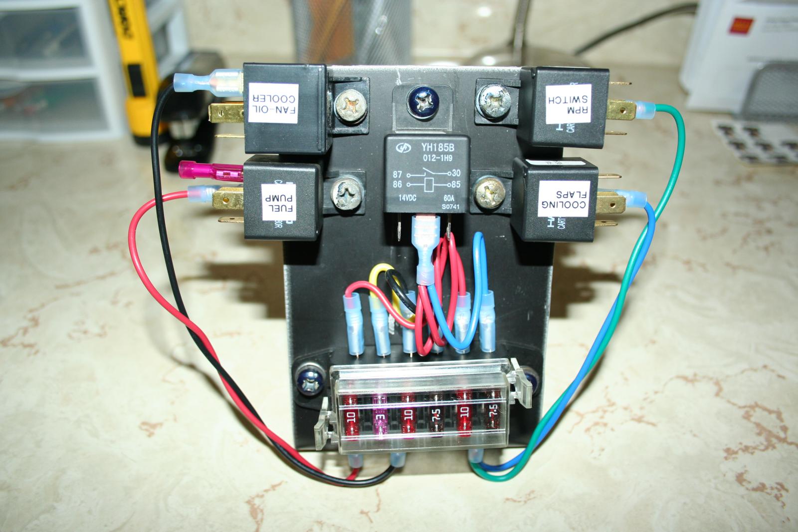

Well, enough talk. Let's get to pictures. This is the relay I used. It was like 8 bucks at Radio Shack, and the base for it (with all the solder in connections) was in my dad's stash! I made a little bracket to tuck it up under the dash. It works, but I'm not real proud of it, so you're not getting a picture of that!
This is not really relevant to the story, but I seriously need to work on my organizational skills when I'm actually in the middle of a job...... That and the picture is fuzzy!
Mark D.
This is the dash before startup. All switches down. The far right switch is the override, and the light above it is the warning light. Down means it's overridden and it gets flipped up after the car is started.
This is the panel in a 'fault' condition. The ECU switch (second from the left) is up because the car was running, but I took the sensor wire and grounded it to test it, and it killed the engine immediately. Note that the override switch is up (off), meaning the safety circuit is active, and the light is on, meaning that the switch has tripped on low oil pressure (or grounded sensor wire). This will actually be reversed when I make that a momentary switch. It'll normally be down, except when you hold it up during startup to override and allow the engine to start.
Well, that's it! I took it for a test drive and really bogged it off the line a few times to see if it'd trip off under normal (or close to normal) conditions, and it didn't. The only time it when off was when I flat out stalled it trying to bog it, and then I heard the relay click and the light went on. I think the response of the pressure switch is a little slow, but even so, if I broke an oil line on the track or something, it should be fast enough to save the major components of the engine, if not the bearings.
The total cost was under $30 dollars. That includes some extra pieces that I ended up not using, but doesn't include the pressure switch which I already had, and a couple connectors and stuff. If it works ONCE, it's more than paid for itself! Thanks for reading.... GOD That was long!
Mark D.
:edit: full credit goes to my dad on this one. It was his idea in the first place (said he saw it on an old Clarke forklift in the early 80s) and I would've been lost trying to design it without him. Thanks pop!

Well, since the rear suspension is well sorted now, I decided to get into the front. I happened across the pictured upper strut mounts, and decided that it was a good time to take out the stock mounts and reverse engineer them (I'm designing adjustable mounts). However in the process of trying to get the rusty struts out of the rusty mounts, I mushroomed the thread on the right side with my BFH. So the new mounts got new Koni yellows to match the rear.
In addition to all that, I got new tires all the way around as the Kumhos that I was running were rather hard and blistered. Dunlop Direzza Sport Z1 Star (Inhale) Specs, all the way around. So yesterday, I figured it'd be a good time to drop the ride height, equalize the camber, and do a four wheel alignment. The took about 8 hours, considering I've never done it before, and the frame is a bit tweaked, and EVERYTHING was out of adjustment. But the results look promising. 2 degrees negative camber in the rear, 1.5 in the front. I'm trying to put a few gentle miles on the tires before really pushing them, but I'm autocrossing next weekend, so we'll see how it works.
The only thing unusual about this setup is the custom hardware that I had to machine to work with the new mounts. These 'retainers' are basically a 22mm nut no threads and a key cut in them. I tried making them out of aluminum, but that didn't work so well. So I went back and redesigned them to give them a little more meat, and made them out of steel.
New mounts.
This was my original plan for hardware. I only ended up using about half of that.
Mounted and adjusted. You can see how far over and back it's adjusted, but the other side is pretty much centered for the same amount of camber. A little frame tweaking, me thinks. Note the adjustment key on top of the shock. Please ignore the dirty ass sheet metal with 4 different paint jobs on it.
Mark D.

About May of 2010, the D-jet system really started getting bad. It was never really great with the modified engine, but the system started deteriorating rapidly to where it barely wanted to run. I decided to park it before it cost me an engine. I quickly realized I was faced with two options. Either spend to rebuild the ignition and injection systems and live with D-jet for even longer, or bite the bullet and go to SDS as I've wanted to do for years. Well, there was no cash for that. I was trying to buy a house, and my commuter car blew an engine shortly thereafter.
However, in August I was able to find a brand new SDS EM4-4F system (exactly what I wanted) on eBay for cheap. It was a guy in Australia who bought it for a project that never got that far. With shipping back to the US I paid $1140. Plus I had to ship it to SDS and have some rework done for some of the options I wanted, as well as a V17 chip upgrade. That was another $388. All in all, I figure I saved about $500 on a fully loaded system.
Of course, as life goes, I got my house the very next month, and for a while it was very hard to find time and money to put into the install. However, I was try to spend one extra night a week in the machine shop building the brackets and stuff I need for the sensors and injectors. So anyways, in the past 4 or so months, this is what I've come up with.
The first custom part I machined is a mount for the TPS. Luckily, the 'D' pattern on the TPS is the same as the stock shaft. The shaft did need to be cut shorter, which took me about two minutes with an angle grinder and a cutoff wheel. The hard part was that the TPS plug is turned 90 degrees from the stock location towards the back of the engine. With the bell housing there, it gets a little tight to plug the loom in. So careful measurement had to be made to make sure everything would fit.
What I came up with was a two piece design that consisted of a machined block that mates to the TPS, and a sheet metal 't' that flips it 90 degrees and mounts the assembly to the stock TB.
TPS brackets. You can see that the sheet metal part was all done by hand. It's functional.
Assembled TPS mount alongside new TPS. You SDS guys will be familiar with that part.
Installed.
Mark D.

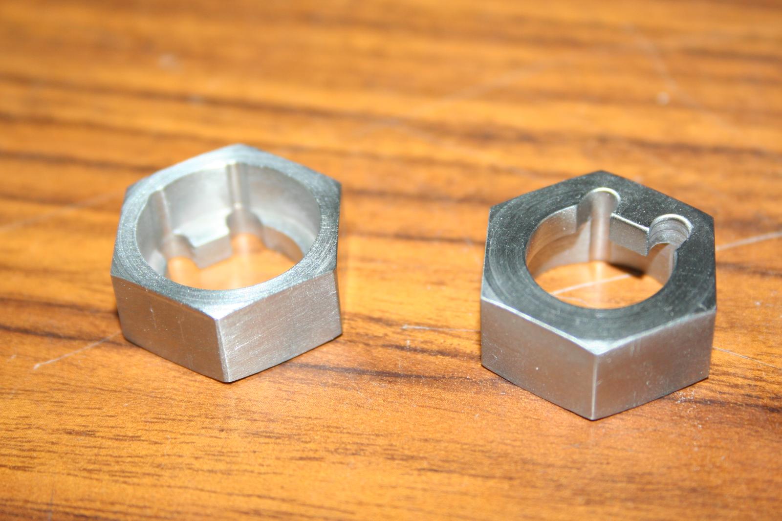

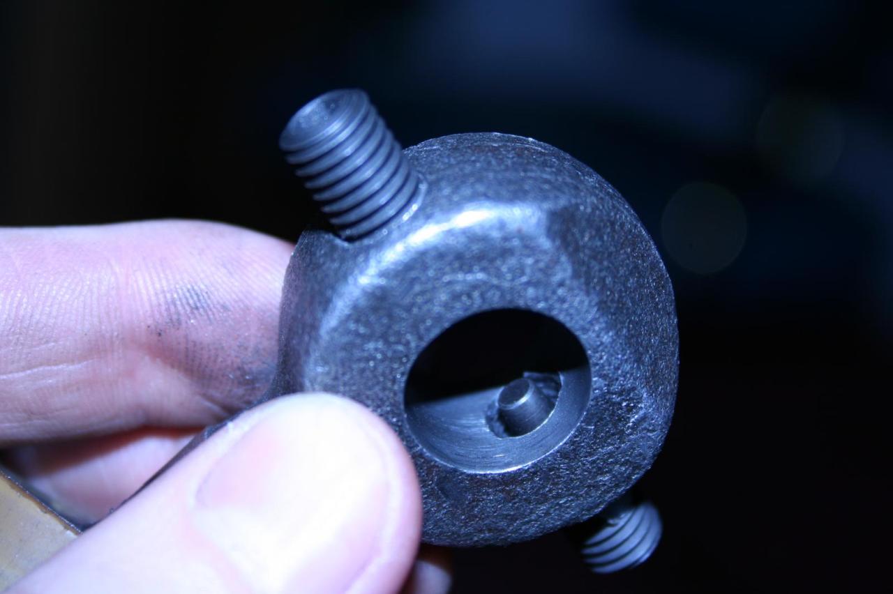

Since I'm going to crank fired ignition, another thing I had to make was a blockoff plug for the distributor bore. This was just time spent in the machine shop. I found the o-rings at McMaster Carr. I got a compound of rubber that's supposedly rated up to 400 degrees fahrenheit and oil resistant.
Not much to say about this part except if I do another I'm gonna leave more material around the bolt hole if I have to do another. That was a reverse engineering mistake. I.E. I don't know how to measure a stud.
Installed. Don't worry. The engine will get cleaned up before I put it back in. The fit in the bore is almost orgasmic, BTW.
Mark D.
Originally, when I decided that I wanted to go to SDS, I was just planning on using the stock D-jet injectors. However, since I bought a system from a private party, he had ordered injectors with it. He bought the Ford style 440cc 'Green Top' injectors, like so.
Even though it's overkill for the engine that's in the car right now, I decided to go ahead and install these. Two main reasons: I didn't want to change the injector plugs on the loom, and then have to change them back when I had enough engine that required bigger injectors. These are a standard size, and I can get them in many different flow rates. Also, they're new, and it's always best to use good components, even though there was no known problems with the old injectors.
The way I decided to accomplish this is to bore and sleeve the manifolds to accept the new injectors, use the existing clamp, and machine port adapters for the backside (still in process).
Manifold bored and counterbored to accept the sleeves. The fixturing on this part was a little interesting because the injectors rest at a 80 degree angle from the gasket face. Bore tolerance was .0005 for the press fit.
Mark D.
Sleeves. The small end was held to +/-.0001" for the press fit. The bore on the larger side was held +/- .002 for the o-ring to seal.
Oh yeah. They were machined from some 316 that I had lying around.
Sleeves pressed in. The press fit was perfect. Not too tight. Not too loose.
Port side.
Mark D.
Injectors installed. Feels good to start putting stuff together.
It took some careful calculation to get the depth of the injector approximately as the stock ones were. I think I did okay.

Quick update here. I'm not sure if I mentioned that I'm doing a battery relocation while I'm at it. So I decided that instead of running power cables through the tunnel to power all the switched features, I'd run a switched line to a master relay that turns those functions on, and pull power off the starter. (I'll get some pics of the battery work that I've done later today)
Anyways, there are some switched circuits and some non-switched circuits that all need to be fused, so I decided to do a completely separate relay board in the engine compartment.
This is what a wiring diagram looks like as drawn by someone who doesn't know how to draw wiring diagrams. I drew this up at work while my machine was running on Friday. Some of the capacities on the fuses are subject to change. I need to do some more research on that.
I fabbed this up in about an hour and a half yesterday, and I'm quite pleased with how it came out. Yes, the labels are upside down, but I did it that way because my head will be upside down in the engine compartment when I'm looking at them.
Stayed up until late last night wiring this up. This is all the wiring I can do without installing it in the car. I need to add the main power from the fuse to the master relay (60A), all the control wires to the ECU, all the grounds, and a couple intermediate control wires.
Mark D.
A couple more things that I did a while ago. When planning the SDS install, I decided that now would be a good time to move the battery up front. I just used a $10 plastic battery tray and attached it with rivet-in T-nuts through the trunk floor. That way you don't have to hold a nut on the underside of the floor while screwing a bolt in the top. It also makes a flush mount on the bottom side. The battery clamp was done the same way. I just used M8 X 170mm bolts (which were a bit too long) from McMaster Carr and screwed those into T-nuts in the floor.
Installed.
Mark D.
The cables were just purchased from O'Reilly. I don't remember if they're 4 or 6 gauge, but I had to run the hot lead through the tunnel all the way to the starter. The ground needed to go to the battery switch at it's new location on the left front fender.
Note the 30A inline fuse on the hot lead. Grommets are epoxied in anywhere the lines pass through a firewall.
Battery switch's new spot. This is actually the old radio antenna hole. I'm going to make a plate to cover the uncleanliness sometime and paint it bright orange so that it's easy for course works to spot. This mod is actually in response to an SCCA GT-3 rule that requires a main battery shutoff on the outside of the car that is accessible with the car either rightside up or upside down. It's also pretty convenient, because you can just drop the key in just before getting in the car.
Mark D.
Wiring in the inner fender to the battery switch. It's pretty tight in there and tough to photograph. Note the ground on the backside of the fender well. This is also bolted to a rivet-in T-nut. I've been doing that a lot more lately to make the thing easier for only one person to work on. I live alone, and I can't just go grab an extra set of hands. Also, even if I did have an extra set of hands, you don't want to know where the other end of that bolt pokes through. It'd be a bitch to hold a nut on it.
This is what I did with the space left by the stock battery tray. This is the -4F coil pack. Pretty self explanatory. I'm also going to put that new relay board and a ground point in that area.

your master off switch needs to cut all the power on the + of the cars electrical system not the ground to the batt.
just cutting the ground to the batt will not shut off the electrical system and shut down the car,
run the alternator wire to the batt, then run main batt wire to switch, then on the other side of switch run to the car electrical system.
cutting the ground will still allow the car to run off the alternator and the spike from the loss load from the batt will surge you electronics all the while the car will still be running.
when i was tech inspecting at the local stock car track i shut a cars main power off and the car stayed running but the tach stopped, the driver accused me of "blowing up" his tach! i explained to him that i did not impropely wire his emergency shut off and that his car has failed tech inspection becaused it failed to shut off the engine from the emergency off. he stomped off to complain to the track steweard.... i heard laughing from that direction.
or this is better http://www.ssdiv.com/master.html
Hmmm... Good info. Thanks. I guess I misinterpreted that rule. I won't be running SCCA for at least a couple years, so it'll stay this way for the time being. Thanks for the heads up, though.
Mark D.
Well, got her running on Sunday! ... after a year off. Anyways, I was waiting on new pieces. Some I had to buy, others I had to make. Here's what I had to make. These go on the back side of the injector and adapt it to a regular-hose clamp type fitting. They're made of 316 stainless like the aforementioned sleeves.

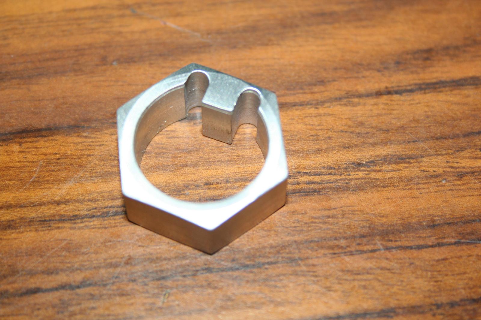

The port profile was reverse engineered from a C4 corvette fuel rail that a guy at work had lying around.

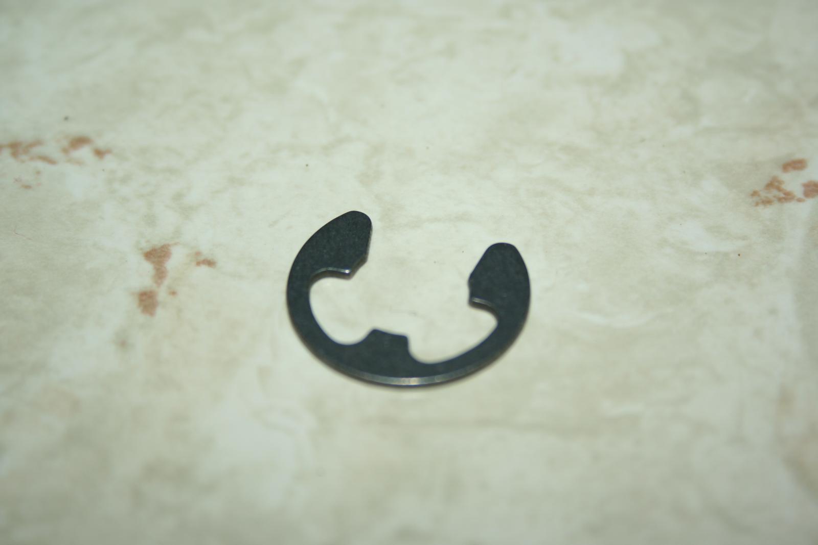

One of the big holdups with this part was that I couldn't figure out a way to retain it on the injector that I really liked and that wasn't a pain in the ass to machine. This is what I came up with. This groove....
...allows this clip (from McMaster Carr)...
... to clip in like so.
This is the final assembly.
The really important thing on this part was making sure the groove was deburred really well so there was no chance of tearing the o-ring on assembly. I left that part to one of the professionals at work. The fit was a bit tight, but with a tiny bit of oil and some finesse, they went together beautifully. No leaks so far, either.

Another thing I had to finish was the intake. This took more money than skill.
Apexi filter from Redline Motive. Aluminum u-bend from Lancer Shop. Spectre silicone unions from my local O-Reilly.
Mark D.
The last thing was the plug wires. You would be amazed how hard it was to find what I needed, and what I needed was not that complicated. I finally found a set of cut-to-length Moroso Bluemax wires for a V8. They have HEI ends on both sides, but one side is strait, which I needed to get below the sheet metal. It actually worked pretty well. I just robbed the boots off of my old wires and slipped them on the strait ends like so...
So I drove her a bit last night. She's a bit doggy right now. I'll hopefully be able to do a hardcore mapping session this weekend and fix some of that. She's still getting a bit hotter than I think she should, too. My old theory was too much advance with the stock distributor. That may still be the case, since I haven't dug into the advance curve really deep yet to see what advance she's running under load. However, my B theory is quickly becoming my A theory. That theory is that the exhaust is too restrictive and it's trapping heat in the heads. I know for a fact the exhaust needs to go, so we'll see what happens when it does.
