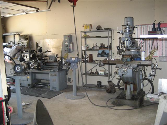

Here is a portion of my "machine area"

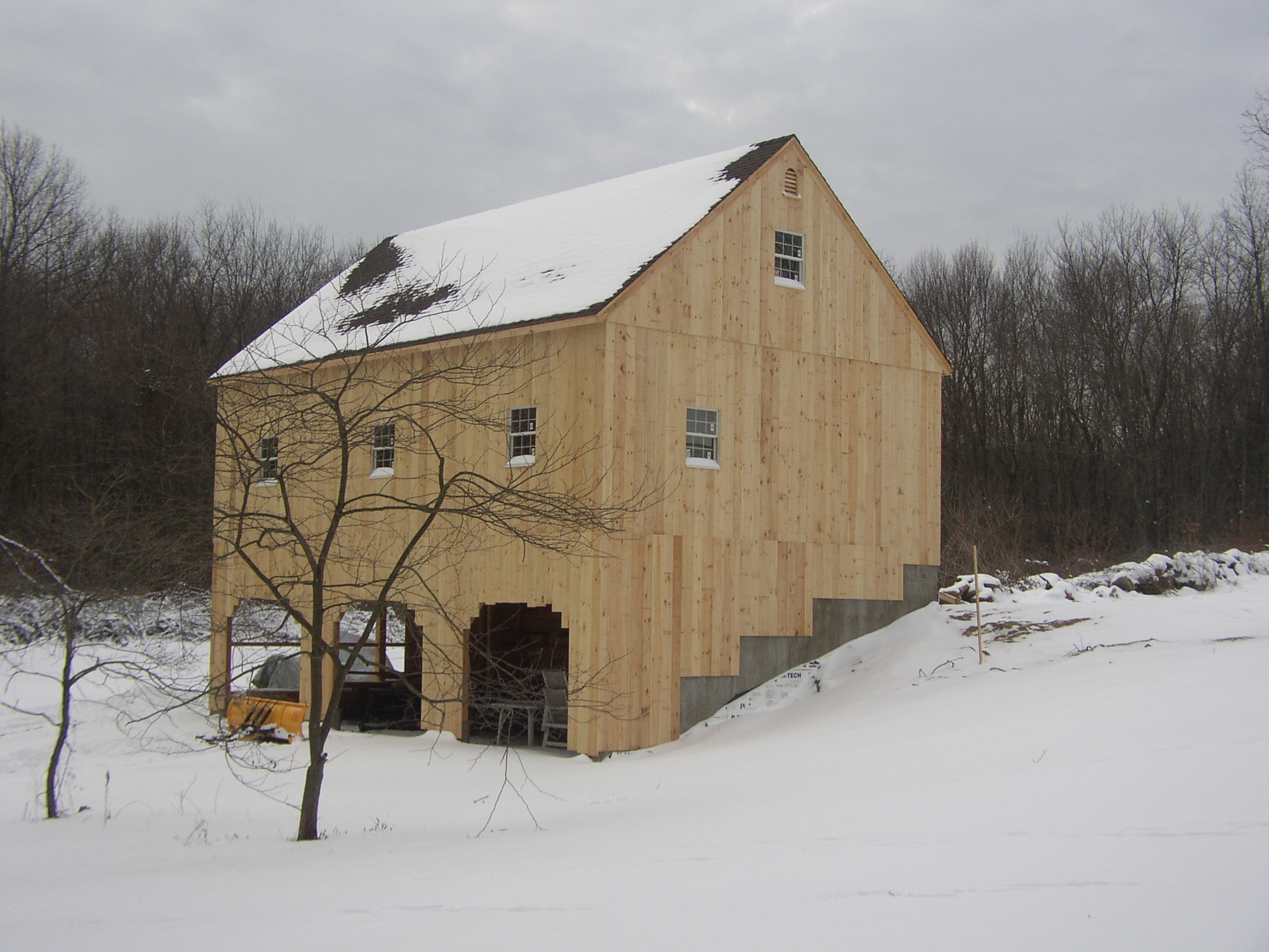

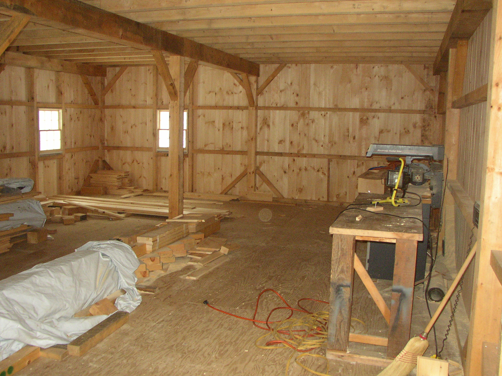

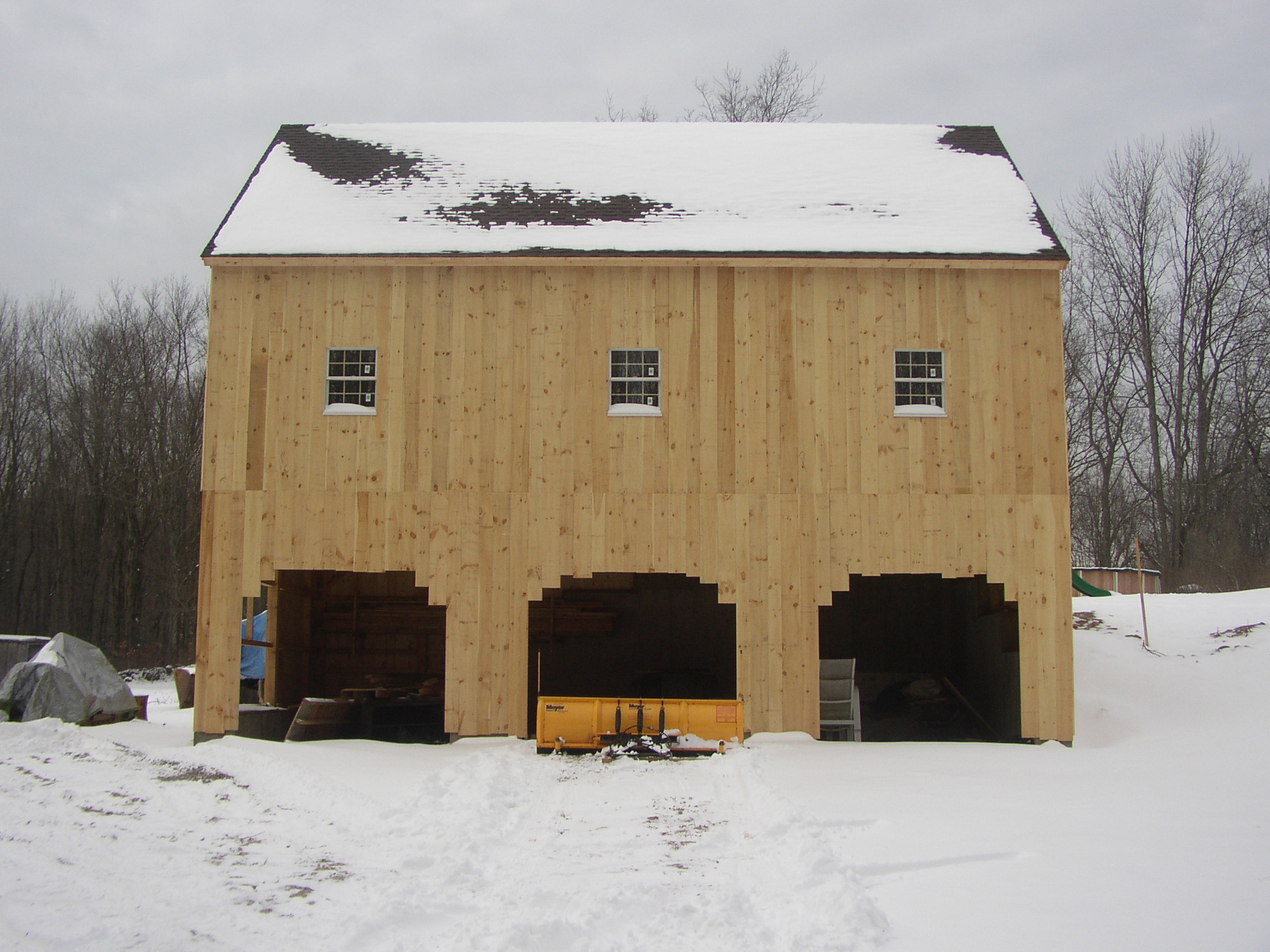

We built a 24x36 garage thats post and beam. It was a kit, and my Dad and I though that the assembly was really easy. We actually did all of the framing in about 1 weekend (my whole family are very skilled carpenters so the above may not be true for most people). The hardest part of the framing was lifting the 6-700lb beams up 10ft. Three people was not enough for that task
We did all of the escavation, built the foundation forms, poured it, and finished the entire barn so the price was very reasonable. The place we got the kit from has a demo page at countrycarpenters.com.
All in all it took about 3months tho build which included all of the above and clearing an acre lot too.
Its a 24x36 structure which we thought would be plenty large, but its not. Three Porsches and a bunch of other projects fill the garage portion pretty easily. The foundation was made an extra high 11ft so there is room for a lift. We'll get one eventually. Now we are planning a 14ft addition Just like Paul said above, we want to put a lean to on the front for some car port space (many of our neighbors think we're crazy because all of our daily driver cars are outside).

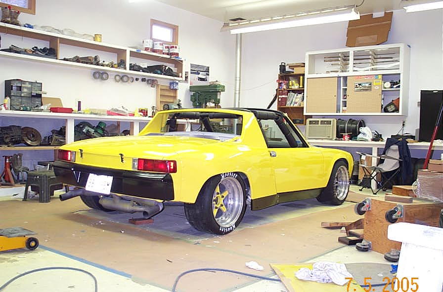

heres a pic of ours in june of this year...now, the driveway is all framed, and ready to be poured...the garage itself is almost done. During the summer, it was comfortable inside, not too hot. Use a moisture barrier under the concrete floor!

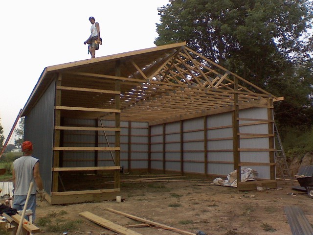

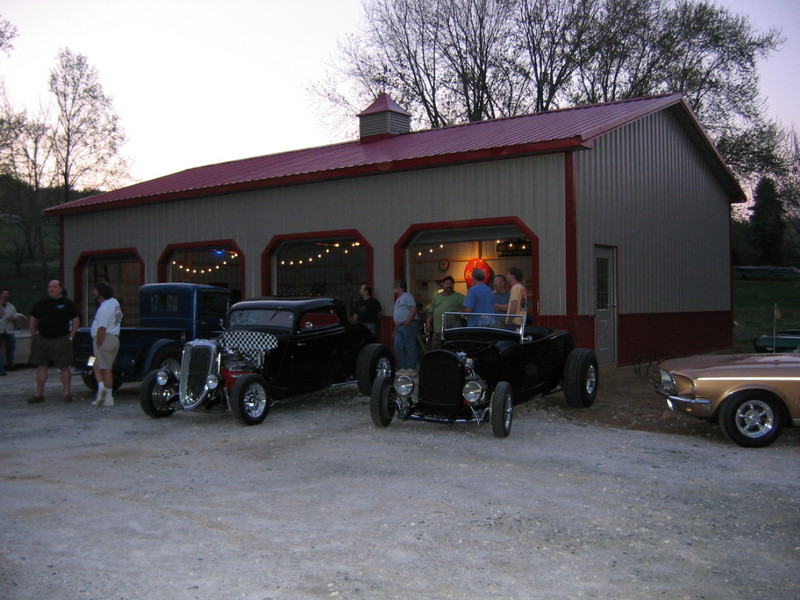

I've been on the garage journal too. I'm thinking of going with something like this.
Pole barn designs seem to be the easiest for the do it yourself guy.
I guess down in California you can get away with that, but up here you should have it heated. Plus, the pole barn thing looks so cheap. Build something that is more secure and finished properly.

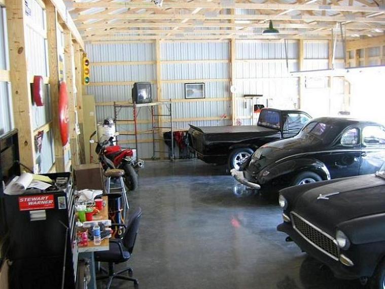

Here's the outside and the thread from the garage journal http://www.garagejournal.com/forum/showthread.php?t=7077&highlight=pole+barn
