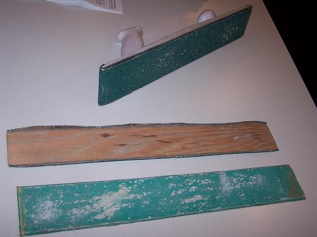

Any painter will tell you that the prep work is where the "magic" starts. Fancy paints look great but you can get by on lesser paint. You would think you could just paint over the old paint but the multi-layered "base coat" will show through, especially with lighter colors.
You could get people to donate to you some sand paper becuase that's the prep you'll have to do. Sometimes you can't even primer over old paint because the old paint reacts with the primer. Borrow a dual action sander and a compresser for the tough stuff then learn the fine art of block sanding. You can do it! Good luck!

36 or 40 grit sand paper? Isn't that a little harsh? I sure don't want to scratch the metal too much.
Don't worry about it. You won't. Get that topographical map off that hood. BTW: If you run into some stuborn paint you can use a heat gun and warm it up. As it starts to soften, use a sharp putty knife and slide it off. or heat the paint and then apply stripper. These methods work best on the 2nd or third paint job cars. The original finish will be hard as nails. Your best bet is to just sand the original finsh or what you can't strip easily.
