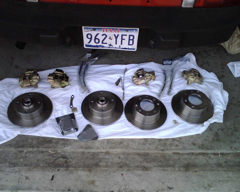

I'm using 4 new rebuilt calipers from Eric Shea. With these calipers are 4 new rotors, new front bearings, new seals, 4 new softlines, all new pads. A total of $1038 in parts from Eric.
From the pic...the parts are gorgeous!

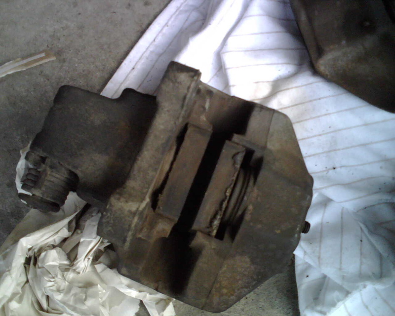

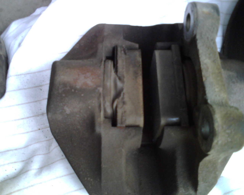

Here is the pic of the left rear caliper... not much room is there? No wonder the car smelled like hot brakes all the time!
The right rear caliper came off pretty easily and wasnt a big deal compared to the left rear. It didnt need any coaxing to get off the rotor, so I guess it was somewhat okay. It was still touching the rotor though...

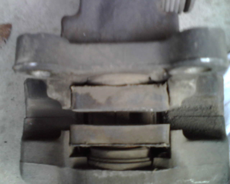

Here's the left front caliper. it was dragging slightly, but the bearing needs attention here on this one...
What's with the seals on the piston? is that right?

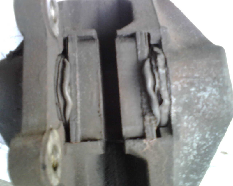

The last caliper to remove for the day is the right front. This is actually the one dragging the second loudest.
Behold my amazement when I see this....
Looks like a herniated disc from Joe Sharps XRays.....
How does this happen? These seals look completely melted! What's going on here?

Are you sure those are the dust covers we're seeing? It may be anti-squeal compound on the back of the pads. If it is the seals, this is what can happen when you have a pad dragging. They get "extremely" hot.
In your first picture of the rear caliper, you can see uneven pad wear and a piston that is out further than the other. This is indicative of stuck pistons or severly skewed adjustment. Looks like your inner piston is stuck and not working.

I've said this before; "I've seen hundreds of calipers from the inside. You can tell which ones have been maintained properly and which ones haven't. Take care of your brakes and they'll take care of you."

Eric, the fronts look for sure like the seals have flipped inside out. It's really scary to see that stuff on my car. It's no wonder only my left front would lock up the tire. that's some hairy times when I slam on the breaks
Would that explain why no fluid leaked out of the system? I can't have sealed it up with some measly saran wrap that well, could I?
No wonder the holes in the brake lines looked so tiny! When I cut them at the body they looked rediculously small inside.

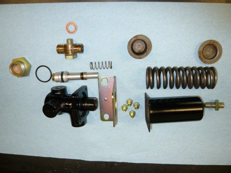

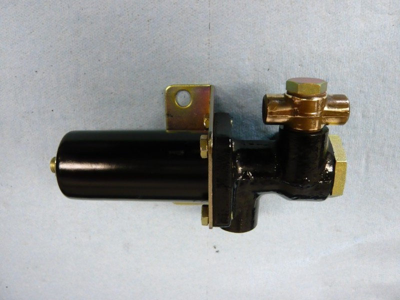

Here's what a Proportioning valve looks like opened up:
Notice all the little places the air can get trapped. There's the large body and spring. The valve body has numerous holes in it to trap the air. Without getting into how this little bugger works, you can see there are plenty of places for air bubbles to attach themselves.
You can tap this with a plastic mallet or a wooden hammer handle etc. I like to crack the right rear bleeder and stomp on the pedal. This and the tapping will free up a lot of air trapped in the valve. Then crack the left rear and do it again.
