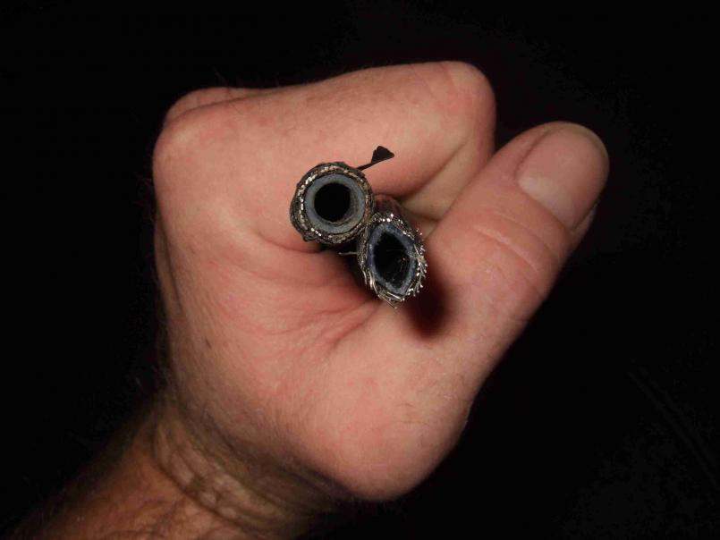

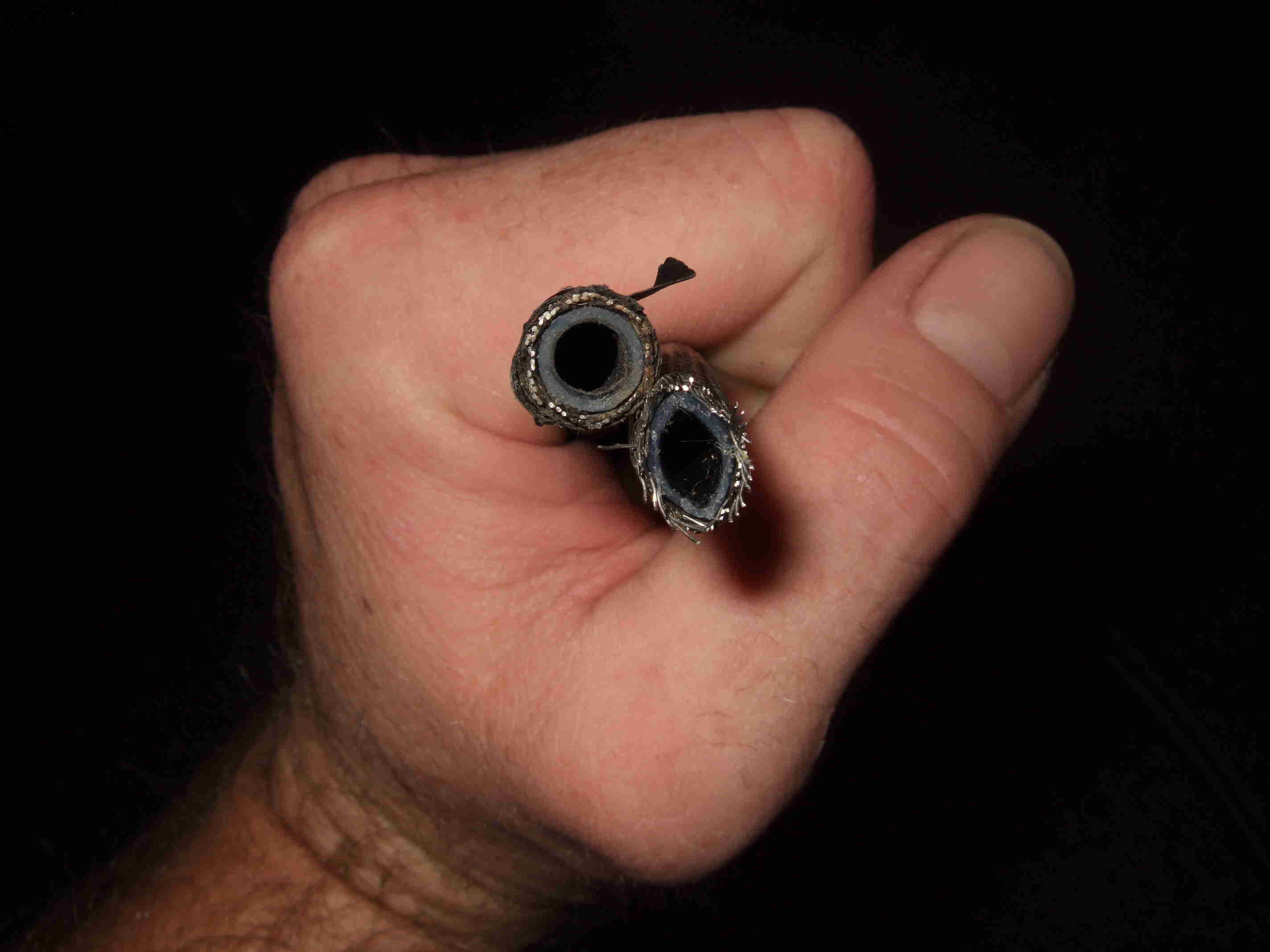

OK, here's the show and tell I talked about. This is high quality aircraft stuff. It blows the doors off of any automotive line.
The line on the left was cut using a high speed grinder. You'll notice it's nice and round. The line on the right was cut using very sharp diagonal cutters. You can see how the line is tweaked and no longer round. The line was stressed beyond its elastic limit. Kinking the line would do the same thing. The line would be weakened at that spot. Continued movement will eventually cause the line to fail.

Sorry, but how is that relevant? You've deformed one with side cutters, but how would that ever happen in automotive use? No automotive hose that is the correct length will be put into a position that it can be flexed to the point that it "kinks" the way you indicate. If it's possible to do that with the hoses on your car it means they're too short, and that would be misuse. You cut the other with a high speed wheel, the way it should be cut. I really don't understand the comparison or your point.
If you have the correct length brake hose it should never be put into the position where it can be extended so much that it's stressed. Certainly never stressed longitudinally as much as the NHTSA tensile test. The only thing a correct length hose should ever see in automotive use is movement, and NHTSA "whip" test is intended to be an extreme case of exactly that. Both braided stainless hoses and standard rubber hoses pass that test.
Do you know of any formal test data that indicates that teflon hose, covered or not, has flex performance that's inferior to rubber? If so, how much? That would be relevant.

The purpose of the picture was to show that the hose isn't as resilient as rubber. We've all cut rubber hose before. You dont have to baby it with a high speed grinder to avoid damaging it. Cut it with an axe and the end will still be round. I believed that was relevent to the discussion.
Folks that have experience working with SS hose and those that have had failures are sharing their experiences with you. Take it or leave it. If you think they're the best thing since sliced bread go for it.

First off I'm not trying to be argumentative. Please read all of this before you get pissed off.
The steel braid isn't holding the hose in that position. After the braid is cut it doesn't hold anything together. That's the reason for the tape on the line cut by the grinder. It holds the braid so it doesn't unravel. The braid is like a Chinese finger puzzle. I could peal the braid back to show you the tweaked teflon but I'd poke my finger 150 times just so you could say it's irrelevant.
A complete assembly is only as strong as its weakest part. The picture shows the weakest part. The inner teflon. The fact that you don't find the picture relevant baffles me.
Any material can flex infinitely as long as it's not flexed past its elastic limit. The simple truth is that teflon reaches its elastic limit before the stock line. I could cut a stock line with a diagonal cutters and show you it's still round. But again I'm afraid you'd feel it was irrelevant.
How is installing the line on the car irrelevant. How does the DOT check the hose for proper length and measure bend angles that might be encountered? The labratory tests are irrelevant.
I've worked with engineers for many years. They design it and I build it. I've tried to explain this simple fact to them many times. Just because it looks good on paper doesn't mean it's going to work in real life.
I hate to say my patience is exhausted. I suppose yours is too. How about we agree to disagree.
