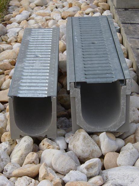

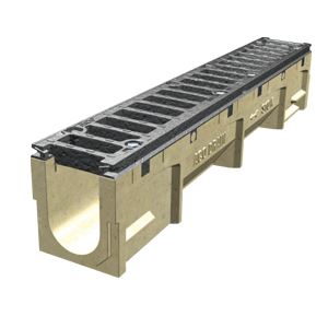

The best option would be to cut a section out and put a trench drain in and pitch it to one side of the drive. The water would come down the drive and go into the drain. Trench drains come in different widths and and have different grates types. Shop around. I'll post some pics of what I'm taking about.

With a trench drain, you pitch it in one direction about 1/8 inch per foot.
At the lowest end, you dig a dry well.
The size of a drywell depends upon your soil...in Texas there is alot of clay that does not drain to well.
Up here...a decent drywell is about a 2 foot diameter hole, four feet deep.
Fill the hole with 3/4 stone up to and above the bottom of the drain...cover the stone with weed cloth and put a few inches of soil on top.
What that does is buy you time...the drywell gives a place for the water to go and then it has time to sink into the ground.
Again....its very dependant upon you soil...that is how fast does your soild perk...how lond does it take to drain the drywell of water..
And the other consideration is this. Do you get massive thunderstorms that flood the road? if so a smalll drywell may just overflow.

I would go the strip drain route as Paul has suggested with atleast 1/4" of fall to the drain. Now some of these drain have fall built into the bottom of them so the top is level but the water drains away properly. Run the piping into your drainage system even if it takes extra work to do...Install a "Y" cleanout at the beginning so you can clean it out if it needs it.

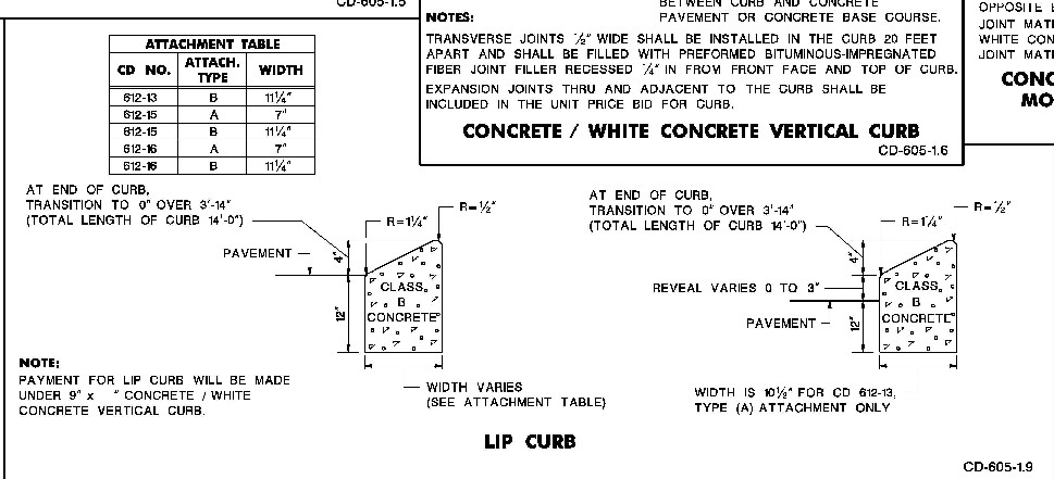

what exactly is a lip curb? Is that where the curb is shaped like a quarter pipe?

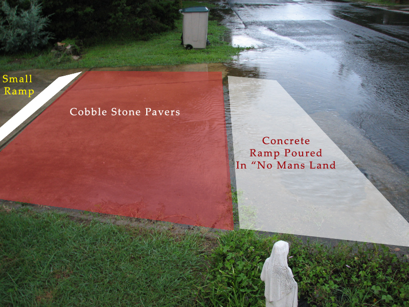

Ok, here is the pic. This was taken after a big rainstorm had subsided, but you can see the problem. Also shown is this sort of No-mans land in between my driveway and the street. Why they didn't pour all the way to the street, I don't know, most neighbor's driveways go all the way to the street.
Here is just one idea that I have where I would have to pour a ramp, but place cobble-stone pavers over the existing slab in the front. I like this idea because it can be tackled in stages that I can do by myself. Plus, pavers look nice.
That sucks - absolutely no road drainage at all! No ditch no nothing. Move
It really looks like that is standing water not just run off. You would almost need to run you lip curb 10 feet up the road.
BTW that "no man's land" on your diagram probably belongs to the municipality. Look for survey evidence as to where your property line is - probably 33' back from the centerline of the road. Someone suggested getting in touch with engineering department. I second that whole heartedly. You go changing public lands and sooner or later some PO'd official is going to show up and lay a beating on you.
