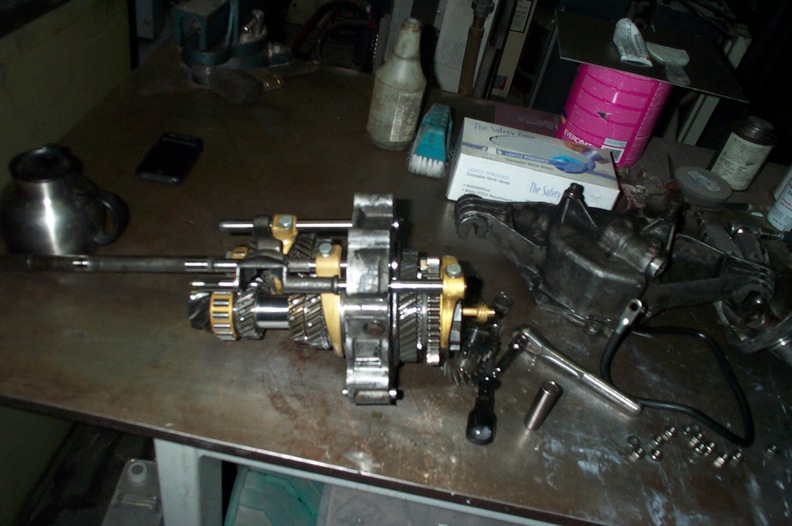

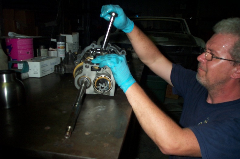

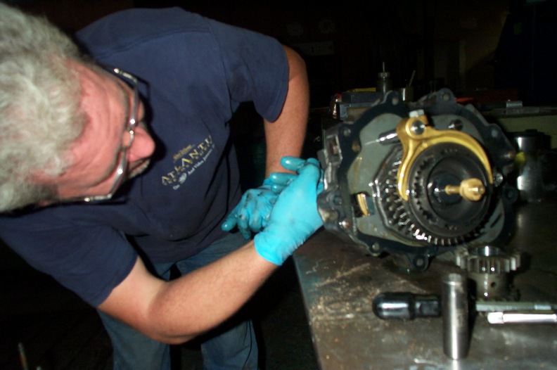

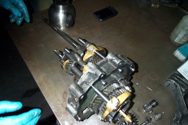

I drove over to Thomas' shop this afternoon with my tranny. He removed the back, pulled the stacks and quickly surmused the 4th and 5th gear fork was loose. A few minutes later, the fork was adusted and tightened, the stack replaced in the case, and the back bolted down.
You can't see it real clearly form this picture, but the 4th 5th gear fork is out of position. Thomas noticed the bolt was fairly loose on this fork.
Note the alignment jig. Yep, he made it himself from an old tranny case. In the background is his 1.7 10-year project.
