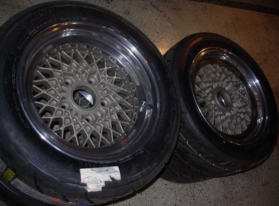

I already have a brand new set of street tires and two sets of used Hoosiers.
Its a huge benefit that my brothers tr4 takes the same size tires so I can use his "old" tires since he doesn't use them till they are useless.
