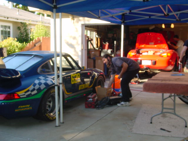

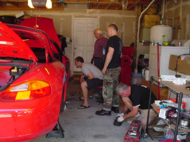

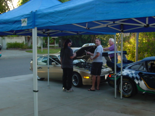

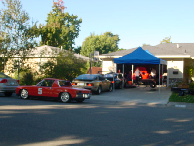

The work crew begins to show up....
McMark, Brad and Randal looking at Randal's clean 944.
Bill P.
Doris cooking breakfast for the crew....
Fritz has dual distributors...Doris has dual frying pans!
Bill P.
SirAndy has arrived!
Dan (Almaden Valley) shows up....

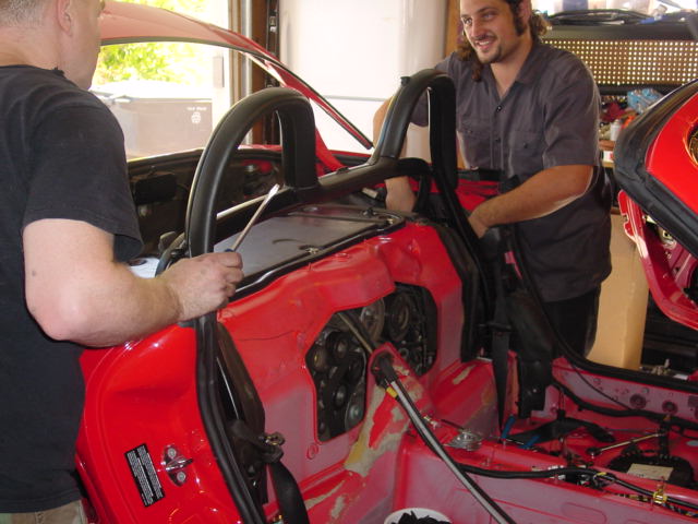

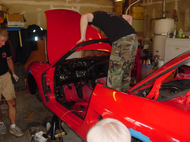

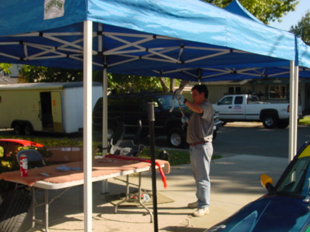

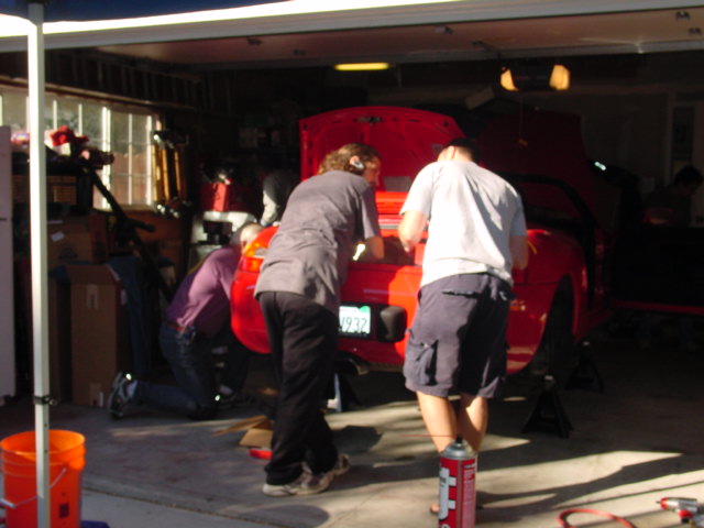

It is now 2:24pm PST. We started at 9:00am....

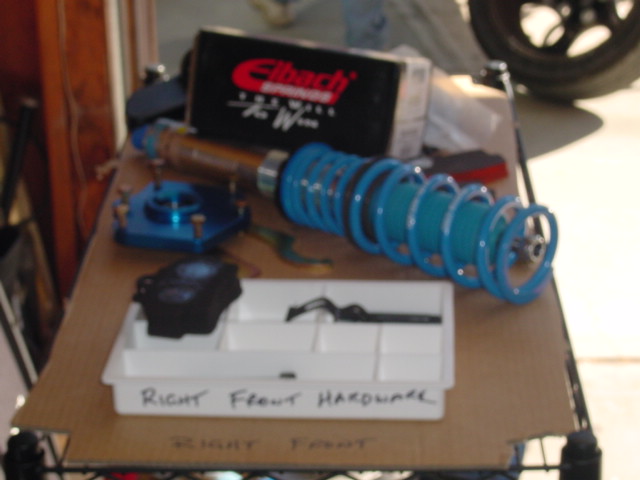

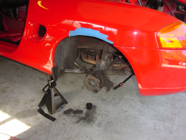

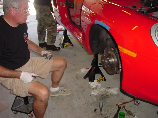

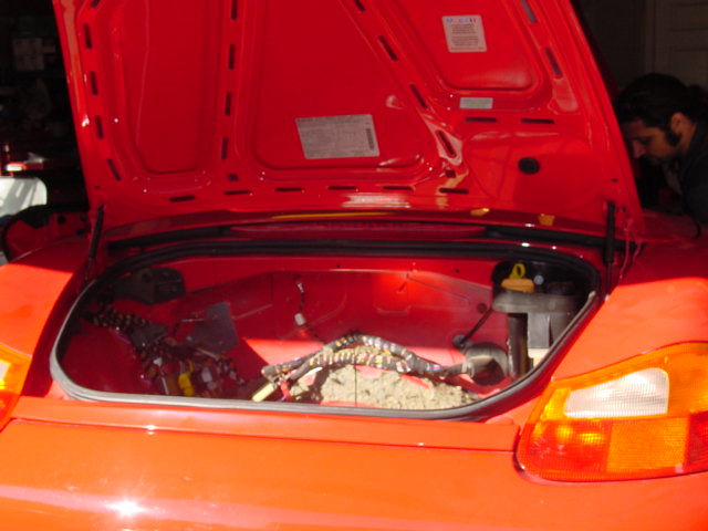

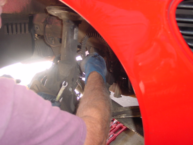

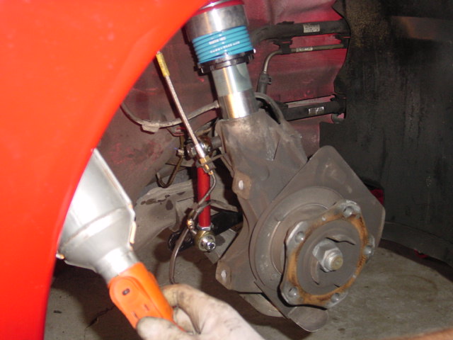

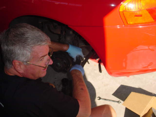

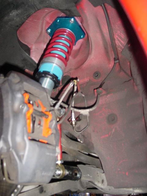

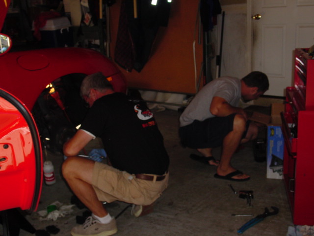

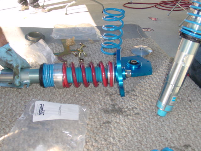

Front suspension and new brakes/rotors in.
Front and Swaybars in.

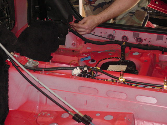

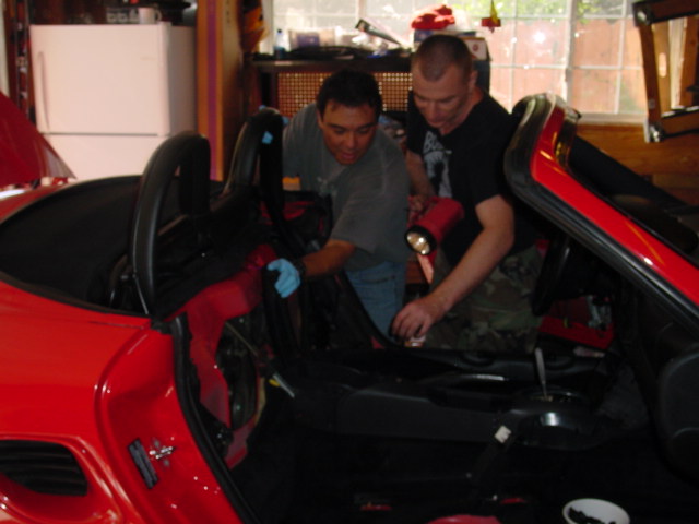

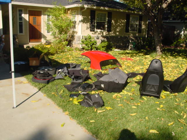

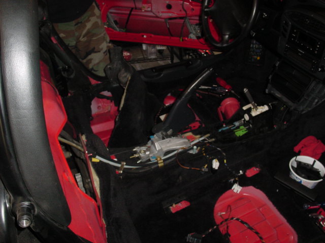

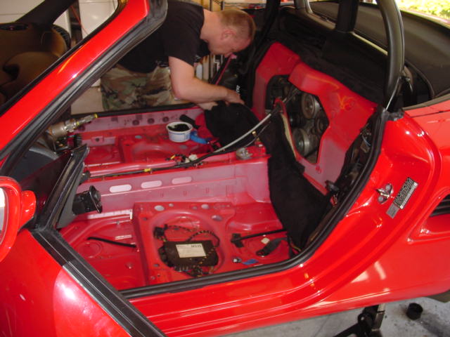

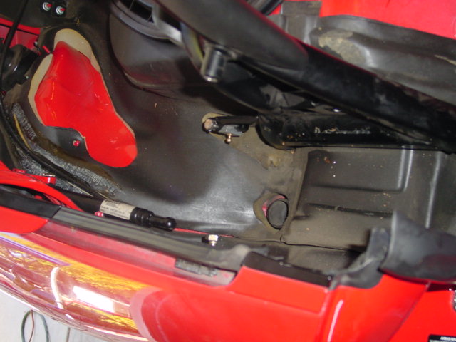

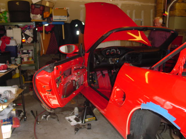

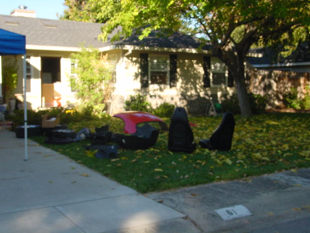

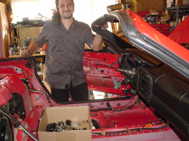

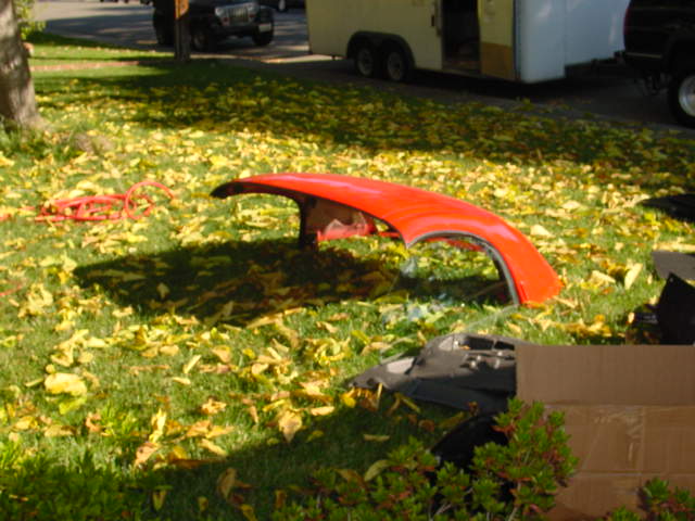

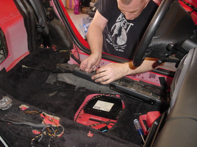

Car gutted.

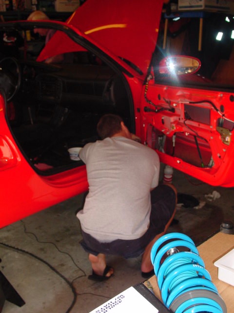

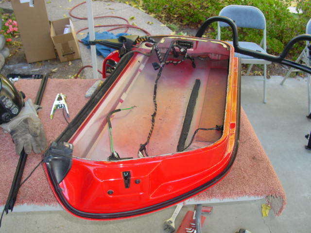

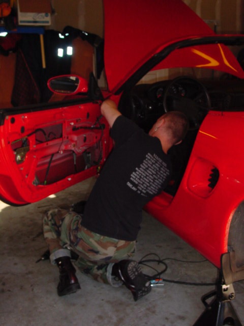

One door gutted.
Now starting on the 2nd door, the dash and the rear suspension.
We are shooting for a test drive at 5:30pm to bed the brakes.

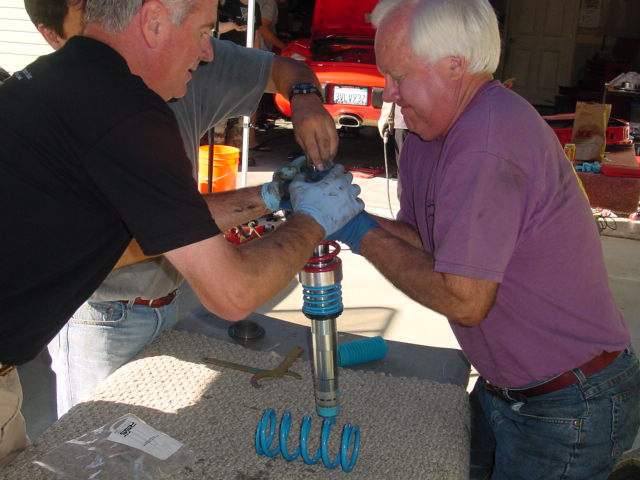

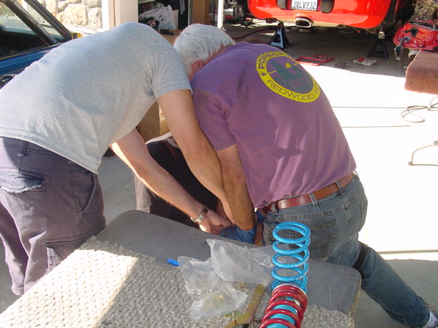

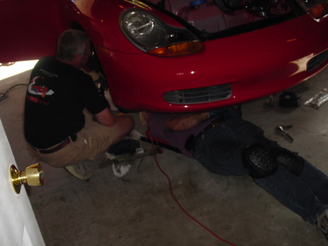

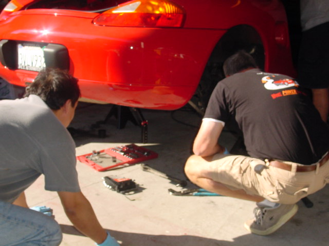

Had a great time Randal and I handled most of the suspension and brake removal/install.
Actually went fairly well....finding the right tools when you needed them was the biggest time user.

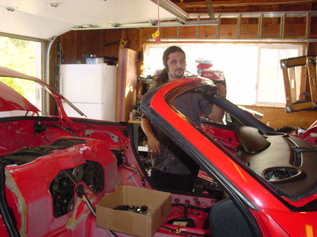

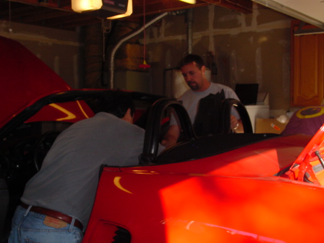

Andy, McMark and Brad handled most of the interior/top removal.
It was extremely interesting to see the inner workings of a Boxster up close and personal...

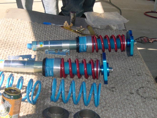

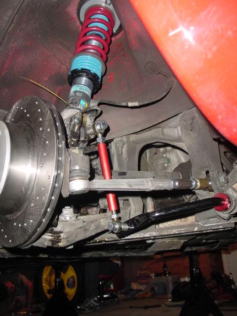

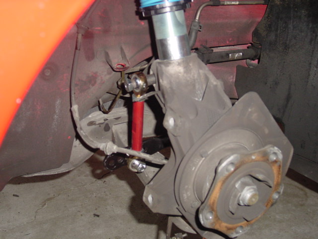

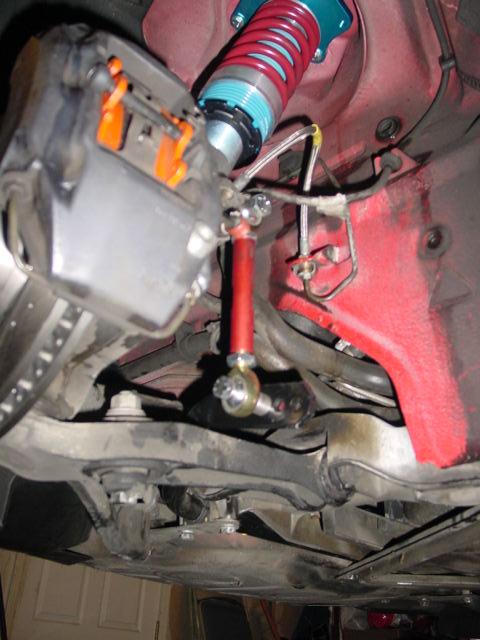

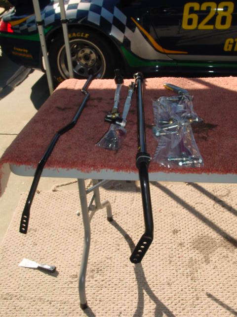

Ira from Tarett Engineering really has nice stuff...
Check out the rear AR bar and toe link...a twist of the wrench to re-adjust from track to AX settings...

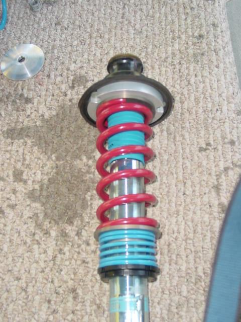

I screwed up in my undertanding of what was needed from the race shop in LA that I bought a few of the trick suspension parts from. It appears we needed to leave out the tender springs on the car....it's a beautiful Boxster 4X4!
So....

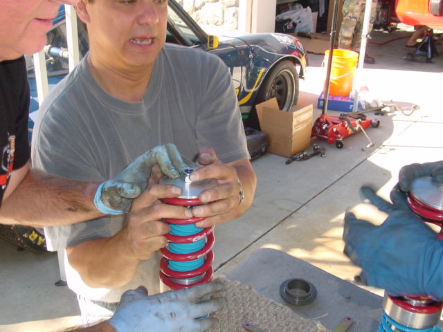

Today we get to R&R the springs ONE MORE TIME!
Here's the pics of the rear and front suspension where you can see that the tender springs combined with the very stiff Eibach's leave little room for adjustment in ride height.
Bill P.

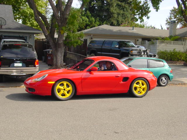

we already *DROVE* the car around the block last night, 11:30ish ...

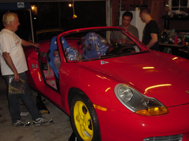

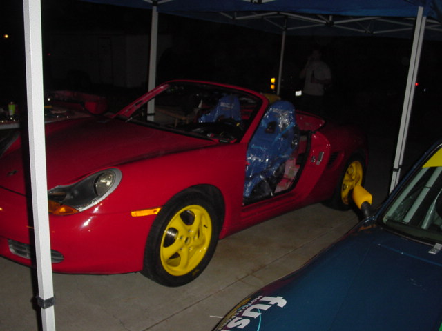

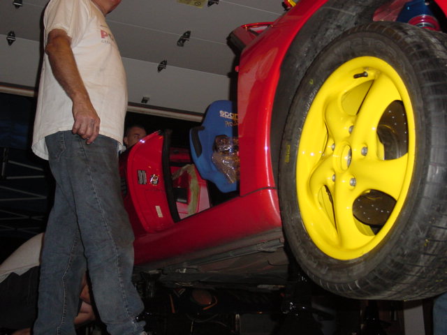

Spec Boxster build is DONE @ 1:30pm Sunday!
We've been busting the car around the back streets....all I can say is.....WOW!
The car looks good and the handling is neutral. Brad remembered talking recently to a Porsche technician who had come up with a way to access the struts without taking the entire suspension assembly apart. We were able to have the fronts swapped in a little over an hour and the whole car swapped in 3 hours. It took fiddling with the ride height to get it dialed in for about another hour or so, but after that it was back together.
All I can say is:
THANK YOU to the Spec Boxster build team:

P.S. This was an amazing learning experience. The adjustability of the components allows for some pretty sophisticated setups if we choose to do so. The amount of work done from 9am Saturday through 1:30pm Sunday was fantastic. This would have been a very long car build at a race shop. We did it in 28 hours.

Can you say....."negative camber".....

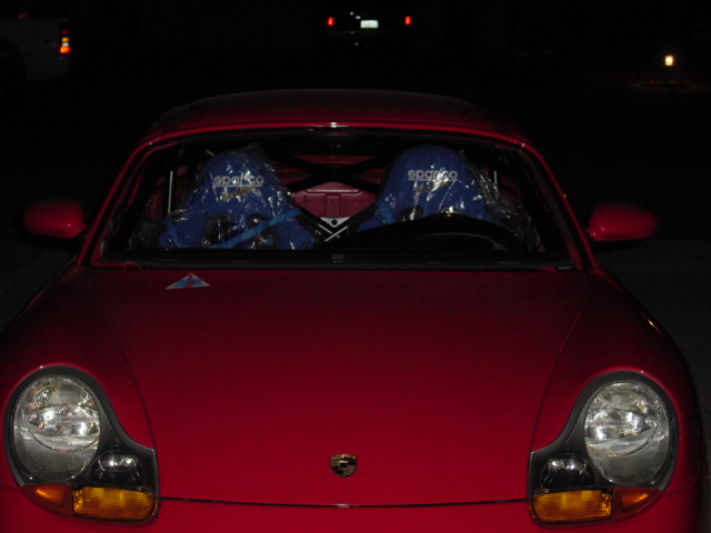

Next up I drop the car with Tony at TCDesign tomorrow morning for a custom cage. We pick up Lucille on Thursday evening.
Friday (10/27) she gets the windshield installed and a 4 wheel alignment.
Friday night (10/27) I assemble the racing harnesses and re-install the dash.
Saturday (10/28) we take out Lucille to her maiden AX at GGR#9 at Alameda.
450lbs springs in the Front and 500 springs in the back. Front and rear adjustable swaybars. Bilstein PSS9's. Adjustable rear tow links.
We will be playing with the setups at the AX.

And Randal.....well Randal spent a lot of time on his back............under the car getting really dirty.

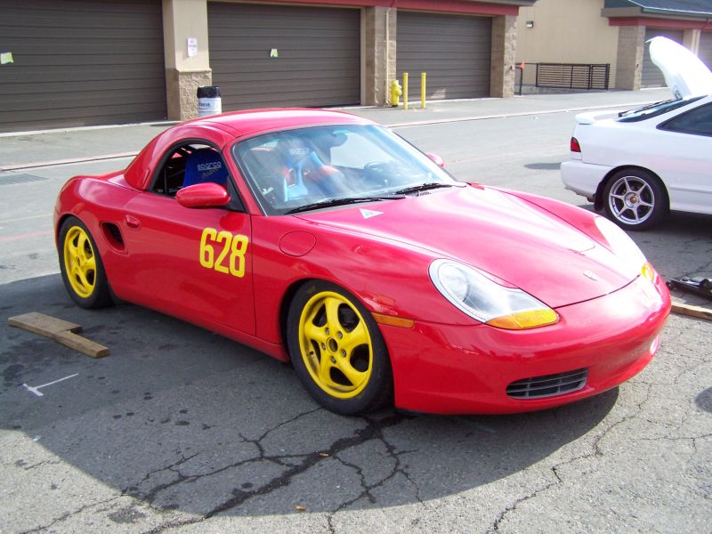

Will the #628 be on this car, too?
KT
Bill,
You should check with Jim Calzia....#9. I heard he may be moving on to vintage racing or some such....
Also check directly with Laurie Hageman-Dean. AS the TT registrar she has control of the #s.

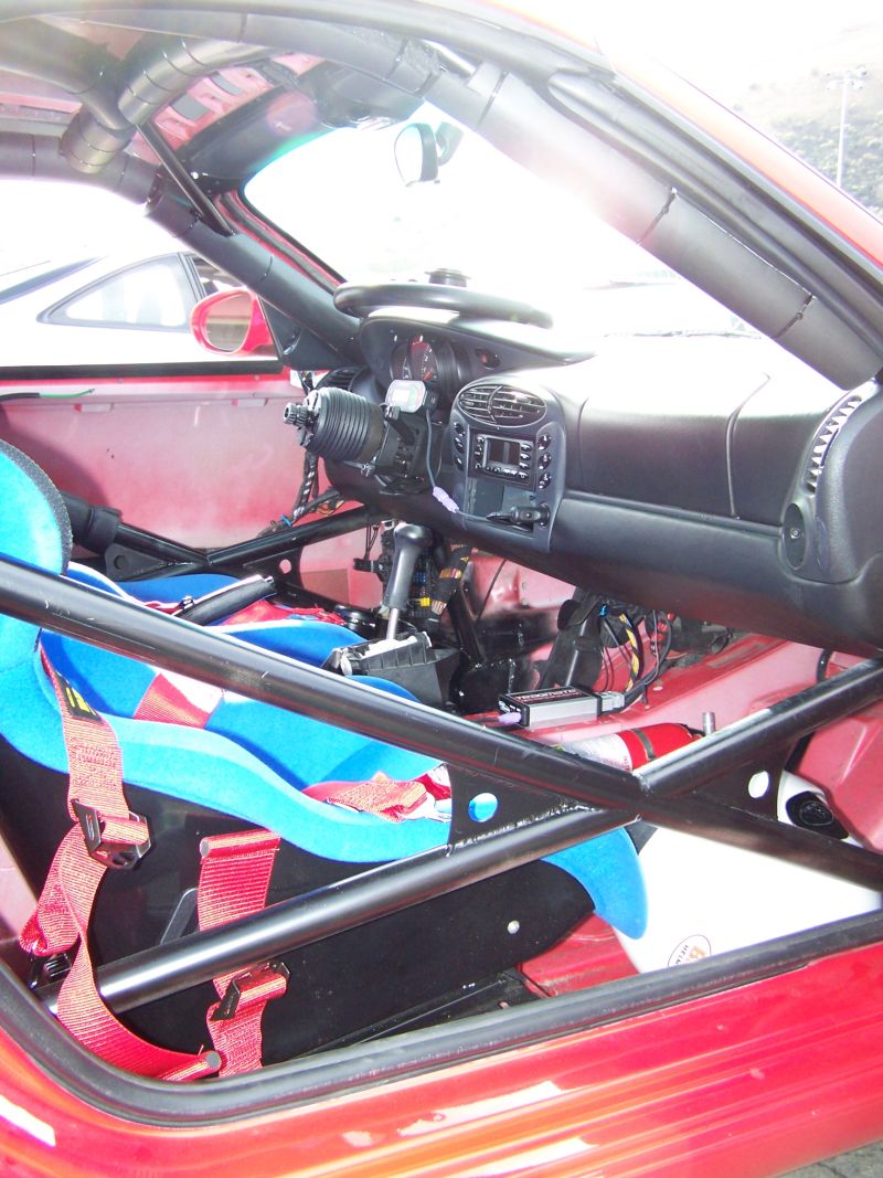

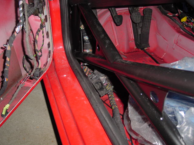

I'm HIGHLY concerned about the main hoop and A pillar bars!! I dont want him to have to make 3 main hoops before he figures it out. Did you discuss this with him? The whole "helmet" against the cage thing?? He needs to stay as tight as possible to the hardtop for the A pillar bar. Also make damn sure he doesnt block the center engagement for the top at the top of the windshield..LOL
I wish I was there helping him zip in the scab plates and get the interior ready.
I also wish we would have cut down the studs and prepped the scab plate area's for him.. oh well.. he is getting paid for this..LOL
B
B,
Call Tony ASAP if you can. He's laying out the design right now...they are going to make tracks.
(408) 956-1526.
Bill P.
I called him and voiced my concern. I also went over some of the dash stuff and how he was going to do the cage.
It will be BADASS!!!

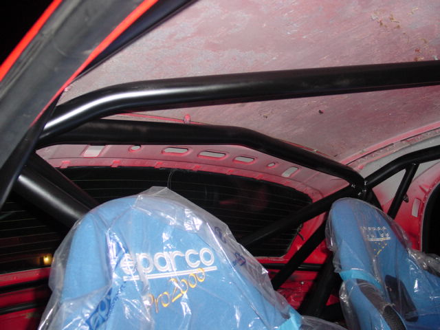

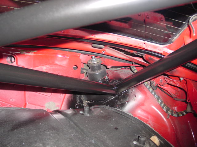

He is going to use the new 997Cup style design
B
The 997's have an X behind you in the main hoop and an X from the top of the main hoop to the rear strut towers.
He just called me about modifying the top near the location of the main hoop, so the A pillar bars will move over a little bit allowing more room. I told him we had to remove the factory latches and trim them for our main hoop. They still work fine, but need to be trimmed down a little bit.
He had the scab plates welded in before noon. We also discussed moving the fuse panel forward of the A pillar bar. I also warned him of the top latch for the windshield hoop.
B
The biggest issue is: making sure the seats dont interfere with the eyebolts in the forward or "back" positions.
Have him do the nut plates for the sub belts also!!!!

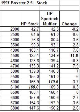

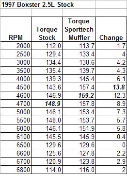

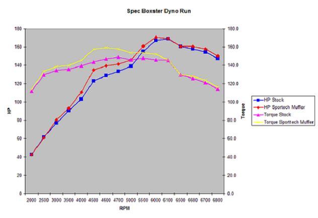

Bill, you should get Mark (sportech) to slap on that muffler while the car is there getting the alignment and windshield done on Friday....
I don't think Mark is going to have a time limit set. And since you are a good friend of mine he knows you are good for it...or he'll get me the next time I am at the shop.
I meant to ask you on Saturday. Did you desnork the air box? That is good for some sound and maybe a HP or two....at least it sounds better.
That sounds great....by the way that muffler is the one that came off of my car several years ago when I put on the SS Dansk sport muffler.

I have been inside of the 2.5+2.7 mufflers. We spent a lot of time in them while I was at SSI I know how they are baffled.
I'll stick with the $150 Flowmaster that Chris Murry runs

I just talked to Tony at TC Design. The cage installation will be finished in the Boxster between 3pm and 5pm today!....
Bill P.
It will weigh 2650 in its current config with cage and half a tank of gas. The only difference currently between this car and the one I run is the fiberglass GT3 nose and the third radiator, BUT he still has his AC/Heat box in the car and functional. I'm betting this weight is a wash and the car will weigh 2650 +/- 30lbs. I weigh 200lbs and checked in on the POC scales at 2850 with me in the car on Hoosiers.

The cage is AWESOME!!!!
Get this....you know how most other spec cars have the end caps of the dash cut....not Tony...
You know how some cages you can see from the street in the A pillars and make you feel claustrophobic?.....not Tony...
And you know how some bars go through the AC directional vents?...not Tony...The vents are left stock...I may even be able to use flex hose and still make the AC run through the side vents as well, not just the center vents. Totally trick!
GT3 style X bracing in the main hoop and in the attachment points behind the motor, yet there is no blocking of rearward visibility. And he moded the hard top and radiused the bends of the cage to match the hard top contour. You cannot see the upper halo while looking at the car from the side.
Do you guys really want pics now? It's dark and I'll have to unload and take pics in the dark....I still need to clean up the garage to fit the car in it....
Oh...and did I mention that all of the cage was TIG welded....no MIG on the thing...
This thing is a work of art!

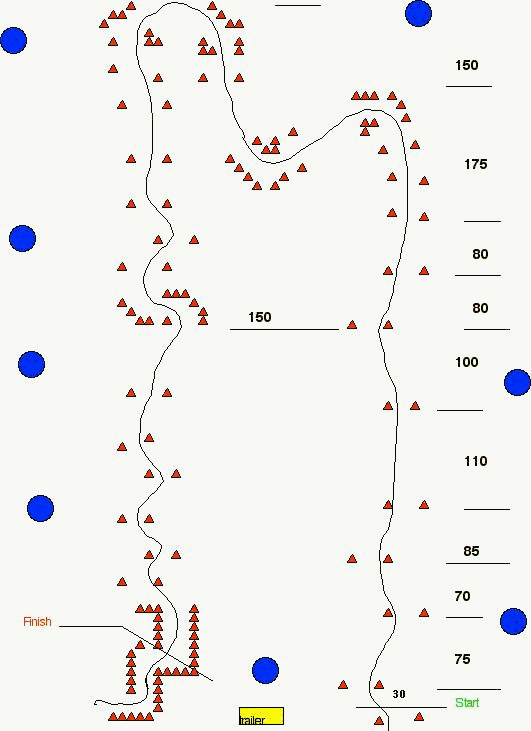

latest course layout....basically the same course with less cones and a couple of areas of fine tuning.

Okay...okay...geez....I pulled the car out and started snapping away....
side view...the bars are hidden...
rear view....x brace
driver's side....where's the roll cage?
passenger intrusion x brace...
sick
very nice.
A pillar....notice how close to the A pillar the bar is...the AC grill is untouched and sides are not butchered...
Let's go inside and see all the custom bends on a hand built cage....notice how Tony snugged everything up to the top...and the latch is free and clear!
Continuing the tour....
All the points meet up...
and the rear mounts...
Now you got the beat!!
KT
My knee bar is the same height, but your A pillar bars are farther forward by 3/4 of an inch or so. I didnt want to relocate the fuse panel. I totally see why he didnt cut the dash.. and now I'm wondering why we cut the black car!! The black car has the el cheapo dash in it so it really didnt matter.
I like it. Looks great. I also like the lopsided door X.
Cant wait to see it with the top off.
B
When we spoke on the phone he asked me about cutting the stock top. I told him to go for it!. I see what he did now. He cut the top back for the A pillar bars. This allowed him to move them out farther away from the drivers head
B
Yeah...next time you are around you'll have to sit in it. The cage doesn't feel like it's right next to you. It feels comfortable.
I've got to get that quick release on the steering column ASAP. I almost broke my back getting in the car when unloading from the trailer. The window opening is much smaller than the 911.
Don't forget to feed me the alignment settings...
Bill P.
booyaah!
Tony did an excellent job
really trick how he did the extra diagonal braces on the front hoop
and the way the dash fits
looks like it was designed and installed at the factory
one question...
when you're sitting in the car, how's the head clearance to the top front bar?
The weight of materials for the cage came to 85lbs.....
Bill P.
Bill, in all my years of building race cars I must say the cage is a work of art. Tony's last name should be Picasso. Good job!

Randal and I worked on the dash tonight. The dash is back in and everything electrical works except the turn signals. We don't know why...but since the car will never see the street again, it really doesn't matter.
Heater controls work
Defrost controls work
AC controls work
Traction Control button works
We also:
adjusted parking brake
cleaned up some wiring
re-attached hard top locator tabs

6. Figure out how to adjust AR bars quickly (we will be trying different settings between every AX run on Saturday).

I just got Lucille back from Sportech. She looks pretty slammed but we can go lower. I didn't want to bottom her out just yet because I want to maintain as much shock travel as possible. Right now it's an eyeball job on how low to go in comparison to the shock travel. I will leave it for the AX and the first track day as is to get a baseline.
Initial settings are:
Front
At the current ride height the most camber we could get was -2.75 degrees. Toe is set for zero.
We did not touch initial ride height from where the build team set it.
Rear
We set the camber at -3.0 degrees. Toe in is set at - 1/16".
We lowered the rear another 1/4" from where the build team set it. The car now has 0.5 degree rake.
The gutted muffler sounds GREAT! I'll dyno it in a few weeks. We're hoping to pick up a few HP on the upper end of the power band for the track.
I drove the car around the neighborhood with the new alignment. The car's handling is killer!....lightning quick and very stable. I took it up over 100MPH on the expressway and it's just like a cruise on the highway....this thing is going to be one nice car!

maiden voyage went pretty well.
Rode with Bill on his first 3 runs this morning. Car handles great. Immediated turn in, good throttle response, car rotates nicely.
All with base suspension settings.
I'll let Bill reveal his times but I think he finished pretty much where I predicted he would.
By the way the 914club was well represented today.
Tom was there with his son and 914aroo, Demick, Trekkor, Myself and a couple others that I don't know.
Demick and Trek got into the 46s, I had a 47+ with the orange putput.
Grant was scrubbing in his new tire/wheel combination on the Mazdaspeed6, and Nathan was there shredding tires with the Firehawk.
As usual The Smurf was way up on everyone.
Spec Boxster Plus driving impressions:
WOW!.....
Randal will need to post his impressions but I was truly suprised how good the platform was out of the box for us. We set the AR bars neutral and the shock rebound full soft and combined with the 450/500 springs the car was a delight to drive right from the start. We could run the car flat out on the high speed parts and yet turn very easily in the low speed stuff. That is very different from Fritz or from my earlier 914-6 which required me to adjust my AR bars for an either / or combination.
We definitely me our goal of putting the car in the top 10. On raw times we may have stuffed the car in the top 5, but I was so tired I didn't read the entire posting sheet and our second set of runs I just wanted to drive and not fiddle. For the afternoon Randal and I just drove the car, we didn't even bother checking tire temps anymore....
I'd never flogged a Boxster except at an AX school with a studen't car. The Spec Boxster Plus feels like a slightly bigger, heavier 914 with alot of torque, and this from the 2.5L small motor version. I have been so lucky to drive some pretty fun cars, my 914-4 and my 914-6, Fritz, and now the Boxster. Taking lap times out of the equation, and based totally on the fun factor, my 914-6 was always my favorite for AX and Fritz for the track. Our Spec Boxster is easily my favorite now for AX. And soon we will be testing on the track and we'll see how that goes.
For various reasons (financial being a large part) we will keep the Spec Boxster at the mandated 2700lbs per the Spec series rules. However, the long term plan is to change the car to a lighter version with more power, all the while keeping the car narrow body for ease of double duty (AX and Track). So we'll be collecting parts that will help lighten the load (i.e. f/g lids and such), and deciding how to get more power (2.5L mods? stuff in a 3.2 "S" motor? stuff in a 996 3.4?, etc).
The evolution of the car has just begun, but if anyone wants more detail just ask me. I'll be glad to share our experiences with you, including cost. And I'm sure any of the build team would be glad to tell you what was good, bad, ugly or funky about the car.
McMark
Brad
Randal
Special Guest Ken J. from the Boxster Racing Board (unofficial photographer)
I really owe you guys big time!
Bill P.

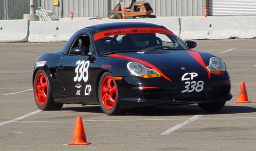

Action picks from GGR#9....from street car to Spec in 8 days.....
Dan Thompson and I at the sweeper at end of course....
Bill P.
another...
Dan Thompson and I braking and turn in after the high speed section of the course....
third pic...
Me trying to find the limits....this was a DNF....
4th pic...
Randal in the tight stuff....
5th pic....
Randal starting in on the backside of the course...
Might have had something to do with the excellent alignment he got at SPORTECH.
Not to mention the discussion we had with the car on the rack about what to use as base suspension settings for it's first runs.
Shocks on soft and sway bars set front middle setting and rear 2nd softest.
I think the car did pretty well set fairly soft.IMHO
Seems to work pretty well with the weight loss and the nice cage to stiffen up the chassis.
Oh and that muffler sounded pretty sweet up in the RPMs.
Bill, all that toe in on the front is probably why it turned in so nicely and did not push at all...
A bit more camber would be nice
Instead of more lowering, how about slotting the strut towers some more first to get more neg camber?
If you get it much lower in the front you won't be able to get those 255s you wanted to try under there without a bit(bunch) of rubbing.
255 and 275 V710s would be killer for AX next season.
A very nice first outing for Lucille.

I was loooking at elongating the slots. I'll have to take a look and see if the plates will hit if we move them over anymore than they are.
I'll be at Sears for the first track outing on Sunday, Nov 12th.
B,
Do you think I can lower the car even more to gain camber or our we at the limit? I don't wan't to run out of shock travel. And it would be nice to try some 255's up front...

Randal would have been faster on my suggestion (full soft on the bars)

I think 1/2 an inch would be safe. I just dont want you to blow up your new shocks. They dont like to be bottomed out!

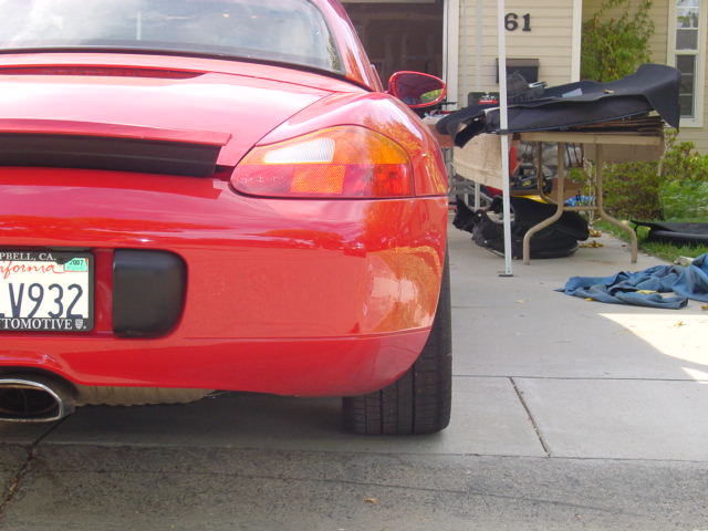

Trying to compare the ride heights.. It has the 993 rears on it in this pic and Boxster fronts.
Damn. That 275 looks BEEFY on the back..LOL
Just noticed that!
B
Right now, the black car rubs both inner wheel well plastic pieces. This could be happening for multiple reasons.. but it will happen first towards the front of the fenderwell. It will only wear once.. then you have a small hole. It wont even create an smoke..LOL
1/2 inch looks good. If you had the toe plates you could do this on your own and set the toe at zero.

With the bar adjustability you have.. the 255-275 flip will be fine.

My 2nd pass of dyno results are in. This was where we took off the stock muffler and bolted on a modded muffler from Sportech, a local shop here in Campbell, CA. The interior baffling has being redesigned for better flow and the size of the outlet opening changed.
Our results show the mods were very successful for the stock 2.5L motor. While peak HP is up 1 HP, the 2300 to 6000 RPM rev range shows a very flat HP and TQ curve with most of the range showing 4 to 11.8 HP improvement. Torque is up considerably as well. We made a significant improvement in the meat of the driveable power band.
Here are the HP numbers:
Here are the Torque numbers:
Here is the Dyno Chart:
What was interesting is that I pulled dyno runs on the car with new muffler with the snorkel on the airbox on and with it off. Supposedly this makes the engine breath better. While the intake sound is much nicer, there was NO DIFFERENCE in performance.
Some of the aftermarket companies claim an 8-10 HP improvement with an airbox mod or a replacement. A mod seems to be the only way as you would need to change the airbox to promote different airflow characteristics. Probably combined with a chip mod.
Overall I'm extremely happy with the muffler mod!

Nice work on the power upgrade.
KT
Bill,
I am impressed....I didn't think it would make that big of a difference...
Pretty good for just gutting and a little change in the outlet size...
I guess Mark may be on to something
Glad I convinced him to give it a try....he has been doing the same thing to 911 mufflers for years....another one of those tricks taught to him by the "original" Ken....
Some of those old racer's tricks still work evidently.
Yes, you need to weigh the HP/torque gains against the cost...but with a 2.5 there really aren't any other options.
From what I have read...headers are the next step along with either sport cats or no cats...
Seems logical for the headers....have you looked at the stock exhaust manifolds...pretty cheesey..
the headers would smooth the exhaust flow not to mention opening things up a bit...
I would think the headers would move the torque band up higher in the rev range...
There is so little out there as far as solid information....on all these mods.
Have you contacted evolution motorsports? They have lots of performance mods for the 2.5 and have tested them together...you might want to give them a ring.

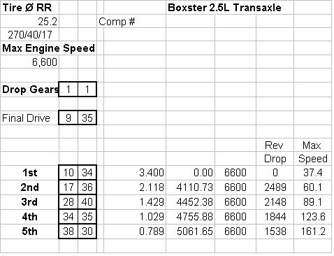

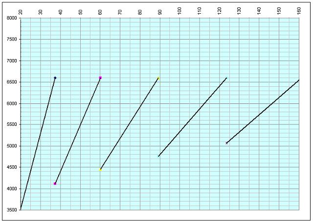

Since I wish I could have close ratio gearbox for Christmas....here is the Spec Boxster's gear ratio chart....pretty spread out.
Bill P.
Yep. The factory manuel shows the same graph.
The 2.7 box isnt much better.
B
I talked with Paul Guard and Vision Motorsports (Kokeln) this morning. Gear sets are in the works but no timing. "Maybe" next year.
Bill P.
Yep. I knew that too..LOL Paul is getting tired of me calling. I could have had Jap gears by now.
The people to contact are the Audi people.. Audi box.. maybe locate another Audi box that has better gearing.
