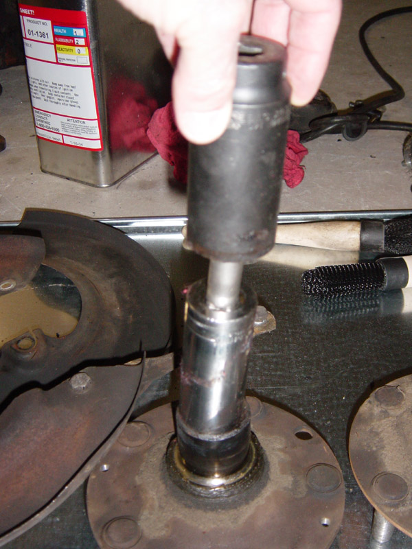

I just finished assembling my trailing arms and I experienced a small problem with the edge of the hub when pulling it through the bearing on one side. It seems that the lip of the hub was catching on the bearing and wouldn't let it slide in strait. So, I took a small dremmel and smoothed out the lip of the hub and it slid in like butter!
The moral of the story is (if it don't look right....don't force it!)
Jeff

Custom hitech tools needed!! (IMG:style_emoticons/default/wink.gif)
Jeff

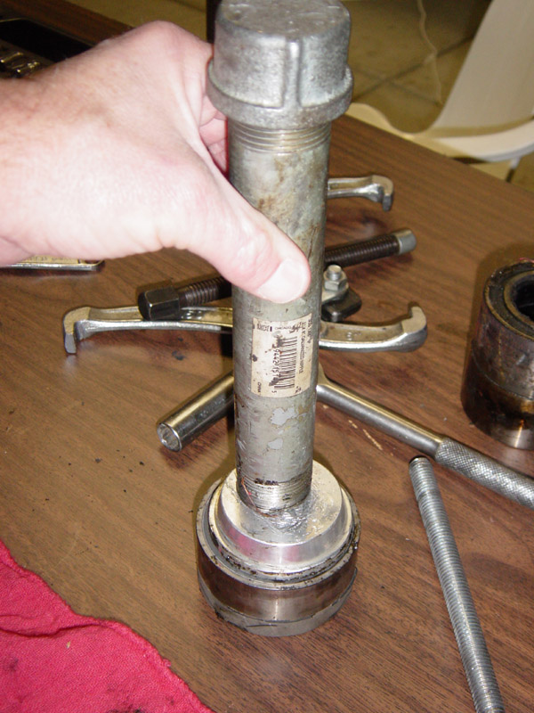

More tools!
Jeff

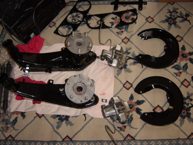

After you get done, how do you insure that the "Hats" are on straight? The first time I tried, I tightened down the little beveled screws and the disc bound on the caliper (W/o pads, even!) I then just spun and tightened, spun and tightened until I had clearance. Is that the proper way?

I put the drive shaft through and tighten it untill it seats properly then you put the rotors on! If you try to put the rotors on before properly seating the hubs then they will not line up with the calipers!
Jeff

Jeff, that looks very clean. Good job!
Thanks! It is a long slow process but it is very rewarding to look at!!

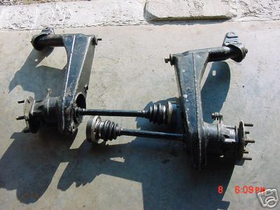

Jeff,
I just got this setup and was wondering what calipers you are using and where you got them. If they are as tight as the seller says I will just POR15 the arms and install them.
914 trailing arms with 5 lug 911 hubs, bigger driveshafts and cv joints. Perfect for v8 or race application. You will need to get the  later, larger 901 transmission hubs or change the inner cv to stock 914 to make this work. Wheel hubs are not  redrilled 914 hubs. All cvs and wheel bearing are tight and boots are good.
