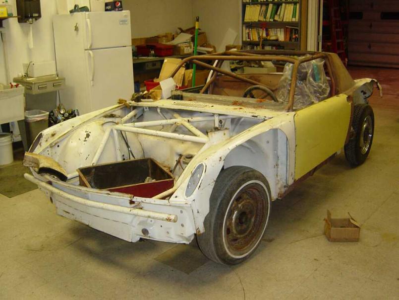

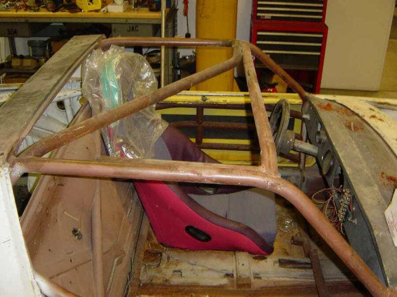

Back in April 2009 I bought a real 914/6 that was raced in IMSA in 1979 and 1980.
This car was in storage since the late 1980s, in fact I had considered buying it back in 1990. Here is the car as it sat in Mark Kinnaman's (Bartlett 914) shop after I bought it.

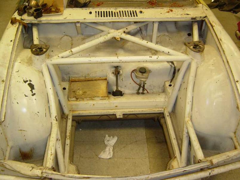

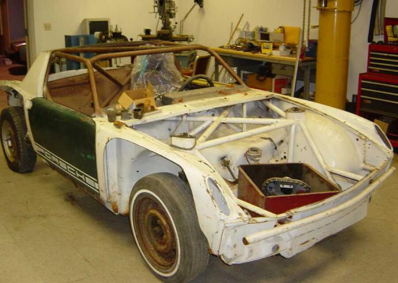

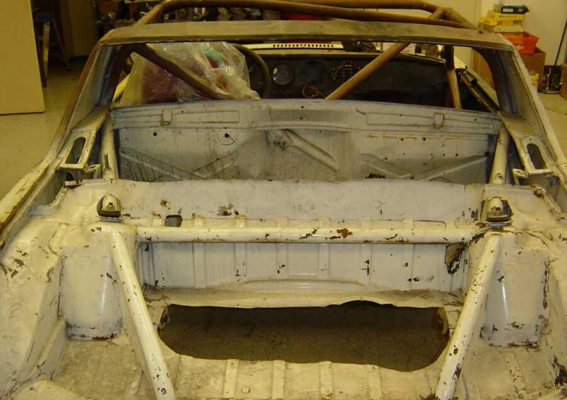

gms   Here are more pix of the car as it arrived at the ...   Feb 13 2011, 04:55 PM

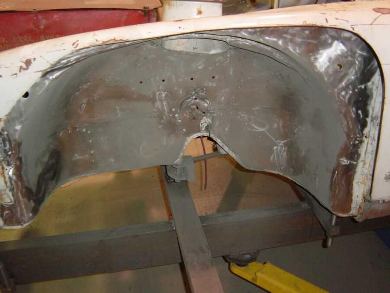

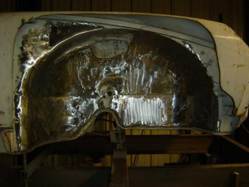

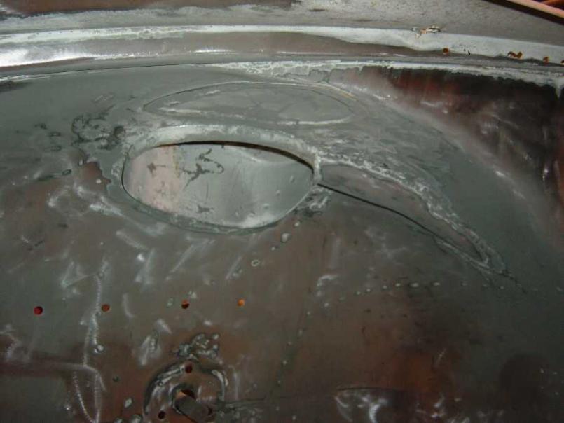

gms   I started to strip the passenger front wheel haus ...   Feb 13 2011, 05:03 PM
J P Stein   This worked best for me....if you're gonna han...   Feb 13 2011, 06:21 PM
gms   This worked best for me....if you're gonna ha...   Feb 13 2011, 08:39 PM

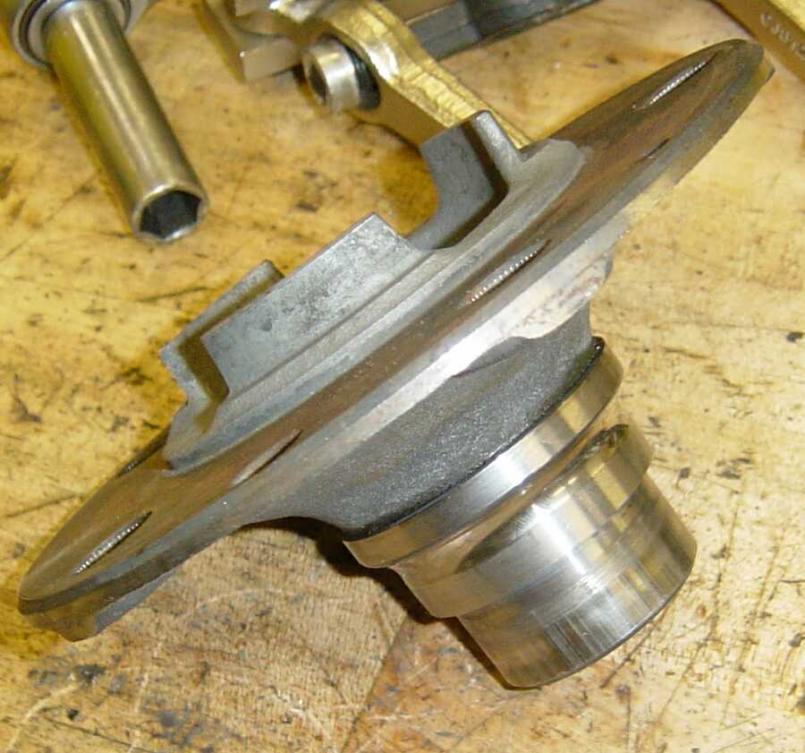

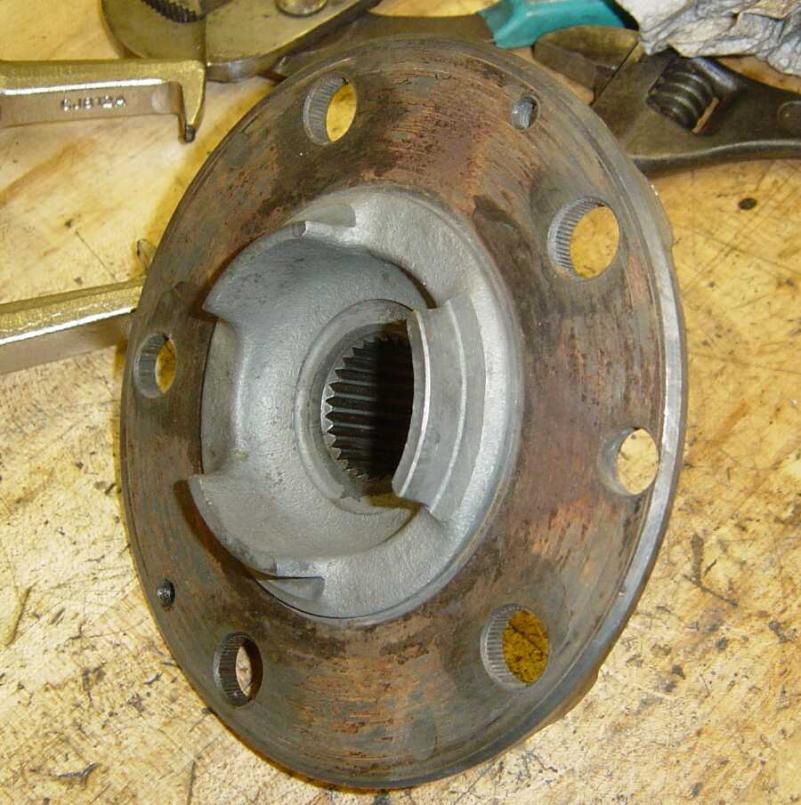

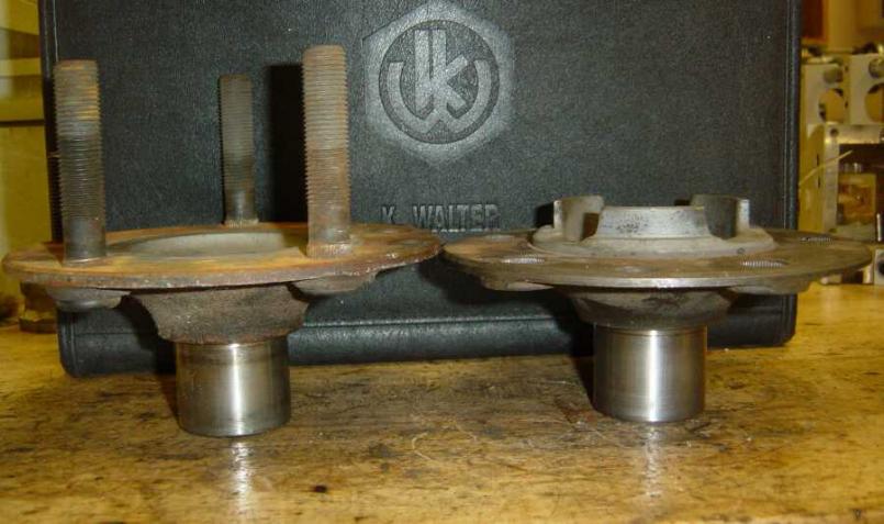

gms   Mark cut down some 911 SC rear hubs to use in the ...   Feb 15 2011, 08:54 PM

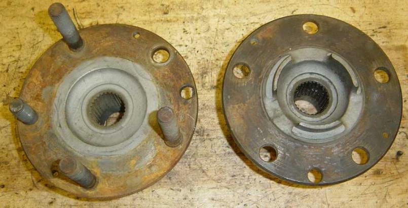

gms   here is the original hub (L) and SC hub ® side...   Feb 15 2011, 08:57 PM

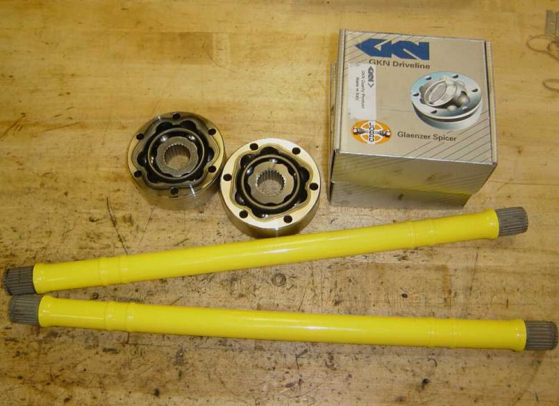

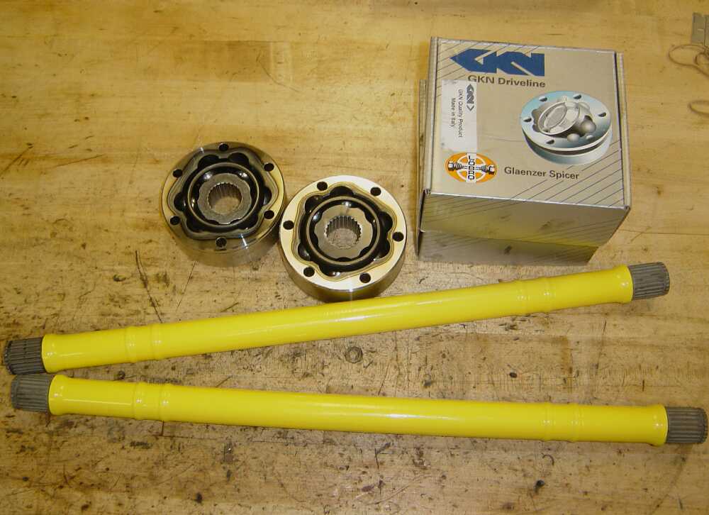

gms   My powder coated 914/6 axles arrived today from Al...   Feb 21 2011, 02:01 PM

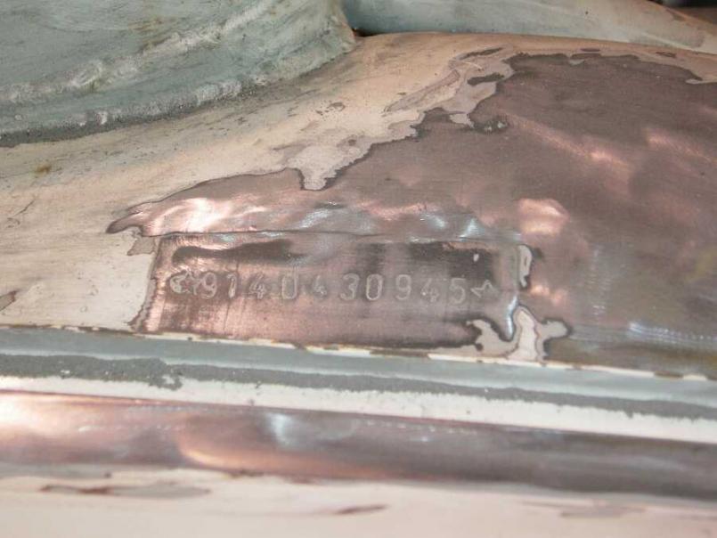

gms   Here is the VIN   Feb 27 2011, 09:47 AM

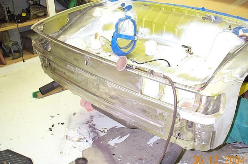

gms   I did a little paint removal yesterday, very clean...   Apr 4 2011, 03:03 PM

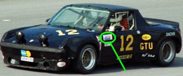

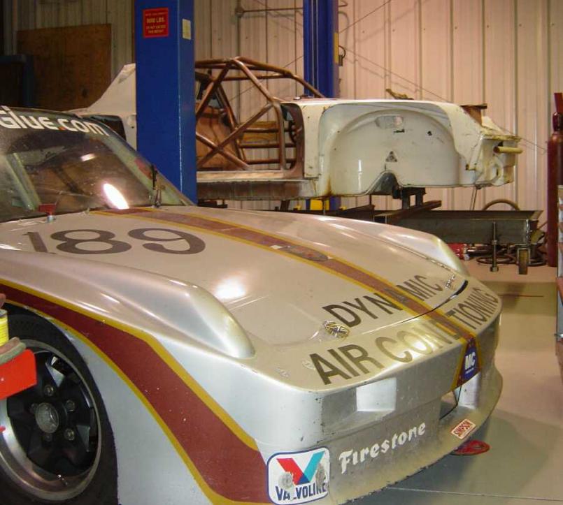

gms   Another photo of the car at the Daytona IMSA race ...   Feb 11 2013, 08:14 PM
GeorgeRud   Looking good! I don't know if anyone arou...   Feb 11 2013, 08:55 PM
gms   Looking good! I don't know if anyone aro...   Feb 11 2013, 09:10 PM
