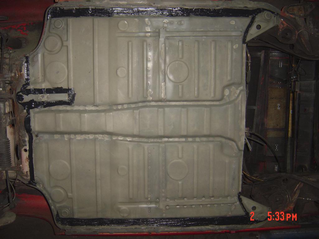

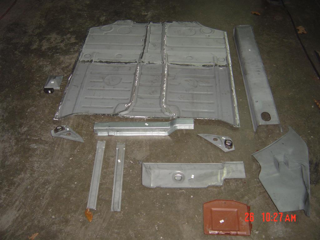

9146986   My post from '05 What we do in my restoration...   Feb 25 2011, 08:56 AM

charliew   I have always had good results with using epoxy pr...   Mar 3 2011, 08:33 AM
sean_v8_914   Perry, you saved me alot of typing. Your proceedu...   Mar 3 2011, 08:48 AM
scotty b   I do basically the same as Perry. Get ti to bare m...   Mar 3 2011, 08:51 AM
r_towle   I picked up a gallon of phosphoric acid which seem...   Mar 3 2011, 09:40 AM

9146986   The water stops the acid. If you are going over i...   Mar 3 2011, 01:25 PM
