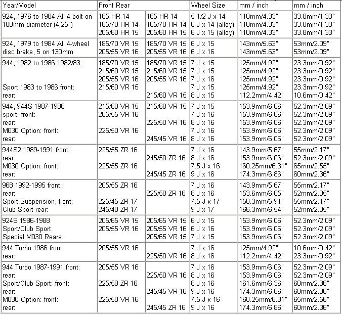

Wheel Enhancement Wheel Styles
At the above link, clink on a rim and it will give you the size and offsets
The near perfect offset for the rear of a stock fendered 914 is 35mm
(for rim that is 7" wide)

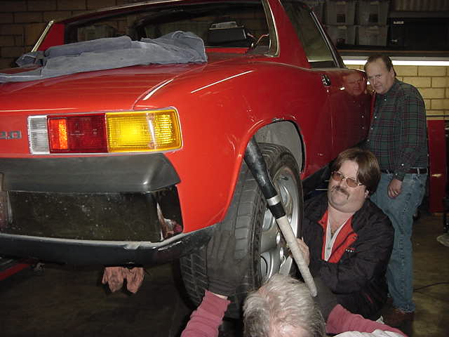

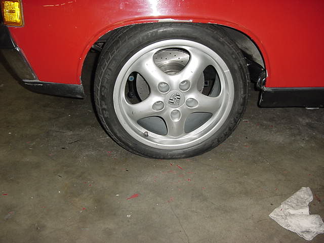

I ran the 9x17s, but we were starting to get a little rough on the fenders in serious turns with the 245s, so I dropped back to a set of 964 Cup wheels that are 7x17 and 8x17 with 35mm spacers in the rear and 25mms in the front. The tire size that works the best in the rear seems to be 235.
as for the fenders... does this answer your question? (IMG:style_emoticons/default/smash.gif)
