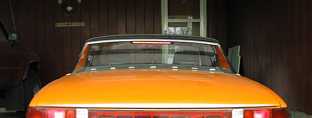

Just wanted to thank Demick for the thread on the 3rd brake light. Finally got it installed, works just fine and doesn't hinder my view from the rear view mirror. Great idea thanks again (IMG:style_emoticons/default/biggrin.gif) (IMG:style_emoticons/default/beer.gif)

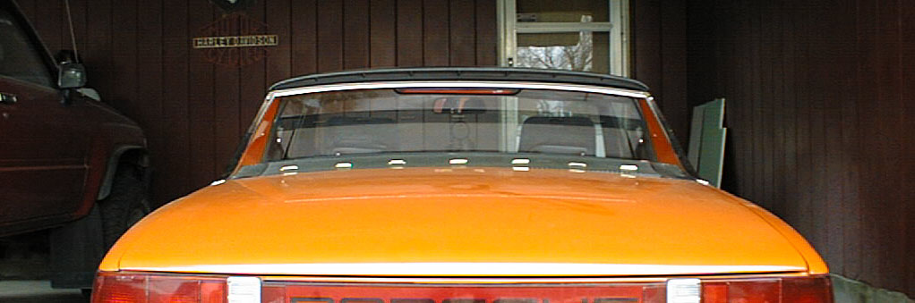

next one

Looks pretty good! I might have to find that thread.

Looks great. Is that the mid-90's GM SUV light? Can you be a little more specific as to type and source. Wrecking yard? I want to add one too.

Yes your right it is a GMC light,, I posted a thread on here that gives a guys phone # where you can get this brake light, the cost was around 21 bucks if I remember right. I no longer have his number so I hope you can find the thread I started about this.. Thread was called 3rd brake light. Hope this helps.

Looks just like the light on the roof of my 98 Suburban. (IMG:style_emoticons/default/MDB2.gif)
