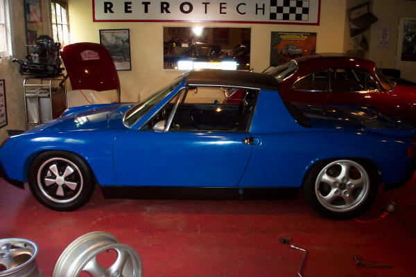

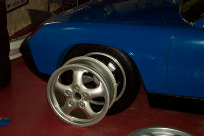

I don't mean to burn you out on the list, but I am really confused here. I just mounted a 17x2.25/50 tire on the rear with 1/2" spacer. It seems to fit, but with only a small amount of day light clearance. It is a 55 mm back space, so 1/2" shouldn't be enough. Since I borrowed one tire, and don't have long enough studs I can't drive it, but its in there.
Now I don't know if I even like the look.
Give me some input. I seem to be convinced I want the Falken Azenis tires no matter what. And I thought I liked the 17" 993 wheels.
Opinions?

914 Freak!
Posts: 17,155
Joined: 4-January 03
From: Antioch, CA
Member No.: 87
not sure if I like them on there or not...I like the "Hot Wheels" look of the Fuchs on your car......nice garage !!!!!
I too wanted the Falkens, but I think the 225's are too wide for the 7" wheels
(I know they'll fit, I'm running 225/45/17's on 7's on my Volvo)
spare set of wheels/tires for auto-x or when you really want to tear up the roads with the Falkens installed????

Be carful that you are measuring the clearence on the back of the wheel. Meaning the space between the tire and the "trunk wall" The outer fender can be rolled a little if need be.
The 993 wheels look funny b/c you only have one on the car. the fuchs are not a compliment to the 993's.
Just out of curiosity why do you say 2.25/50 not 225/50? I have 225's on my 7 inch rims but the tires have rim guards that add that width.
Look at my site (link below my name) for some picks if you need to decide on the look.

retrotech
post Jun 9 2004, 10:50 PM
retrotech
Posts: 470
Joined: 2-November 03
From: Mosier, Oregon
Member No.: 1,302
Thanks for the picture of your car. I think if I had flares I would like better. The 2.25, was a slip on the key board.
Maybe you are right about the fuchs/993 combo, but I could only borrow one tire for fit test.
The 1/2 spacer seems right. Fenders already rolled. Its such a tight fit, I think I might have problems in hard cornering.
I definately want to use Azenis, and in 17" the smallest is 225.
I may regroup with 16" Fuchs and do something different with the finish. Perhaps sand blast for a American Mag look.
