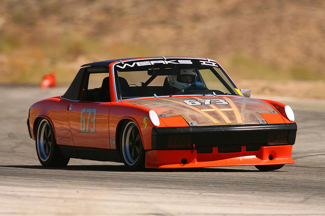

Some of you may have seen my earlier build thread on the 914club site. In a nutshell I have a 73 2.0 that I converted to a six in 2003. It's now heavily modified and race-prepped, powered by a stout 2.7 twin-plug engine.
The car currently weighs 1988lbs without fuel or driver; my POC minimum class weight with gas and driver is 2209lbs. It's still narrow-bodied and I am running 16x7 Fuchs with 205/45 Hoosiers. As you might guess, the car is significantly grip-limited and traction-limited in the rear especially. It basically tears the tread off R6's within 6 run sessions or so.
Here is its current state:

I just dropped it off at a local shop, about to dive into:
- Tangerine Racing steel flares, front/rear
- Sheridan 6" f/g rear spoiler
- Rollcage triangulation to suspension pickups
- Possibly other chassis bracing
- GT headlight lifts or remove lights completely
- Repaint car (TBD how extensively)
- RSR finish Fuchs 16x8's up front, 9's in rear
- New graphics/decals
One upcoming decision is whether to keep the sail vinyl or go body color without vinyl. I've always liked the factory vinyl and bright trim look but could go either way on this.
The work could start as soon as Tuesday and I'll post updates and pics as I get them. This is not going to be a CW rotisserie sort of project since it's a race car, so progress should happen quickly and I plan to run the POC Laguna Seca event towards the end of August.

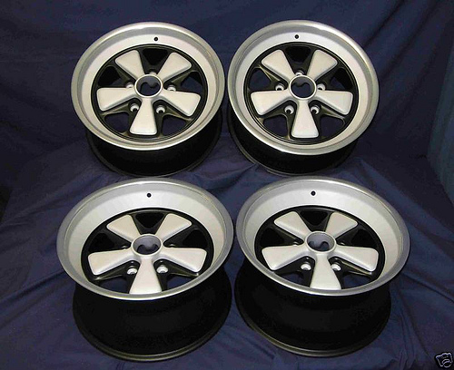

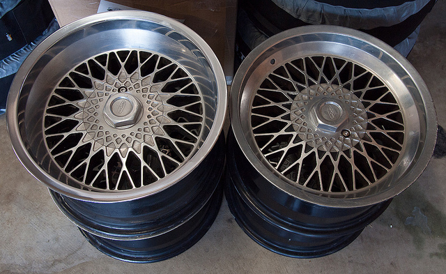

So a couple of you have already discovered that my car is at Kundensport in Camarillo for the body/paint work. I will be posting pics as available.
Here are the wheels I've been hanging onto until I had flares to stuff them under. I will be putting Hoosier R6's on them.
(IMG:http://www.914world.com/bbs2/uploads_offsite/farm5.static.flickr.com-21-1310184522.1.jpg)
16x8 and 16x9 Fuchs, RSR finish by cjcam, on Flickr
(IMG:http://www.914world.com/bbs2/uploads_offsite/farm6.static.flickr.com-21-1310184522.2.jpg)
16x8 & 9 Remotec alloys (German) by cjcam, on Flickr

The Fuch are light.....a bathroom scale will show that the 8 X 15 inchers are around 12 lbs ea. Those other things look heavy. In my experience to get a 16 incher that approaches those weights you need to go to a 3 piece wheel with a spun rim. My 10 X 16s weighed 11 lbs each but they are delicate....as tire mounters have found out.
Tis a slippery slope you are contemplating. Personally I go with 15 inch wheels, 8 inch in front & 10 inch in back. 225 X 45 & 275 X 35 tires they would keep the ride height down. The standard flares in back won't accommodate those rears but you have the HP to over power even those. OK, so I set up cars to suit available tires.....I've been on that slope.

JP - those Remotec wheels are nearly identical in weight to the same-sized Fuchs, believe it or not! I can no longer use smaller than 16" wheels due to the suspension mods (strut spindles) up front; also the DOT tire choices are rapidly dwindling in 15" and are still a little better in 16".

OK, I thought you were talking race tires but your right, the available DOT tire selection sucks. I run 19mm raised spindles with just a few mods to clear the inside of the wheel....tis a near thing. Bigger wheels & tires are heavier (& taller) than the 15s. I guess it is whatever floats your boat.
