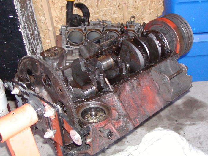

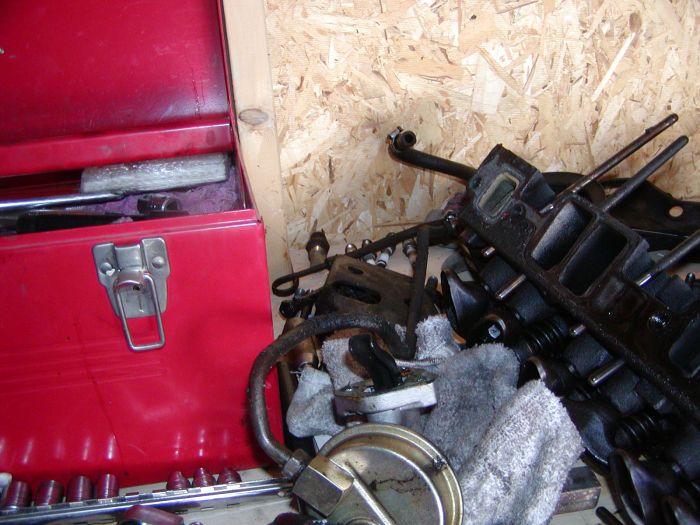

Anyways with that, I then went to pick and pull and found a 305 engine from some later car. We look all around and cant find an engine number.. Hey, its a v8, we need to pull something, Lets just do it (im very glad I said that..)

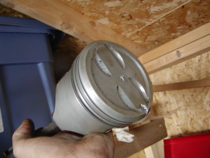

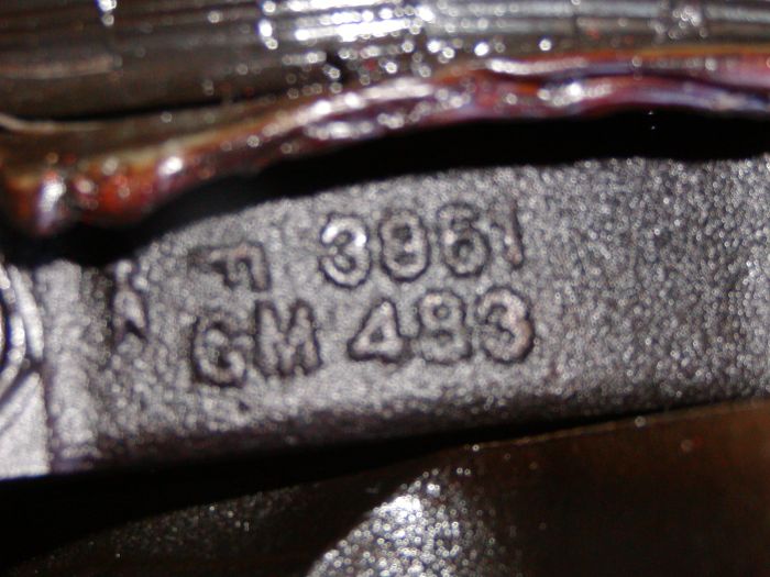

We then get the engine home and I plop off the valve covers and find that it has 350 heads(via the number), hmm.. Interesting... So I go and find the block number look it up. Sure enough, its a 350 block. Well thats not enough for me, I take it apart check the bore, theck the stroke, Yuppers 4in bore, something or other stroke, Yup its definately a 350! Whats not known is why it was in a 305 car.. So checking the pistons dad says there high compression, I wouldnt know any better.
So then talking about radiators, Mike Mueller kindly offers me his (very large) aluminum radiator for cheep. I take him up on his offer and drive to his house to see his garage packed with neet toys! Thanks mike for the walk through! We enjoyed it!

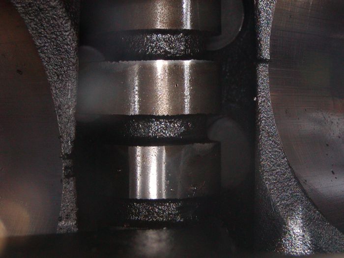

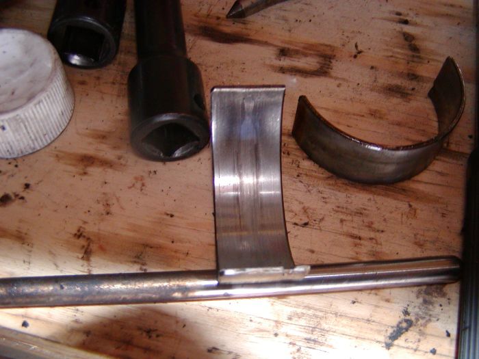

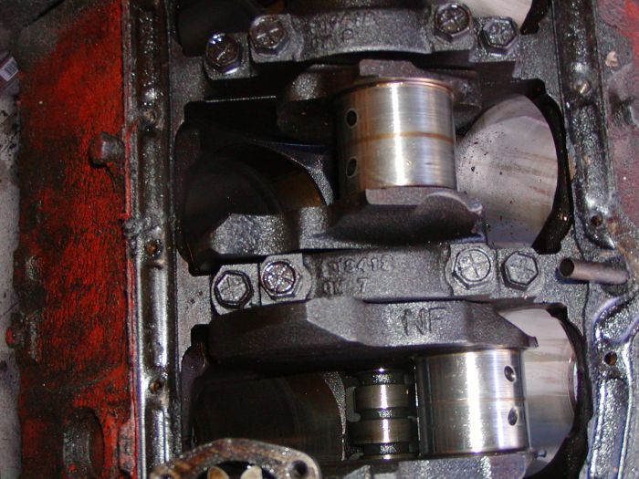

So we go home, and later in the week(yesterday) I start taking off the pistons, I get one off and clean it, trying to find an overbore number.. Cant fine one Check the bearings, they have .0005 on them. No clue what that means...
Anyways, while taking out the rest of the pistons dad stares at something for a second, laughs, and shows me that it is a 4 bolt main. So, now where very curious to why it was in a regular family car.. 84 or such.

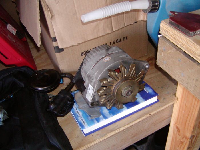

Andyrew   newish alternator   Jul 8 2004, 07:20 PM
Andyrew   block   Jul 8 2004, 07:21 PM

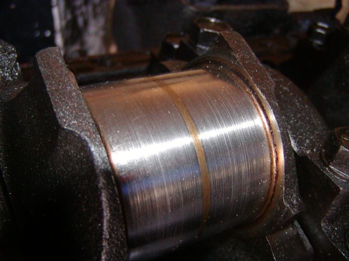

Andyrew   Bearing wear, lifter dirt   Jul 8 2004, 07:22 PM

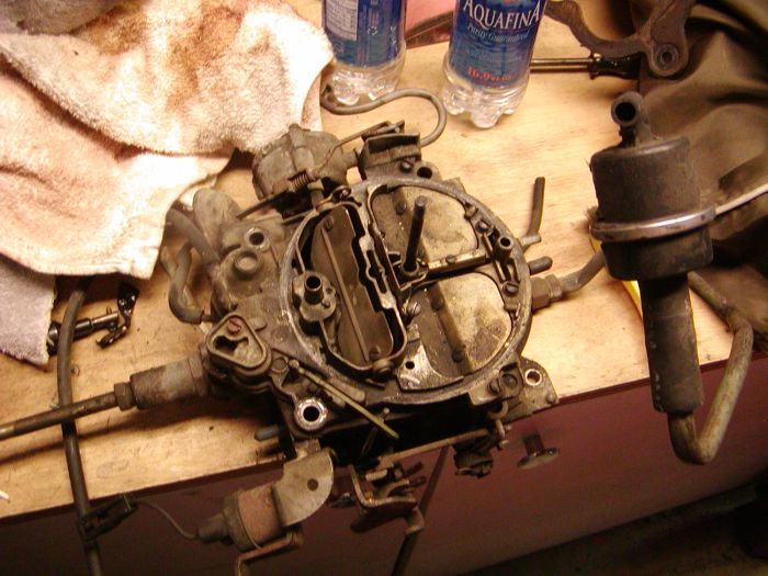

Andyrew   carb.. after the engine rolled over on it.. (Ya le...   Jul 8 2004, 07:24 PM
Andyrew   crank wear.. gona have to overbore or whatever the...   Jul 8 2004, 07:25 PM

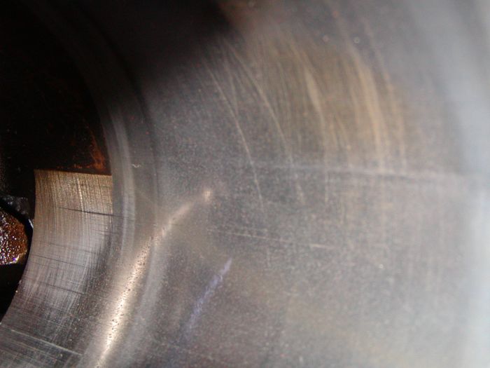

Andyrew   Cylander wear.. Not bad Oh ya.. 1500th post.. I f...   Jul 8 2004, 07:26 PM

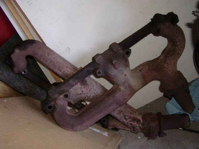

Andyrew   Stock exhaust, I think I'll use it for now. Gi...   Jul 8 2004, 07:27 PM

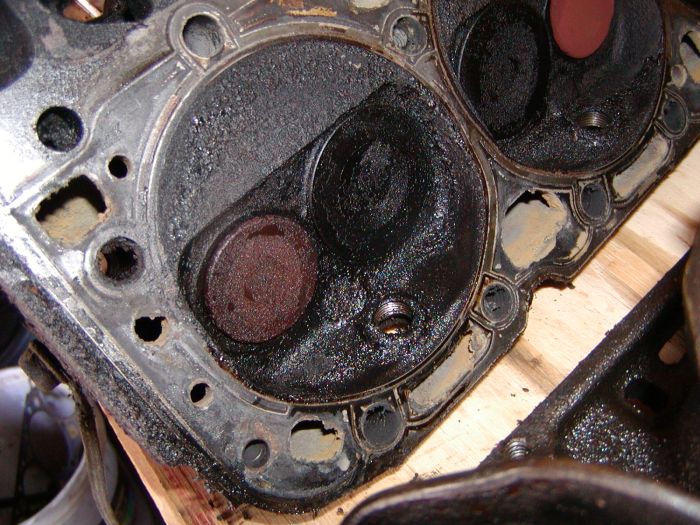

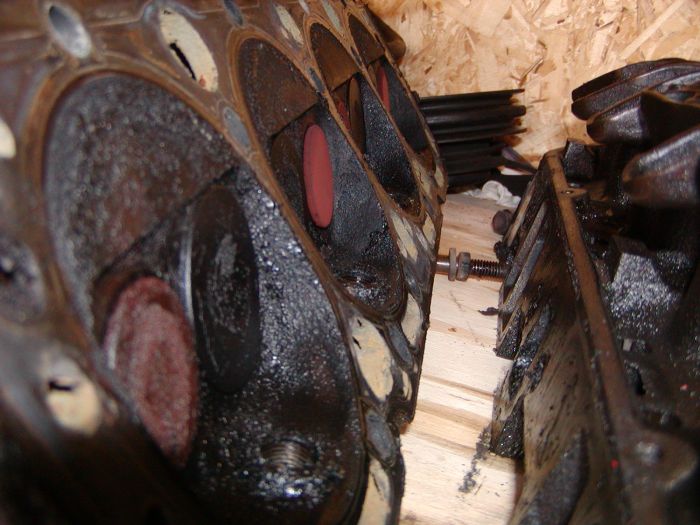

Andyrew   Head...   Jul 8 2004, 07:29 PM
Andyrew   Gota lap the heads or get a valve job (tehehe)   Jul 8 2004, 07:29 PM
Andyrew   heads and intake manifold   Jul 8 2004, 07:30 PM

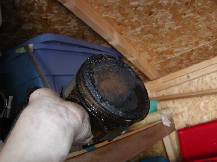

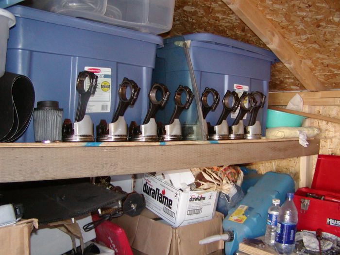

Andyrew   Dirty piston   Jul 8 2004, 07:30 PM
Andyrew   Anyone want me to detail their car? Clean piston   Jul 8 2004, 07:31 PM
Andyrew   there so many of them!   Jul 8 2004, 07:32 PM

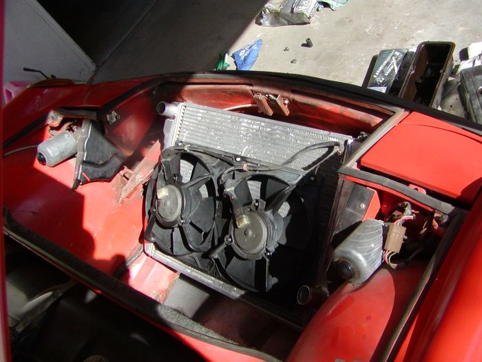

Andyrew   Sexy aint it! radiator with 944 twin fans.. I...   Jul 8 2004, 07:33 PM

86motoman   Here is a site for all of your chevy numbers. htt...   Jul 8 2004, 08:09 PM
smrz914   Andrew you will probably have to use an elecrtic p...   Jul 8 2004, 08:17 PM
skline   Ok, First off, the pistons are standard GM pistons...   Jul 8 2004, 08:23 PM

Andyrew   I cant run the stock alternator the way its mounte...   Jul 8 2004, 09:12 PM

Andyrew   crank   Jul 12 2004, 08:51 PM
Andyrew   Out of curiosity, is this timing chain stock?   Jul 12 2004, 08:52 PM

Andyrew   The heads where magnifluxed and checked for cracks...   Jul 21 2004, 05:18 PM

Andyrew   The twin (huge) fans that I got from Steve... I th...   Aug 3 2004, 09:15 PM

Andyrew   Boring single exhaust... One cat, one truck muff.....   Aug 3 2004, 09:31 PM

Andyrew   Alternator mount, and "custom" alternator... I...   Aug 3 2004, 09:34 PM

dan10101   Radiator... DONE (minous wiring the fan...)   Aug 30 2004, 09:27 PM
skline   Why does it look like its going to leak??? Are you...   Aug 30 2004, 11:26 PM
Andyrew   Oh the hoses arnt connected all the way.... air es...   Aug 30 2004, 11:55 PM
