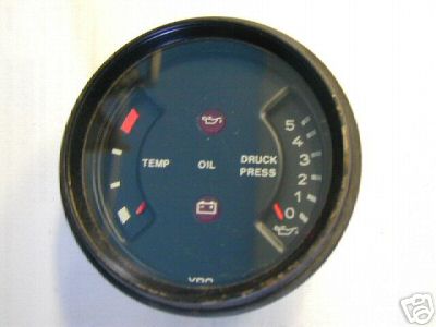

I replaced the oil pressure sender on the top of my case with a sender which provides light activation and VDO oil pressure reading. How do I know which pole is for the light and which is for the pressure gauge?
The gauge also has three connectors for the gauge (not the connector for the light) which is marked +, G and grnd. What connects to what?

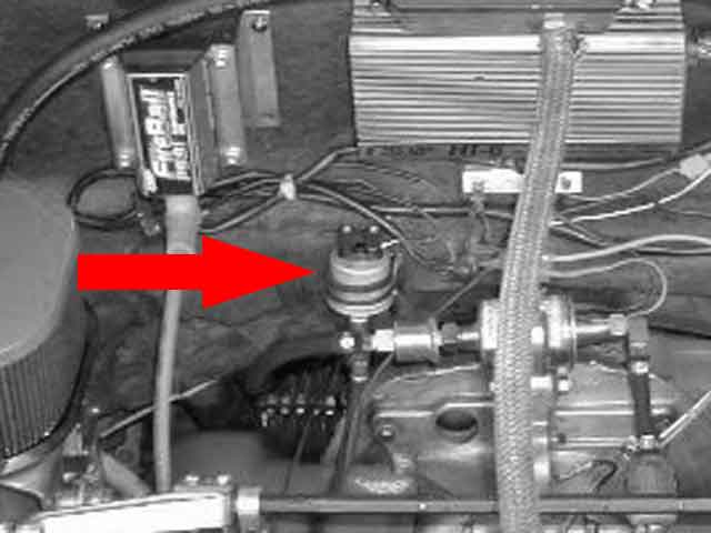

How about a pic of this sender and where is it being procured?

I'm working on this right now, been out in the garage last two hours with this and 911 tach. I started a similar thread last night...
I just hooked up the 911 pressure gauge when turn the power on the gauge comes up to zero then when I start the engine it pegs the top. That can't be right, can it? I unplugged the ground and it stayed pegged at the top let the engine die and it drops to zero.

QUOTE(rdauenhauer @ Aug 6 2004, 06:47 PM)
this bugger,
have to remote mount becuase it won't fit down in the tin.
any 914 friendly place like pelican or aircooled.net has it.
dr

QUOTE(Mike D. @ Aug 6 2004, 03:20 PM)
verify your connections, of course. the ground may be provided (more or less well) by another connection.
early 911's had 150-psi oil pressure gauges, the downside of which is that everything under about 15 psi looks like zero, which many considered alarming. (it's a 911, get used to zero oil pressure at idle :-) ...) anyway - mid-80's somewhere they yeilded to the complaints and in typical fashion, simply doubled the sensitivity of the gauge making it a 0->75 psi gauge, with more room to spread out the lower numbers.
the gauge must match the sender ... i don't think any Porsche gauges match any aftermarket VDO senders ...
