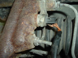

Two wires, that I have temporarily wrapped around each other and then wrapped on the sensor. Notice there is NO reset button.
With the two brown wires wrapped together the buzzer goes off but the flashing lights (like the hazards) on top of the fuel guage continue on?
Two questions:
1.) Does the master cylinder sensor activate both the buzzer and the lights?
2.) Could it be another issue like the ebrake...and if so what?
Please help
