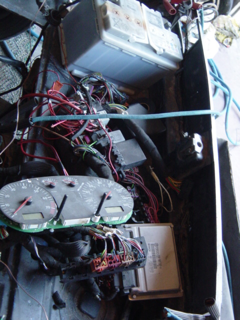

What's left of the harness (i'm still trying to trim down pieces I don't need).
It's down to approximately 15% of the original harness:

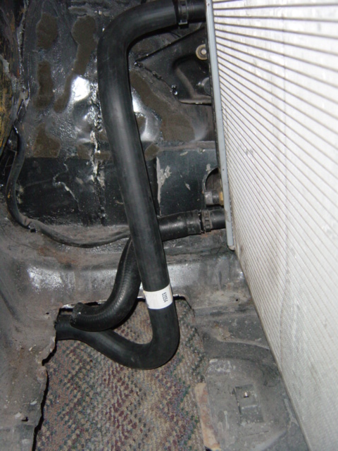

Radiator with some misc radiator hoses I found at my buddy's shop:
I'm about to mount plumbing pipes (copper) under the car to get the collant to and from engine.

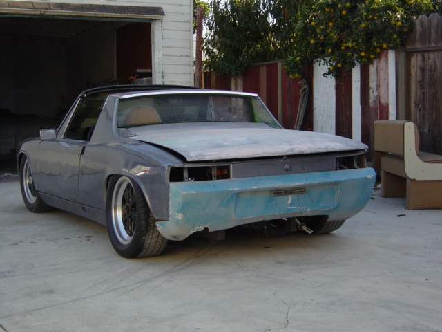

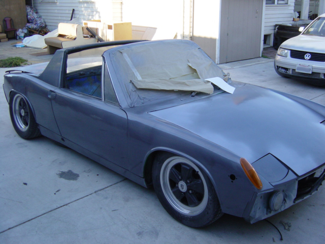

Pic of the car:
Still need to work on those 1/4 panes some more and get that bumper put on.

One more from the side...
Paint looks pretty crappy i think...i'll spray it one more time i guess:

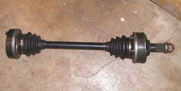

Member No.: 159

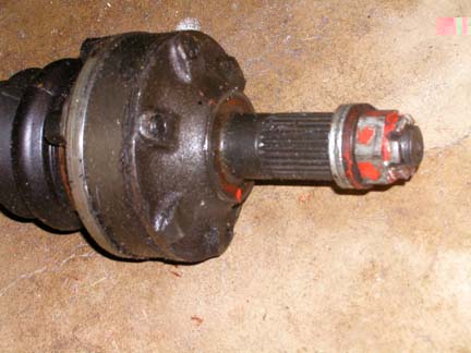

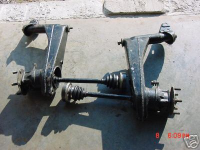

The axle overall length is 23 1/2"
The outer CV face to face is 18 15/16"
Not sure if these are 911, maybe others can confirm.
Felix
neo914-6

Axle end..

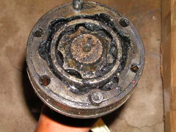

Member No.: 159
CV end...
