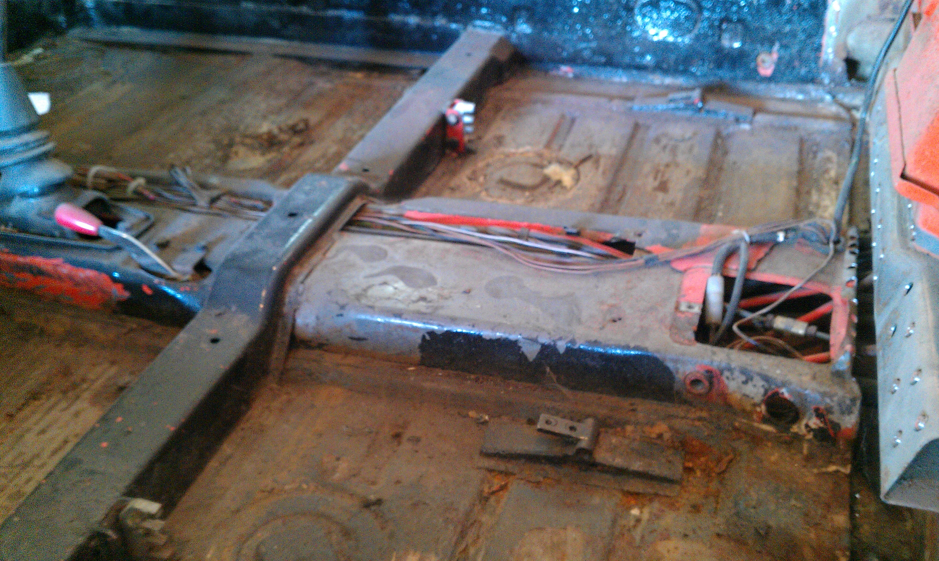

cary   Here's the floor   Jun 6 2012, 10:29 PM

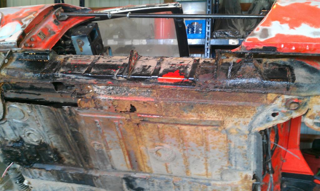

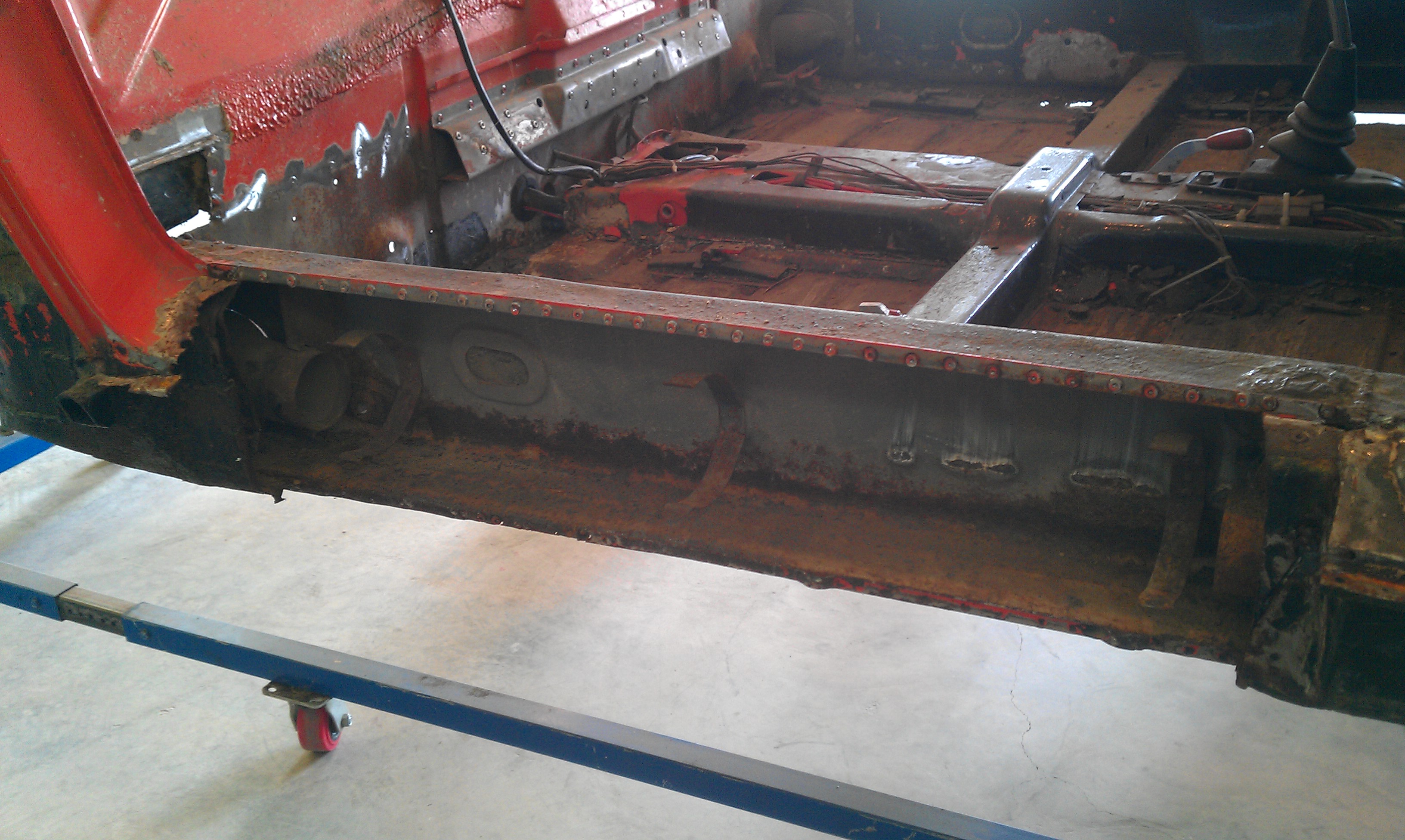

cary   Here's the left side longitudinal opened up...   Jun 6 2012, 10:33 PM

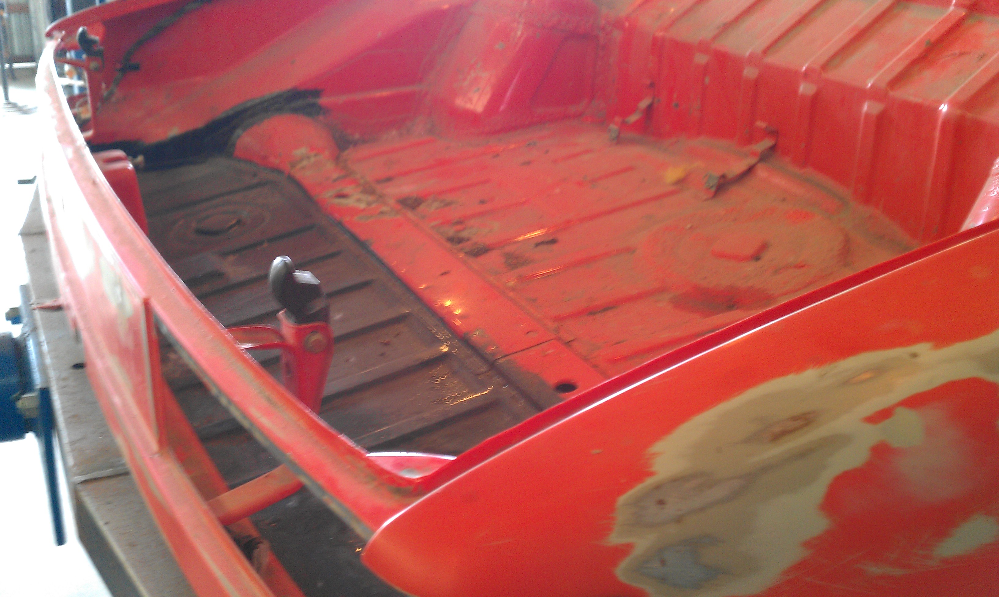

cary   Here's the trunk.   Jun 6 2012, 10:38 PM

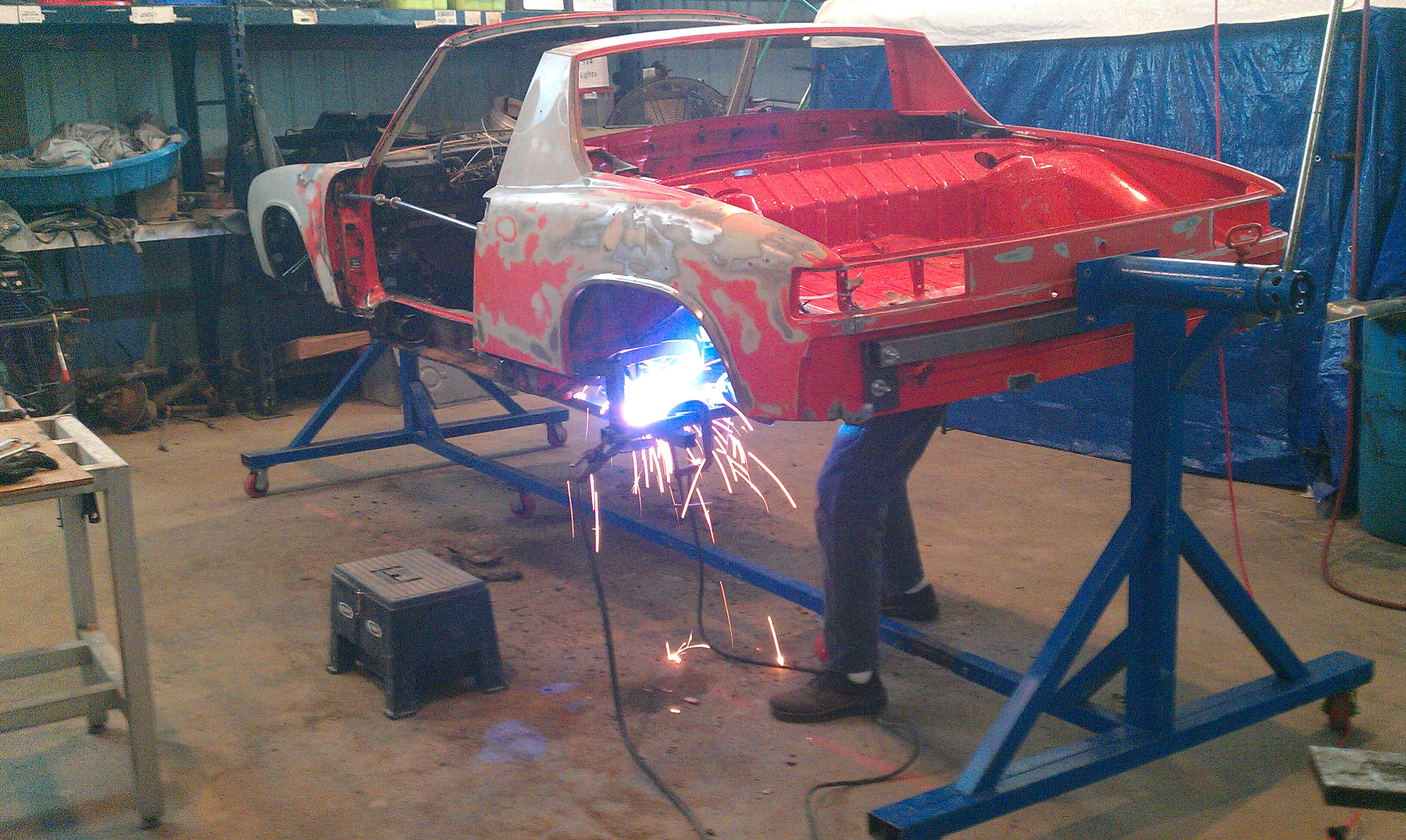

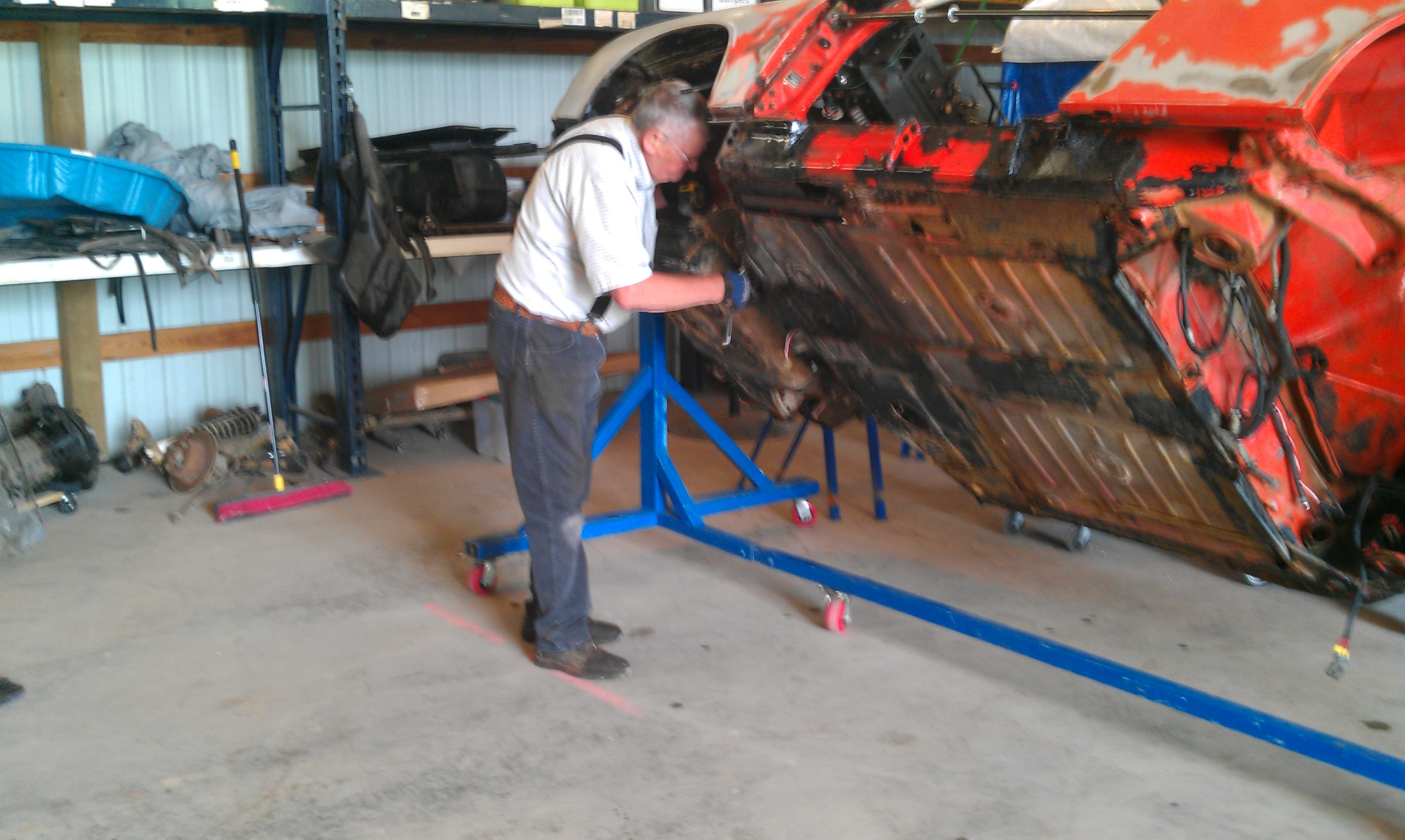

cary   Here's the floor pan on the rotisserie.   Jun 6 2012, 10:45 PM

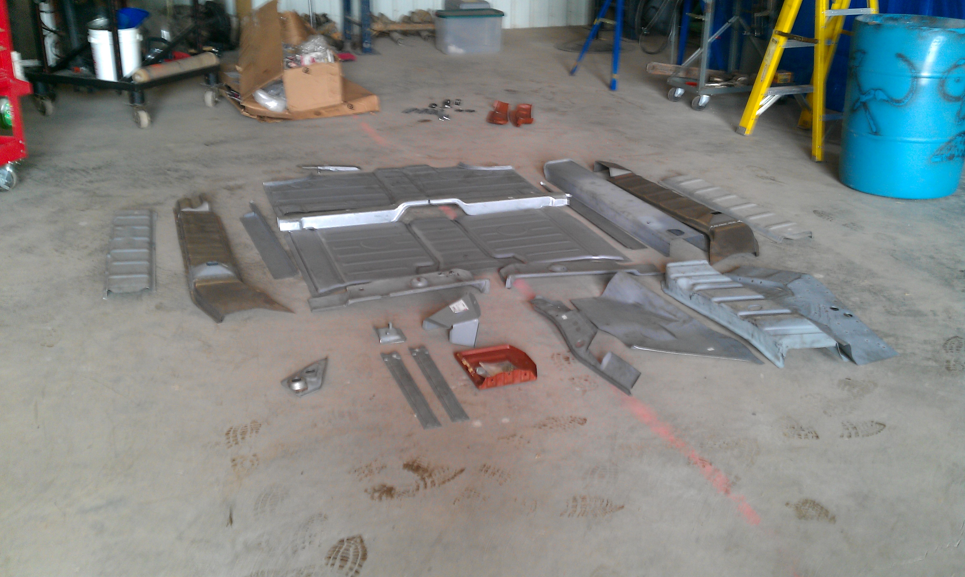

cary   Then I layed out my RD order ...............   Jul 23 2012, 09:41 PM
cary   I'm tearing into the drivers long. It's go...   Jul 23 2012, 09:51 PM
cary   Yes, I cut it open with a disc and a sawsall. I wa...   Jul 23 2012, 09:55 PM

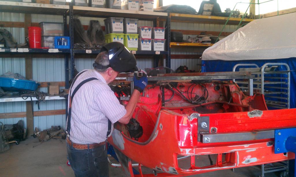

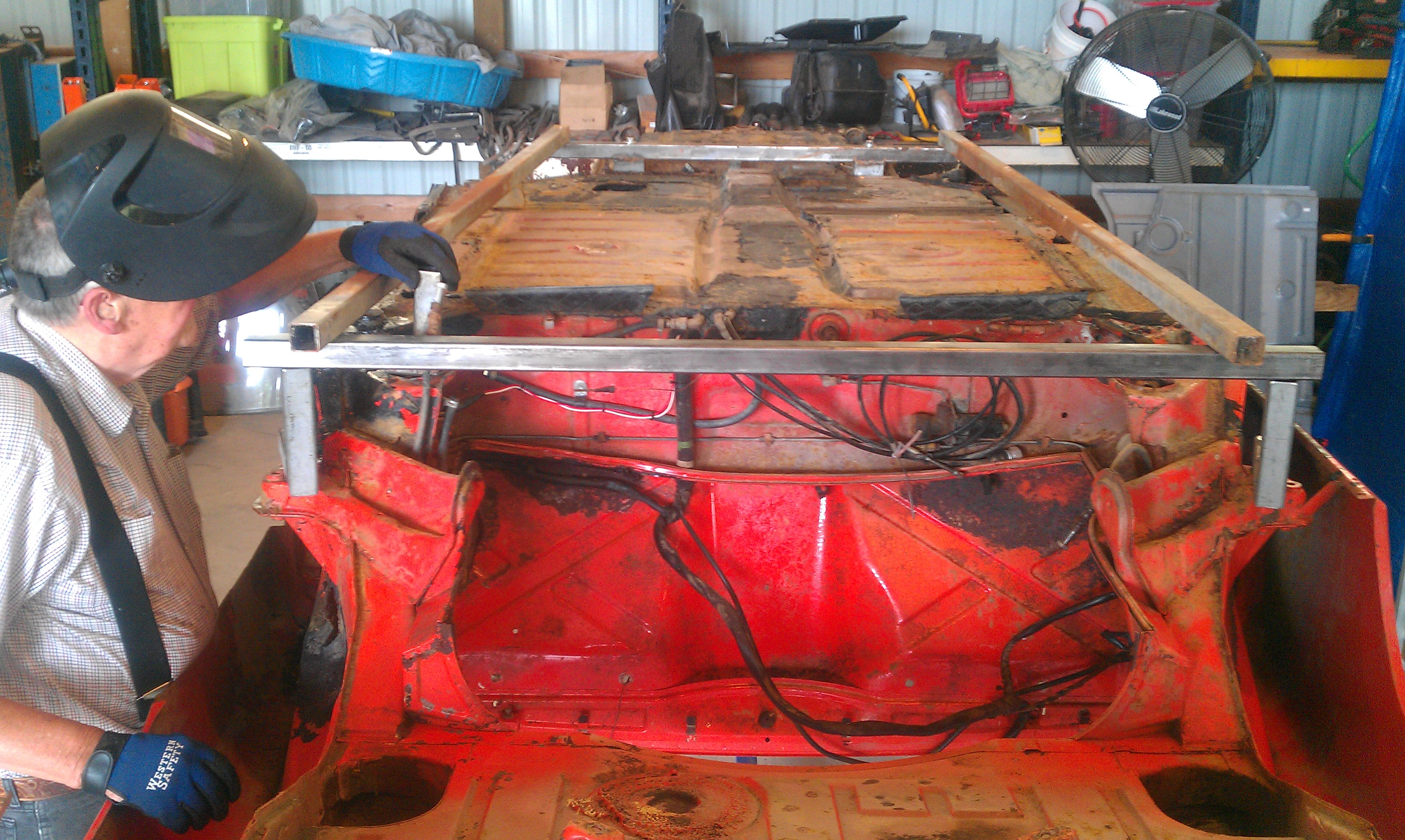

cary   Super In-Law is building a jig to line up the four...   Jul 23 2012, 10:01 PM

cary   Finally finishing up the body jig. After that ...   Aug 17 2012, 09:26 PM

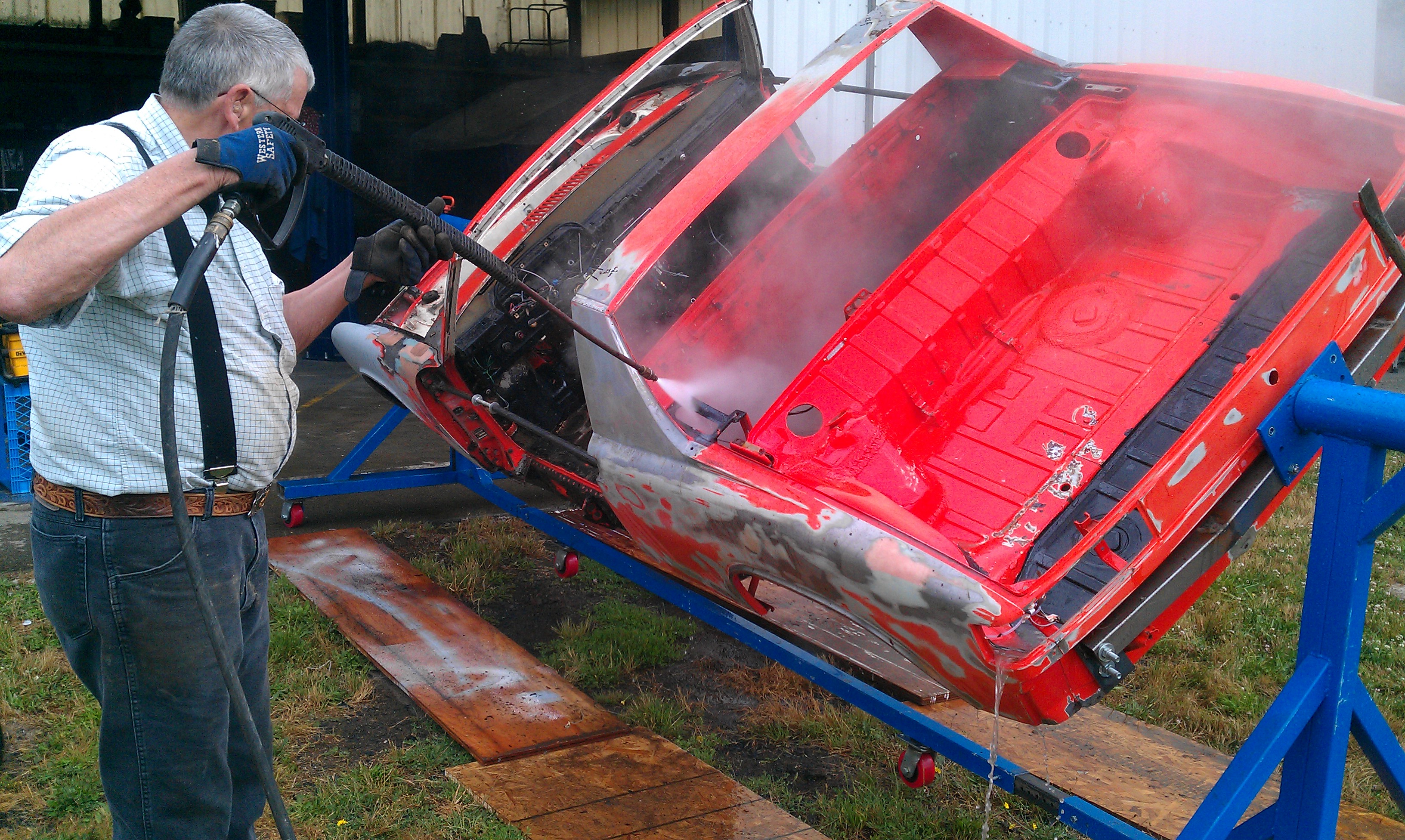

cary   Got the first coat of Ford blue on the parts washe...   Oct 20 2012, 05:02 PM
cary   Out into the light of day............... Even ...   Oct 20 2012, 05:06 PM

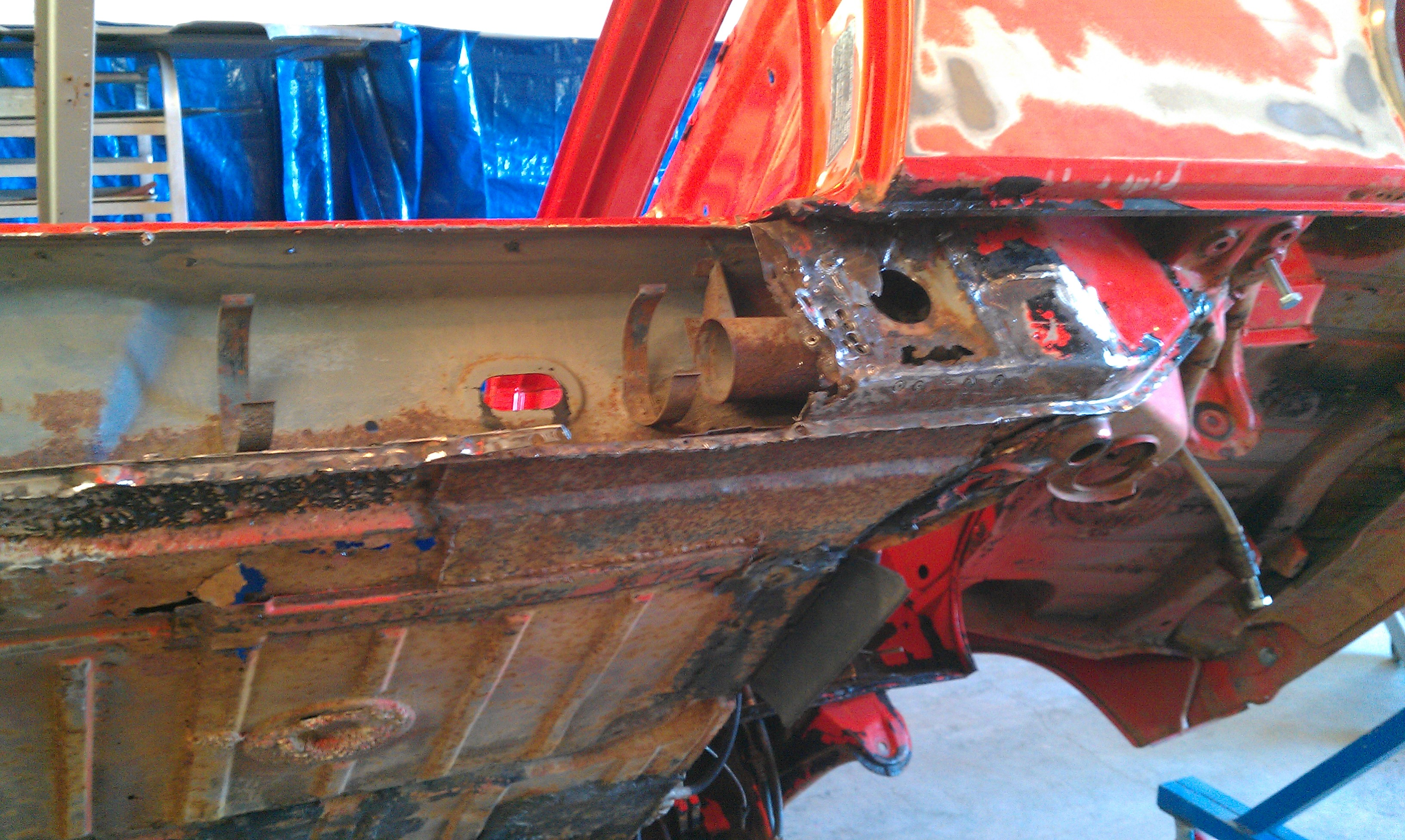

cary   Started by surveying the rust at both ends of the ...   Oct 24 2012, 08:24 PM
cary   Front end ............... Look what I found und...   Oct 24 2012, 08:27 PM
cary   Then I start the carnage ................   Oct 24 2012, 08:32 PM
cary   Getting my moneys worth from my cutting wheels.......   Oct 24 2012, 08:38 PM
cary   First I cut off the bottom .............. Still...   Oct 24 2012, 08:55 PM
cary   Then you see where the day ended ................ ...   Oct 24 2012, 09:07 PM
cary   You can see in this picture our cheater bar. B...   Oct 24 2012, 09:24 PM
cary   As you can see the car isn't liking hanging up...   Oct 24 2012, 09:27 PM

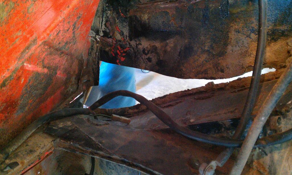

cary   Here's a shot looking into the wheelhouse. Wha...   Oct 24 2012, 09:29 PM

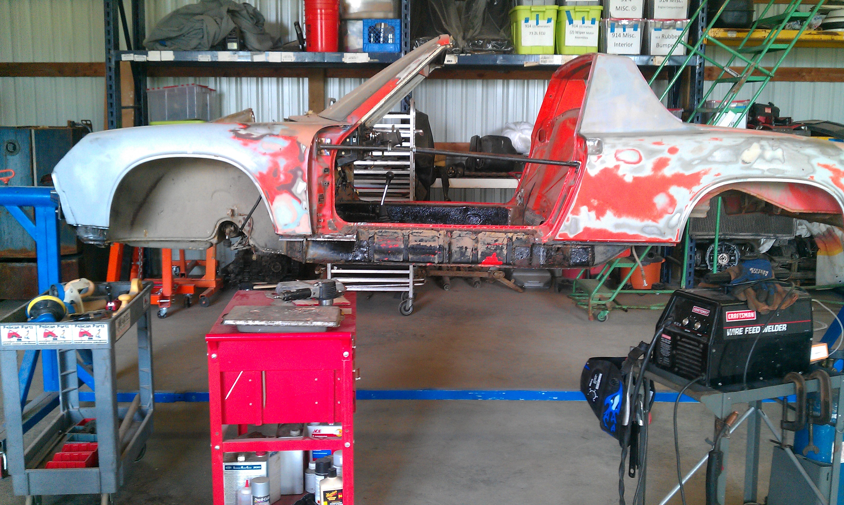

cary   I decided an amputation is in order. Heading to th...   Nov 18 2012, 09:43 AM
cary   Well whats the going rate on a 3 1/2 hour surgery?...   Nov 18 2012, 08:21 PM
cary   Now to disconnect the firewall/hell hole ............   Nov 18 2012, 08:29 PM
cary   Here's a shot up the rear suspension long. Sho...   Nov 18 2012, 08:33 PM
cary   Now for the front end. Outside shot. Inside ...   Nov 18 2012, 08:36 PM
cary   Now 3 1/2 hours later ................   Nov 18 2012, 08:39 PM

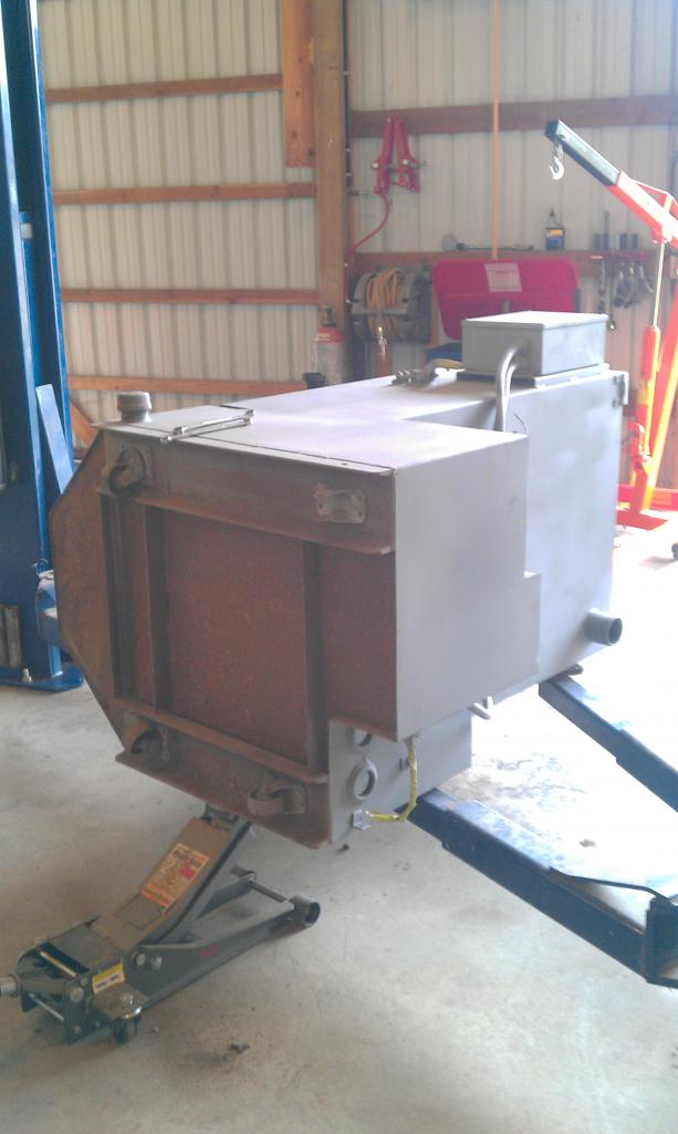

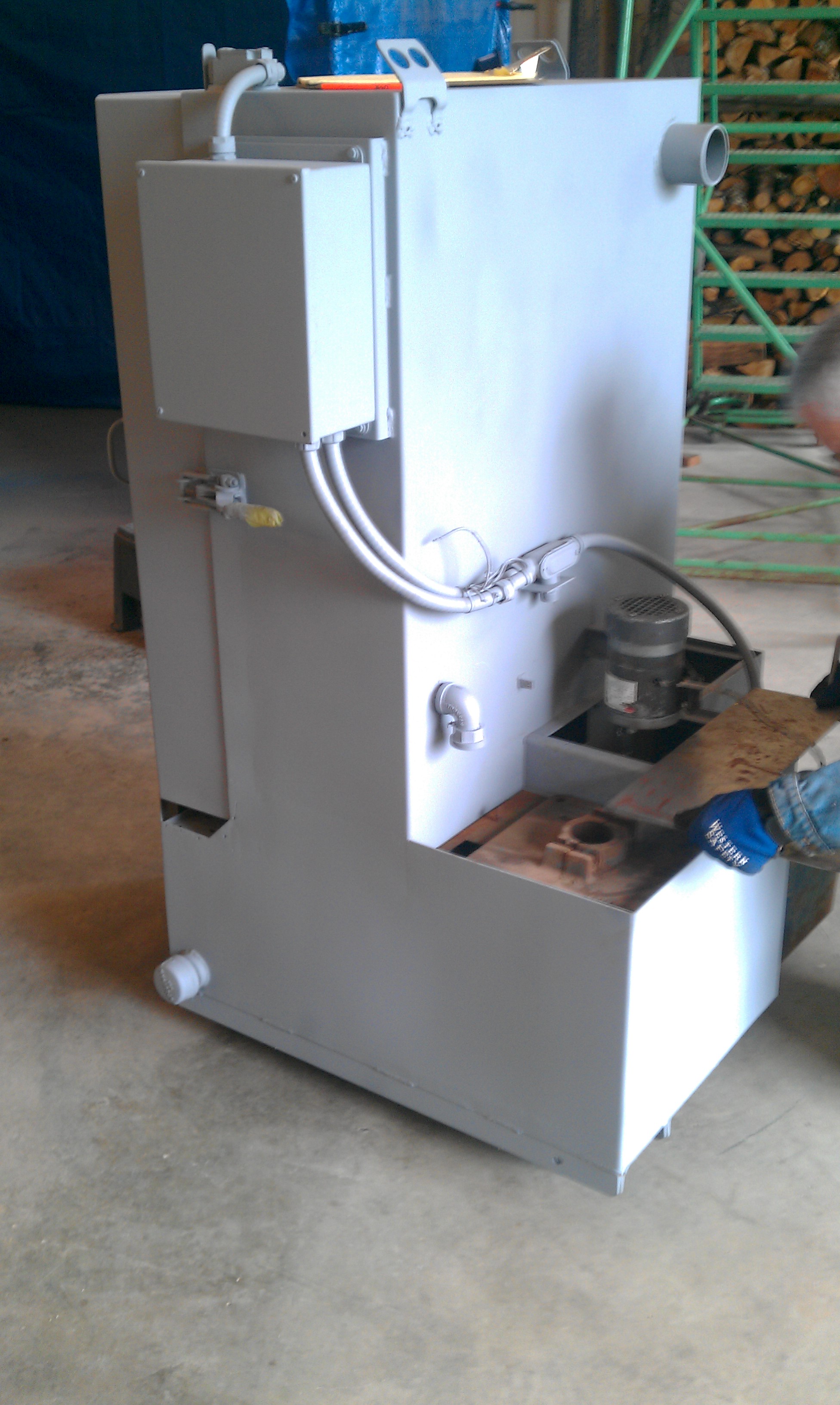

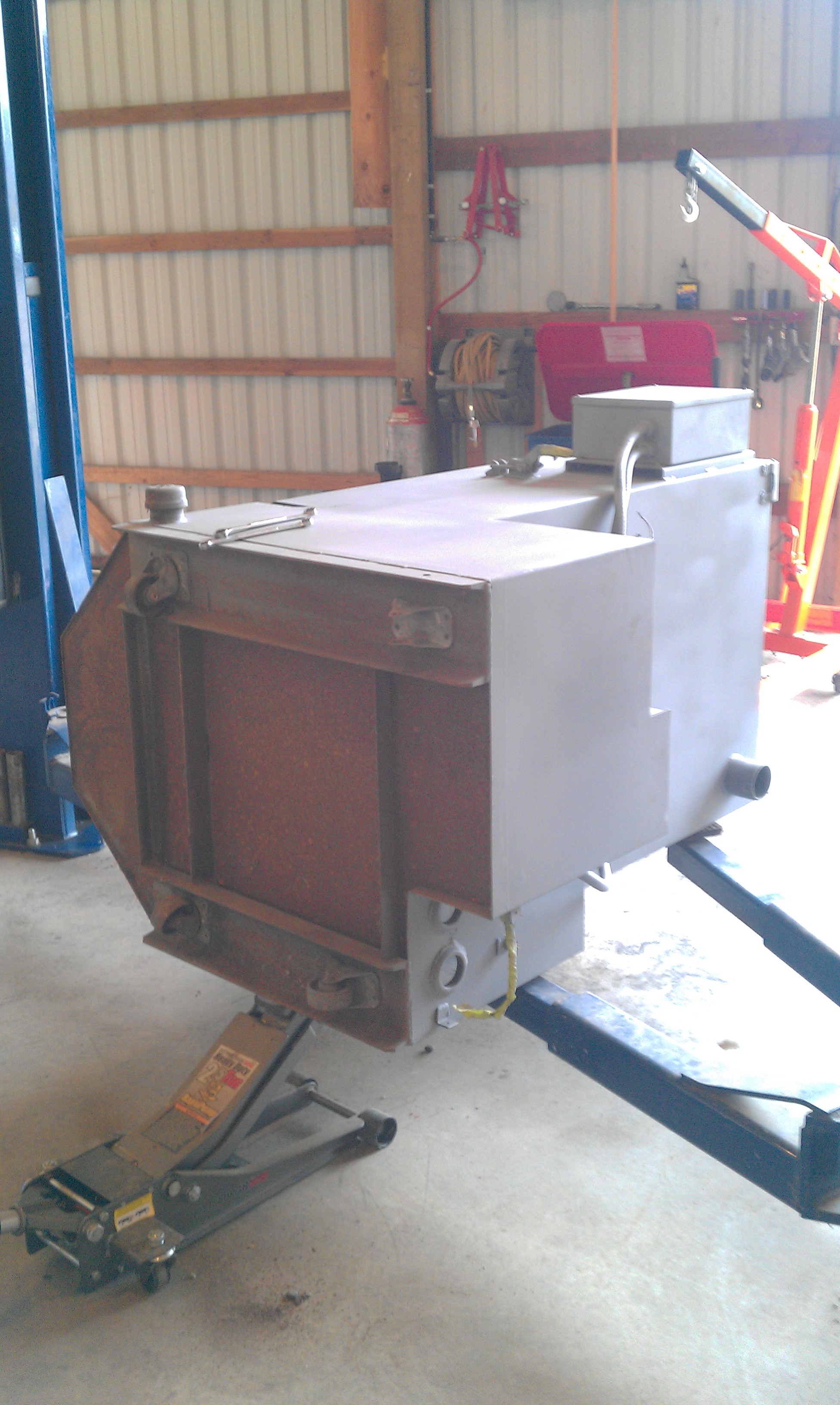

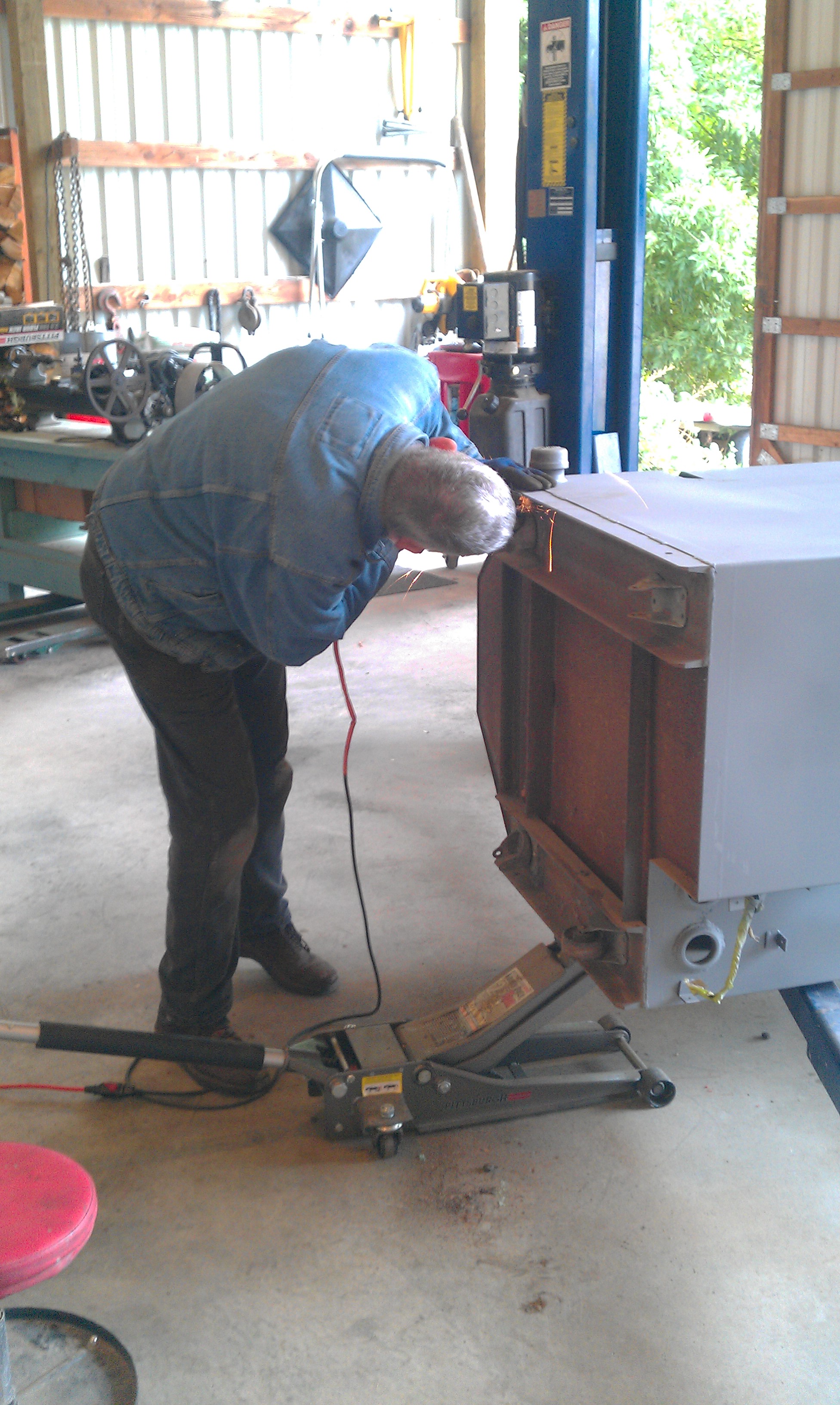

cary   The parts washer lives. Have a small leak at the p...   Nov 26 2012, 11:06 PM
cary   I guess its going to be a Popsicle. White with blu...   Nov 26 2012, 11:23 PM
cary   Well the heater elements work great. The turntable...   Nov 27 2012, 09:16 PM

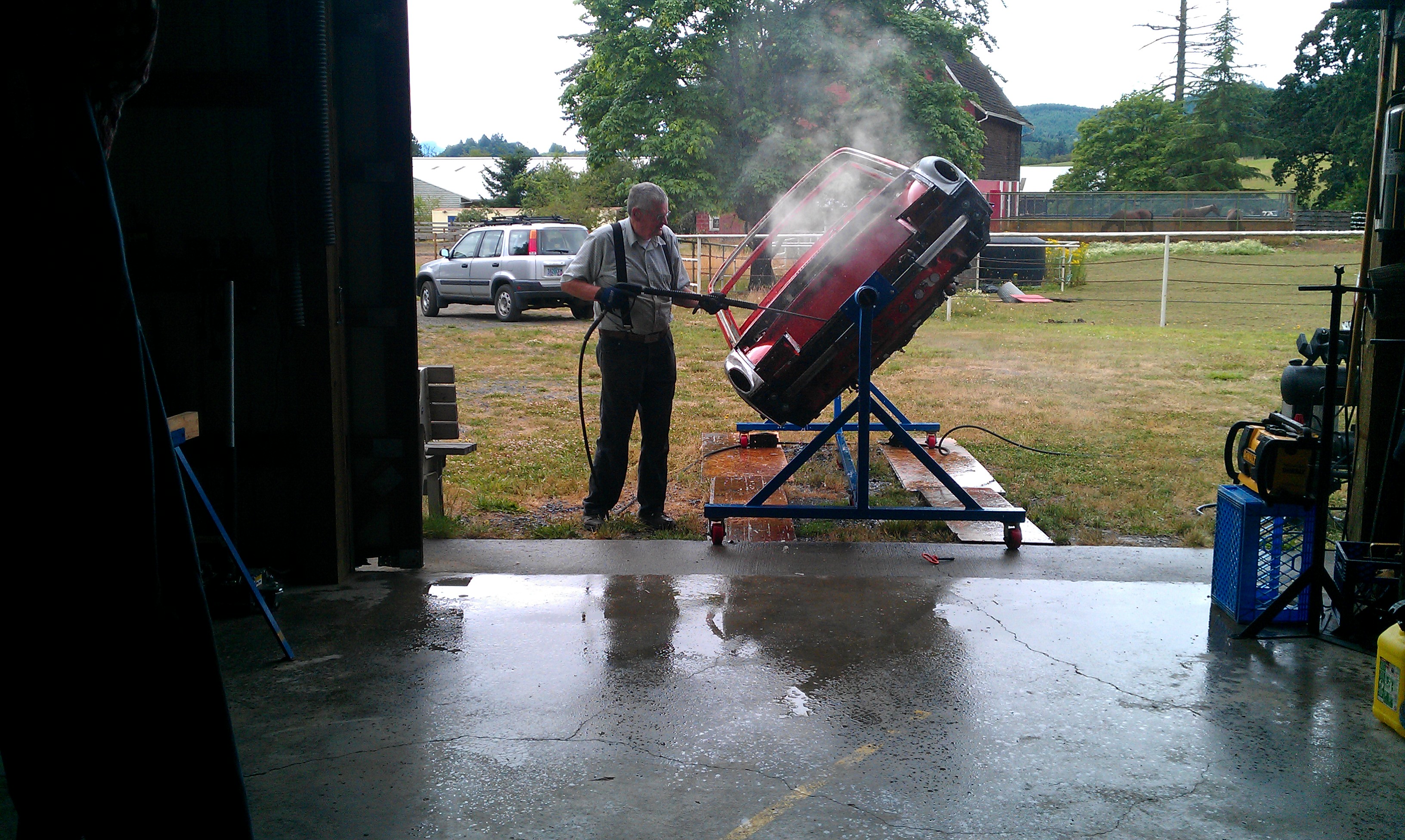

cary   Steam coming out the vent pipe.   Nov 28 2012, 10:05 PM
