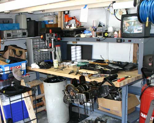

I got my bench from grainger.
Top is butcherblock, 36" x 72" and 34" high with a powered hutch.

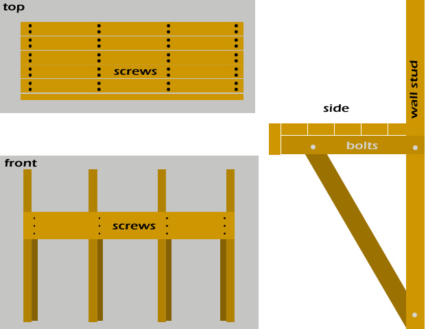

Kerry,
My dad used to make a workbench in his garages when I was a kid, so when I bought my house he and I put one in my garage.
They are very simple and VERY STRONG (oh and cheap).
You use 2x4s and 2x6s to triangulate the bench to the back wall of your garage. I'll see if I can find a pic or two and post it here.

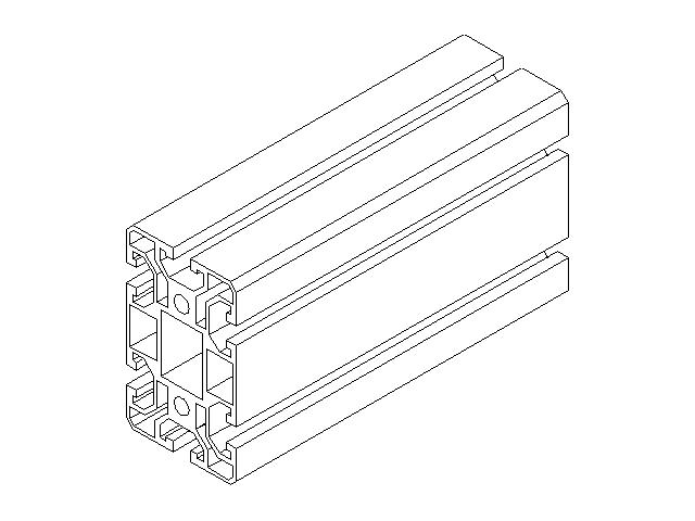

one of 2 benches (sorry no real pictures right now) are built from aluminum extrusion, roughly the size of 2x4's....

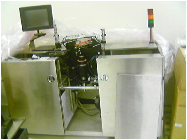

my newest bench will be based on the frame and skins of this wafer edge grinding tool I am taking apart ($75k brand new or something silly like that)
all stainless outer, the framing is 1x1 stainless tubing

That's why you went into the clean room today (IMG:style_emoticons/default/lol2.gif)

Here is a quick drawing.

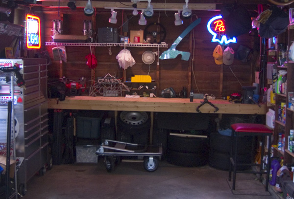

pic

thats tiny!

it's 12 feet long by 34 inches deep!
but, the garage is tiny! (IMG:style_emoticons/default/biggrin.gif)

Sean, PBR nice (IMG:style_emoticons/default/beer.gif)
The bench is nice too (IMG:style_emoticons/default/smile.gif)(IMG:style_emoticons/default/smile.gif) How doe sthe gaps between the 2x4's effect working on bench?

actually, there aren't any gaps, but I wanted to show the different boards quick & easily.
The bench is great, and I can jump up and down on it! Being triangulated you can store stuff
under it without any feet and legs holding up the front.
Not shown in those pics is the welding table addition. I drilled 4 holes and mounted a 40" x 30" piece of 1/4 steel so I can weld on it, too. (IMG:style_emoticons/default/welder.gif)
You can see, there's also an engine stand mounted on the front right.

Kerry I did something similar to Sean's drawing in my old townhouse. I used 3/4 in ply for the top. (IMG:style_emoticons/default/sawzall-smiley.gif)

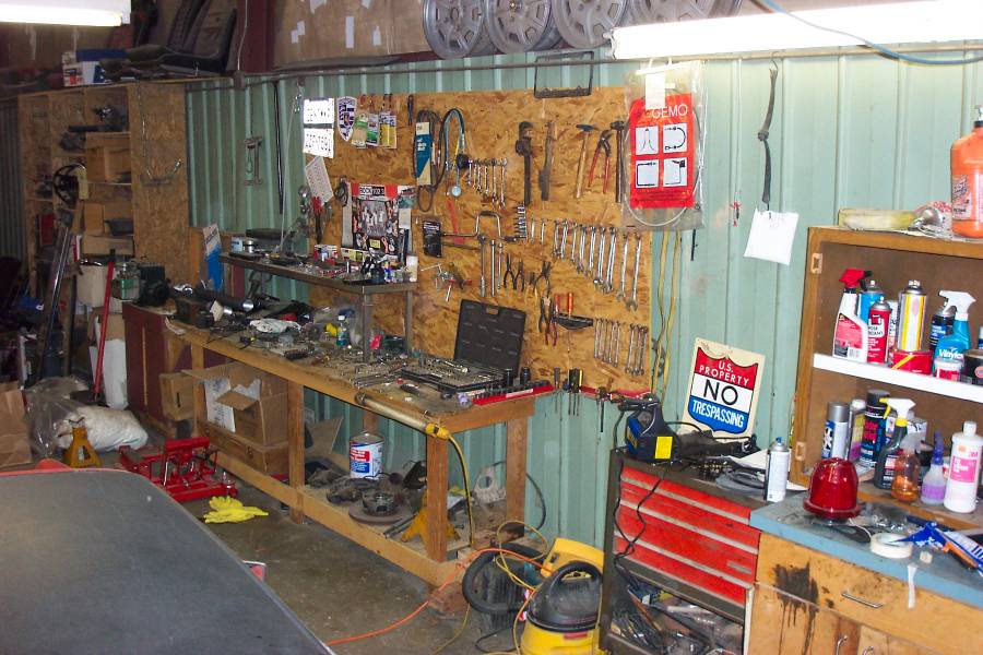

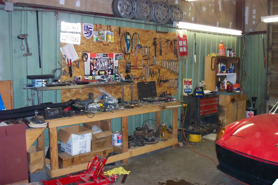

Just a mix and match of old cabinet shop stuff, but it keeps some of the Tulsa Teens running.

nuther
