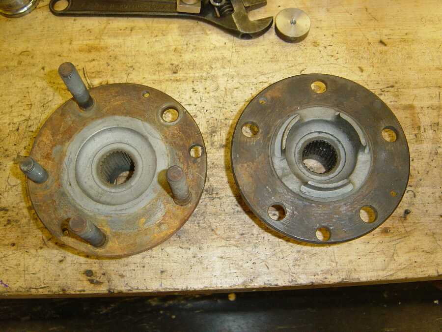

> Hub-centric 5 lug

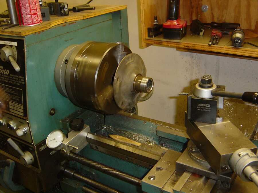

mount up on lathe
Stock version on left
Mmmm hub-centric!

Took me a while. I was looking for the lathe marks and missed the obvious end of the shaft.

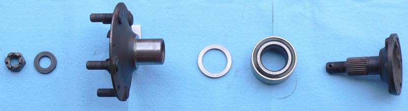

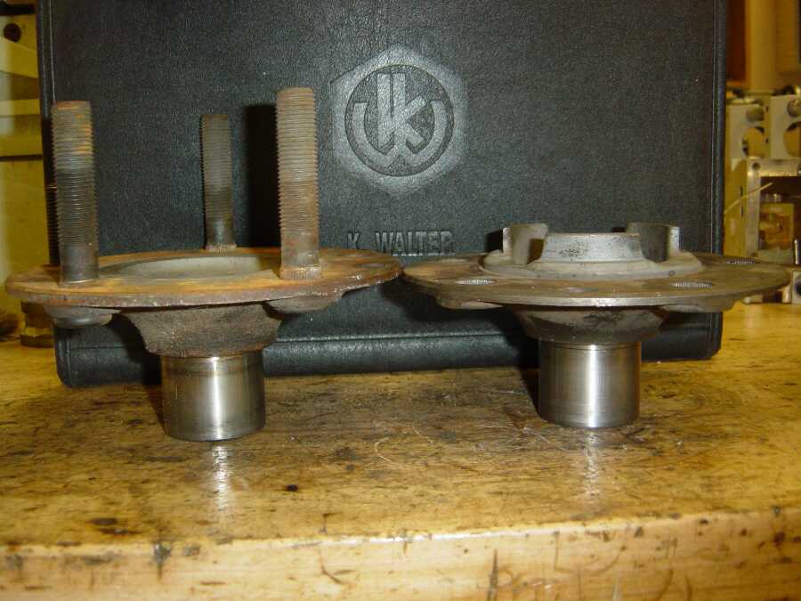

Doug, you need the hub shaft spacer that Luke suggests. Late model hubs are made for the later 911 bearings which are the same ID size but "thicker" than the early bearings used on 914's and early 911's.
Travis, the spacer doesn't push this hub out any further. The extra 5mm for the later hub came off the backside of the hub. This effectively makes the shaft longer to fit the new bearing, which is what Glenn machined off (the "end" of the shaft). By doing it this way, Glenn has moved the hub face "inward" giving you more tire clearance. If you put the spacer on the hub-centric hub it makes it identical to the early hub.
Again, by machining the end off, Glenn will be moving the face inward and the hub shaft will now fit the early bearing. I'd be willing to bet 944 rotors are the ticket here.

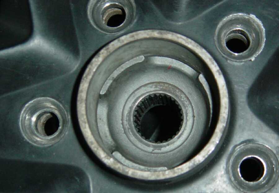

QUOTE(mskala @ Apr 14 2014, 08:47 AM) *
But what is the point of this?
The point is to have hub centric hubs so you don't have to rely on the wheel studs to center your wheel ...

The point is that with even with 5 studs, you're relying on those to center your wheels when tightened and there is a chance that you'll torque down your wheels slightly off center and create a wheel imbalance.
The inner 3 piece ring on the new hub shown in this thread makes sure that the wheel is completely centered. Hub centric they call them for that reason.
That allows for proper wheel fitment every time with now chance of getting them off center.
