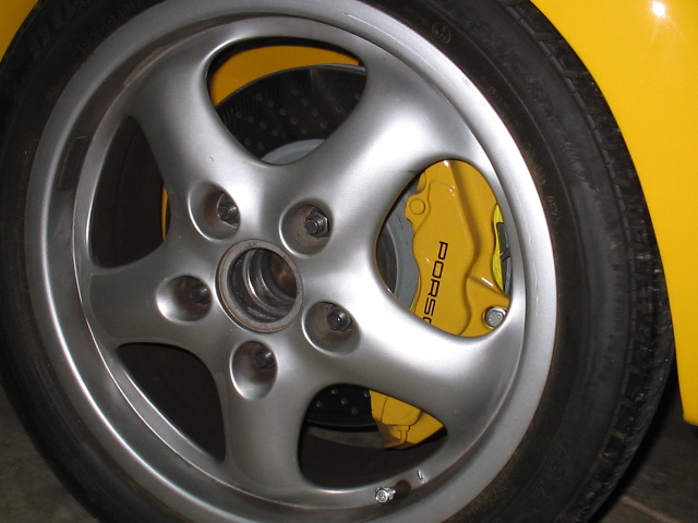

QUOTE (maf914 @ Jan 24 2005, 07:12 AM)
Joe, Good job. Your car looks great and is coming along very nicely.
Thread Hijack!
Joe, I know you've described your wheel/tire combo before, but I can't seem to find the thread. Could you please describe the wheel size, tire size, and spacer size you've used? Thanks.
993 Cup II factory wheels: 7x17 fronts with 225/45-17s and 9x17 rears with 255/40-17s.
At each corner: 100mm wheel studs, 42mm spacers (2x21mm early 944 rear spacers) and steel lug nuts.

Joe, Thanks for the info. That's a lot of wheel and tire! Sure is pretty. (IMG:http://www.914world.com/bbs2/html/emoticons/wub.gif)
