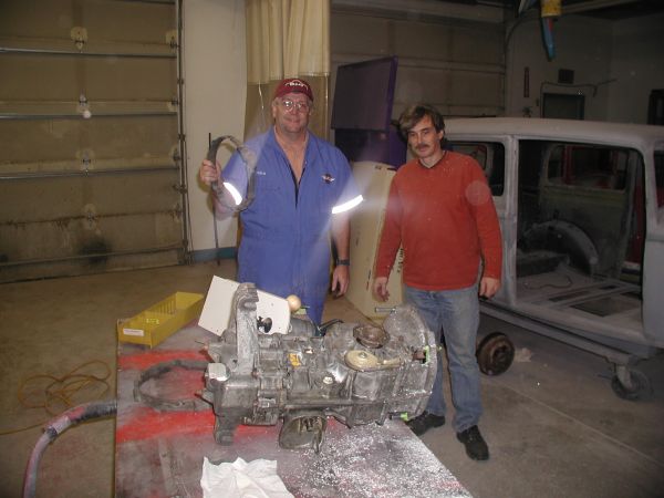

Just wanted you all to know I met Larry and Dad tonight at a Cool local Hot Rod Shop here in Des Moine! Larry is heading back to Texas with his Flywheel, Engine mount, and Freshly modified transaxle. Larry will post pictures when he gets home. Keep your fingers crossed for him. He said he thought he may be running into a snow storm on the way home.

We just flew in form Desmoines and boy are our arms tired....BADUMDUM
Seriously we left out at around 7am and 707 miles back in Dallas at 530 pm. We hit heavy snow from KC to Joplin MO.

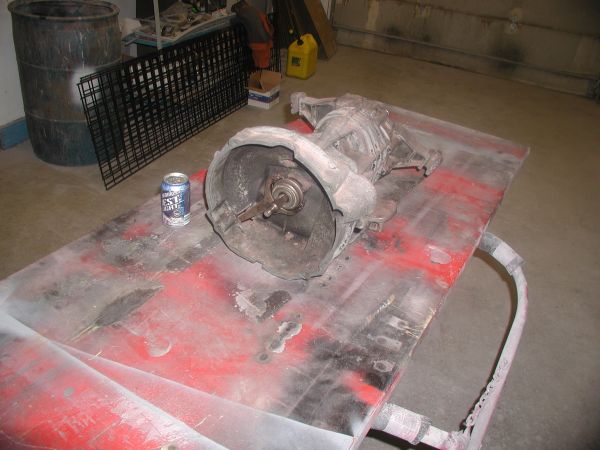

All of that to say here are the photos the first one is the victom up on the operating table

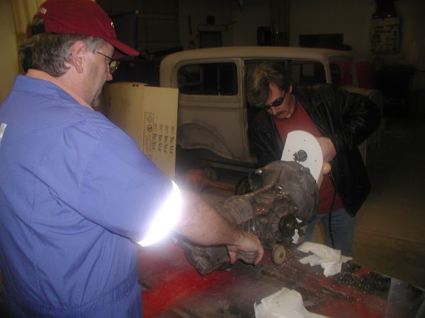

then DR Rick came in to the sterle inviroment and preped for the surgery

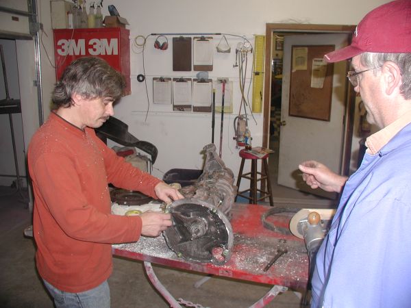

then the cutting began

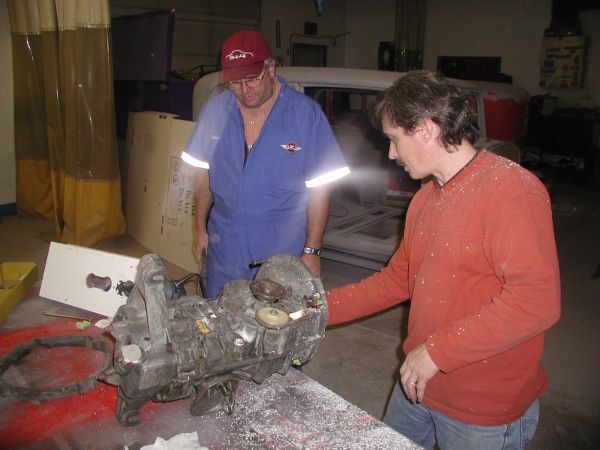

SUCCESS

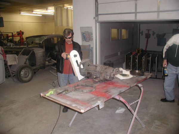

take the alignment bolts out

admire the fresh cut...

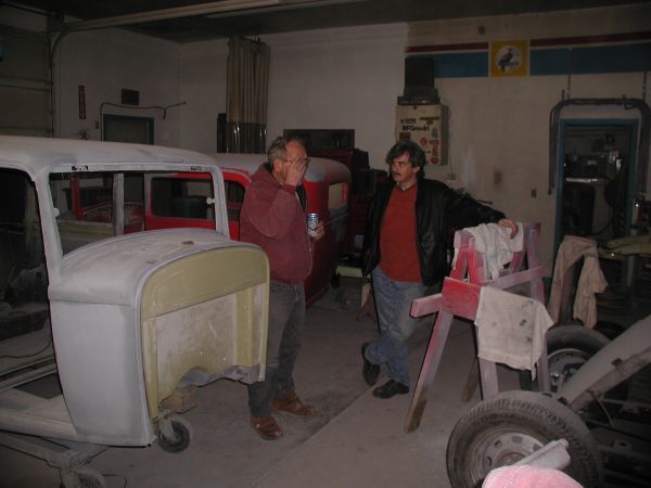

Then lets chat with John about the cool old rods he has going. I know Ill end up getting some parts from him when he comes down for the Good Guys in Fort Worth. Im thinking some rod throttle setups may just work.
THANKS for the use of the shop John. (IMG:http://www.914world.com/bbs2/html/emoticons/clap.gif)
And a special THANK YOU to Dr. Rick for being kind to my trans. It was its first operation you know. (IMG:http://www.914world.com/bbs2/html/emoticons/cool_shades.gif) (IMG:http://www.914world.com/bbs2/html/emoticons/clap.gif) (IMG:http://www.914world.com/bbs2/html/emoticons/clap.gif) (IMG:http://www.914world.com/bbs2/html/emoticons/clap.gif)

Rick
Why do you shorten the bellhousing? To move the tranny forward? To make up for the adapter plate?
rick 918-S
post Feb 8 2005, 09:13 PM
Hey nice rack! -Celette
Posts: 21,014
From: Now in Superior WI
Member No.: 43
QUOTE (Brett W @ Feb 8 2005, 07:06 PM)
Rick
To make up for the 928 block and the thickness of the adapter plate. This gets the input shaft back into the pilot bearing and the starter back into the ring gear.

you cut the bell housing off for the adapter plate to get the input shaft closer to the flywheel... why could you not weld a spacer to get the flywheel further away from the engine instead. it is just easier, and can you use the stock fly wheel. i guess if you had to modify the flywheel it would be just as easy to put the spacer on the flywheel, if not cutting the bell housing is less trouble than welding the flywheel.

Check larry's progress thread. We posted photos of the new flywheel. I don't believe in adding a spacer behind the flywheel. There can be balance issues and long bolts you would need could shear off during acceleration or de-celeration. Just bad science. Besides, it moves the transaxle forward a little over an inch.
