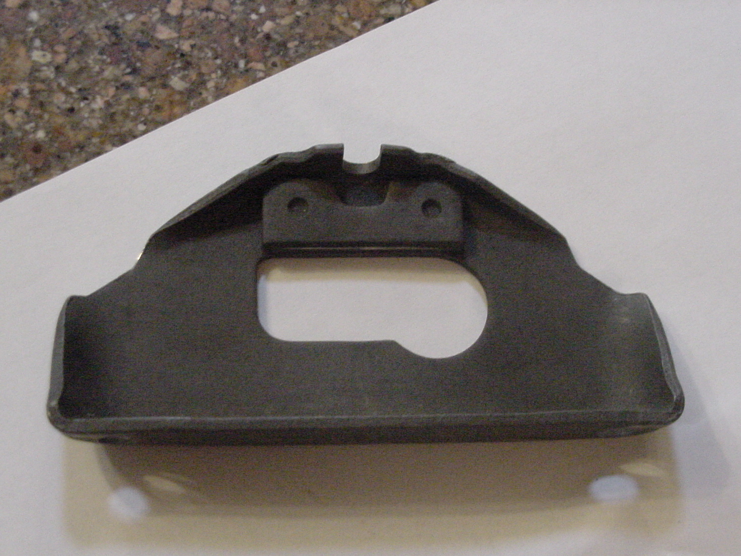

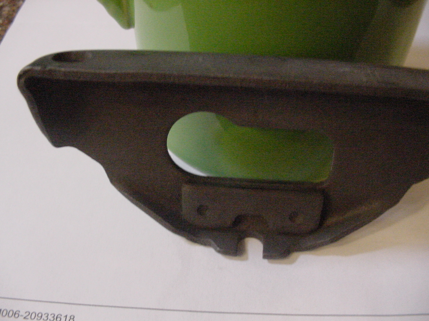

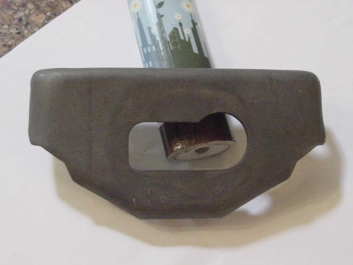

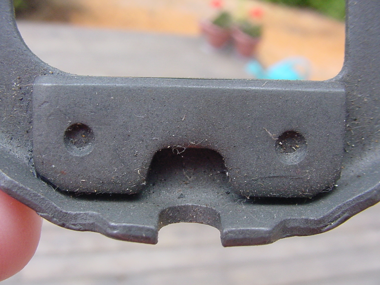

Well presented. The lever ball bushing are often overlooked. I hate to be a pain. The contact edge of the detention plate is pretty worn. It should be straight across the contact edge. Is the shift lever grooved at the contact point?
rhodyguy
post Apr 29 2015, 11:51 AM
Posts: 22,252
Joined: 2-March 03
From: Orion's Bell. The BELL!
Member No.: 378
this is a pretty clean detent plate. junked up springs caked to the point they don't compress adds to the 1&R engagement issues. worn plate, worn shift levers, and spent lever ball bushings just makes matters worse. i'll see if i can find a shifter that has what i consider excessive wear at the detent plate rub point. the backing plate on yours is worn to the point that the crisp line is gone and the surface is wavy. new ones are $36.75 at the bird. gpr may have them also. pn 901 424 017 00. they are common for early and late shifters.

Member No.: 13,281
QUOTE(rhodyguy @ Apr 28 2015, 10:39 PM) *
....The contact edge of the detention plate is pretty worn. It should be straight across the contact edge. Is the shift lever grooved at the contact point?
Rhody-
Yes the shifter bar is very worn, look at the 6th frame down.
Should I weld this back up and grind it smooth and round ?
Also I didn't catch the worn detent plate. Not enough experience.
$36 to rid as much slop sounds like a good deal.
Not sure what vendor is "the bird"?
Pelican parts ?
rhodyguy
post Apr 30 2015, 06:30 AM
Posts: 22,252
Joined: 2-March 03
Member No.: 378
Yes, pelican. I had missed the picture showing the wear point. I would consider that excessive.

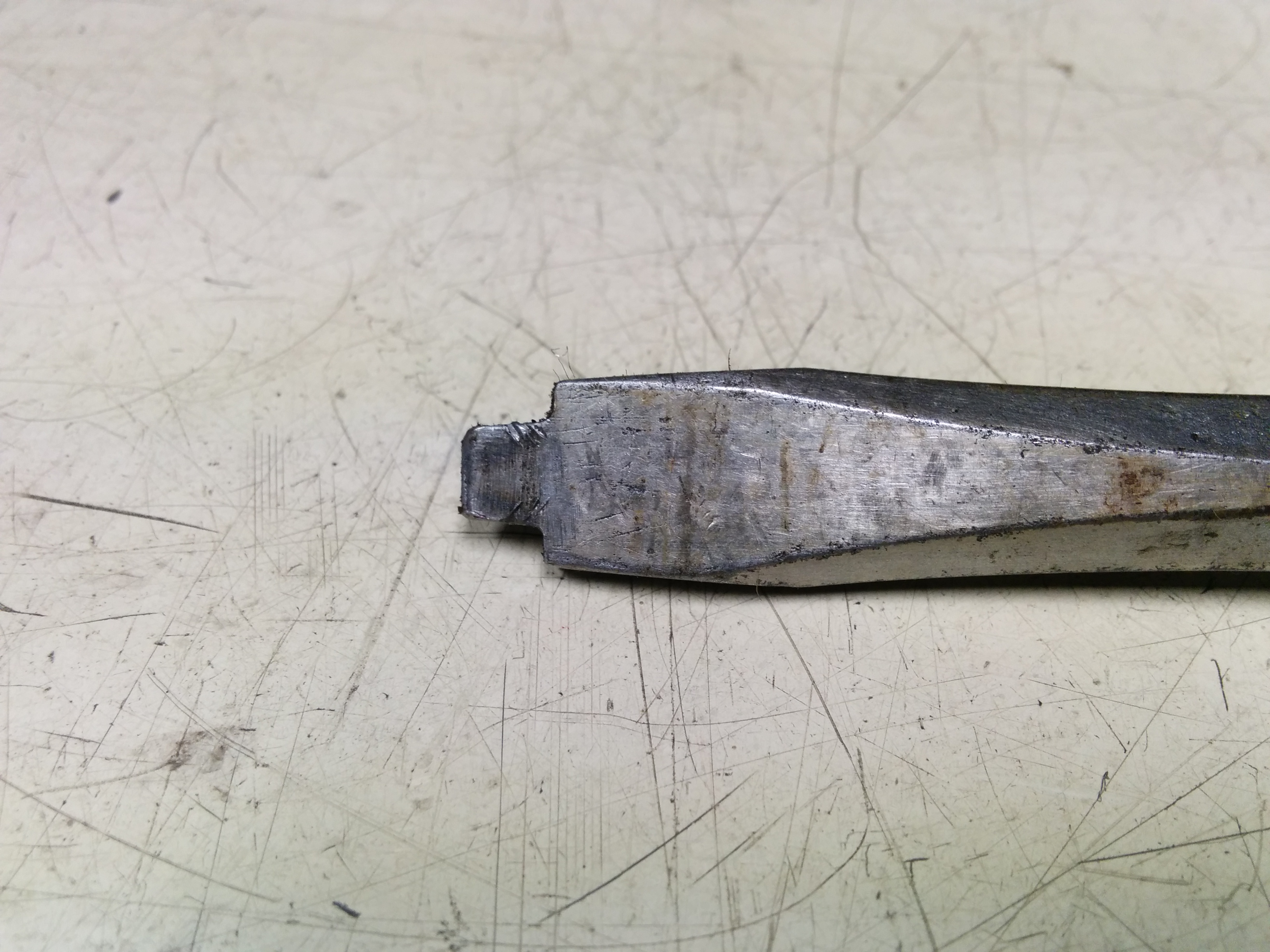

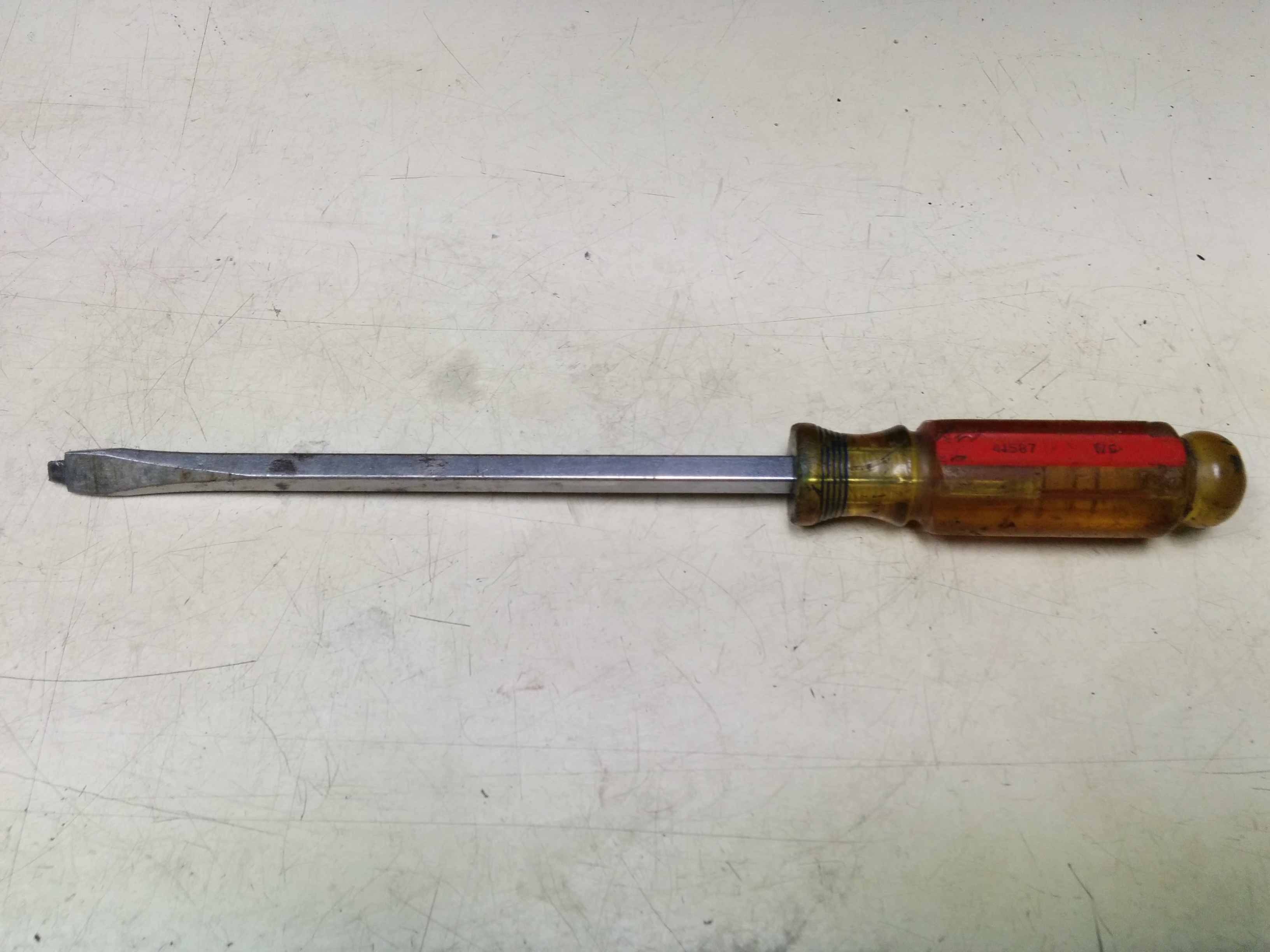

I made this tool a long time ago for just this type of project....guess I should patent it eh...modified a large flat blade screw driver....gives that little extra push(compression) on the spring with out slipping
