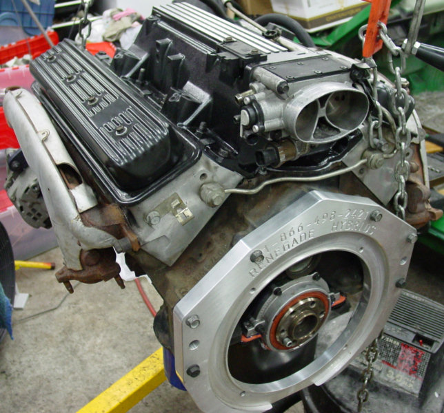

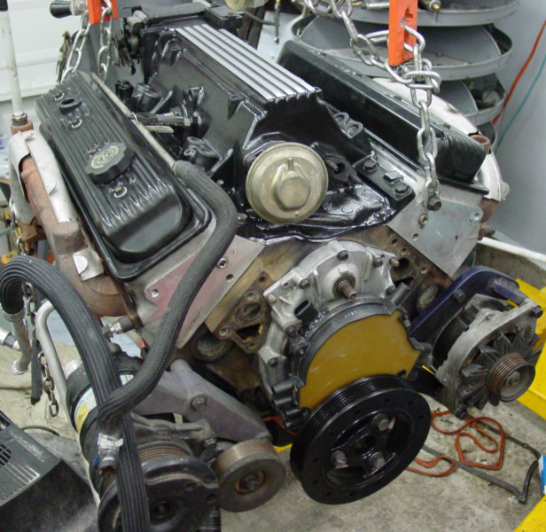

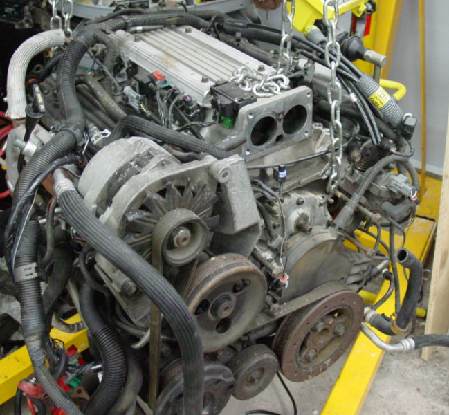

I took all the accessories off my LT1 in order to re-do the belt system and turn the intake around. Now I'm putting it back together. I tried to anodize the intake manifold, but it was just too big and my setup can't anodize it well enough to take dye. It kept coming out purple, er, I mean aubergine. (IMG:http://www.914world.com/bbs2/html/emoticons/smile.gif) I gave up and just painted it black.
I'll start with the before pic:

Front after: (obviously I don't have all the wiring and fuel rails back on)

Rear after: (anyone know what to fill the half circle with under the engine so the front side of the flywheel isn't exposed?)

well royce the kennedy suby kit has an AL plate to cover that opening, i wonder if the sbc kit does or if you could make one.

The adapter should have come with an aluminum plate that fits over it, its just an inspection plate and I think you can get the same one from any of the old GM cars or make your own.

I saved the VSS out of the trans, I'm going to put a toothed wheel on one of the output flanges of the trans. I should probably get started on that.. I need 400 pulses per mile, but maybe I'll adjust it to 300 so I can go faster before the computer says no (IMG:http://www.914world.com/bbs2/html/emoticons/smile.gif)
There was a plate over the flywheel before, but it bolted to the trans and had a big hole for the starter. I'll probably just make a plate.
