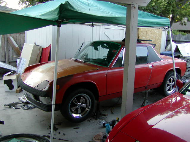

> Alright, I got 3/4's of my 5 lug done.., now to do the rest.
Andyrew
post Jun 16 2003, 09:17 PM
Spooling.... Please wait
Posts: 13,381
Joined: 20-January 03
From: Riverbank, Ca
Member No.: 172
I guess I should give you guys a pic to look at.. I want to get this thing done in 2 weeks, so I think I better get crackin.. Well Hope you guys like my 5 lug!

Looks great!
