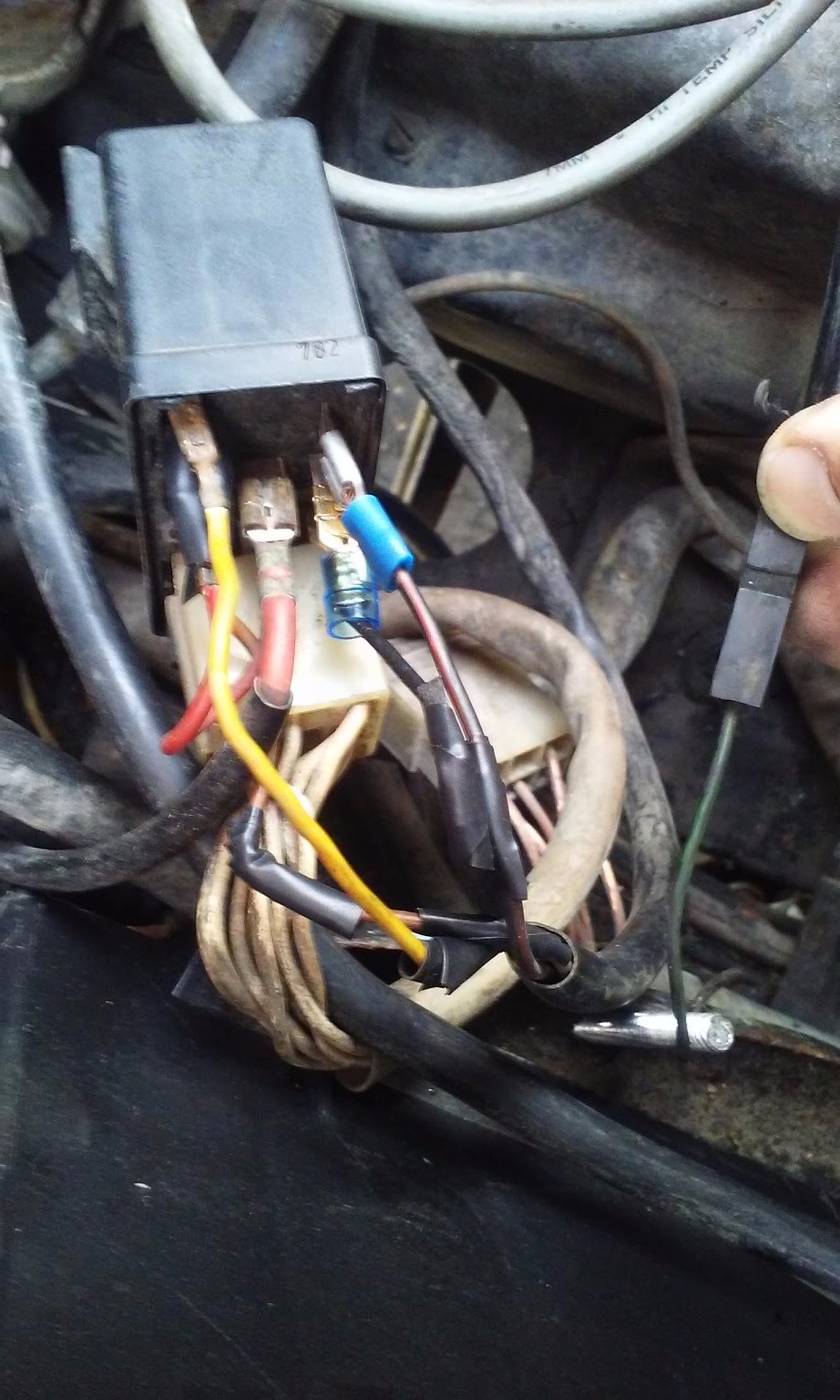

The owner pulled apart the dual relay - fuel pump/injector side - which I had to wire back together because he said there was a "fuel pump issue" which I think is the relay. Everything else seems to be intact relating to the engine and the other half of the dual relay. The lights, radio and gauges are another story.
Oh. There is one black with green stripe wire that is not connected. Not sure where that goes? Please don't judge the wire connectors. I'm just getting it together so it runs and will clean this up later.

I'm not sure if I can see the jumper from 88Y to 88Z, other than that it looks wired correctly.
With the ignition set to on and the ECU connector unplugged, do you get 12vdc at pin 10 to ground?
