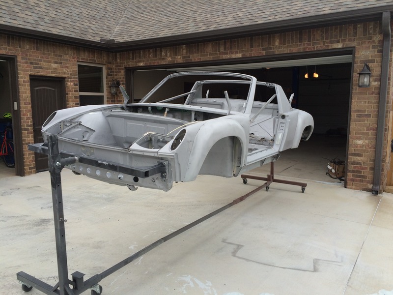

my car was media blasted (non WSB) for $1100 in my driveway. No panel warping that I'm aware of. It came out very clean, but there IS a lot of hidden media in the car like Andy described (not a big deal to me since it falls out as I rotate the rotisserie frequently).
As far as flash rust.....In my experience, I've left the bare chassis in my climate-controlled garage for two months with minimal rust since then.....except where my sweat gets on the bare metal. Ideally it would be nice to immediately primer the entire car, but I had too much grinding/welding left to do. I probably should have primered the areas that were finished (like the front trunk or hood)
