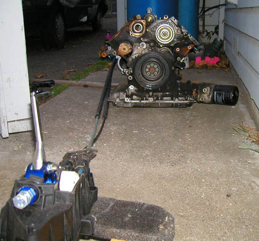

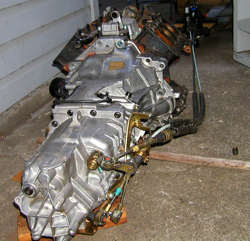

I couldn't find a Gates hose supplier open today so my V8 project got stalled. I really need to get this car running before Neo914 arrives from WA.
I went ahead and dug out the Boxster tranny buried behind the 914 V8 and got my new jack installed in my engine lift to get the Audi block on a dolly. This enabled me to test mate them for the first time. I knew the patterns were close but I found the alignment pins matched perfectly and most of the other holes as well. The starter pocket matched too. This means no adapter, no modifying the bellhousing, or finding an alternative tranny. The Audi pins had a shoulder but the diameter matched so all I need to do is buy the pins from the Porsche parts dealer and buy the bolts from the Audi parts dealer (IMG:http://www.914world.com/bbs2/html/emoticons/smilie_pokal.gif)

Here's the B&M shifter

Have you done a hieght measurement yet? The Audi pan looks very deep.... (IMG:http://www.914world.com/bbs2/html/emoticons/huh.gif) Really cool how that bolts up. (IMG:http://www.914world.com/bbs2/html/emoticons/smilie_pokal.gif) Your on a roll! (IMG:http://www.914world.com/bbs2/html/emoticons/clap.gif)

Preliminary measurements indicate I may not even have to cut any engine compartment sheetmetal. Once I get the Neo914 roller I can position them to design and fab the engine and tranny mounts. The bare block will make it easier to position. Then I'll mount the fully dressed engine to figure out the exhaust and cooling. I may fit them in the Chalon car before the V8 goes in... (IMG:http://www.914world.com/bbs2/html/emoticons/idea.gif)
The shift cables "should" be the easiest to route. All I have to do is position the shifter.

that is great news there Felix...I was pretty sure at least one or two of the Audi engines would bolt up...now this is the 5 speed version correct?

I'm interested in how much fabrication will be needed to get that Boxster tranny in the right place on the car? As you could also bolt a 3.4 from a 996 to that tranny as well.
There are a growing number of Boxster drivers who have done the 3.4 conversion quite successfully.
It would stand to reason that the new Audi 2.0T , 1.8T, non turbo 3.2 V6would also bolt on to the 5 spd boxster tranny since its shared with the A4.

Tell me your Audi sources, I need to find out the deficiencies of this engine. The front to back of the V6 is very short. When lining up the axles, I will still have over 5” of clearance in the front to the bulkhead. Like the V8’s, the servicibility should be pretty good. This ex-track car also has a bulkhead access panel. (My profession is tech support so I believe heavily in design for service)
Did you have a hunch that the engine & trans would mate directly, or is this just the auto gods smilimg down on you in unbelievable fashion.
Chris and Mike,
It was a calculated risk, I posed the question on VWVortex and Audiworld with little response but found the 012 was similar. This cross-compatibility of parts may only be known by a few Audi-VW engineers.
Grant,
Did they do the 3.4 conversion with the 5-speed? I really wanted an “S” 6-speed but noticed too many differences on Jason’s tranny to match to the Audi engine. He has the full “S” drivetrain for his 914 and I would have followed this route but didn’t want to modify the engine bay and rear suspension. I never got to the point of creating a template to check bolt patterns when I noticed the starter pocket is on the top.

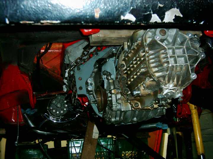

ajracer
post May 29 2005, 09:36 PM
Posts: 204
Joined: 18-April 04
From: Toronto, Canada
Member No.: 1,945
Felix:
Should be an interesting porject and at least it will all be "German"
I know you had commented in my Project 914-LT1 posting regarding
a BOXSTER tranny and V8 engine. Which is what I am currently completing
in my vehicle.
BTW in your picture of the tranny and V8 did you actually connect them together
or just do a mock / trial fitting to see if they were compatable. We you actually
also thinking of doing the Boxster and Chev V8 combo also ?
Anyway I have attached photo that confirms my setup and what I am currently
doing; hopefully it will be on the streets within a month or two. Keep in touch.
Allan
