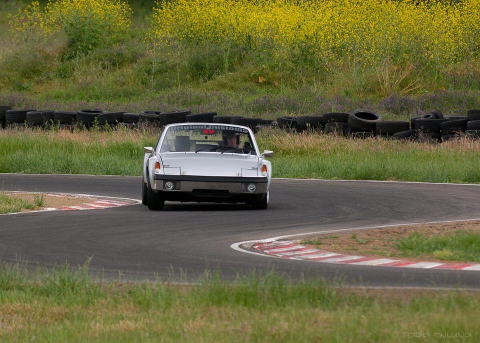

Mine is a 3.2 six conversion. I have 200# rear coil overs with stock front 4 cylinder torsion bars. All the bushings are Elephant which makes the car feel stockish on the road. I do use a stock rear sway bar and a Taret front bar. I like the front soft so I can tune with the Taret bar. If you have a four cylinder, your 140# Welts should be fine.
As you can see, at full song she handles perfectly flat.
