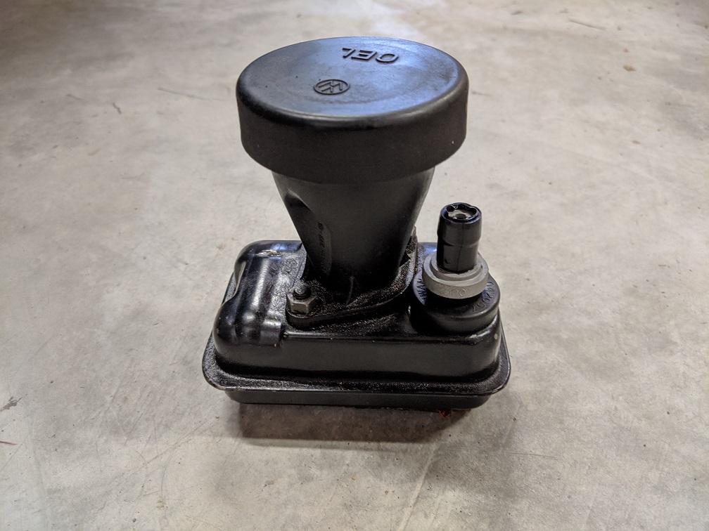

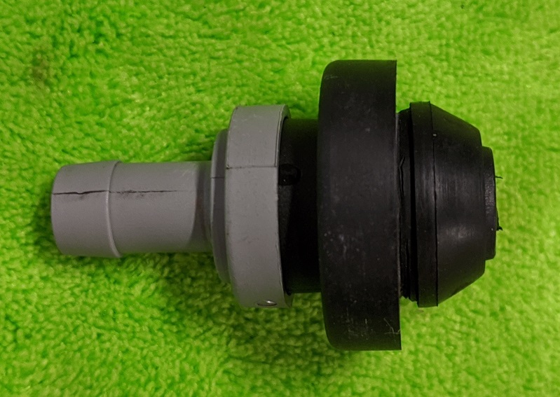

The solution I finally came up with (again taking a cue from pbanders), was to adapt a modern, readily available PCV valve to the car. This provides apparently similar airflow as stock at high engine loads (low vacuum), and lower airflow than stock at idle (high vacuum). If you try this, you'll likely need to adjust the idle screw on the throttle body to compensate for the reduced flow.

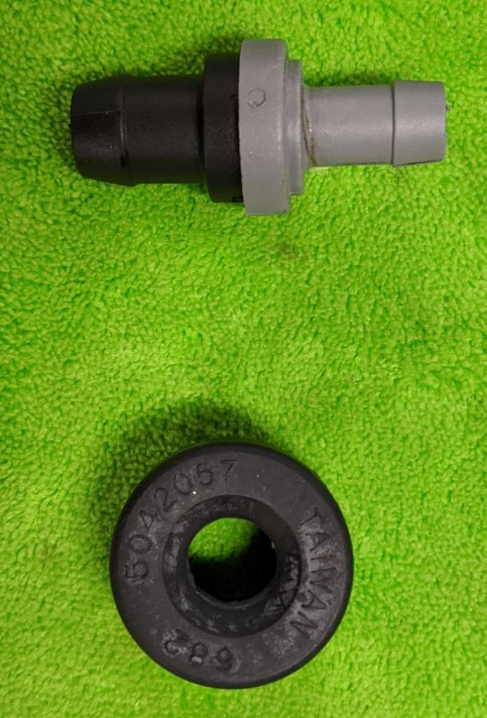

The components I used are as follows:
PCV Valve: Microgard PCV 279 (cross for FRAM FV279) which is a generic valve for a 1990 Toyota Corolla
Grommet: dormanproducts.com p/n 42057 PCV Grommet (cross for Toyota 90480-18180)
The grommet fits the hole perfectly in the 914 breather box. The nipple on the valve is around 11mm diameter, which is a bit too small for the 13mm PCV hose (or elbow) on the 914. I currently just have the nipple on the valve wrapped with electrical tape to size it up to 13mm, but I plan to fit a proper adapter to size down the 13mm hose and connect directly to the valve. I suppose I could also fit the original elbow, but plan to just leave the hose exiting the valve vertically.
Here are the relevant pics:
