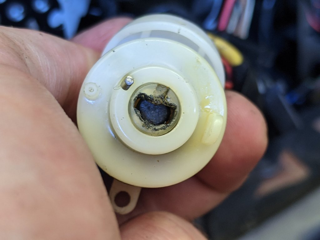

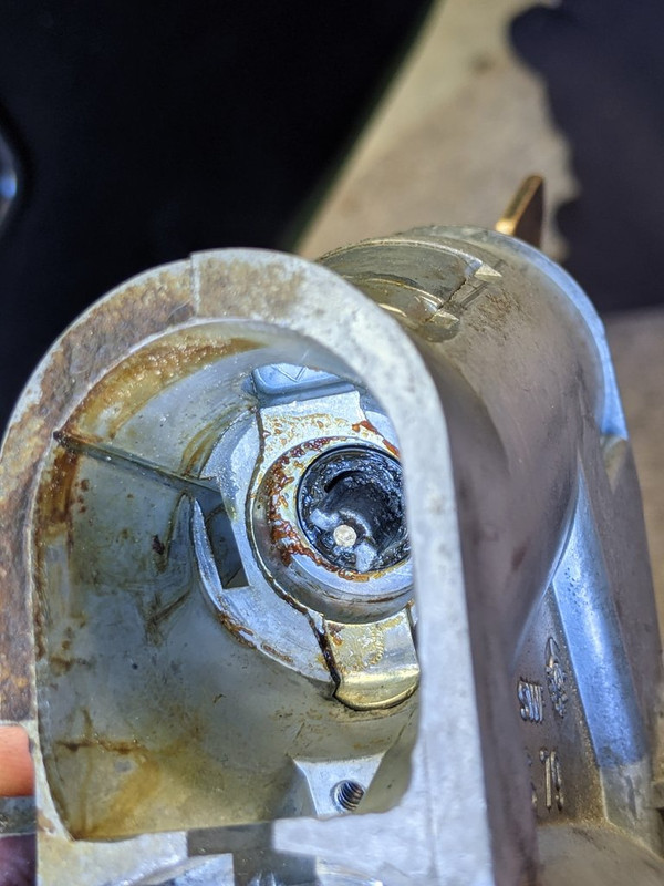

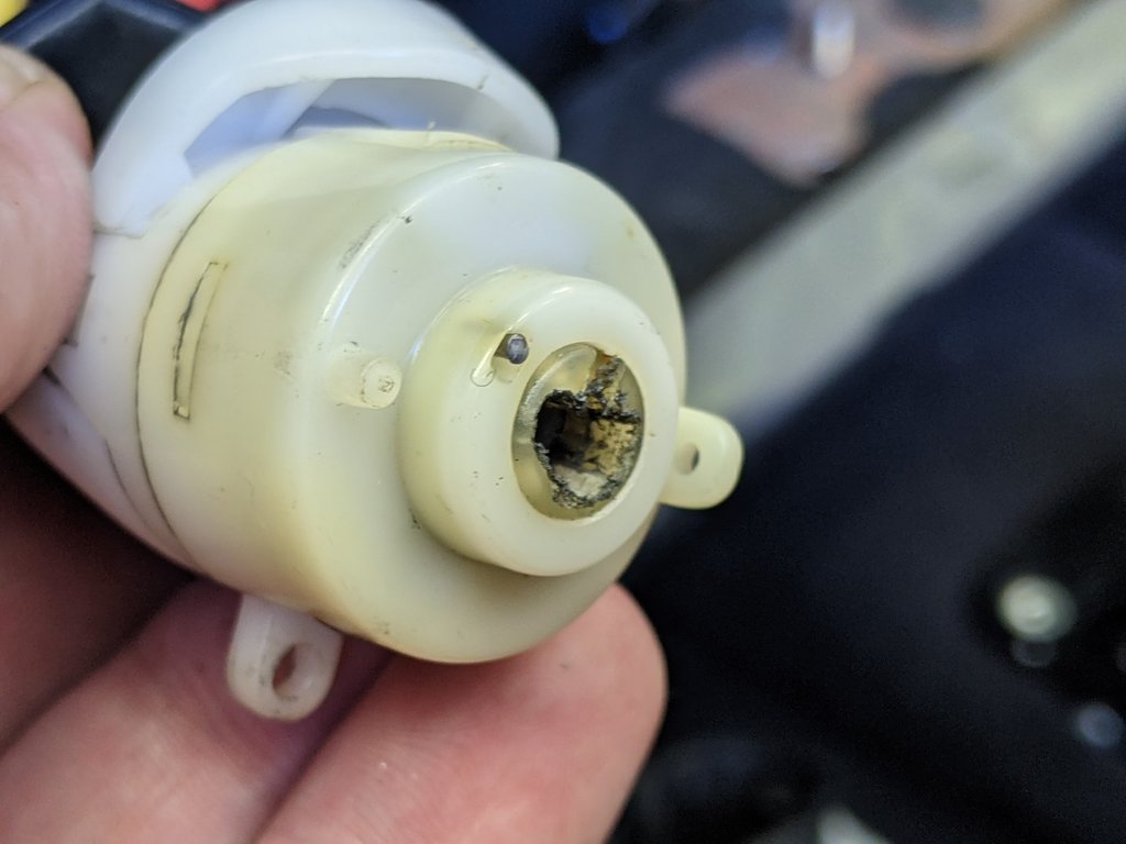

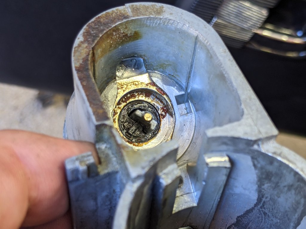

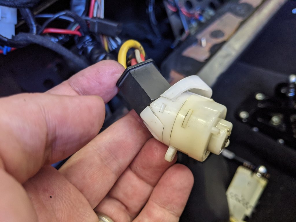

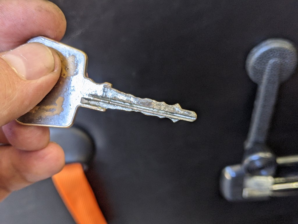

I still need help with this, please. But, I have some new information...
The problem is somewhere in the ignition switch/barrel area. See photos below for reference of my switch, inside my barrel and also the key, showing wear for reference (if that's relevant).
When I turn the ignition switch with a screwdriver, all works ok.. engine starts, happy days. When I assemble the switch into the barrel and turn with the key, it does not. When I turn the key in the barrel by itself when disconnected from the column, just holding it in my hands, things 'sound' correct. I mean, I can hear the key turning through the motions as it should.
So, something is preventing the key from turning the switch when things are assembled together.
Any ideas? Looking at the photo of the key-end of my switch, does that look worn out? Could that be the issue? Or maybe, is the tab in the barrel somehow not connecting properly?

Take the assembly to a locksmith that's been in the business for a while....they can verify what's not right and likely make what's called a "code cut" key that will work perfectly....likely won't cost more than about $75 & take less than an hour.
