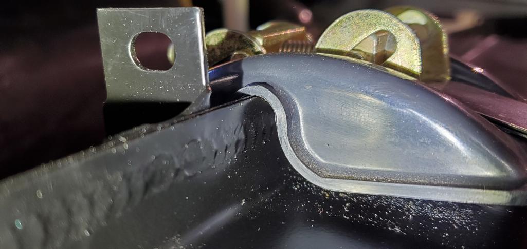

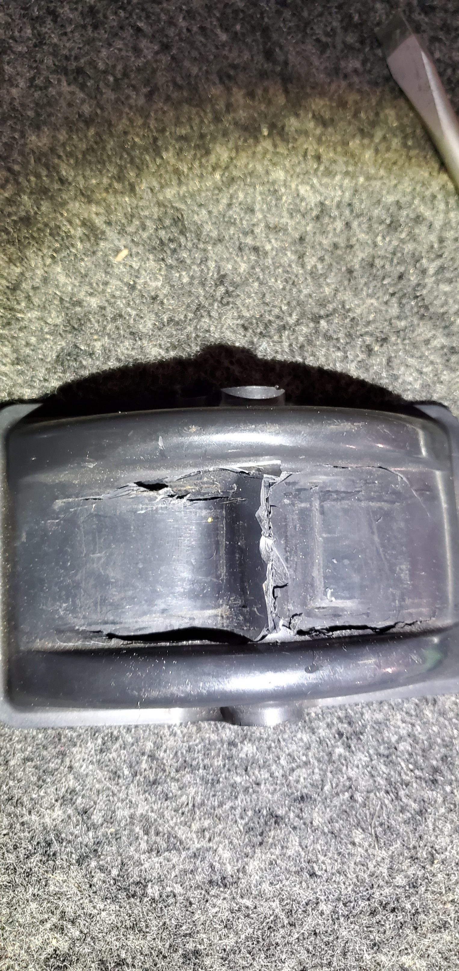

When i got my new fuel tank from Dansk it turns out that the rib that runs along the top of the tank is too tall for the mounting strap and guide. This means that when you tighten it down it does a beautiful job of destroying your plastic guide.

BillJ A fix is trim off some of the material under the g... Jan 26 2021, 03:26 PM
aturboman Had the same experience with my Dansk tank.
Since... Jan 26 2021, 03:31 PM
BillJ Next, using a cutting wheel in my case, carefully ... Jan 26 2021, 03:38 PM
BillJ I will say you could probably do this with the tan... Jan 26 2021, 03:45 PM
914Sixer What about gluing some rubber pads on to the plast... Jan 27 2021, 08:08 PM
raynekat
What about gluing some rubber pads on to the plas... Jan 27 2021, 09:53 PM
BillJ Of course if you do this to the tank when you firs... Jan 27 2021, 10:59 PM![]() ![]() |
