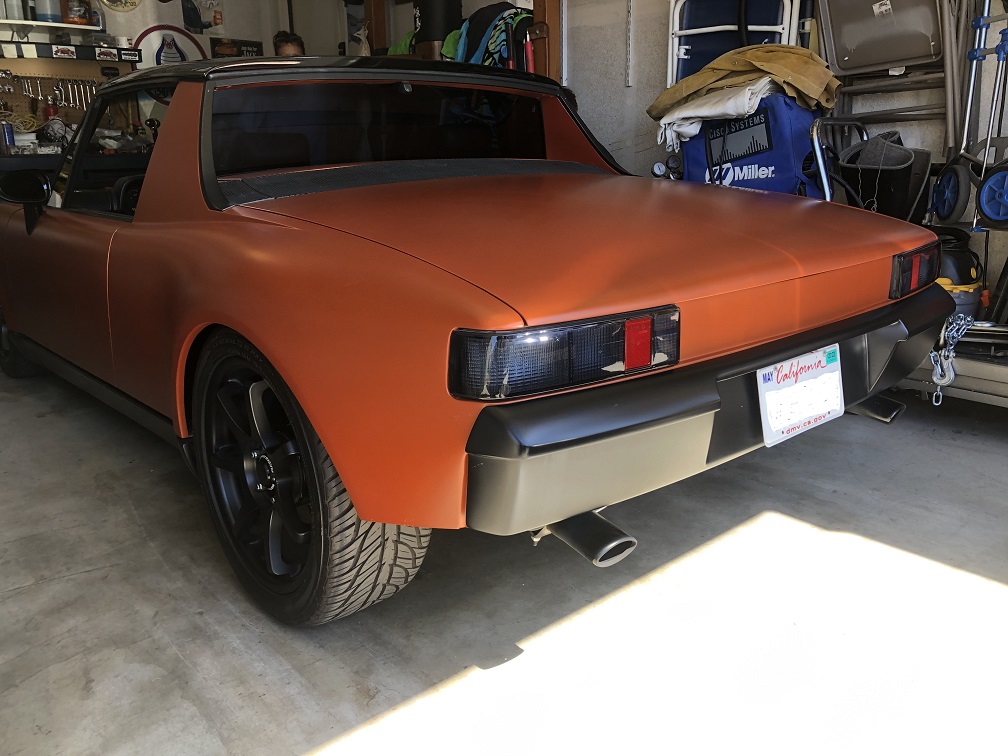

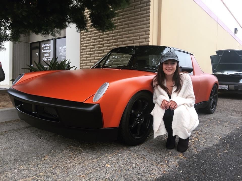

Couldn't pass it up. I saw Kent's car for sale at the Phoenix Club.
This picture is my daughter Sammy in front of Kent's car 5 years ago at the G&R swap meet.
I always wanted a V8 914.
No, I'm not selling the six.
Here is a link to Kent's thread.
http://www.914world.com/bbs2/index.php?sho...228918&st=0

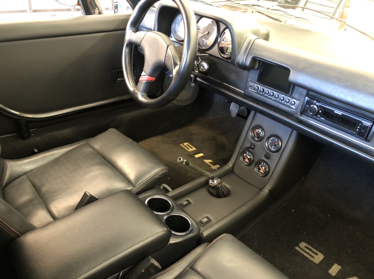

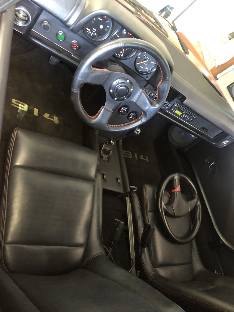

Fixed dash lights, installed horns, added voltmeter, clock and arm rest with drink holders.
Idiot lights don’t work and the harness in the engine compartment is hard to get to, so I added the voltmeter so I can see if the battery is charging. The car already had a temp and pressure gauge, so I don’t need idiot lights for that.
I also added a toggle accessory switch. The stereo and electric windows were connected directly to the battery. Now I can shut everything off or have it come on with the ignition or directly to the battery without running the motor.
Also replaced the CD player with a Bluetooth media player. The stereo is amazing.

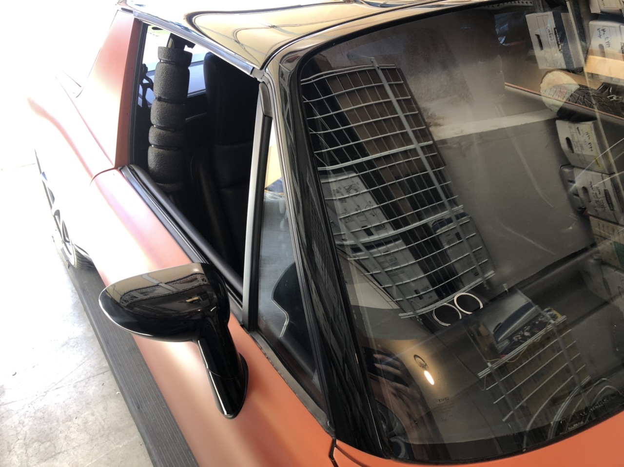

I also put some foam padding on the roll bar by my head. I was paranoid if there was a side impact that it would crack my head.

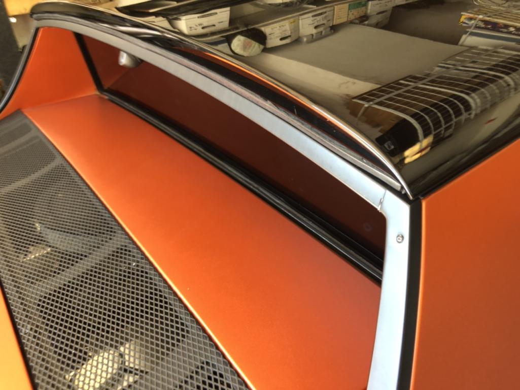

The targa top is way cool and matches the paint on the pillar. Only downside is that it’s cut short in the rear, so it won’t stay in the trunk properly.

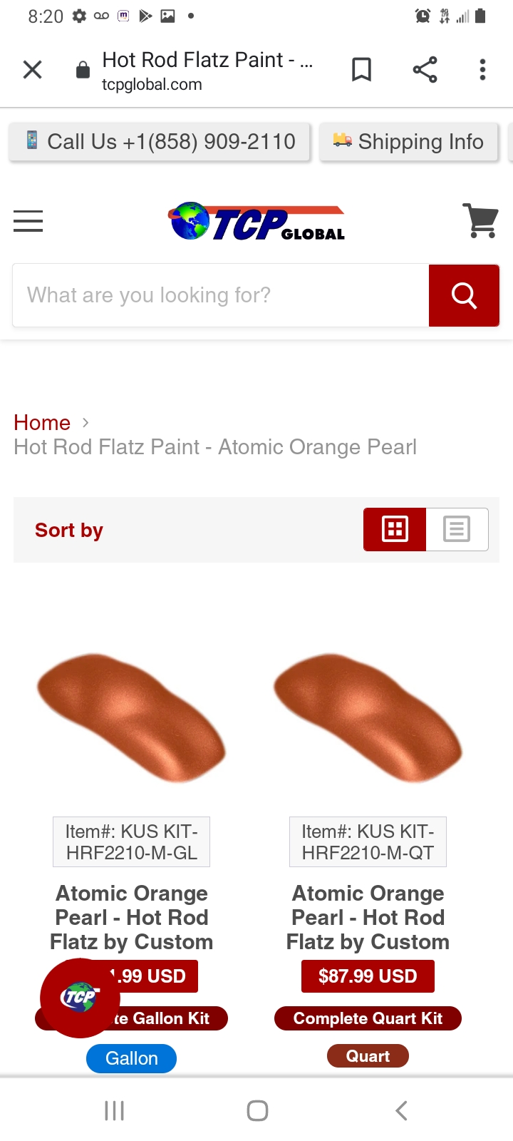

Super cool car. Soooo clean... Anybody know the exact color? Looks like some sort of Satin Orange?

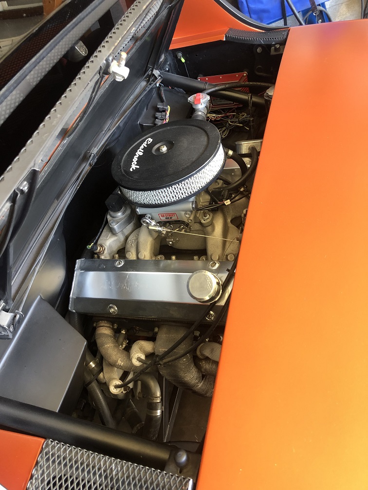

Thanks!! Kent installed metal boxes in the engine compartment, so they don’t interfere with seat travel. They work fine with a v8. They would probably interfere with a six.
Check out the link in the first post of this thread to look at Kents build thread.

QUOTE(Craigers17 @ Nov 24 2021, 02:35 PM) *
It’s called Atomic Orange Pearl
