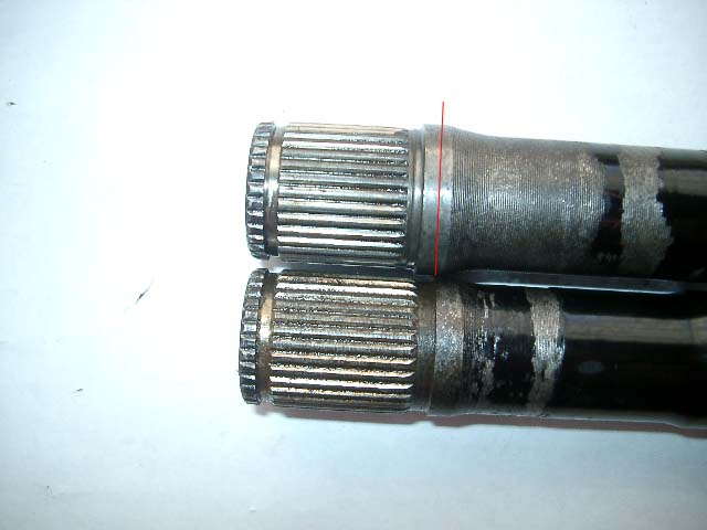

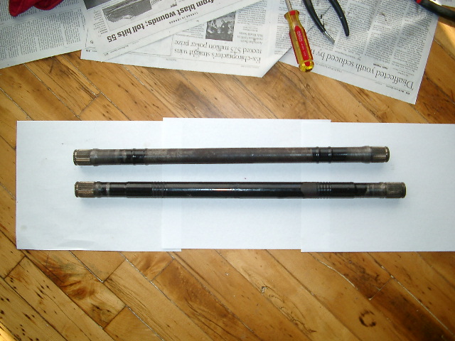

turns out, the 944 Turbo CVs are 4mm thicker than the 914 CVs which means the 914 axle shaft has to be machined down a bit for them to fit.
see pictures below ...
(IMG:http://www.914world.com/bbs2/html/emoticons/smash.gif) Andy
1 - 914 shaft on top, 944 shaft below
(IMG:http://www.914world.com/bbs2/uploads/post-11-1123372532.jpg)
2 - closeup, for difference, see table below ...
(IMG:http://www.914world.com/bbs2/uploads/post-11-1123372553.jpg)
3 - 4 mm needs to be removed from the 914 shaft to accomodate the 944 CV
(IMG:http://www.914world.com/bbs2/uploads/post-11-1123372569.jpg)

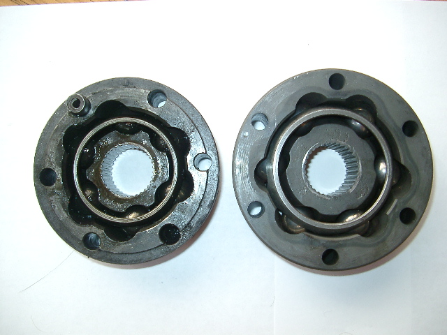

4 - 914 CV on the left, 944 CV on the right
(IMG:http://www.914world.com/bbs2/uploads/post-11-1123372588.jpg)
5 - 914 CV on the left, 944 CV on the right
(IMG:http://www.914world.com/bbs2/uploads/post-11-1123372608.jpg)
Dimensions:
914 Shaft, dia. = 25mm, length = 514mm
944 Shaft, dia. = 26mm, length = 540mm
914 CV, dia. = 94mm, width = 31mm
944 CV, dia. = 100mm, width = 35mm

yes, this is based on clay's parts list ...
it would be great if you could use the 944 shaft, but it's over 1" longer so that won't work.
the 914 shaft is only 1mm thinner than the 944 turbo shaft, so i'm not worried about the strength of the stock shaft, plus, it comes with the right length built in!

I found out the same thing. I took the shafts to Wes and he machined a groove below the splines. Plus he says to leave out the washer below the cv joint.

huh? NOOOOOO ....
the shaft itself is 1mm bigger in dia. but the SPLINE IS THE SAME where the CVs are mounted ... (IMG:http://www.914world.com/bbs2/html/emoticons/wink.gif)
944 CV's slide right onto the 914 shaft, same spline and all. if you look at the closeup pics you can see how both shafts taper off after the spline part down to the actual thickness of the shaft.
so the 1mm difference does not matter ...
as for the bolt pattern, NO it's NOT the same, 944 uses 6 bolts (like the 911) and the 914 uses 4 bolts ...
that's why you need the 911 output flanges and the 944 stub axle, like aaron posted ...

Are the bolt hold patterns the same between the 914 CV and the 944 CV
The bolt hole patterns are not the same. You need different output flanges and stub axles for these CVs to work on a 914 as noted in Aaron's post.

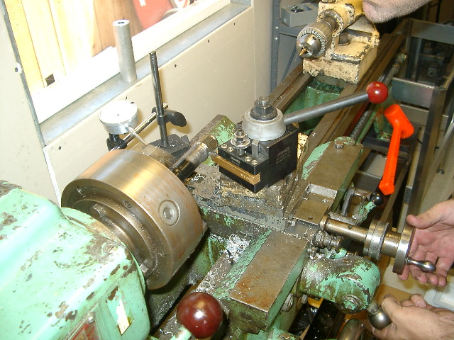

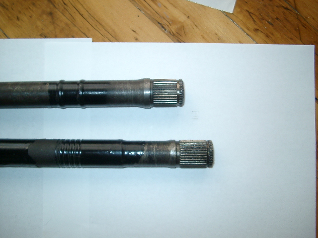

UPDATE on the machining of the 914 shaft ...
here's Mueller Meister in action: (IMG:http://www.914world.com/bbs2/html/emoticons/smash.gif)
(IMG:http://www.914world.com/bbs2/uploads/post-11-1123463973.jpg)
turning them down: (IMG:http://www.914world.com/bbs2/html/emoticons/sawzall-smiley.gif)
(IMG:http://www.914world.com/bbs2/uploads/post-11-1123463990.jpg)
and the end-result: (IMG:http://www.914world.com/bbs2/html/emoticons/smilie_pokal.gif)
(IMG:http://www.914world.com/bbs2/uploads/post-11-1123464006.jpg)
fits like a glove ...
(IMG:http://www.914world.com/bbs2/html/emoticons/beerchug.gif) Andy

wow...I have more hair than I thought (IMG:http://www.914world.com/bbs2/html/emoticons/smile.gif)
i was expecting it to be harder to cut those axles, but it was not too bad....
