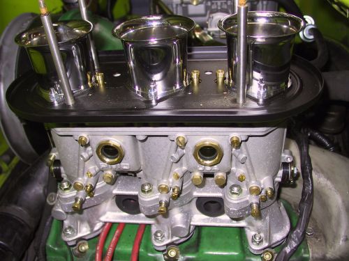

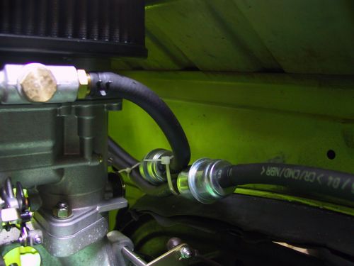

In the /6 conversion that I'm currently running, the green car, I was using Mechanical Fuel Injection. I still think it's kind of sexy, but it's hard to get it to run really well in a 911, with everything original, and even harder in a 914 with non-stock intake and exhaust. I was not able to get rid of a big flat spot between 3K and 4K nor to get a properly functioning warm-up regulator. I got tired of the MFI and got PMO carbs instead.
I put them on the car that's running. They run ok, already, but the fine-tuning still needs to be done. I will take them to an expert to get them really tuned-up.
The install itself was easy, it's really a bolt-on exercise. Some have said that the weakest part of PMOs is the install instructions, but I thought they were OK.
Installation took 2 or 3 evenings of working slowly.

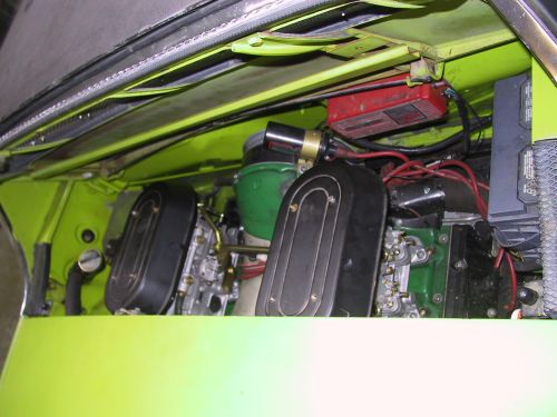

So here's an overall view:

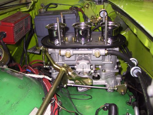

left carb
michel richard
post Aug 14 2005, 09:40 AM
Posts: 1,291
Joined: 22-July 03
From: Longueuil, Québec
Member No.: 936
right carb

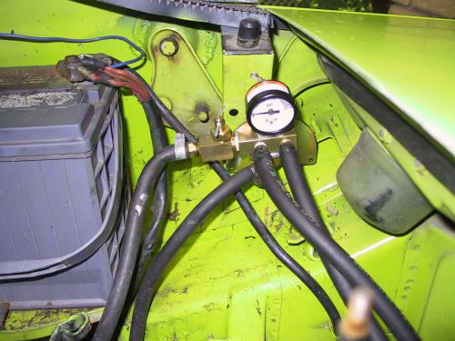

fuel pressure regulator

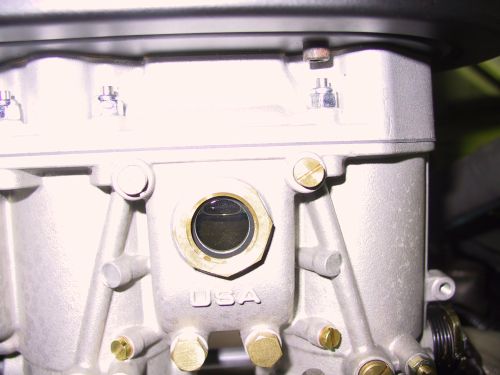

fuel level window. It shows my level as a little high, but that may be because the engine was not running when the pics were taken. I believe the level was OK with the engine running, but I need to re-check.

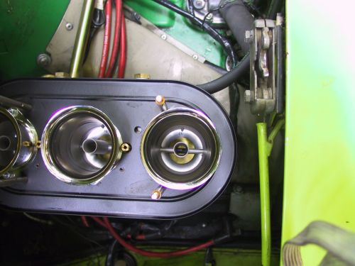

Finally, one of the bores. You can see the 32 mm venturi. The kits are really complete, with all parts for a conversion and all the little fittings, including fuel hose and clamps.

Michel, where can I get a fuel pressure regulator like yours?
Are one of those lines a return line? It looks like it.
