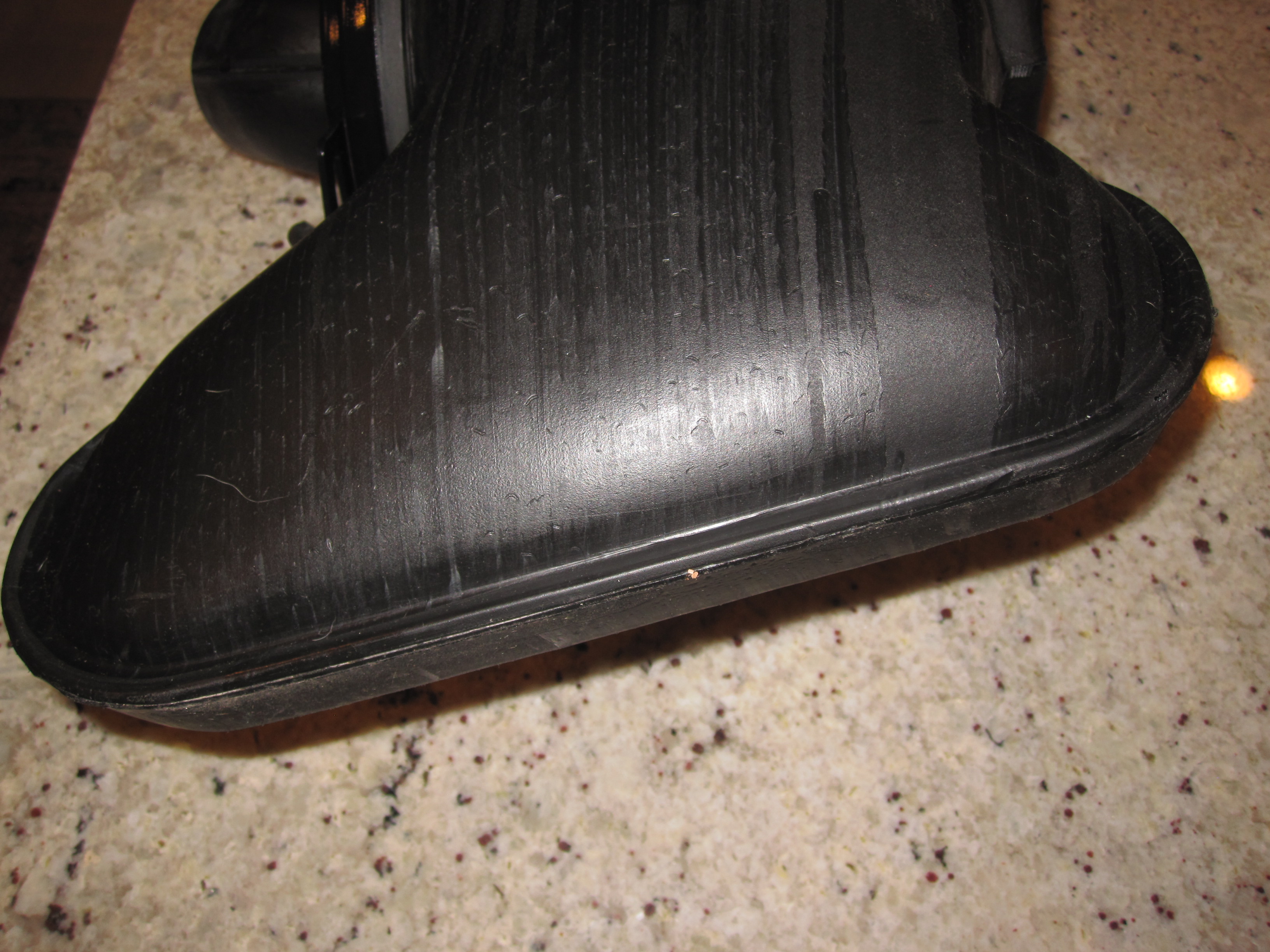

I recently picked up a 911 mechanical fuel injection, air cleaner assembly . I was hoping I could use this with the carburetor Air cleaner base unit I already have. I was wrong once again. Can anyone point me in the right direction on how to make this set up work? I have no problem making custom clips to attach to. Has anybody modified a plastic air cleaner to work with Zenith air cleaner base mounts.

Hey Matt Don't modify anything yet. I have a plastic AF housing, Weber boats and a 2.2E MFI unit. Let me see if they cooperate. Rory I just re-red your post and hope this helps MFI boats have different clips and a taller flange on the inner edge of the rubber seal If you trim the flange even with the top edge of the seal and change the clips I think you'll be in business. See the pics. Be carefull with the wire clips, there ar two versions. You'll need the larger ones Attached thumbnail(s) |

914 6 air filters did. Your snorkel is for a 911 Are the wing nuts plastic ? Fires in the plastic housings were caused by a faulty enrichment system, faulty carbs and faulty maintenance, not by the housing itself. Matt your housing is melted in the round openings for each stack. That's not unusual. Are the mating surfaces flat ? What carburators are you using ? Added pics of a plastic MFI housing. Attached thumbnail(s) |

I hope this helps. And congratulations, that's a 914 6 housing. Attached thumbnail(s) |

Hey Matt What doesn't fit ? You have a 6 air filter, Zenith boats (same as Webers) and Weber carbs. When installing the stock air filter housing in the car it is a bit of a wiggle. Attaching the drain hose, the big vent hose and flipping a couple of the clips is annoying. Doesn't sound like any adaptation is necessary except for correct clips. |
