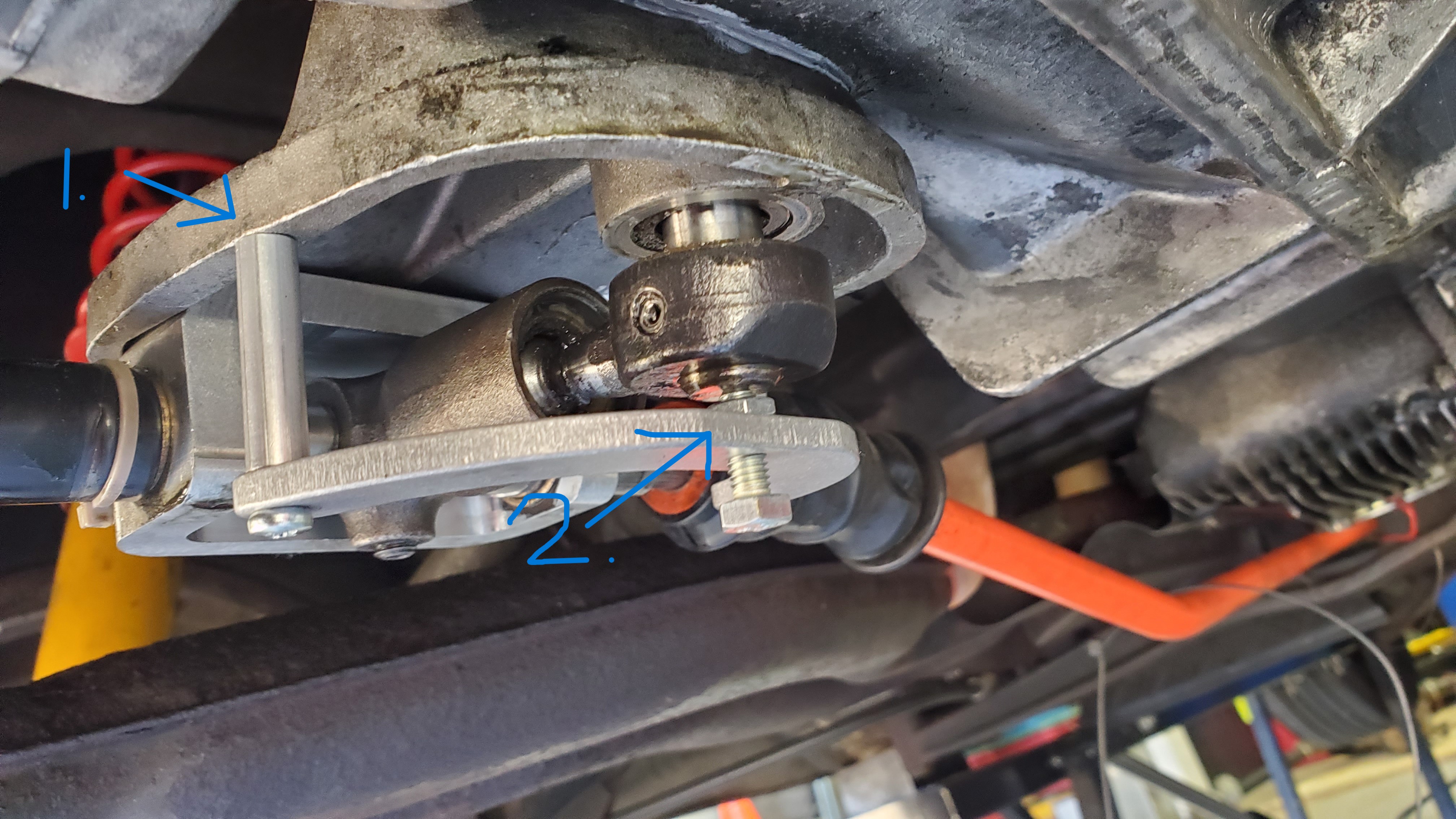

Like the army of 914 owners who have struggled with shifting issues, I’ve spent hours and hours trying to get my ride to shift better than a stir stick in a bucket of sand. Yes, I’ve purchased everything available in terms of replacement/upgrade parts and rebuilt from the shift knob to the transmission housing. Little by little shifts got cleaner and more predictable. I was not, however, satisfied as compared to other P cars I’ve owned or driven.
As always, I checked Tangerine Racing for any possible solutions. Talking to Chris, he suggested a newer tool that aligns the contraption from front to back. My starting point was close to acceptable as described above. Installing the tool and completing the adjustment including clean up took about 75 minutes (less if you aren’t in a hurry). It does require drilling two holes in the transmission shift plate and tapping out the holes (drill bit and tap included with the tool) but it shouldn’t scare you. This setting did the trick for me. No clipping reverse from 1st to 2nd. Cleaner engagement in 2nd through 5th. I really am happy that Chris has developed this and recommend it whether you are new to fixing your shifter, or just want to get to an end point like me. You may find a micrometer helpful, but not necessary. Also, Chris was very helpful answering the few questions I had. Hopefully, you will find this useful. 1. Drill and tap location 2. Adjustment |

I could never visualize how this works or what it does. Now seems like a great time. care to explain? Future customer here... The fixture holds the shift console in the 2-3 plane. To use it, put the car in second gear. Then set the fixture so the bolt touches the bottom of the shift shaft. Put the transmission back in neutral. Then loosen the bolt at the shifter and make sure it is touching the spring loaded gate, but not compressing the springs. Center the shifter and tighten the bolt. Your trans should shift properly now. |

It took me maybe 10 minutes to drill and tap the cassette on the race car (both drill bit and tap are included), the location is obvious (the center of small cast-in circles, see attached photo). Then it was another 5 minutes to adjust the shifter. Next time the street car is on the lift it'll get the same treatment. Good tool to have around. - GA Attached image(s)

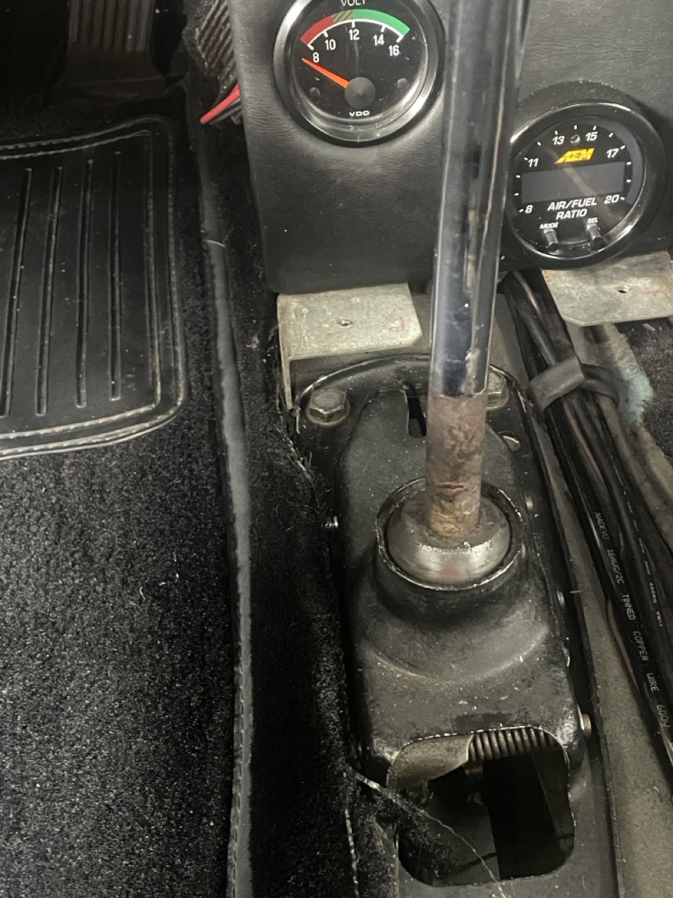

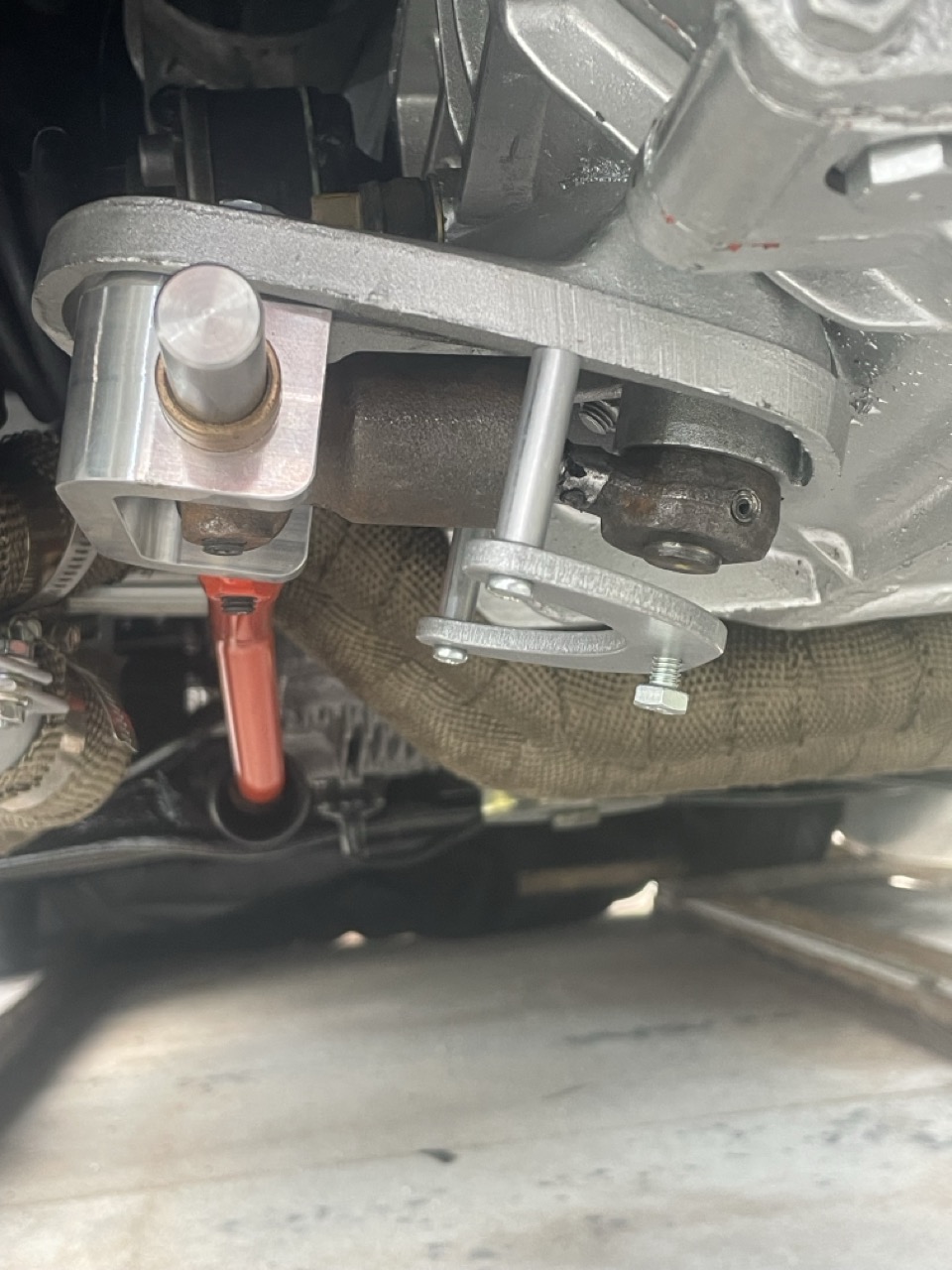

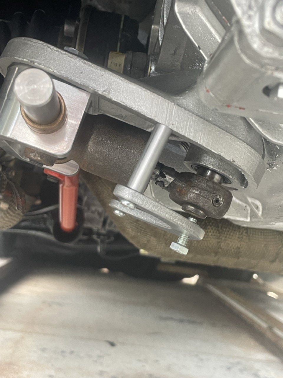

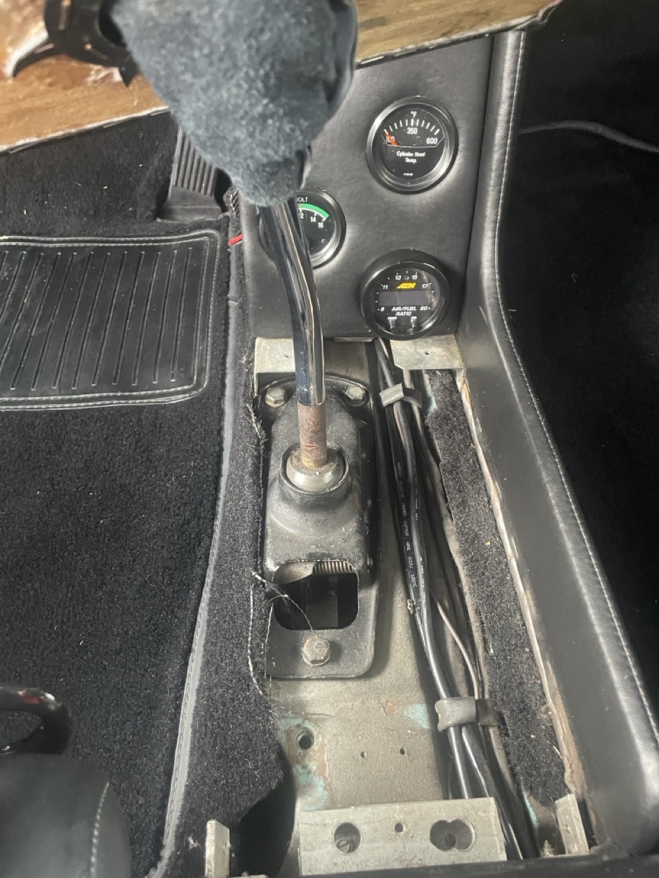

I’m having trouble finding the right shifting plain. I have all of the Tangerine products, but still always clip reverse when going into second gear, so I ordered it. After putting the firewall bearing, shift rod, and adjuster in, I have it shifting pretty well. When I went to put this new adjustment tool on, it is not working as stated and it’s not lining up with the picture provided either. What is shown in the picture as the 2-3 middle plain, is what mine looks like when it’s on the 4-5 plain. When I put it in 2nd gear my shifter on the trans doesn’t have any space as shown. When I have a space, is when I’m in the 4-5 gear plain. What am I doing wrong??
The first two pics are in 2nd gear. The second two pics are when I’m in 4th gear Attached thumbnail(s) |
