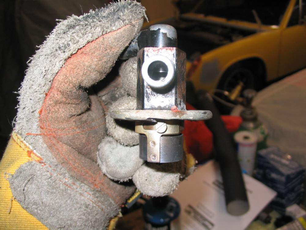

The AAR is stuck open on my 2.0L. In fact, when I connect it to the power source it pops the fuel pump fuse (25A) (IMG:http://www.914world.com/bbs2/html/emoticons/mad.gif) I put a clamp on the hose so now I have to feather the throttle at stops until the engine is warmed up. Obviously, if I take the clamp off then the engine will idle really fast once op temp is reached.
I found a "spare" unit but it, too, is stuck open. Why can't they stick closed? (IMG:http://www.914world.com/bbs2/html/emoticons/biggrin.gif) So, what is there to replace it? I tried the 914 on-line part stores no no avail. AA was a PITA to "flip" thru their on-line catalog (yeah...whatever) and I get bored and gave up looking thru it. The device looks exactly like the unit I had on my previous Type 3 automatic -- which served the same function and was powered by the coil. So I got to thinking, the other units out there, for cars like water-cooled VW engines, use a similar device, just a little more aerodynamic looking (IMG:http://www.914world.com/bbs2/html/emoticons/biggrin.gif) Would one of those (less expensive) units work? Can someone point me to a place that does sell AAR's for our cars (not a "I think such-n-such sells them")? What have others done to fix or replace their failing units?

Air_Cooled_Nut   Thanks guys, and DD for a way to electrically test...   Oct 1 2005, 11:11 AM

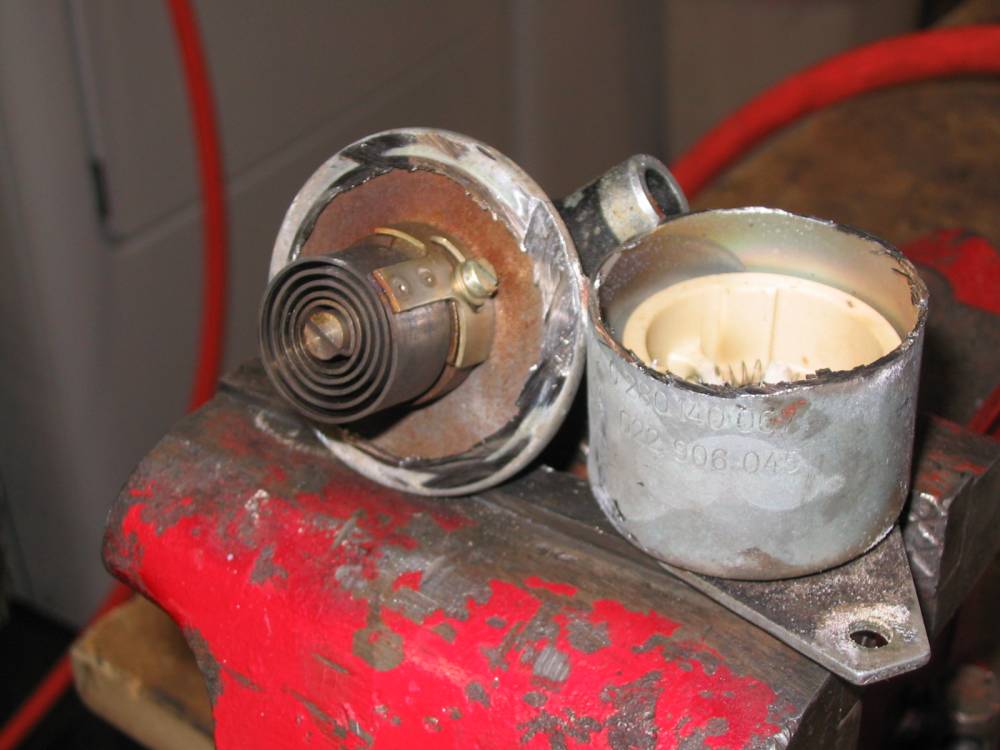

Air_Cooled_Nut   The bimetalic spring is easily removed and doesn...   Oct 2 2005, 01:53 PM

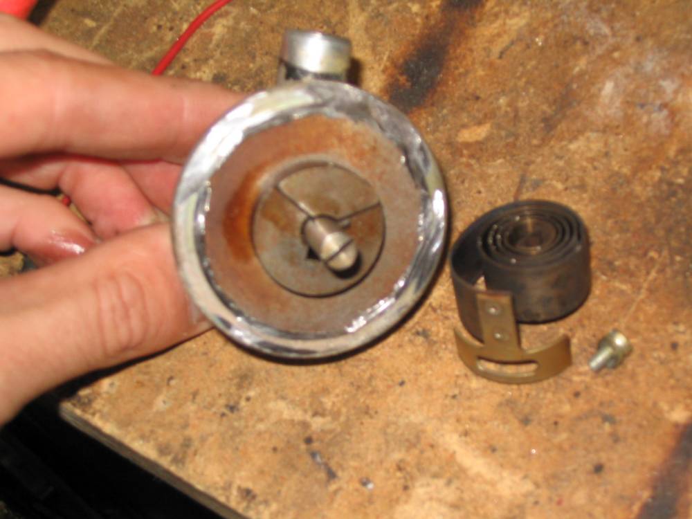

Air_Cooled_Nut   Adjusting/retaining spring screw. In the setting ...   Oct 2 2005, 01:54 PM

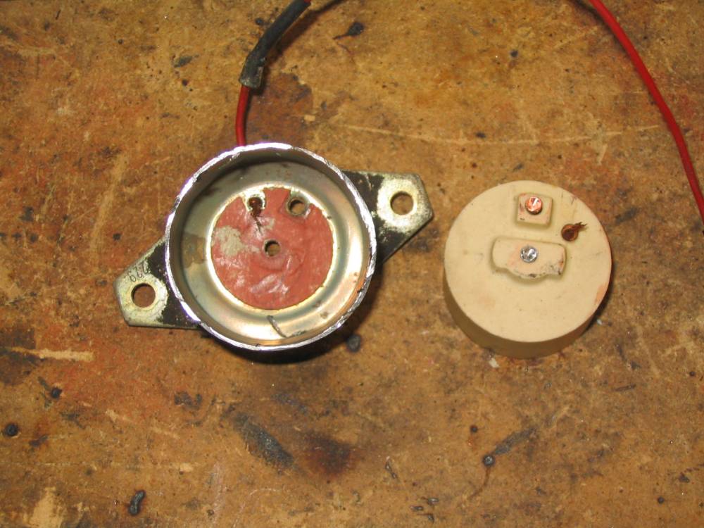

Air_Cooled_Nut   For my application I removed the ceramic cup, fibe...   Oct 2 2005, 01:54 PM

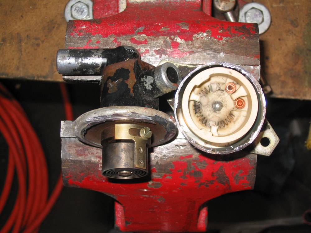

Air_Cooled_Nut   I removed the ceramic cup and bits then put the to...   Oct 2 2005, 01:55 PM

Air_Cooled_Nut   Just came back from a test run -- failure
