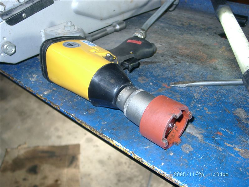

Weapons of choice:

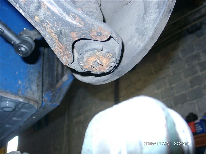

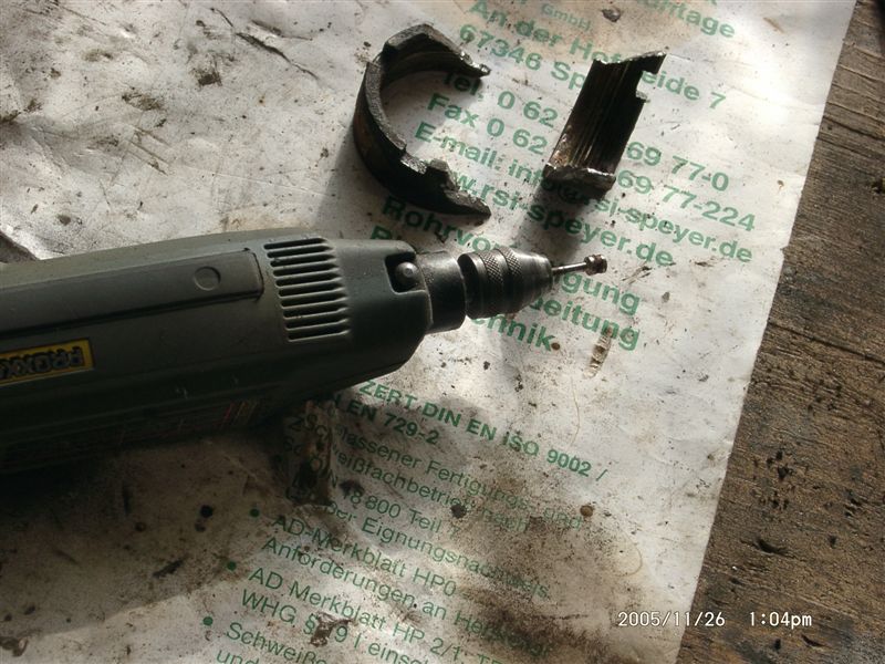

then i decided to grind out the big nuts with a dremel. Fortunately i bought a set of that stupid nuts time ago.
michelko

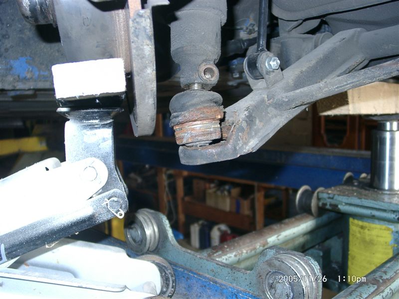

old stuff

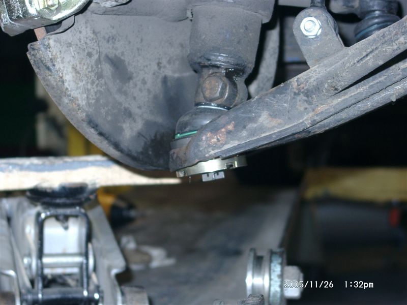

and the new ones

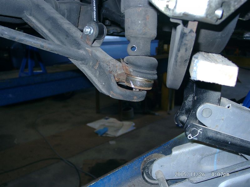

driver side

and after half an hour of grinding

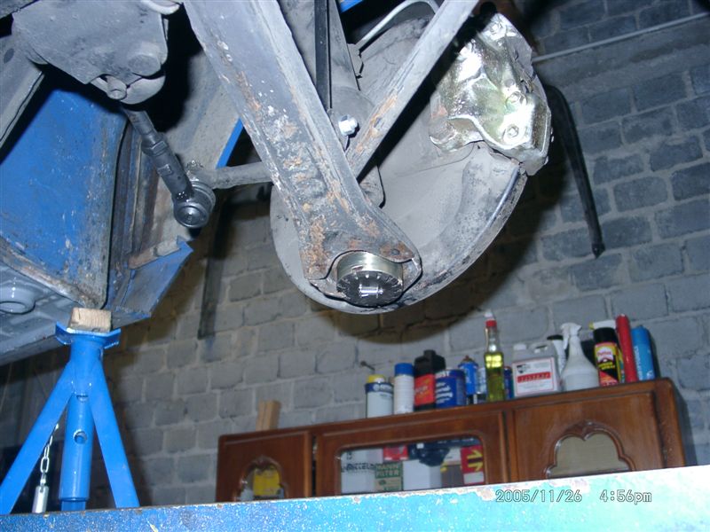

the new one in

Where did you get the tool for removing the ball joint nut? I think this is the first time I have seen the "special" tool, other than in my Haynes manual. I remember the one Dave Hunt made up from pipe fittings.

QUOTE (maf914 @ Nov 28 2005, 06:09 AM)
QUOTE (michelko @ Nov 27 2005, 11:22 PM)
Opening the nuts that hold the ball joints was areal disaster (IMG:http://www.914world.com/bbs2/html/emoticons/dry.gif)
With the right tool an an impact wrench a 1/2 hour of work....
nothing happened.
Weapons of choice:
I used an adjustable pipe wrench to remove them on my car. (IMG:http://www.914world.com/bbs2/html/emoticons/sad.gif)
i bought it from guy that is remanufacturing several parts, like tools, suspension bearings, caster shims, etc.
I bought it before i saw the idea with the pipe fittings, on the other side 20 Euro are not to much for this rare tool
Also on german ebay those tools appear from time to time.
Unfortunately in my case the tool doesn´t help anything to remove the nuts. (IMG:http://www.914world.com/bbs2/html/emoticons/mad.gif)
For torquing down the new nuts it was very helpfull.
