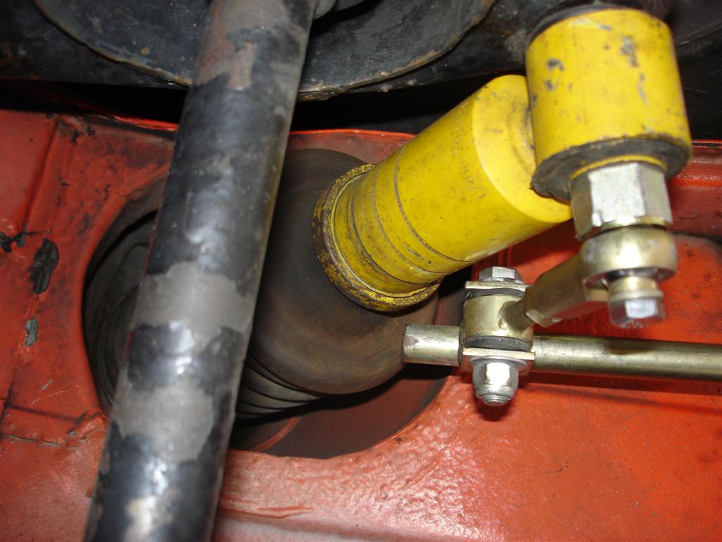

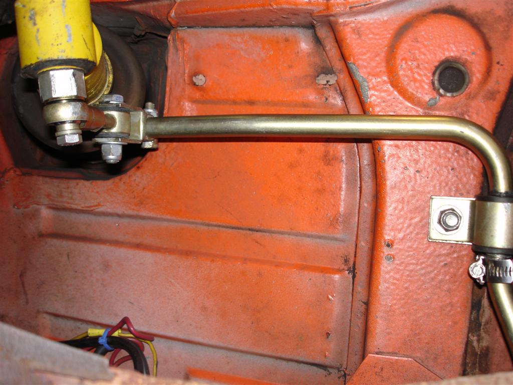

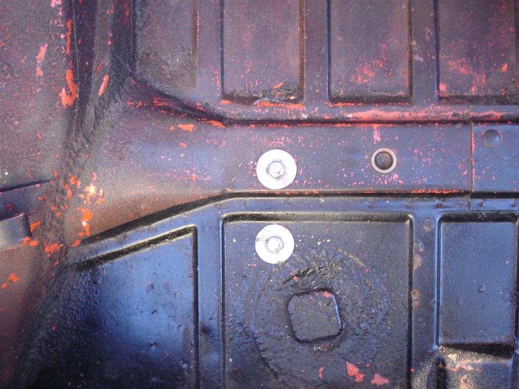

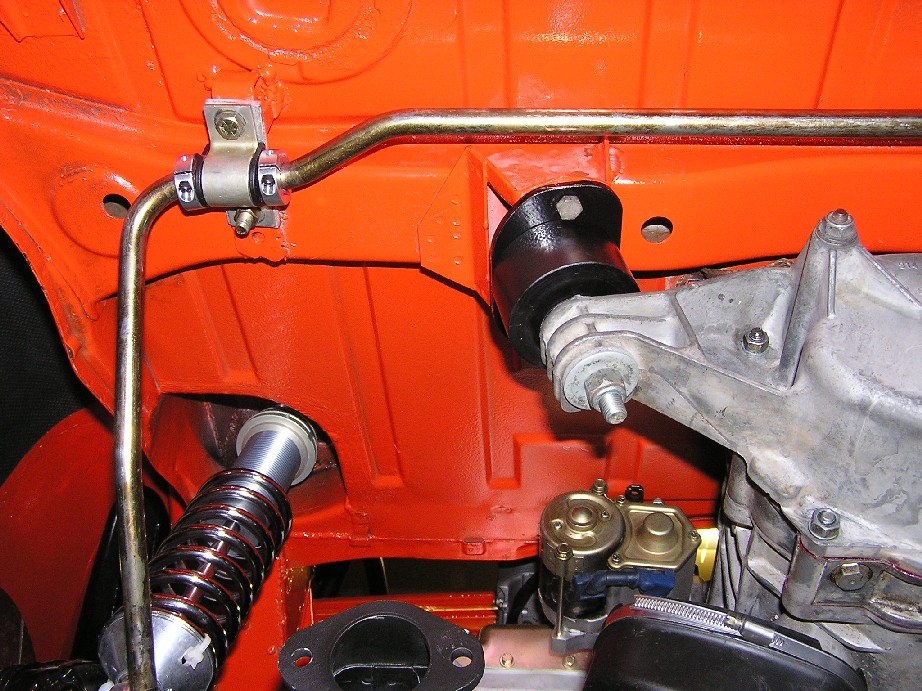

Well, I got it figured out. The installation was pretty straightforward and went quickly. A second set of hands would have been nice, but wasn't really necessary.
You can see how close the adjustable slider comes to the shock body. I will just have to set the bar a bit stiffer. The fronts are also adjustable and the first AX of the year is next Sunday so I'll be fiddling with each end until I get the car to balance.
You can also see that the Welt bar does not use the same mounting points as a stock bar would. I think the stock bar goes into the outboard plug holes.
Mmmm. Performance parts. Sexy.

Couldnt you shorten the drop link for more clearance?

QUOTE (Luke M @ Jan 8 2006, 10:40 AM)
I havent installed mine yet but just a thought.
Yup, you can. On mine virtually none of the threaded portion is visible. IIRC you want to try to adjust the droplinks to get the ends of the bar as close to parallel to the ground as feasible.
There's evidence on my car of the drop link hitting the trunk floor at some time in its life (with the PO) but I have never noticed this happen since my ownership - I substantially stiffened up the suspension & chassis.
I keep it on full soft but prefer the way the car behaves with it vs. without it. Having front + rear bars also gives you quite a bit of trackside fine-tuning capabilities without having to dick around with spring swapping.

Can you point the droplinks back instead of up? that would give you more clearance to your trunk floor, no?

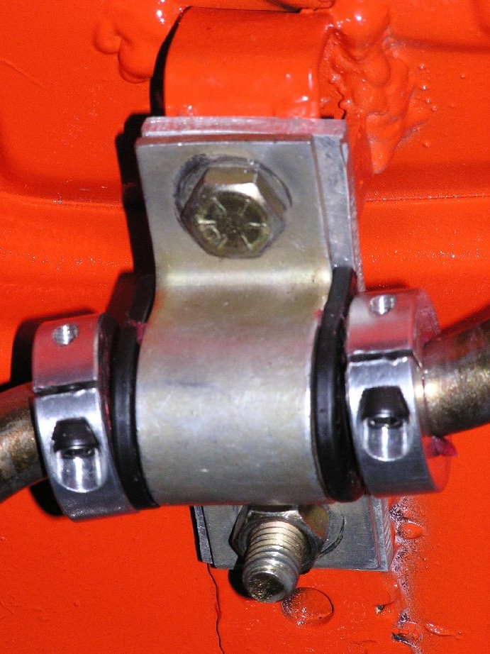

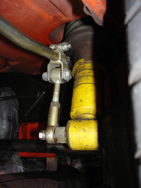

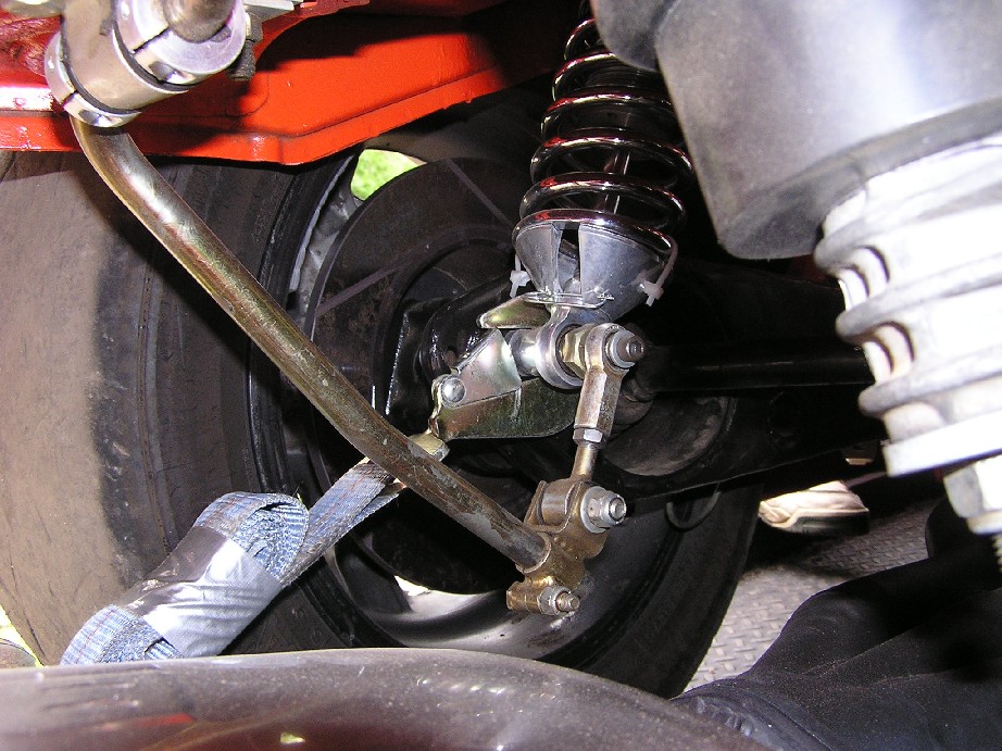

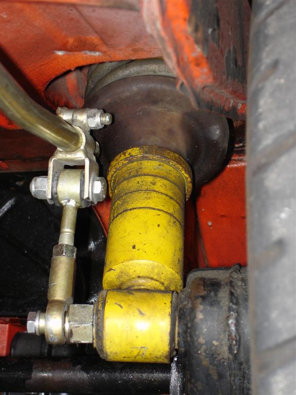

just a few more pictures.
Like Chris, we shortened the drop links.
Also, our shocks are inverted so presented weird clearance and attachment issues.
but the bar is the same:

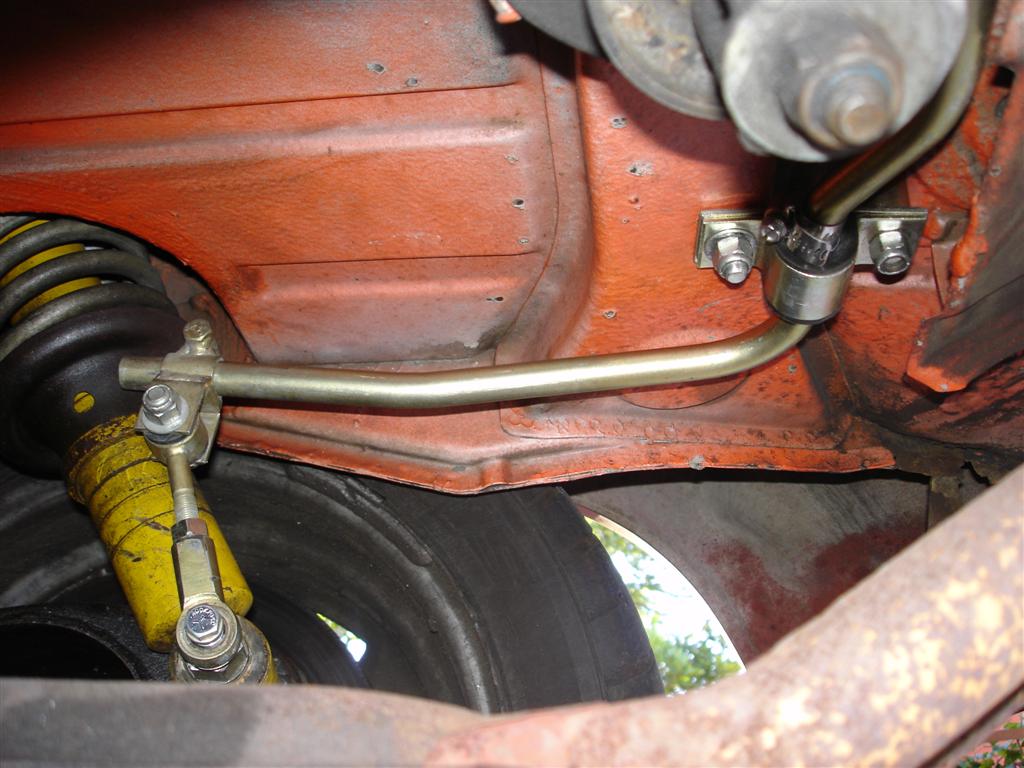

brant
post Jan 8 2006, 01:09 PM
Posts: 12,179
From: Colorado
Member No.: 47
We used aluminum shims to give it a bit more rotational clearance,
and aluminum stops:
brant
post Jan 8 2006, 01:13 PM
Posts: 12,179
From: Colorado
Member No.: 47
Here is our attatchment..
and in this picture the drop link is actually down:

hmeeder
post Jan 8 2006, 01:42 PM
Dante's Sportscar
Posts: 352
Joined: 21-November 04
From: San Diego, CA
Member No.: 3,154
Chris and Brant;
Thanks Gentlemen (?) that's exactly what I was looking for.
So as you can see from the attached photo, my drop link also is contacting my trunk floor, but the instructions and Brant's photos show the drop links going below the shock mounts vs. above (as I did and as a stock set up is.) Sure I can shorten them a bit, but they've contacted the floor with just 2 days of spirited street driving. I could only imagine the damage when I AX it. (IMG:http://www.914world.com/bbs2/html/emoticons/blink.gif)
The bar's PO put hose clamps on the bar to operate as the stops. Not nifty aluminum stops like Brant's, but they do the trick. ps: Brant, your shocks and springs are real purty. (IMG:http://www.914world.com/bbs2/html/emoticons/wub.gif)
Thanks again. Time to get back under the car to flip the bar! (or just the links, since the bar is in the correct orientation.)
Oh, and Andrew, the lower shock bolt is something that comes with the bar and is specific for the application. Though if you don't have them for the bar I suppose you could easily weld a boss to the end a stock mounting bolt. Depends on your welding skills I suppose? I would think it could work.

A closer read of your instructions do show the links above the shock mount bolts.
I wonder if Brant has any issues with them below the mounts? The physics of it seems the same above or below, I'm not an engineer (but I play one on TV.)

brant
post Jan 8 2006, 02:15 PM
Posts: 12,179
From: Colorado
Member No.: 47
our springs... and specifically spring hats create a space problem for the droplinks to go up.
