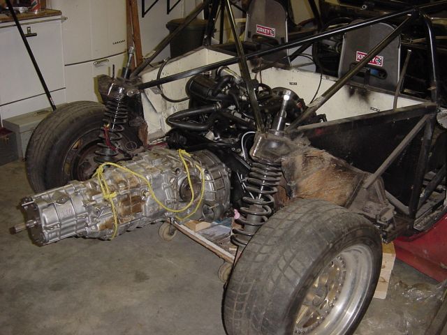

Hi everyone! I have a tube frame 914 that I'm putting a 993 3.6 in and a G50 trans to go with it. I have read lots of old threads on NOT flipping the G50 for use in a 914 but was hoping for some advice.
I understand that flipping the diff is just too hard and have heard that to flip the entire trans requires cutting bell housings off etc.
My question is, why can I not simply fill the old holes, build up the case a bit, and drill new holes? They only need to move 1/4".
Jim

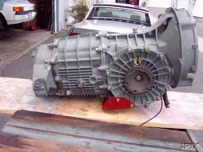

jc87930   Attempt at attaching an image...   Sep 1 2003, 11:48 PM
redshift     Sep 1 2003, 11:59 PM
Brad Roberts   Um.. Jim.. That is a C4 tranny out of an all whe...   Sep 2 2003, 12:29 AM
Bleyseng   Here we go! an all wheel drive 914! should...   Sep 2 2003, 06:20 AM
