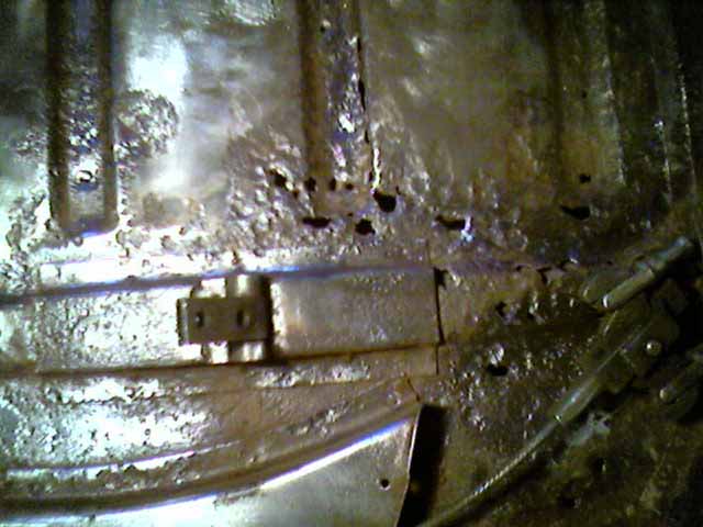

Rust treating, killing, etc, and just want to get some input before I get to crazy with the MIG.
Here are some questions: I have some floor pan issues. Are the holes too big just to try and fill? The following photo is from the driverside, under the seat after the tar has been removed, and I've grinded down to bare metal. Should I advertise for someone who's cutting up a car to cut this pieces out for me, or should I just go buy some sheet metal and make a patch knowing it won't really match, but can at least be made to 'line up'? Attached image(s) |

You can buy new replacement floor pans.
Also any car that's in the "parts" car condition probably won't have floor pans any better than yours. (IMG:http://www.914world.com/bbs2/html/emoticons/smile.gif) |

do yourself a favor and get a new pan section. That piece is pretty eaten up and if you try to weld up the holes you'll just burn through the surrounding areas. Gaurantee!

Next set of questions:
Do I just cut the jack plate out? And leave the rocker as is except for using Metal Ready on it? There are a few holes in the inner rocker panel as you can see in the photo, but can I just cut these out and weld a new patch in? Or should I really cut into the whole thing with the idea that there might be rust (might, that's a laugh) on the inside that will need to be treatd as well? How do I cut the plate off? Just use a Sazall and/or snips, or do I use the welder to 'melt' the existing welds so I can pull it off? There is also rust at the top of the inner rocker along the length of the driver side where it meets the door threshold (I think this is the correct name.) The door threshold all but covers it up in the photo- Do I just apply metal ready to this area? Attached image(s) |

Cut it out, treat inside and replace with a new piece of metal. If the inside isn't eaten up, you could simply bend a pice of 18 gauge to the outside shape and weld it on. Jack post doesn't need to be there but the metal under it does.Spend the $25.00 and buy OSPHO for the inside, it is a helluva lot better than the cheaper stuff but it will f-up you senses if you take a good wiff of it so wear a mask!! Give it ample time to dry before enclosing it and make sure the edges of the metal don't have any on them.

you need to do something with the upper left portion of that pic as well, looks like you've got some serious issues building up in that rocker (IMG:http://www.914world.com/bbs2/html/emoticons/sad.gif) when you get the section cut out, put a blow chuck up at the front vent hole of the rocker (inside the car by your left foot) and blow towards the rear of the car to clear out any rust or debris that may be in there, and if possible spray some of the OSPHO into the whole rocker.

Sounds good, but is the tube that's inside the rocker all metal, or is it some kind of foam hose or something. I don't want to mess it up, and I've seen pictures that seem to show some kind of material other then metal that's used for the heater hose in there. Scotty b, thanks for the info, and more questions if yer up for 'em: The rust at the top runs along the entire rocker towards the front of the car. I wasn't able to punch holes in it with a screw driver, so my hope is that the rust is all on the outside. However, I can't get to it with the grinder either because it's tucked in under the door sill, so I would love to just be able to treat the outside of the majority of the long with something. Is OSPHO like Metal Ready? Or does it work differently/better? |
