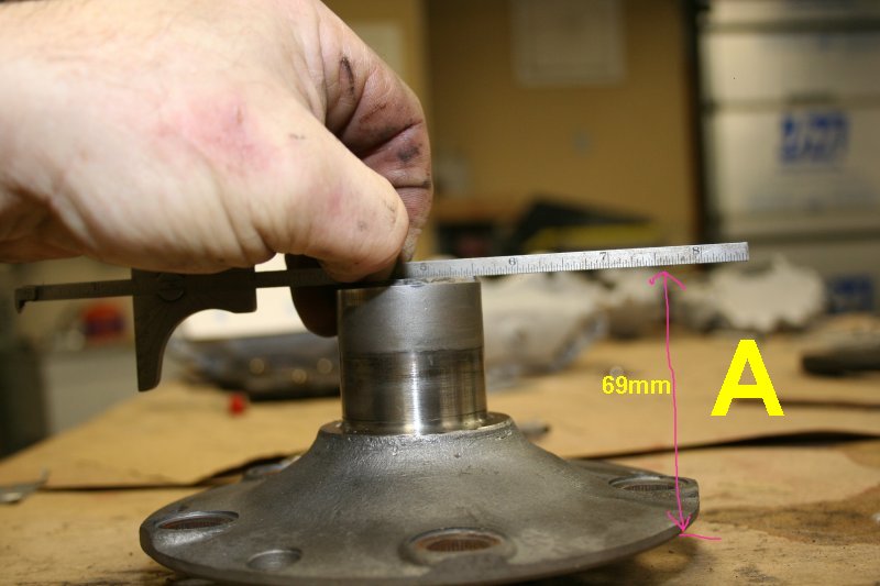

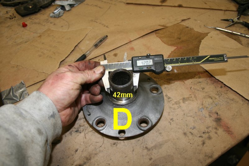

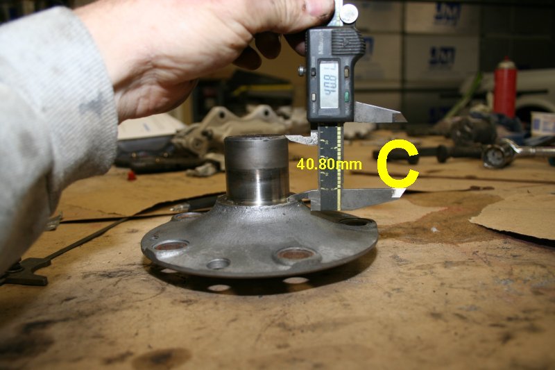

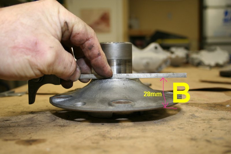

OK, here we go......Flange is off a 1977 911

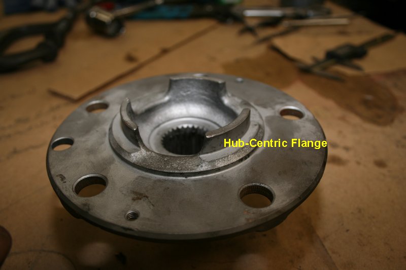

And this is why we want this type flange. The raised portion in the center locates the wheel instead of the lug nuts. The other type of flanges are flat all the way across.......Hub-Centric is a much better method of wheel locating than lug nuts

Early 911 should be:
35.5mm length of shaft vs. your 40.8mm
42mm diameter of shaft vs. your 42mm
68mm total height vs. 69mm (could be straight edge fudge factor)
33mm base to face vs. your 28mm
Let's see what John comes back with.
Looks to me like they simply machined more off the backside of the hub for the longer bearing. I believe it's fatter to though (OD of the bearing) as the handbrake assembly changed to a larger bolt spacing with this new bearing.

I measured one. (Eric, I still have no word from USPS on the lost hubs, I'm guessing they are gone for good.)
A. 68.50 mm
B. 32.40 mm
C. 36.10 mm
D. 42.01 mm
These are real close. I tried in several spots around the hub.
They agree pretty much with what Eric found.
It looks like a 5+/-mm spacer would work nicely with the late model hubs.
