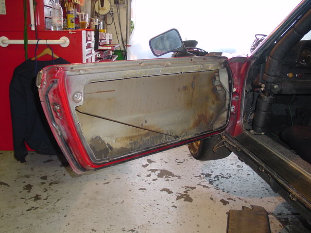

I made the plunge and decided to start cutting into the car and lighten her up....I've pulled the hoods, gutted the doors, pulled all the glass except for the windshield, and have cut off every tab and extra piece of anything metal on the car...
Total weight taken out so far = 286 lbs! (according to my bathroom digital scale)...
Here's a few pics....
The first one is the doors gutted...

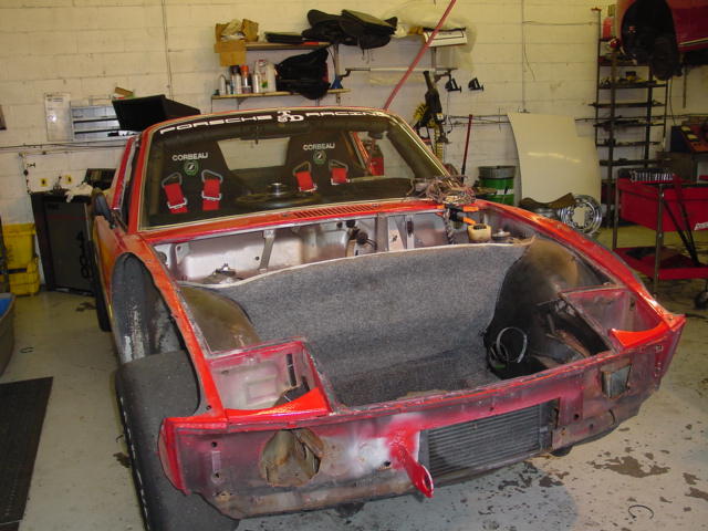

Here's a pic of the front of the car with all of the headlights and bucket motors gone....

get some early doors (pre '73) and gutt those, you'll loose a few more ounces.
OR buy FG-shells. do you have a roll-cage?

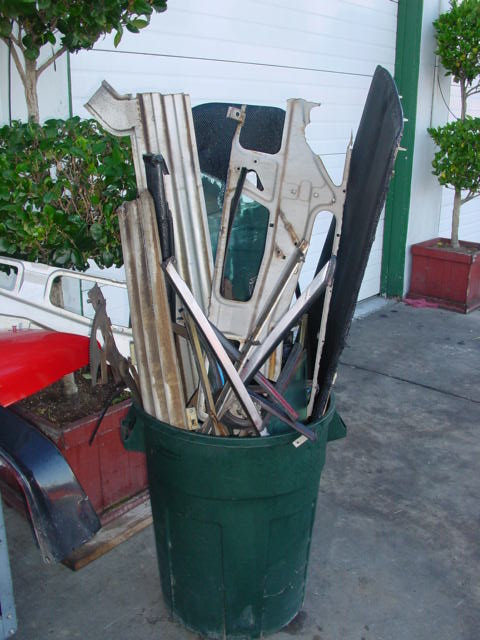

And here's a pic of 1 of 2 garbage cans full of metal....it's kinda unbelieveable what you find when you start cutting here and there.....all of the insulation is now off too...and all of the wiper motors and ventilation hardware....

are you required to have headlights? if not, cut out the buckets too ...
and the piece for the washer bottle. and take out the two pieces that hold up the cowl area.
and ...

I'm not required to run headlights....I've decided to run the open class next year for air cooled engines up to 2750cc....It's "Y" class in the local PCA region....
and...and...and...is right.... (IMG:style_emoticons/default/laugh.gif)
and I haven't even started on the interior cockpit area, although I am considering leaving some of it in for comfort sake...I'll have to see...

JP, unbelieveable what you can cut out of the car. Of the 2 garbage cans filled with metal, one of them takes two people to lift. I had a hard time believing people when they said a piece here a piece there all adds up. It does!

I have a set of early doors that I got from a local shyster (IMG:style_emoticons/default/laugh.gif) Before I start cutting on em', how flimsy are those in your pic? Also, have you come up with any type of padding for the window opening?....my elbows are tore up enuff.
