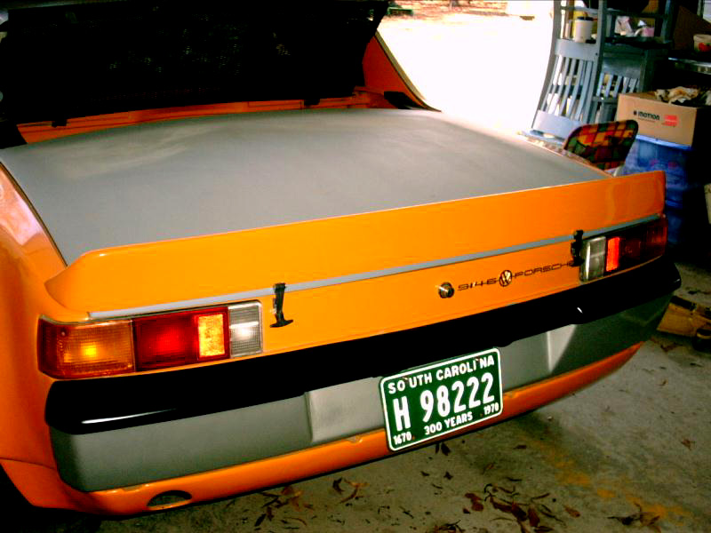

Could a trunk latch like this be used with the reflector?
(IMG:http://www.914world.com/bbs2/uploads/post-2-1073055461.jpg)
Air_Cooled_Nut
post Jan 17 2004, 10:18 PM
914 Ronin - 914 owner who lost his 914club.com
Posts: 1,748
Joined: 19-April 03
From: Beaverton, Oregon
Member No.: 584
QUOTE(soloracer @ Jan 17 2004, 07:52 PM)
Nope. The reflector fills the whole space!
