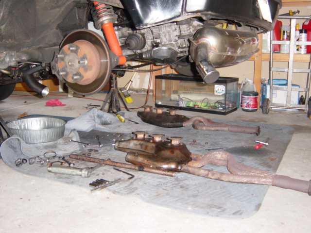

OK, I have finaly started the process of tear-down!
My plan is to remove and replace:
The Oil Return Tubes
The Trailing Arms
Powder coat everything
Maybe Muellers Bearings toooooooo!
Can I powder coat the Heat Exchangers or should I just paint them?
Woohoo, we will see! I will post more photos as I progress!

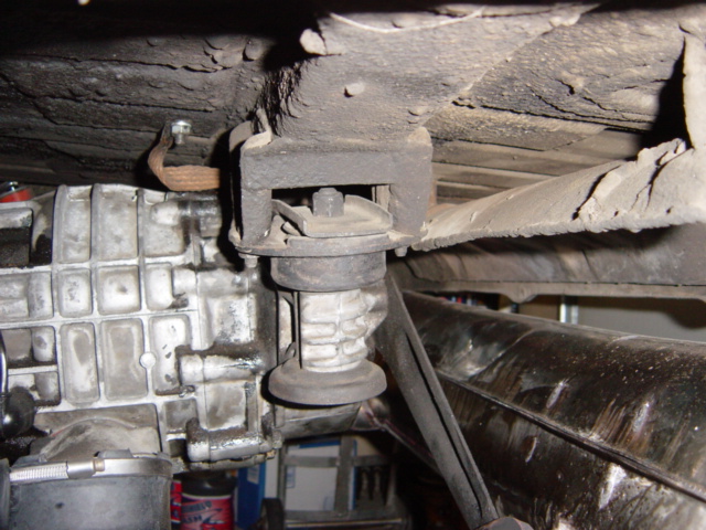

Jeff, your transmission mounts are put together wrong. The big dished washer goes up on the mount, not under the transmission ear.

I could not find a photo that matched the assembly on my car! Does anyone have a photo of the correct configuration?
Jeff

Jeffs9146
post Jan 26 2004, 01:49 PM
Ski Bum
Posts: 4,062
Joined: 10-January 03
From: Discovery Bay, Ca
Member No.: 128
This is the only photo I could find!
Jeff

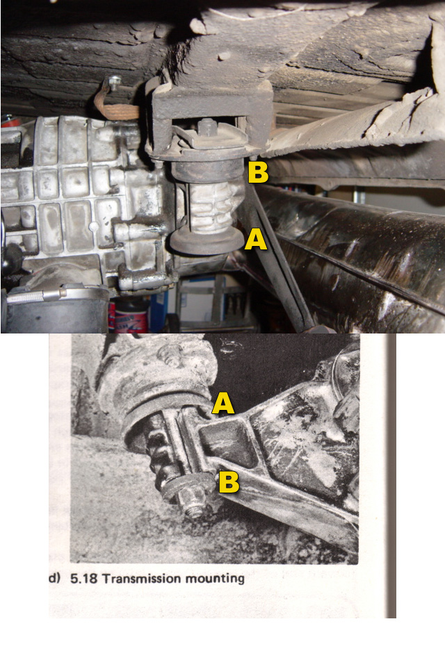

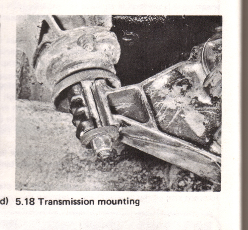

seanery
post Jan 26 2004, 01:59 PM
waiting to rebuild whitey!
Posts: 15,857
Joined: 7-January 03
From: Indy
Member No.: 100
Jeff,
I haven't done a real -6, but I believe this is correct.
Gint
post Jan 26 2004, 03:08 PM
Mike Ginter
Posts: 16,096
Joined: 26-December 02
From: Denver CO.
Member No.: 20
I just removed mine (the mounts) yesterday. Sean's photo work is correct.
Jeffs9146
post Jan 26 2004, 03:59 PM
Ski Bum
Posts: 4,062
Member No.: 128
Thanks you guys! I will swap things around before I put it back together. The PO must have done that when they put the side shift trany in!

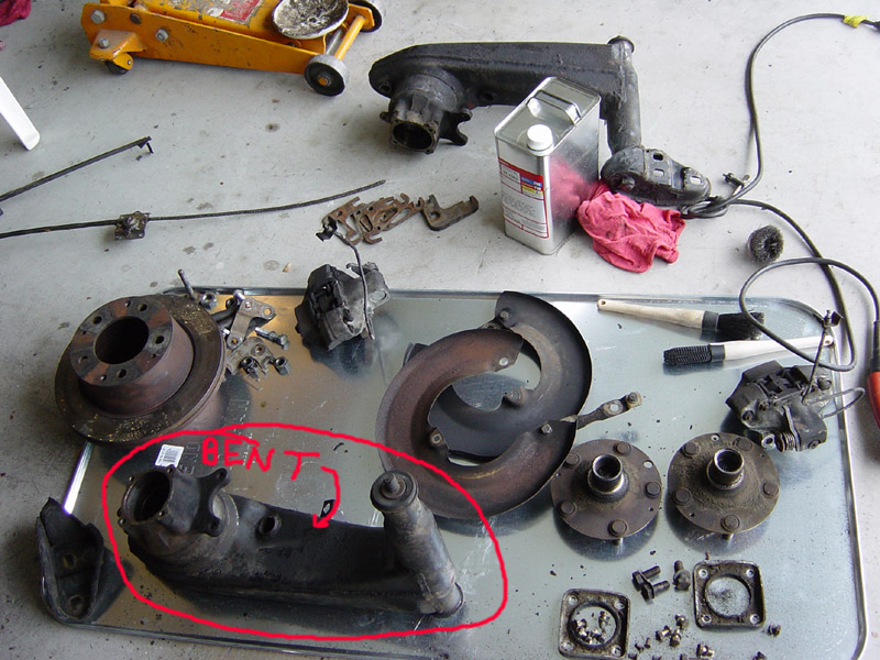

youre replacing trailing arms? why-
Jeffs9146
post Jan 26 2004, 05:09 PM
Ski Bum
Posts: 4,062
Member No.: 128
The drivers side arm is bent! The PO must have slid it into a curb or something. It has about 2" of camber spacers.

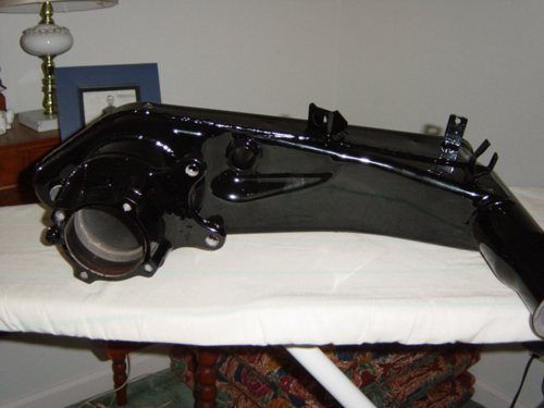

post Feb 13 2004, 01:43 PM
Ski Bum
Posts: 4,062
Member No.: 128
Progress has been made.....slow but sure!!
