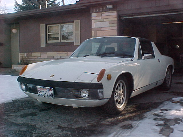

I got Pilots too:
I mounted them as far out of the grills as I could- which makes mine a paint to aim right, but its close.
Dirty Car.
Bob O
